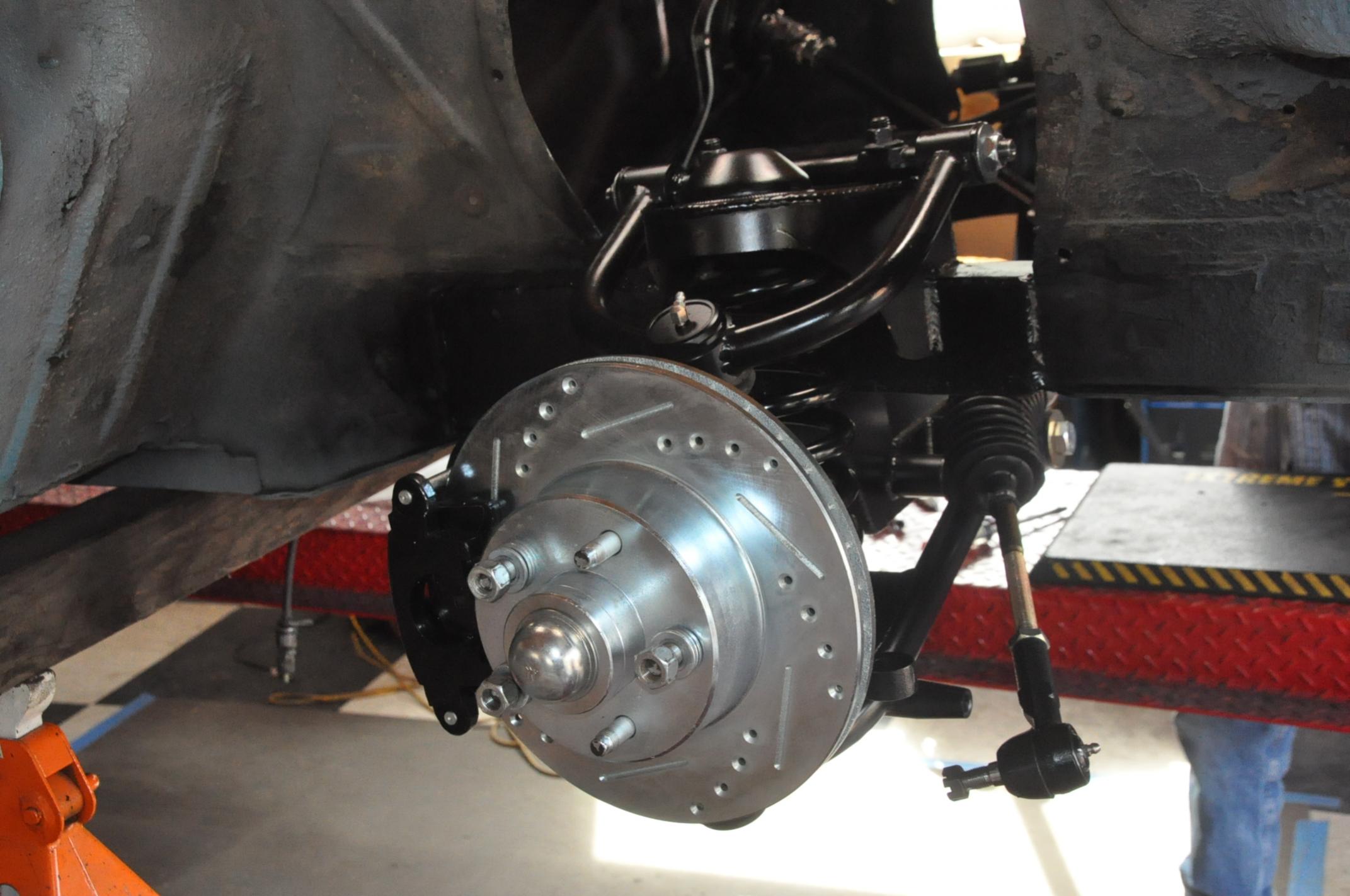

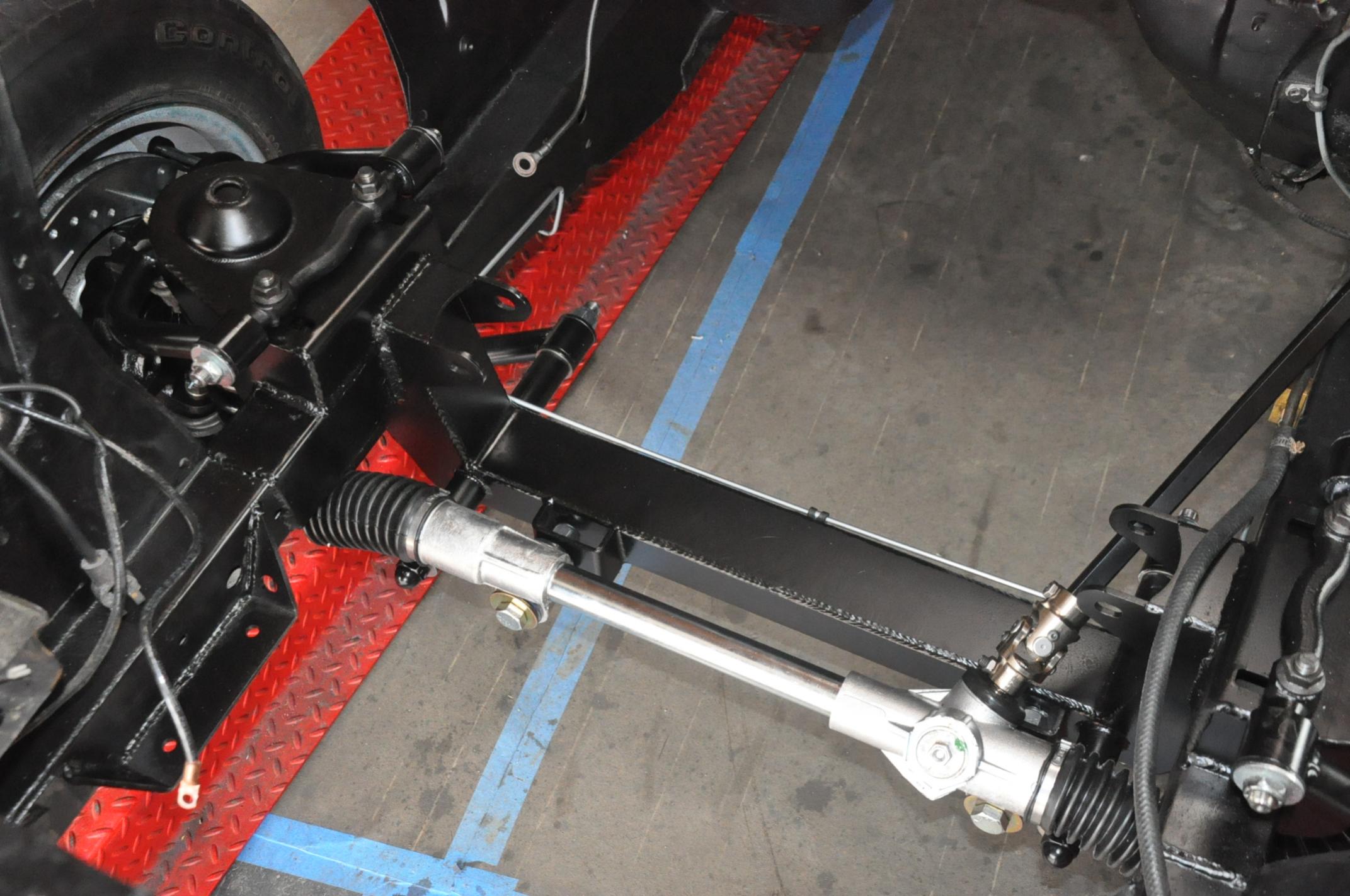

    Or you could step up and put in one of the new TCI kits and get new disc brakes and rack steering.. makes it handle like a new car..

    Sorry to hijack the post, but wow--I drove a '63 Sprint for 12 years with the original front suspension, drum brakes and power steering.
    I would LOVE to see what one of these handles like, when it handles and stops like a new car.
