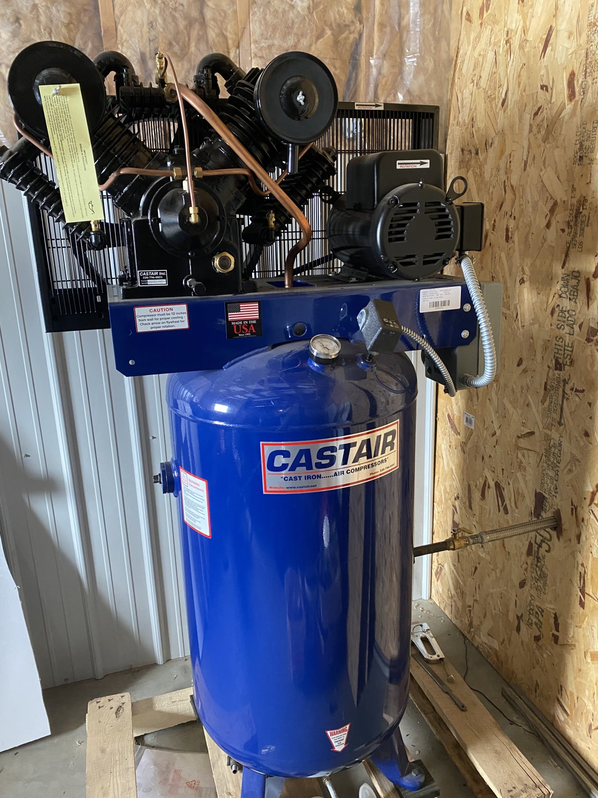

    IMG_0067.jpeg A couple of other things, make sure it it a true 5 hp motor rated for compressor duty. Walk away from a 3450 rpm motor. Find a compressor with a 1745-50rpm. This will keep the pump rpm’s down,=less heat. If you are in it for the long haul, check the compressor valves, discs are better than reeds.
    pump on this beast turns 450rpm. It is quiet and doesn’t build much heat.
    LOST ANGEL and Greaser Bob like this.
