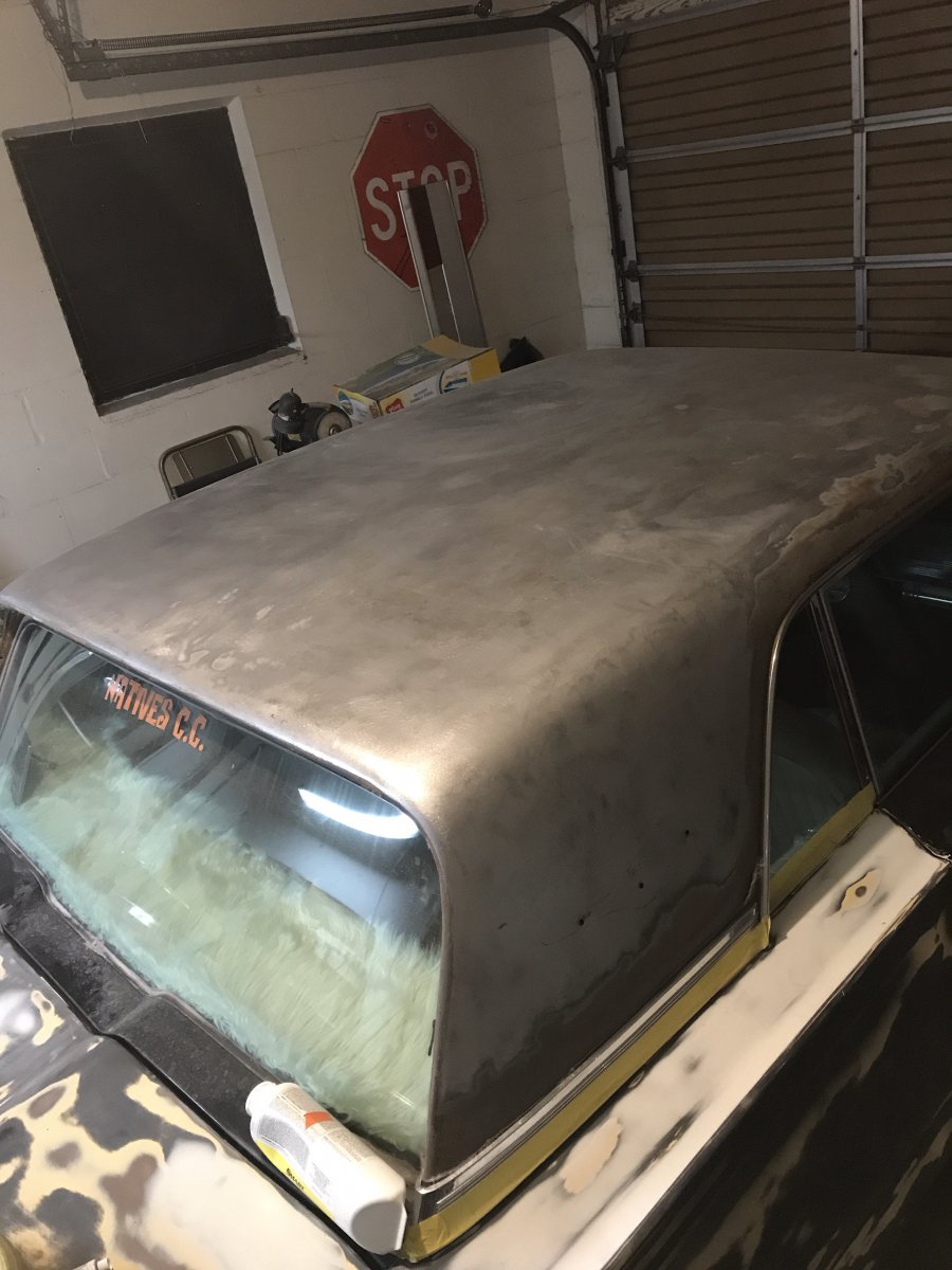

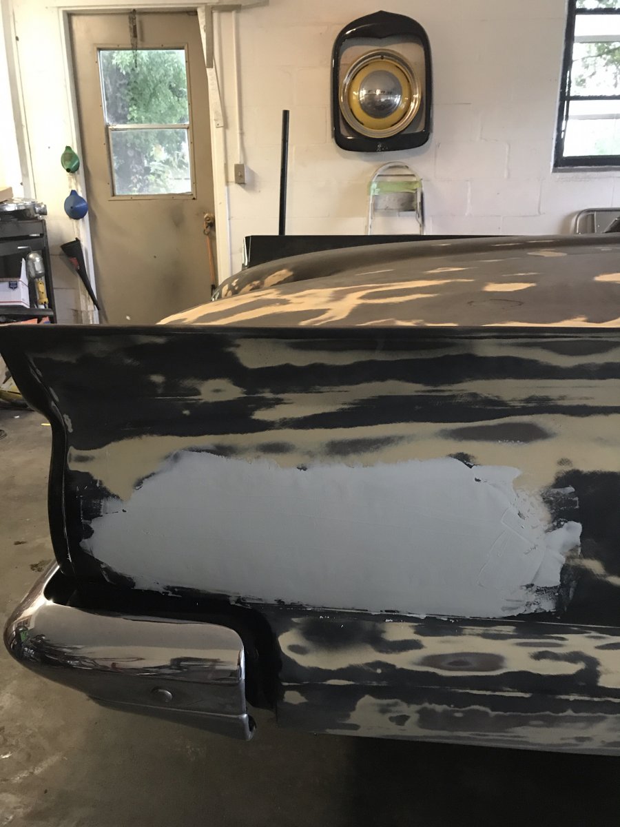

    Just wanted to share some pictures of my thunderbird I’ve been working on. It’s a mild kustom. Just shaved the trim, slapped on some ‘57 Plymouth caps, and added some fur to the interior. I will be lowering it after paint, which will be at the end of the month when I return home from the Hotrod hill climb.

    The body work was shoddy and too wavy for a black paint job, nothing on the car was taken off before paint, and it was an old enamel job. Plus I never cared for black cars personally.
    ... and it’s faux fur, so no dead animals here, just fake ones.

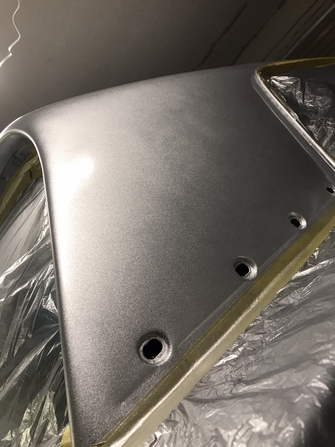

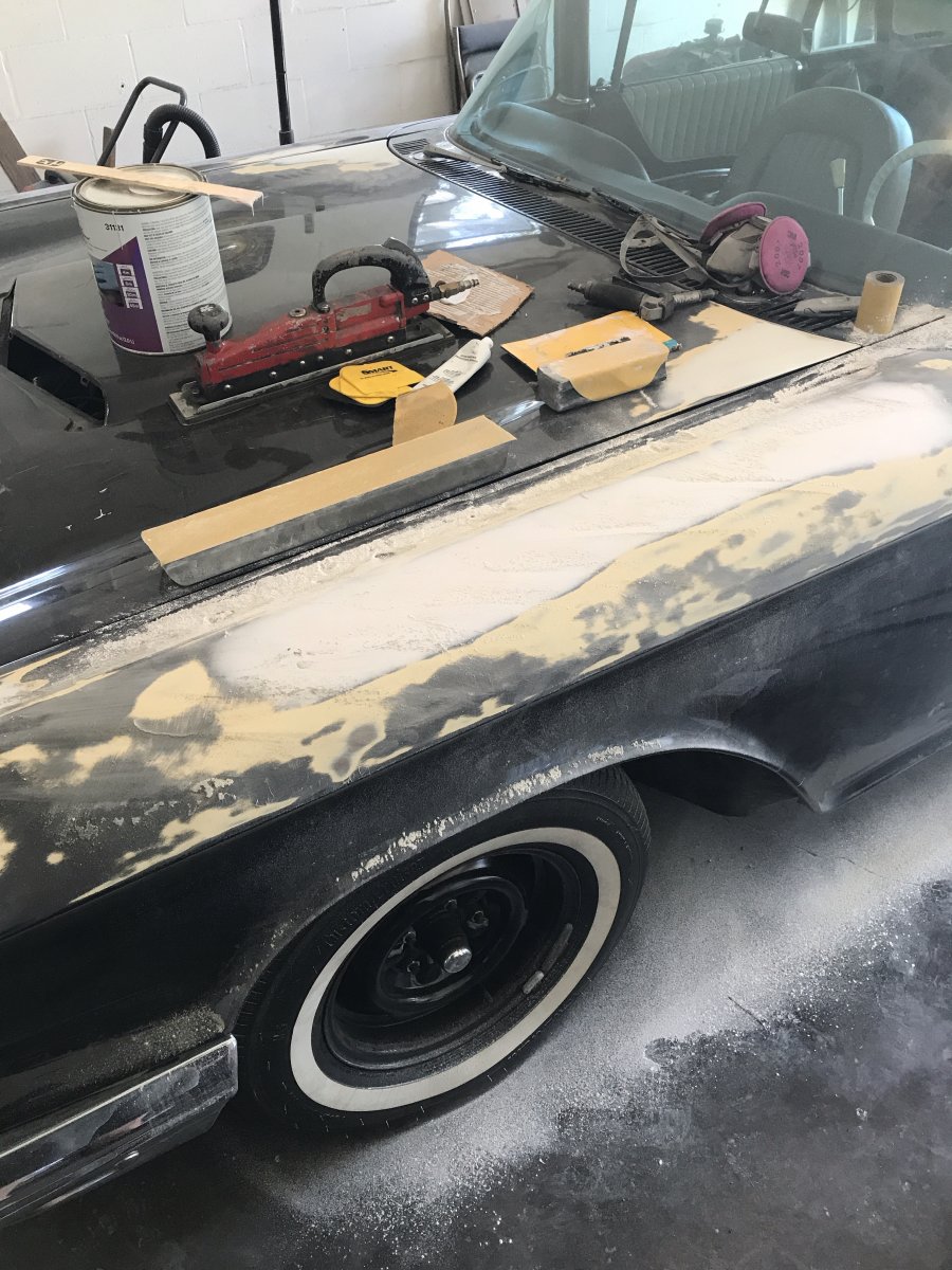

  11. [​IMG]
    Did you at least weld the trim holes before applying the bondo over paint?
  12. DrewModelA
    Joined: Oct 26, 2014
    Posts: 36
    DrewModelA
    Yes, I do body work and paint for a living. Welded the holes, filler, slick sand, and high build primer
