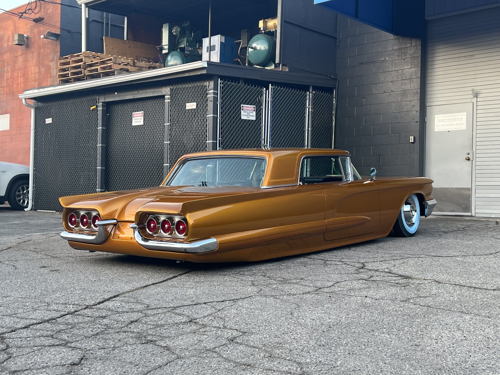

    I wouldn’t have it any other way. It’s more than enough power for this type of car especially with the cruise o matic transmission.

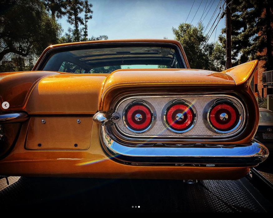

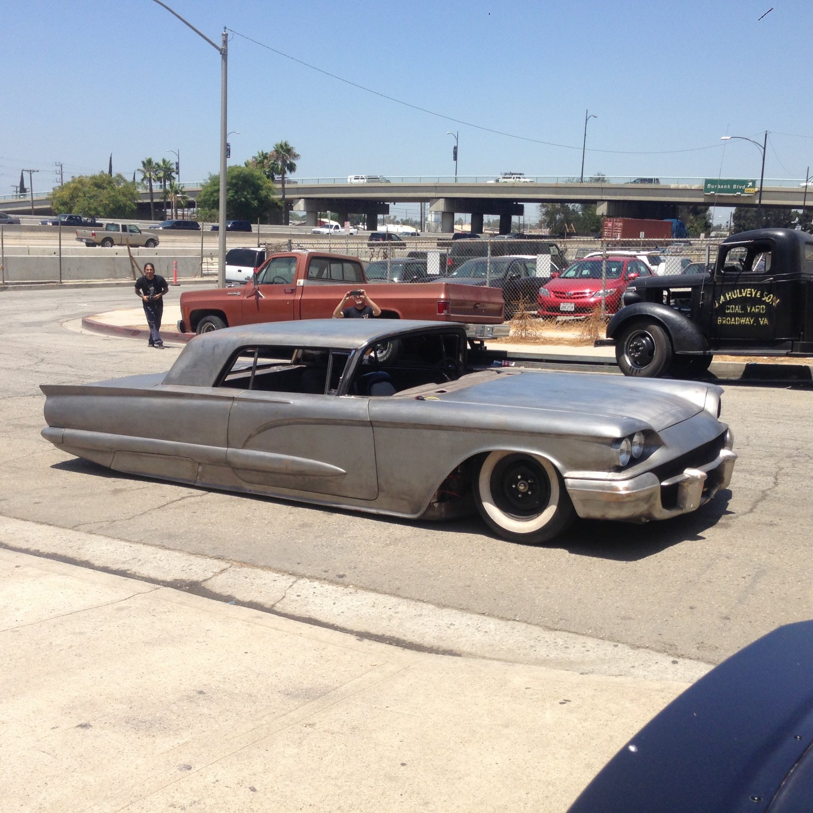

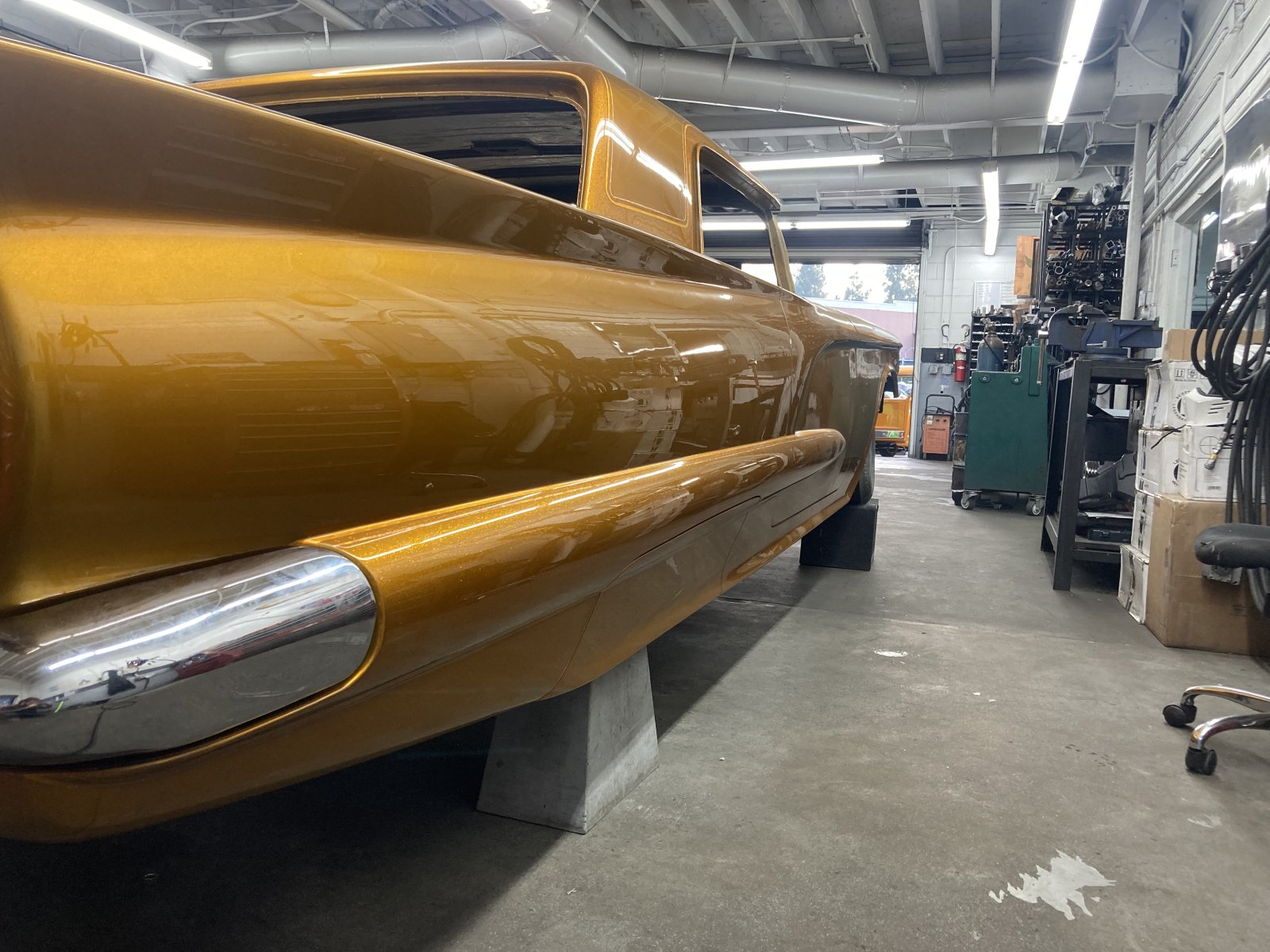

    Not wanting to steal @Hammurd thunder but here are a couple more pics from Troy Ladd's Instagram.

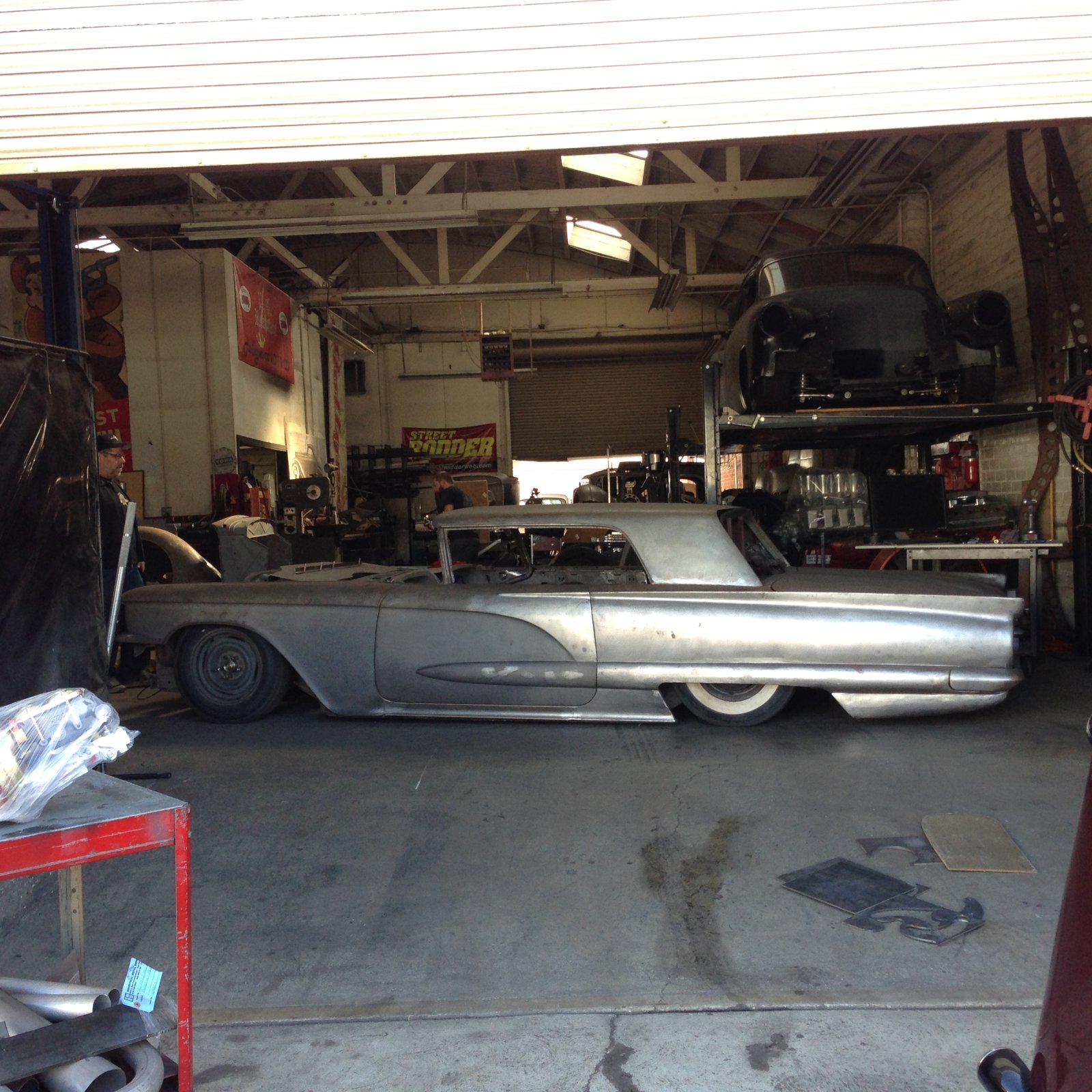

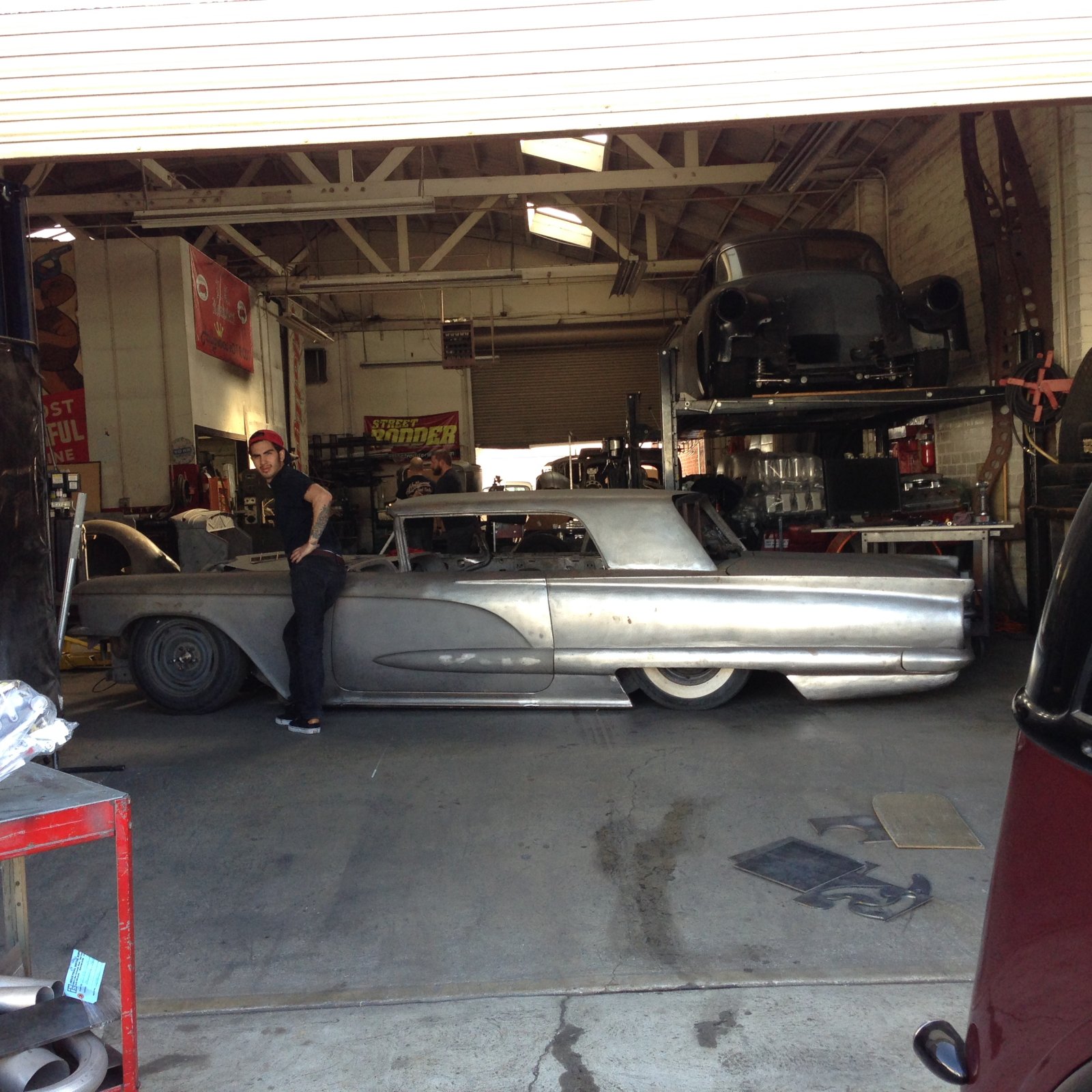

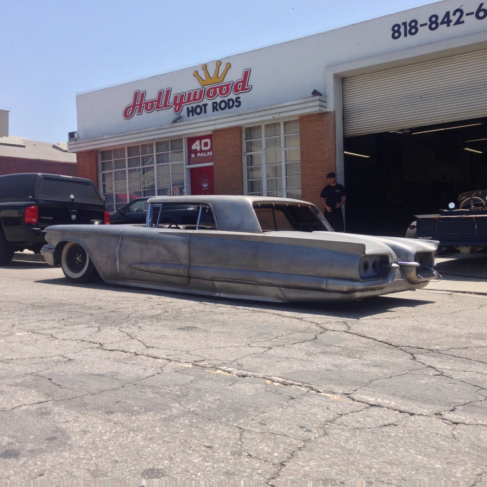

    I looked through my photos. Since there was a long gap in the build of this car, and I didn't do any sheetmetal work on this car, my photos are pretty limited. But this is what I found.
    This is with quite a bit of work done, I have to admit I don't remember exactly where this was in the build. I can't tell from this photo, if the front end work had been done yet.
    Here is one of the guys who did the sheetmetal showing off the car and his own "***ets"

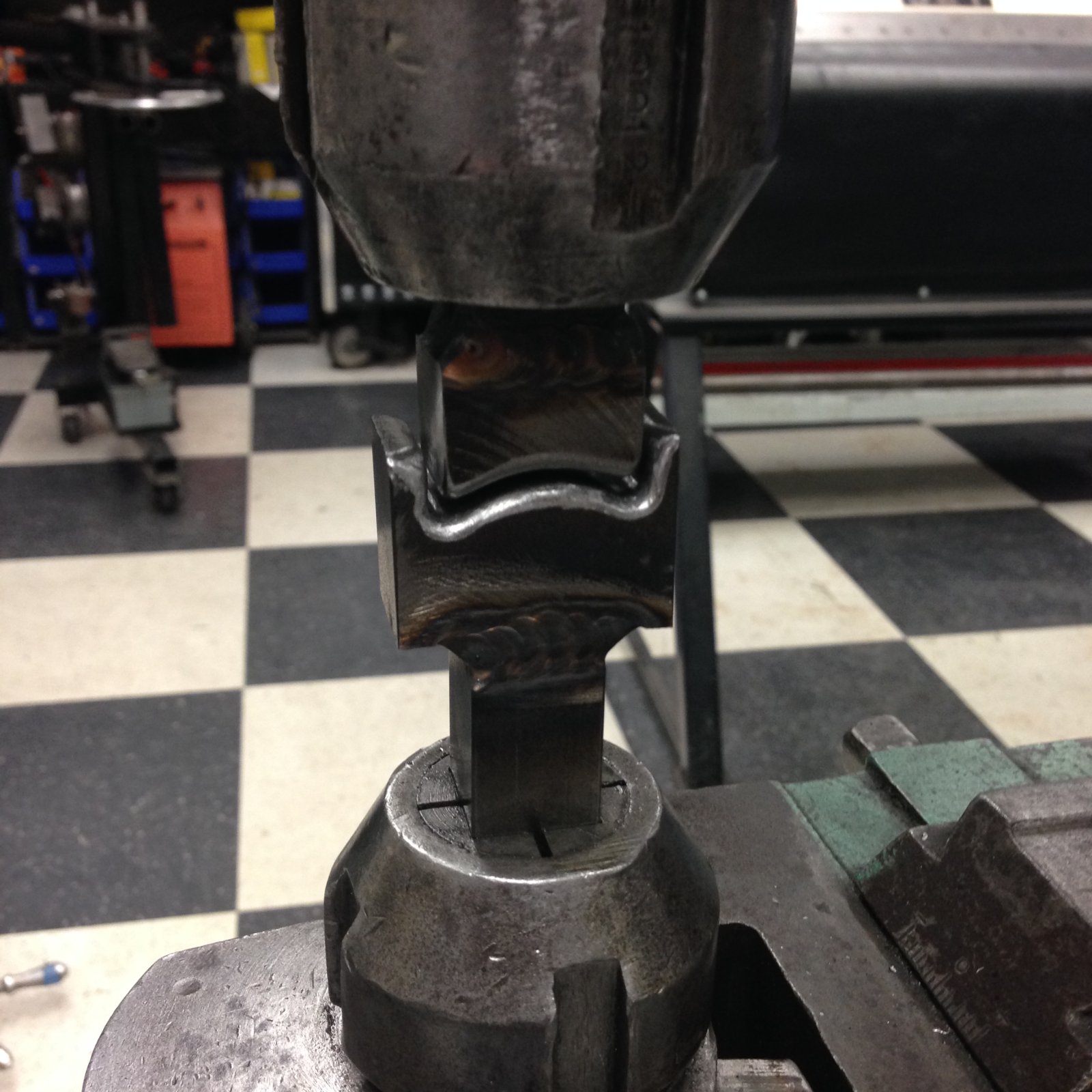

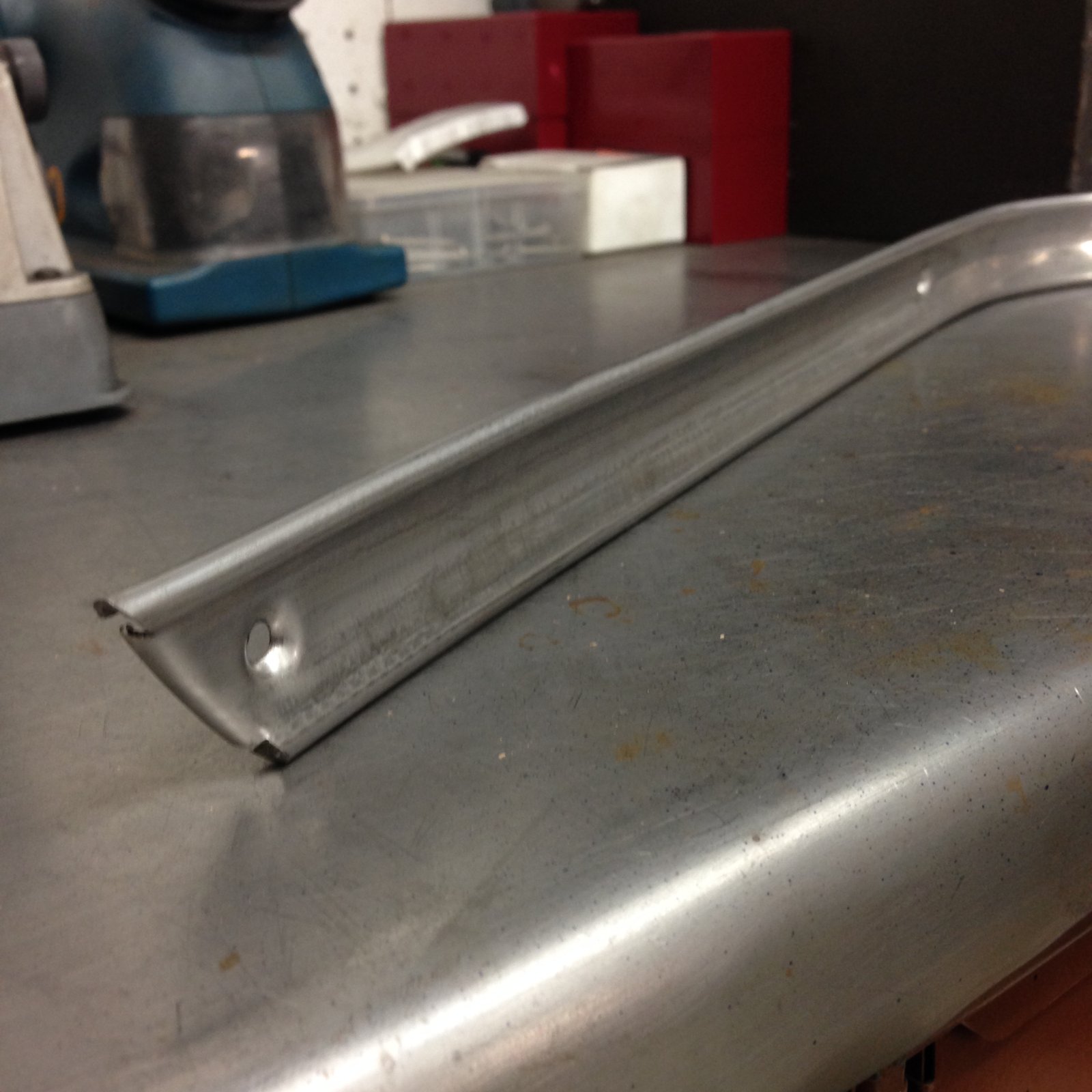

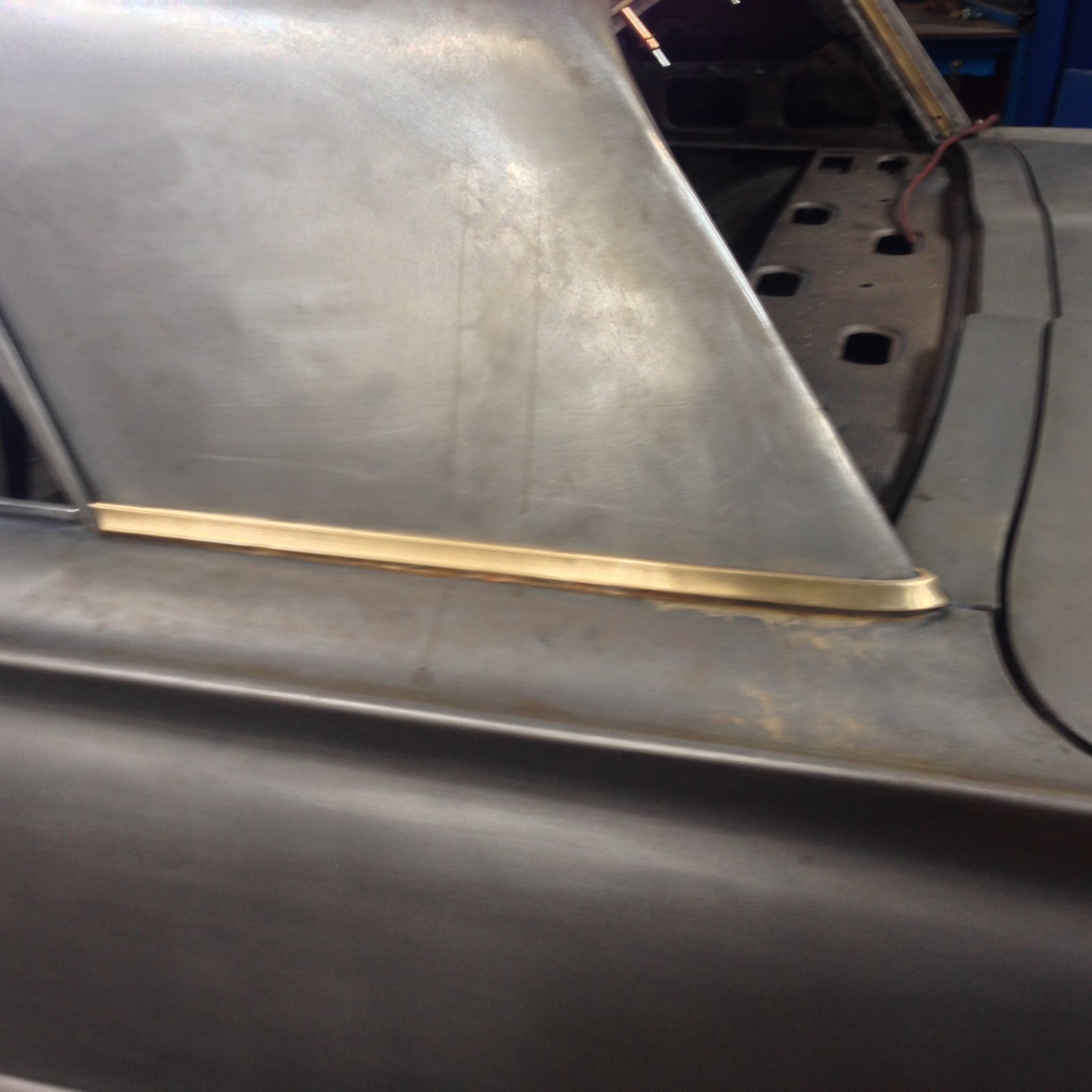

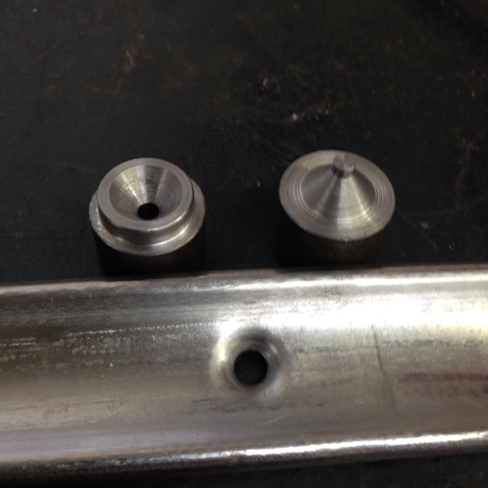

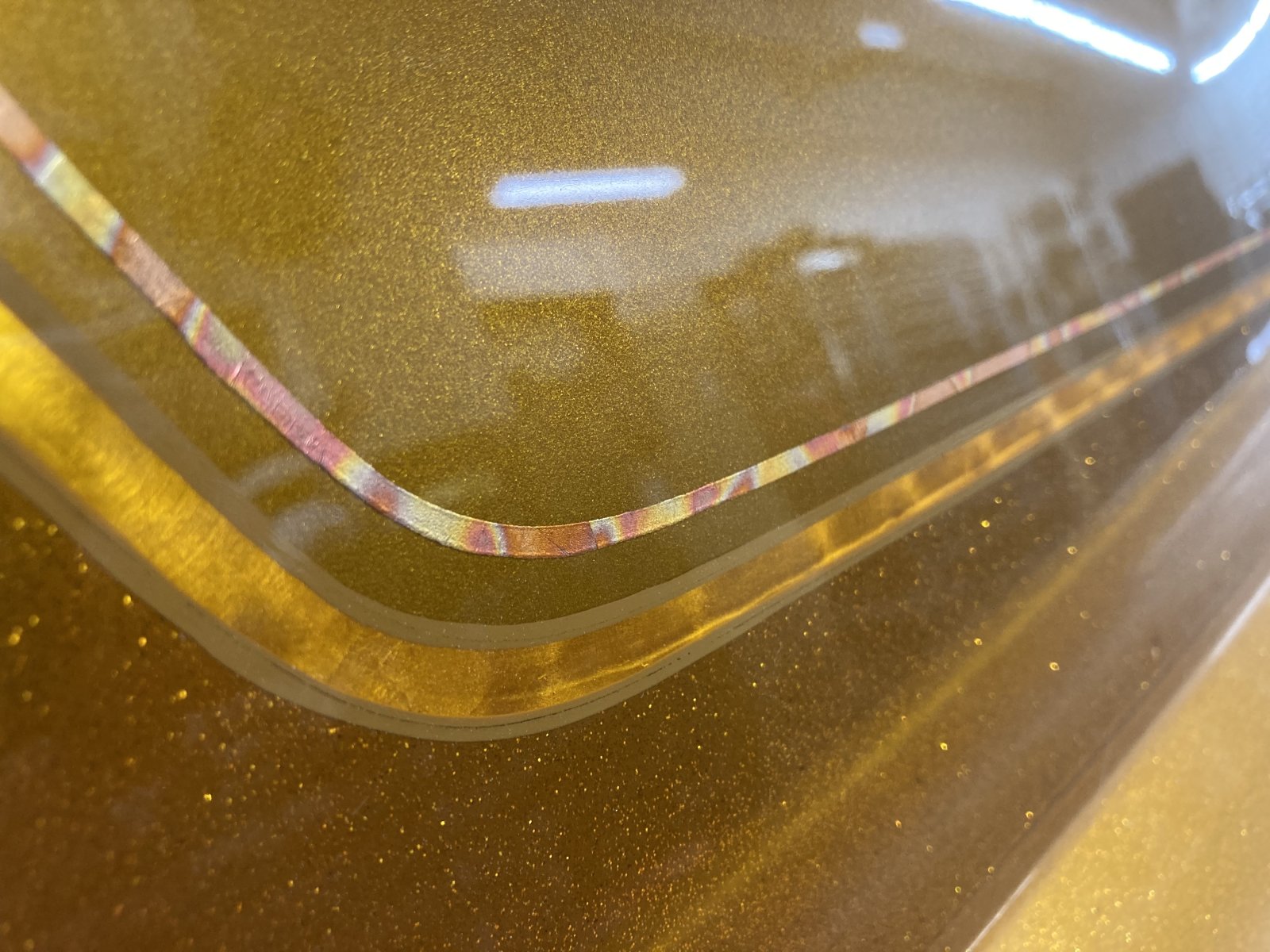

    One of the thing I did do for the car was the sail panel and rear window trim. The car has a mild chop, but the rear window has no chop and was laid forward. So I started with the rear window trim. I made some Pullmax dies to shape it out of stainless sheetmetal, and dies to make the dimples for the screws.

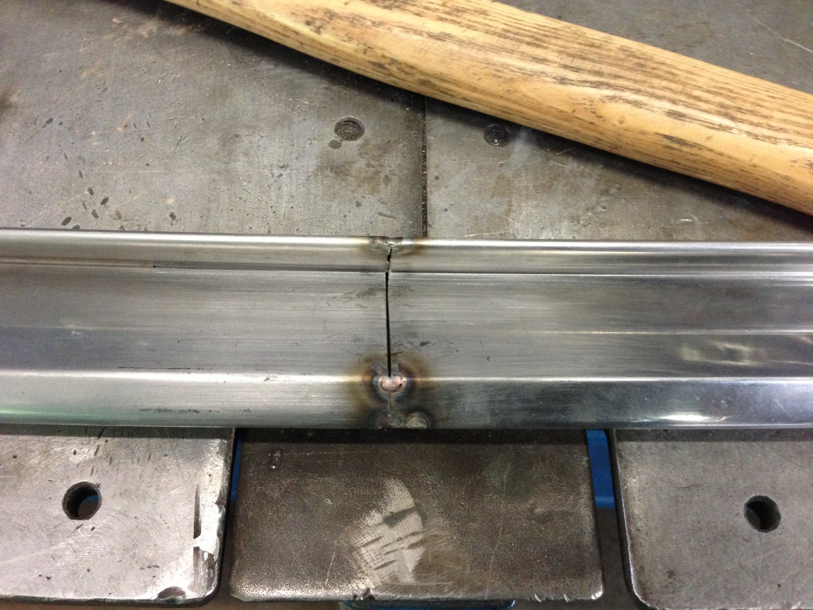

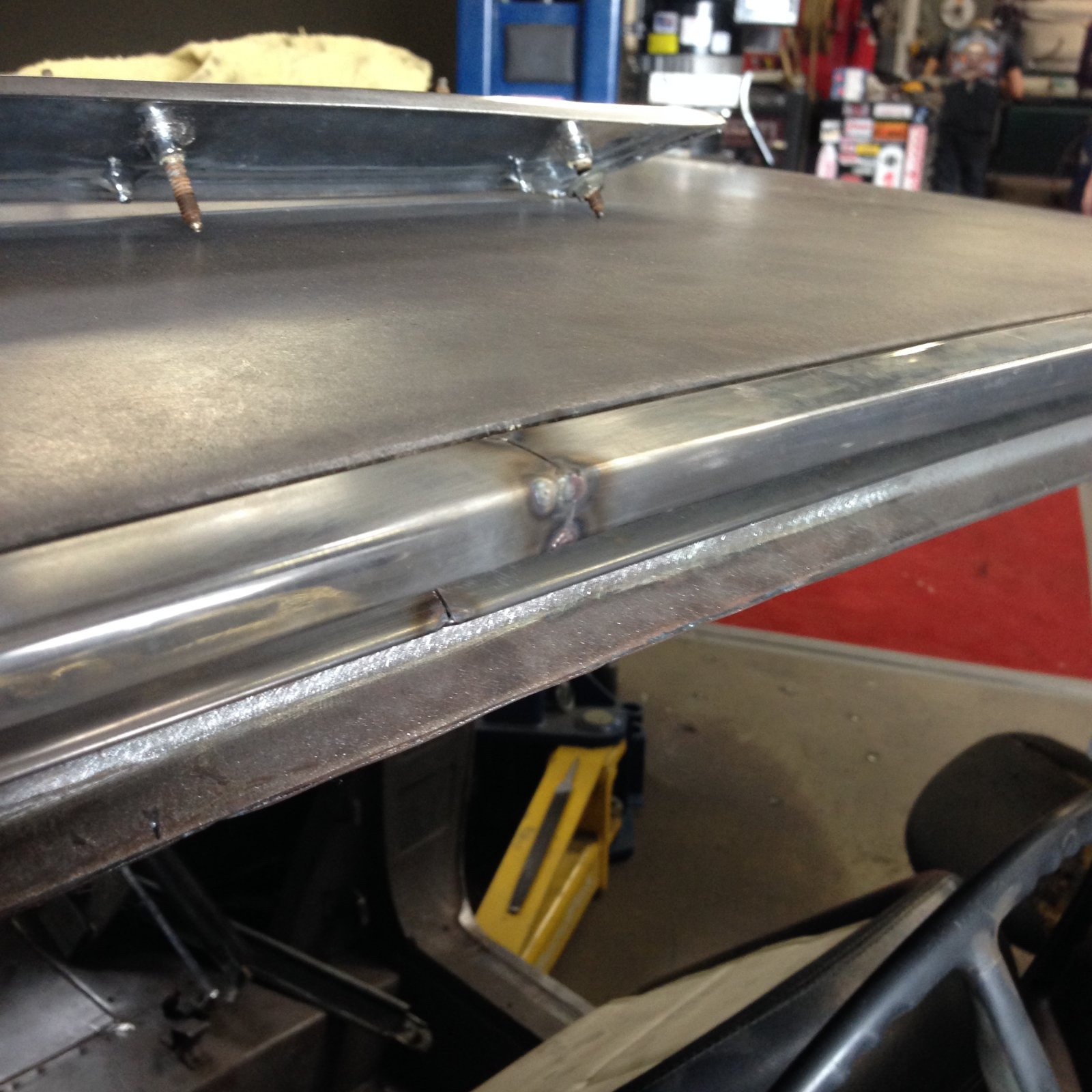

    Then I did the trim for the windsheild. When the car was chopped, we widened the roof to keep all the side windows in line, so the windshield trim needed to be widened. I had two sets of trim, so I was able to make a wider trim with just one weld rather than adding a piece in the middle
    Test fit
    And welded and finished

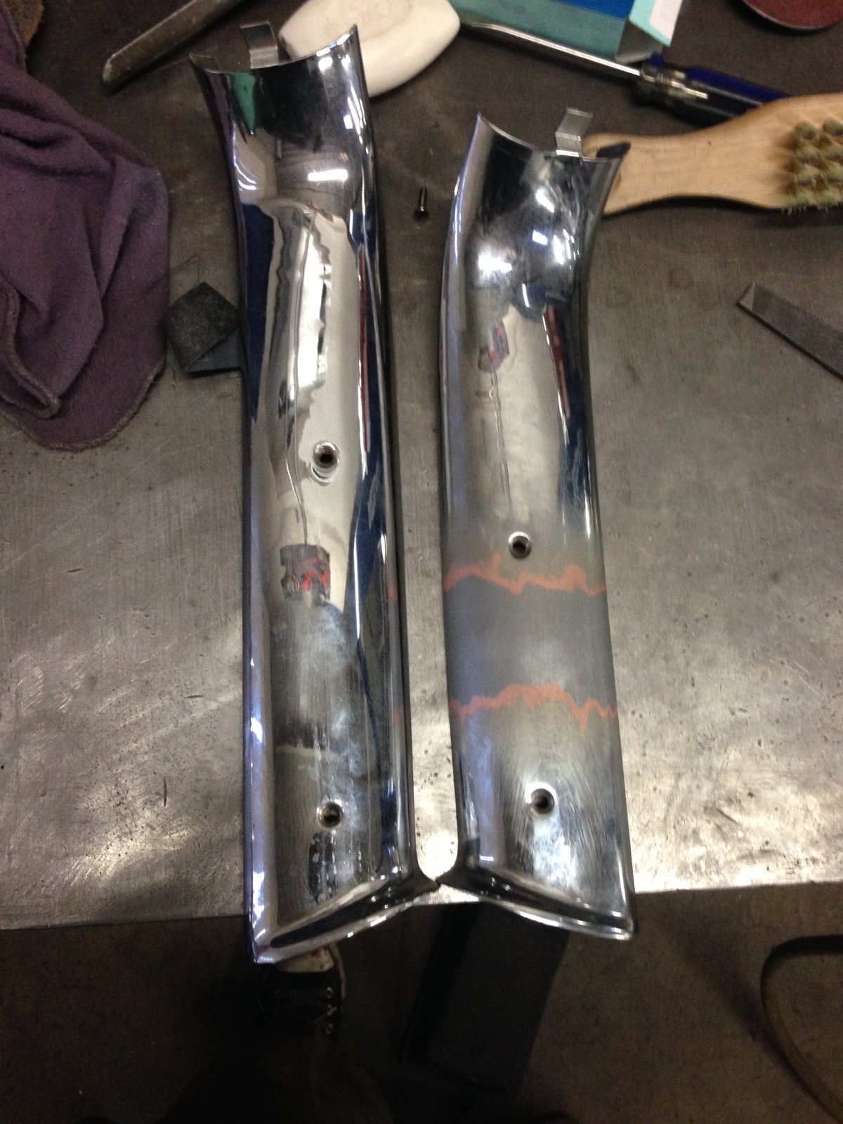

    I then chopped the A pillar garnish molding. Here is a comparison between stock and chopped.
    I had not completed the rear window trim before it was decided that we would instead make the rear trim out of br*** and then chrome it. This was nice because while the rear window trim was a bit challenging, the sail panel trim would have been much more difficult. It was still quite challenging to do it out of br***, and I'm happy with the results. I don't know if I would have been able to pull this off if we had stuck with stainless.

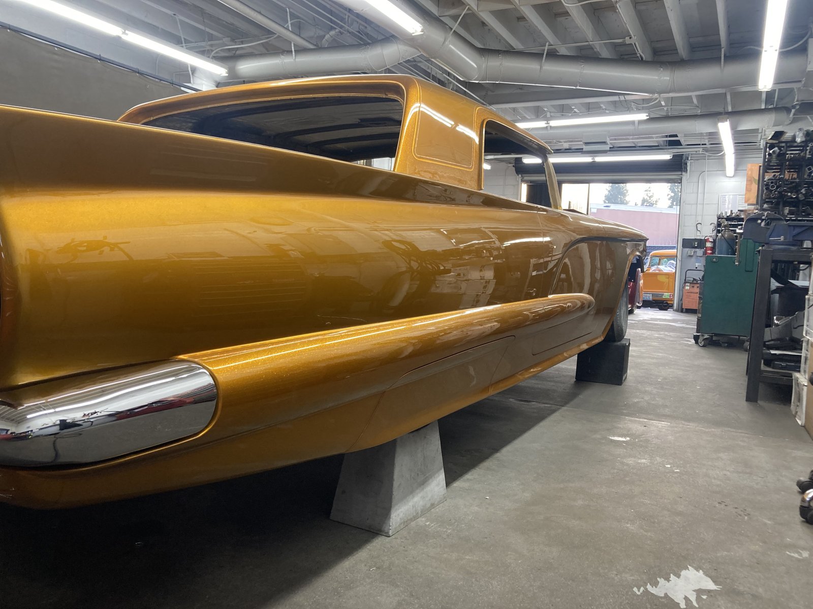

    Completed sheetmetal and trim work

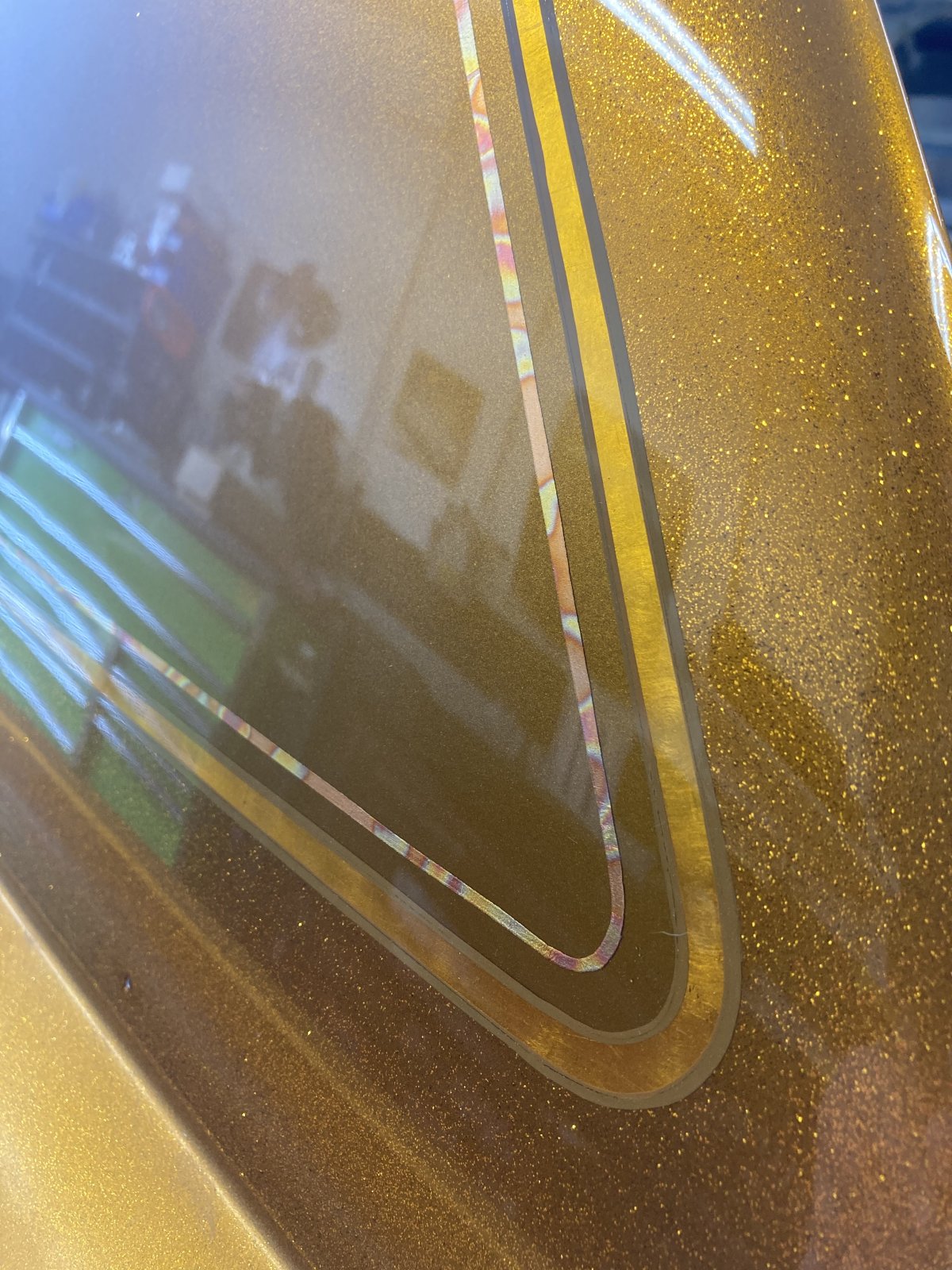

    A little paint detail
    Some skirt and rear bumper detail

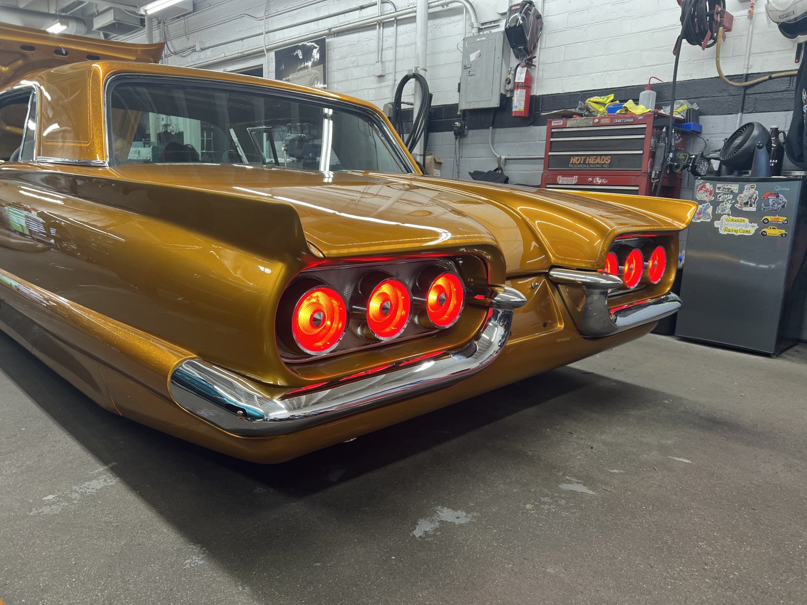

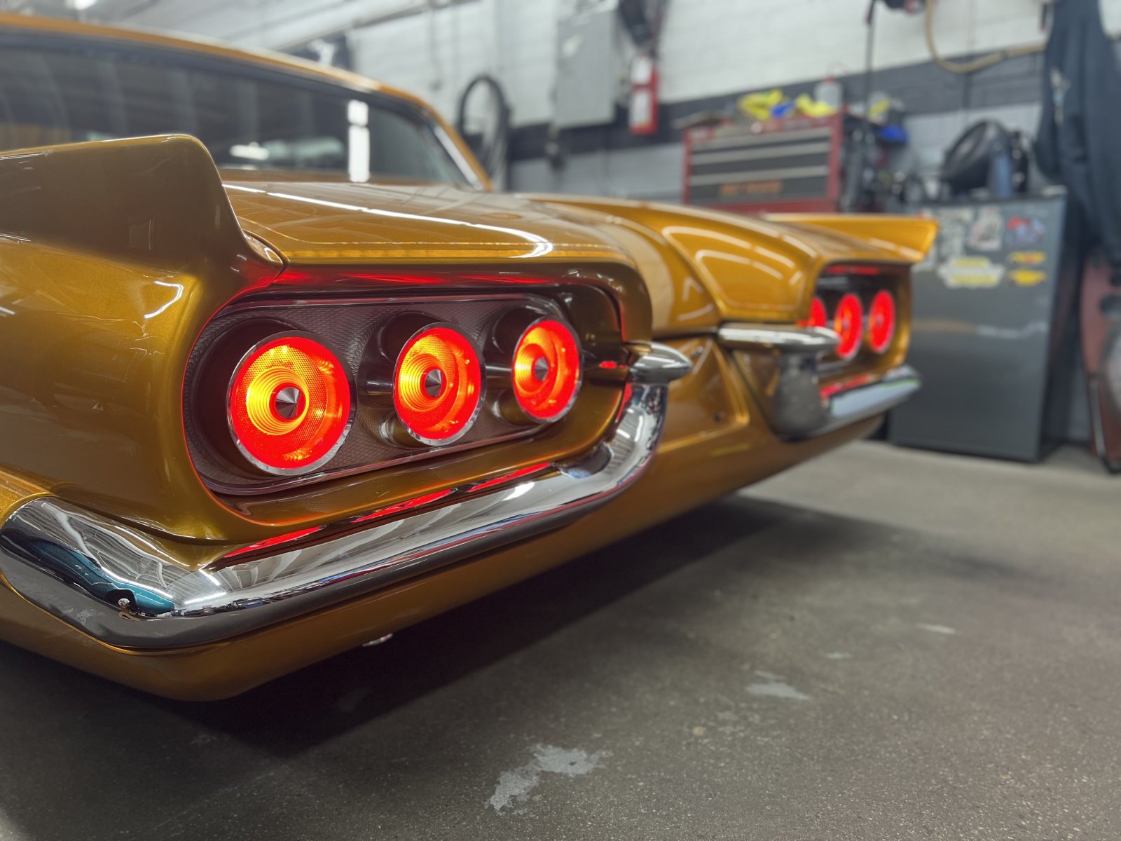

    Got the tail lights and bezels installed.

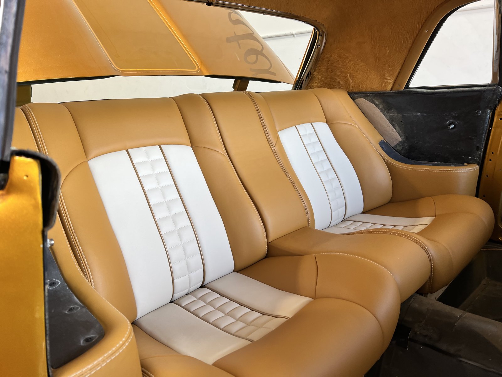

    And these are some shots before it went off to upholstery.
