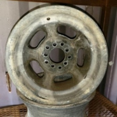

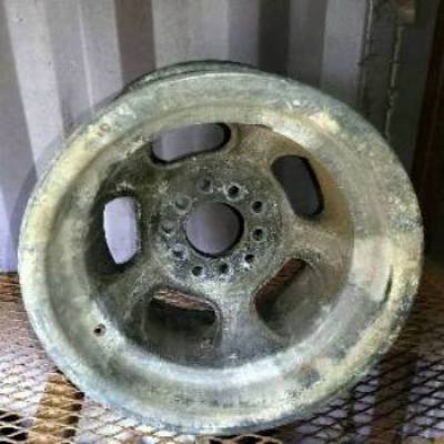

    For the rear wheels, I wanted 16X10 Halibrand Speedway Specials. I found these on FB that looked like **** and took a chance because I got a pretty good deal.
    They were soaked with Awsome cleaner and power washed. The paint on the center parts had helped protect them. Then put on a brake lathe and lips sanded. Next sand blasted to remove corrosion. Sanded again. The 5" B.C. holes I'm using were then spot faced and reamed.
    Then they were gl*** beaded to smooth everything out and to match the front wheels. There ended up being minimal pitting. I then put a heavy coat of Por 15 on the outside like the front to seal any porosity.
    Still the best looking back wheels ever made. Just need to darken up now.
