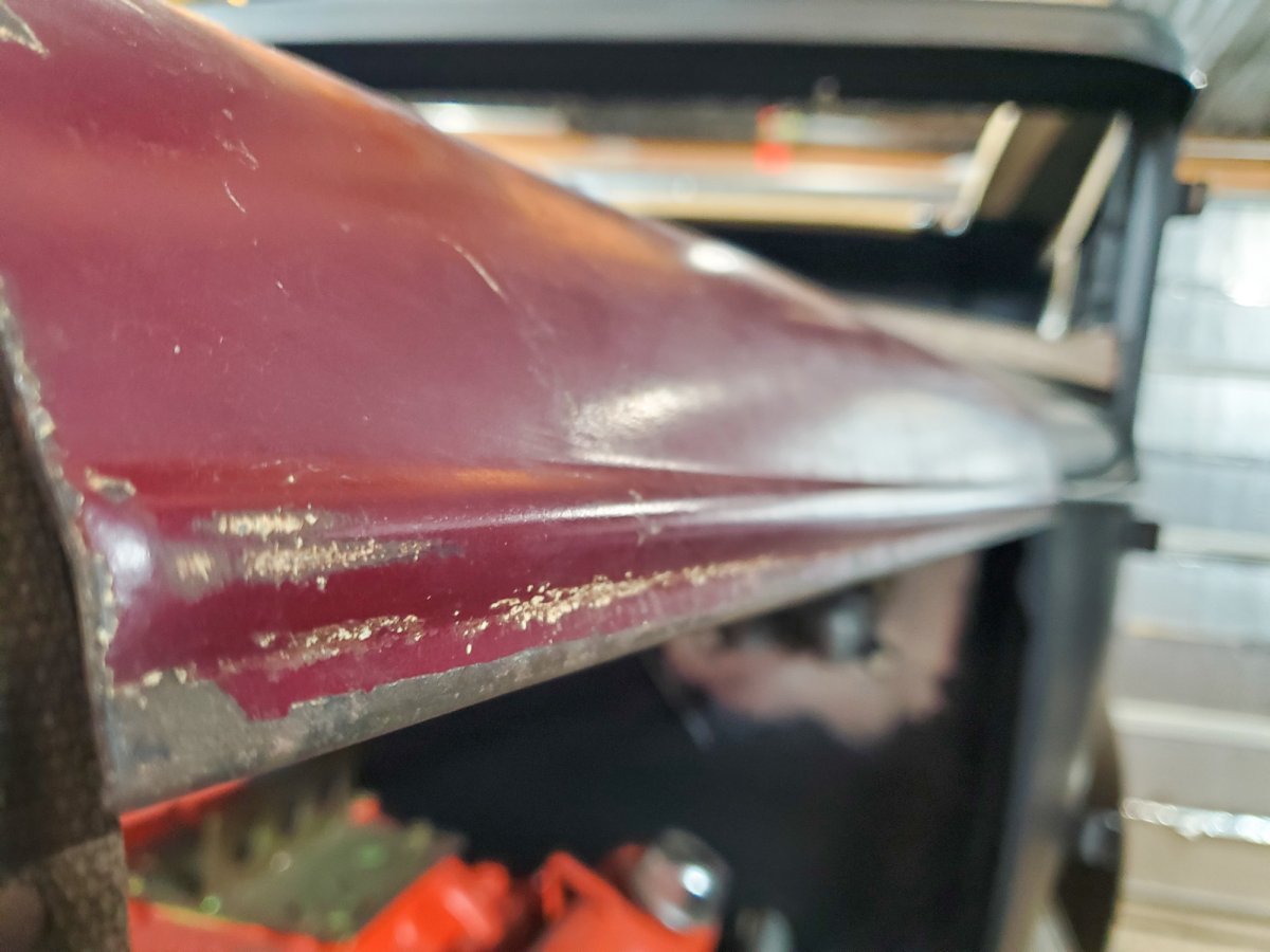

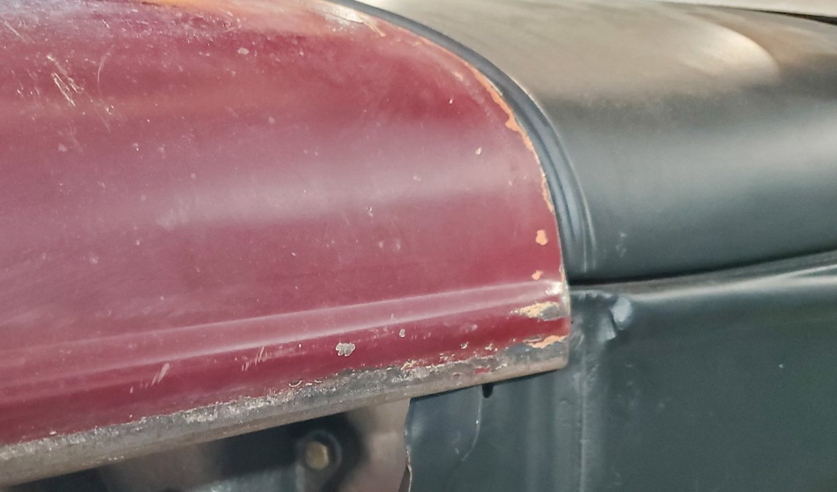

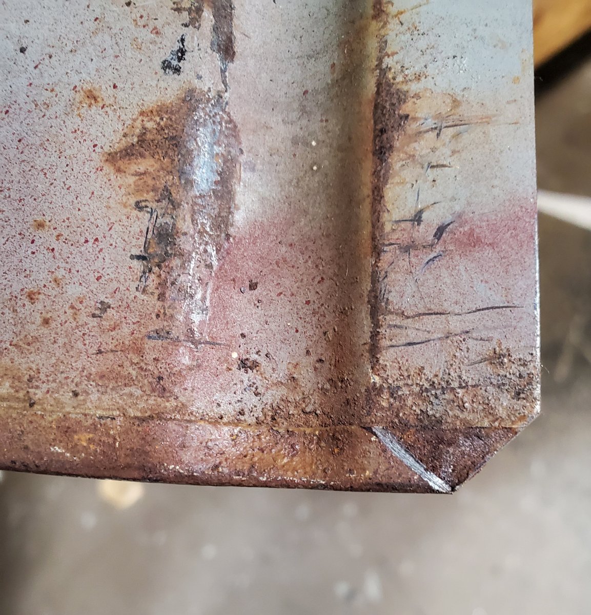

    Chopped Model A Hood Top:
    When I see Model A hoods with the sides removed, the lower portion below the bead ALWAYS catches my eye and not in a good way. They fixed that in 1932 as the hood sides go all the way up to the bead.
    This hood is the one that came with the car. It's in pretty decent shape (still needs a little TLC). I don't plan on running it 100% of the time. But, if it's going to get a hood, I knew I'd have to trim that piece off.
    The sheet metal shop that I use, a big old-school commercial outfit, their shear and brake were too big. They didn't want to wreck the hood. So, I had to find a Plan B. After a while of striking out with folks around, I figured I'd just handle it on my own. While I don't have a shear or brake or a bead roller with a tipping wheel, I still had tools to get the job done. It wouldn't be all that hard to cut the steel and with some clamps, some steel, and a hammer - I could get it sorted.
    Then, one night I shot Chris Davenport a text. I wanted to see what he thought. Could his brake get me close to the bead? We chatted on the phone (thank God for old-school folks who like to talk on the phone!) and he said, he thought he could pull the edge/lip of the brake off and it would get us close. Bingo - that's what I needed.
    Chris's shop is now located 75+ miles north of me but the drive is not all that much longer than driving to his old shop, which was closer but still an hour+ drive south with bottle-necked rush hour traffic.
    The first thing we did was cut the hinge loops and hammered them flat.
    We put some marks, and put the hood in from the back, eyed them up on the sheer and I stomped them off.
    We zipped off the original hem and nipped off the corners so there would be no overlap.
    Here's where I didn't snap any pics. Haha. We just got to work and BSing. Chris pulled off a section of that face/lip on the brake and we slid the hood in until the bead hit the brake's edge. We were able to get it close to a 90.
    That was plenty for me. I figure I could go home and hammer it over but we were catching up after a couple of years and Chris had this tool he wanted to try out to fold over the hem. It's a door skinning tool. It was still in the box and he hadn't used it yet.
    We hammered over the 90 a little bit and ran the tool over it and it ended up how you see it.
    The shadow makes the gap look more pronounced but a few minutes tapping it with the hammer and it will match the rest of the hems. Before I do that, I want to strip the hood.
    In the pics from the earlier post, it's hard to see the area under the bead. It's about a 1/4".

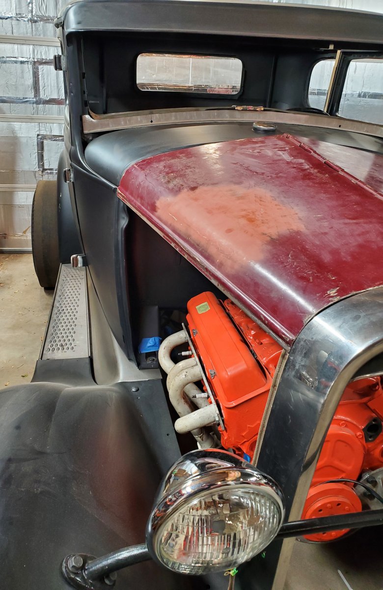

    Seeing the hood on in the garage wasn't cutting it. I needed to step back and see the whole thing.

    Don’t know why I stopped getting notifications on this. Man that’s looking killer!
    seeing it sit outside I can just imagine it replacing the green coupe in two lane black top or pulling in next to Milner at the pump.
    that things got at***ude for days

    looks fast, just sitting there...
    reversed A firewall lets the small block anything settle in nicely...
    I also like the trimmed lower, outer edge of the hood top...
    that 2" that hang down below the beltline is the thing i like least about a '30-'31...
