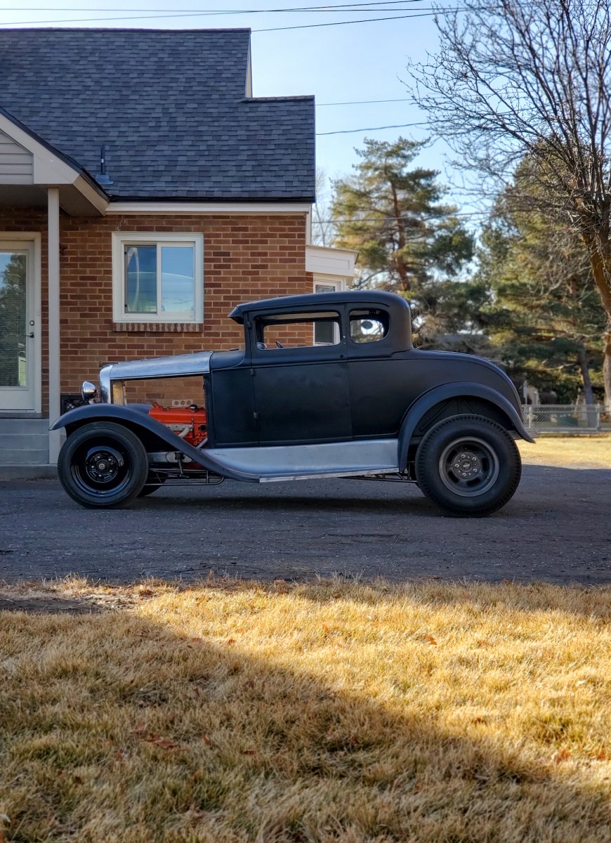

  9. -Brent-
    Joined: Nov 20, 2006
    Posts: 7,714
    -Brent-
    Thanks! It's hard to capture it in pics but once it a while you can really see it.

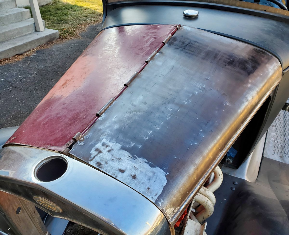

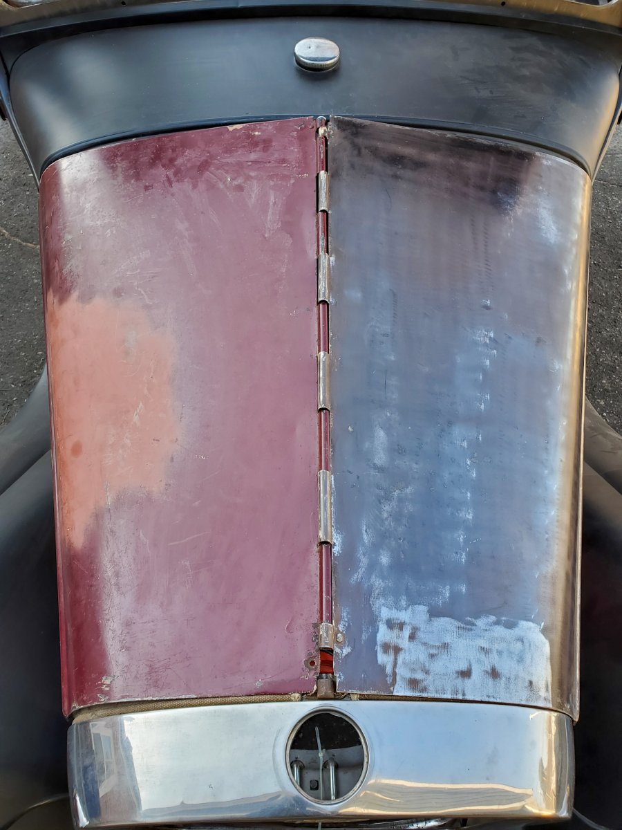

  15. -Brent-
    Posts: 7,714
    -Brent-
    Let me tell you, I'm not even inching along. I'm eighth-inching along. Haha.

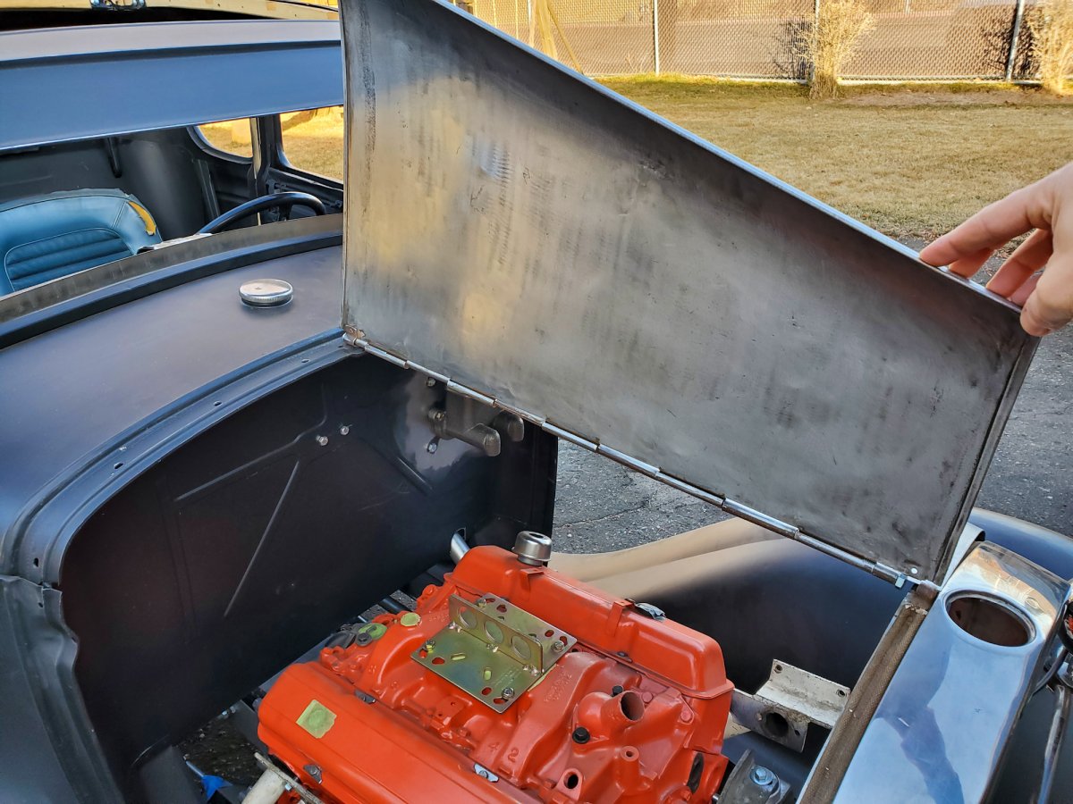

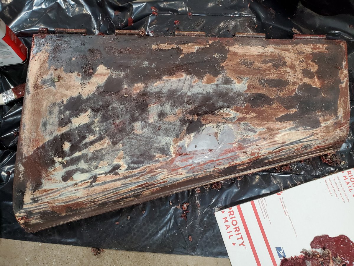

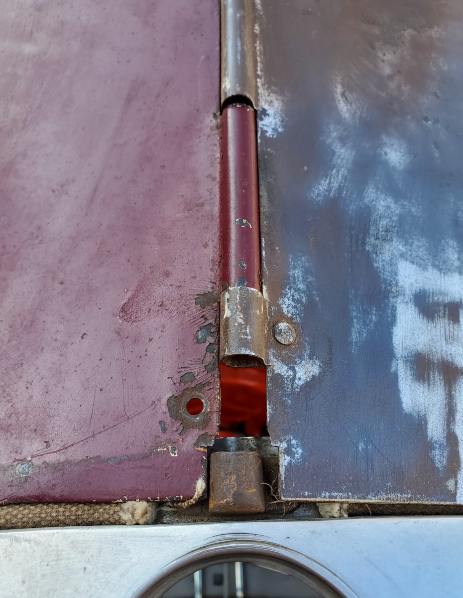

    Since the hood was trimmed I've been thinking about stripping the paint but I've sworn to myself that I need to get other things done (OT things) first. However, I found myself with an hour free and the shop was a workable temp, so... what the hell, right?
    Most of it was done with Aircraft Remover (the harsh stuff) and that brighter spot is a stripping disc, just to test it out. After I cleaned the hood and wiped it down with acetone, I went over it with a fine scotch bright disc.
    So, not all that much of an update, especially since it's only partially done. :rolleyes:
    I just had to see some progress. Now, I really won't be able to let it sit like this!

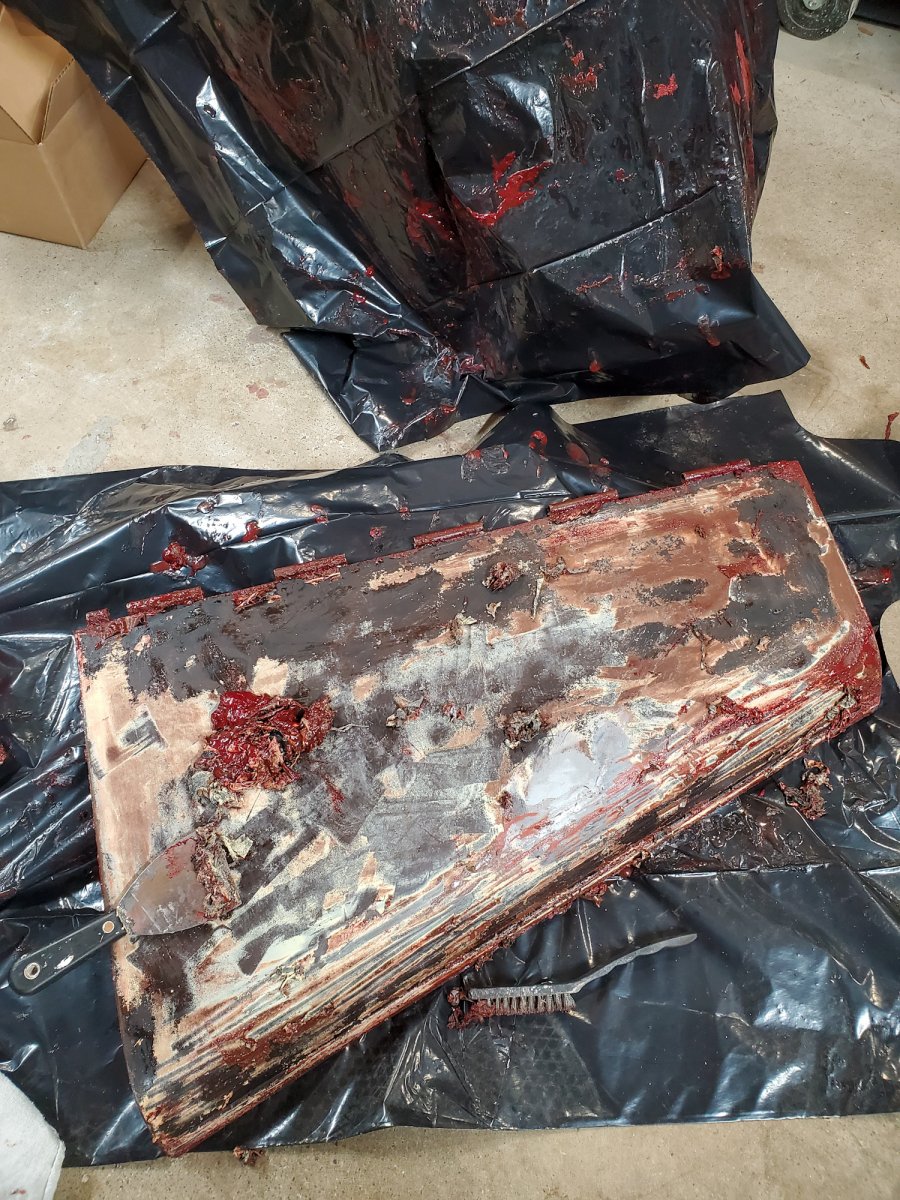

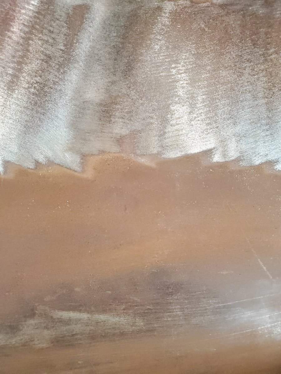

    Stripping the Hood Top:
    I'll get this out straight away, I know very little about bodywork. It's something I've farmed out in the past but I'd like to learn and take on painting this car. The more I read/watch, the more I'm interested in it.
    Last night, I got after stripping the other side of the hood top (the bottom side still needs to be stripped on both sides).
    What I learned was that beneath the layers of paint was a layer of surface rust. I was surprised to see that it sat there as complete as each layer of paint. I naively assumed that under layers of paint/primer there'd be some decent/clean metal. But, this slow approach to stripping (rather than having it blasted as I did on the body) is pretty informative.
    After scraping the second application of the Aircraft Remover I could see the metal beneath the cream color (Bronson yellow).
    After it was stripped and cleaned I wanted to see it bare.
    Still a bit to go but it's much better.

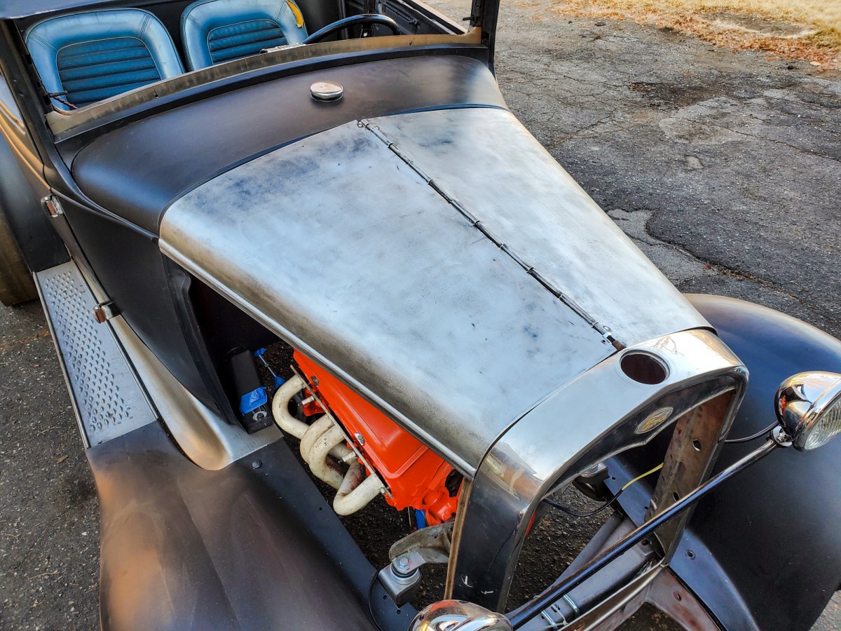

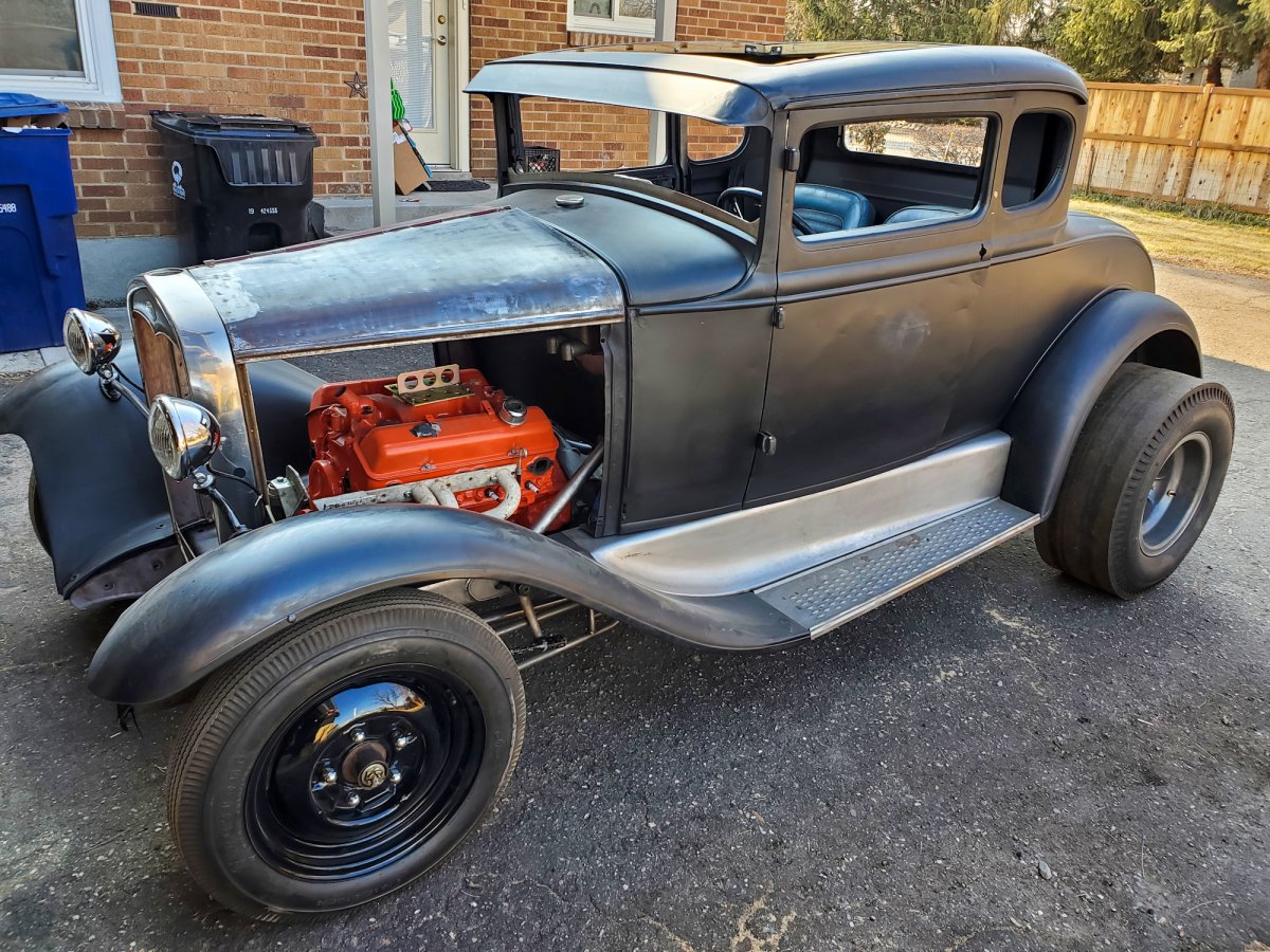

    A Couple More Hours on the Hood:
    First time I've ever metalfinished anything. It was fun, relaxing even, except for the wire wheel biting into the edge and coming after me... that could've been bad.
    I cranked up the music, put in some earplugs, and went to work.
    I used a stripping disc, a wire wheel for any pits or dings, some 80 grit and then 120 grit. There is still a little bit in hard-to-get areas that a wire brush would probably handle. For now, I'm pretty happy,
    The above pic is from last night. I rolled it outside, this morning, while I was pulling some tools and stuff out of the garage. I love being able to stand back and look at it or walk around it and see it from other angles.
    Stripped and Metalfinished Model A Hood.jpg Modified Stock Model A Ford Hood 2.jpg Bottom Side Stripped.jpg Modified Stock Model A Ford Hood 3.jpg
    I'm starting to really like it with a hood.
