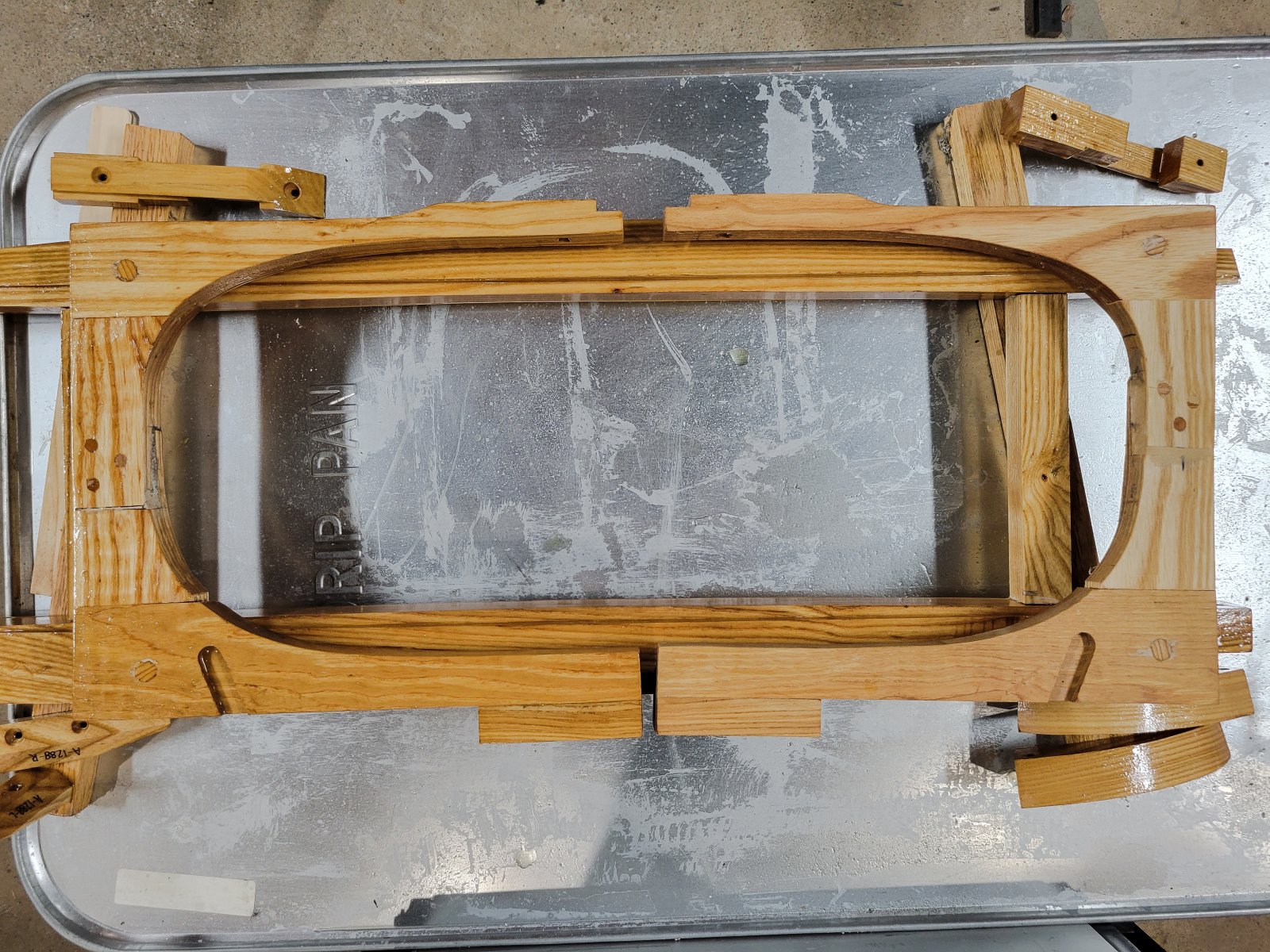

    I started by ordering some pure tung oil. I couldn't find any available, locally, certainly not at the big box stores. Those stores, I'v learned, do have products called "Tung Oil" but it doesn't much resemble the pure stuff, there are driers and other chemicals. The amount of actual tung oil is low.
    Everything was already prepped, so I mixed the first coat 50/50. Tung oil is thick and it dries slowly. To get it to penetrate well on the first coat, it's recommended to thin it. There are a few options folks use, I decided to try turpentine, which is also something not as commonly found these days. Home Depot didn't have it but the hardware store did.
    I mixed a half-cup of each and I ***umed that might have been too much but the wood soaked it right up. Something I saw repeatedly as I was reading/watching/learning about the stuff is that you repeatedly apply the mixture as the wood absorbs it. That it's not so much as coats as it is one longer application.
    I continued to apply until the wood remained shiny and wet for a period of time. Once there, I let it sit for 30 minutes and touched up here and there (especially the end grain). It's crazy how much it soaked up.
    I wiped off whatever residue was left and that was the end of the first coat.
    I check it this morning and there wasn't all that much seeping but it wasn't dry to the touch. I know this because I touched a piece of wood and instantly touched my nose and I could smell turpentine for half the day.:D But, boy-oh-boy did it look pretty. Especially the pieces above the doors, they had this really nice brownish honey color.
    Tung oil dries way slow, the drip pan (it's new, I figured I could use it afterward) is still wet more than 24 hours later. I read where some people's projects took more than 10 days to dry!
    Anyway, I cracked a window in the shop and went about my day.
    Also, side note, this stuff is flammable, so take proper care of your rags and materials. They can spontaneously combust. My friend's parents' business burned down to the slab due to improperly stored chemical rags. Even @Ryan had a scary situation in his shop.
    When I came back to the shop the wood felt much drier.
    Some woodworkers work their way to straight pure tung oil but mixing less thinner into the tung oil, something like 50/50, 70/30, 80/20 and then straight. Others start with 50/50 and then move onto the straight tung oil. I'm not finishing floors or picture frames, here, hell it isn't even going to be seen or thought of once there's an interior. So, we're going straight next.
    First, I went over everything with 0000 steel wool. It was recommended to lightly sand in between coats. Speaking of coats, that's one of the downsides of this process. It needs a few coats/applications. I've got a few things that I'm waiting on, which leaves me time to mess around with this stuff.
    I poured a half cup into my measuring cup and used nearly all of it. There was probably a tables**** left.
    Second Coat Pure Tung Oil.jpg Second Coat Pure Tung Oil Model A Ford Wood Kit.jpg Second Coat Interior Wood.jpg
    Here's what's interesting. After it's applied, you let it sit for 30 mins or so. While waiting, I went around again and touched up little spots, nowhere near as much as last night but the end-grain still soaked it up. It still looked nearly as wet as when I first brushed it on but there wasn't much on the towel afterward - hardly anything. I guess I'm easily impressed. Hahaha.
    After I had sanded/prepped the wood for sealing, I wrote a little blessing that will be hidden away eventually. This is something we did back when I was framing when I was a kid and it just stuck with me. I still sneak blessings into every build, remodel or renovation project.
    Here it is after being wiped down after the second application. It has a little deeper color. I'm eager to see what it looks like tomorrow.

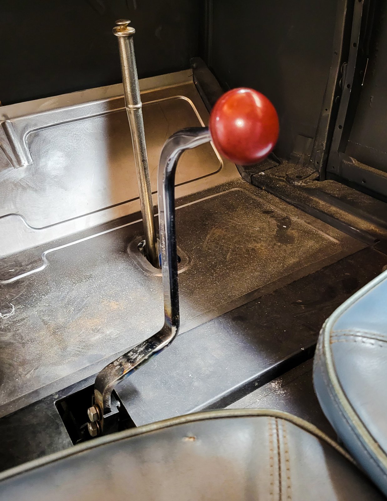

    Wood Sealing Continued and Bending an Offset into a HURST Shifter Stick:

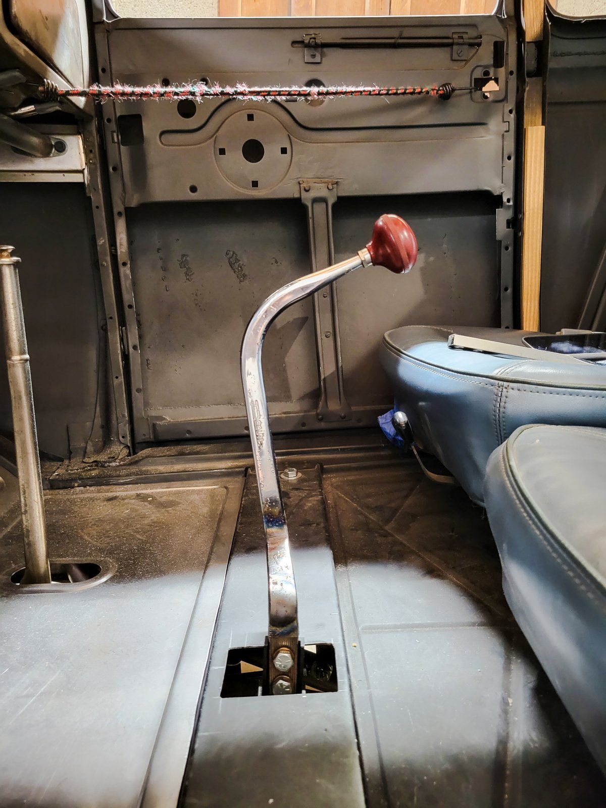

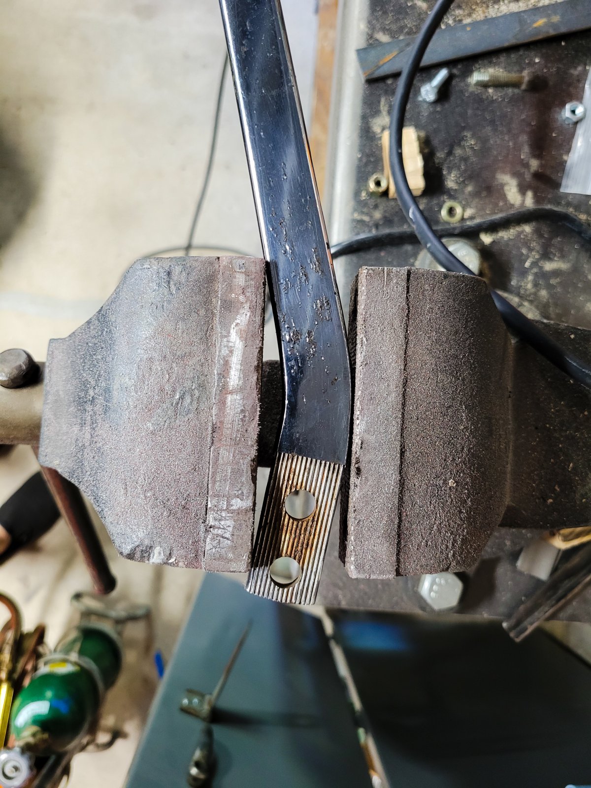

    I picked up this random Hurst stick, locally, for a couple bucks and it was long enough that I thought I could make an offset shifter stick for some practice.
    The plan is to use my diamond shifter stick but before I go about making the offset for it, I wanted to figure out where and how high to make it all.
    I probably won't ever use these two but I'd rather learn with these. Here it is stock:
    Unbolted it an put it in the vise:
    Heated and applied pressure:
    Then I just winged it. I made a couple marks, tried making this one a little different here and there compared to the other stick I have.
    It came out decent. This offset fits me better but I want to have my wife sit in here, too, and see how much this interfered. The stick could be brought over a 1/2"

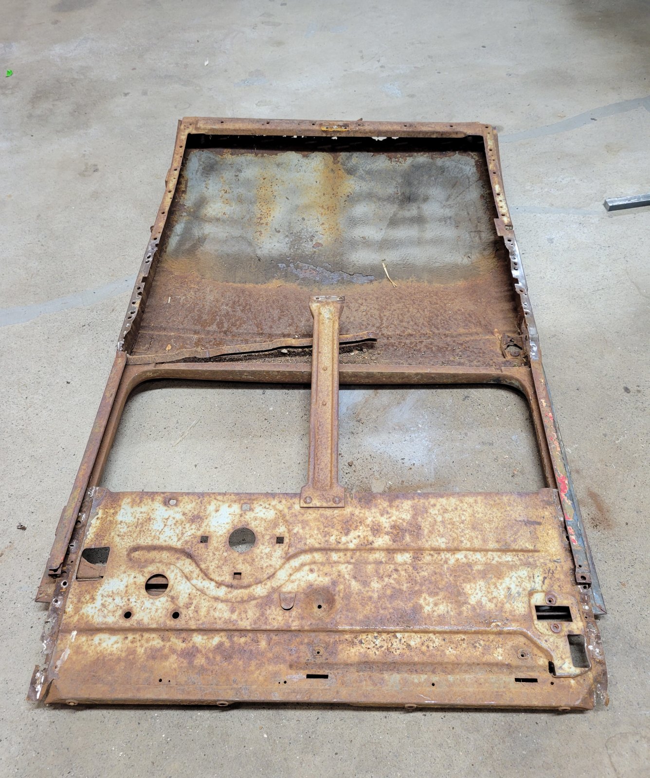

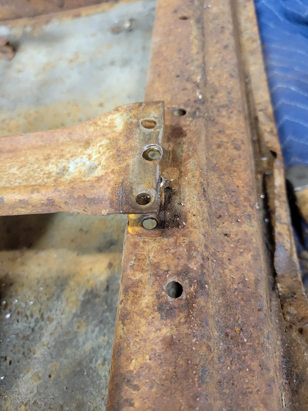

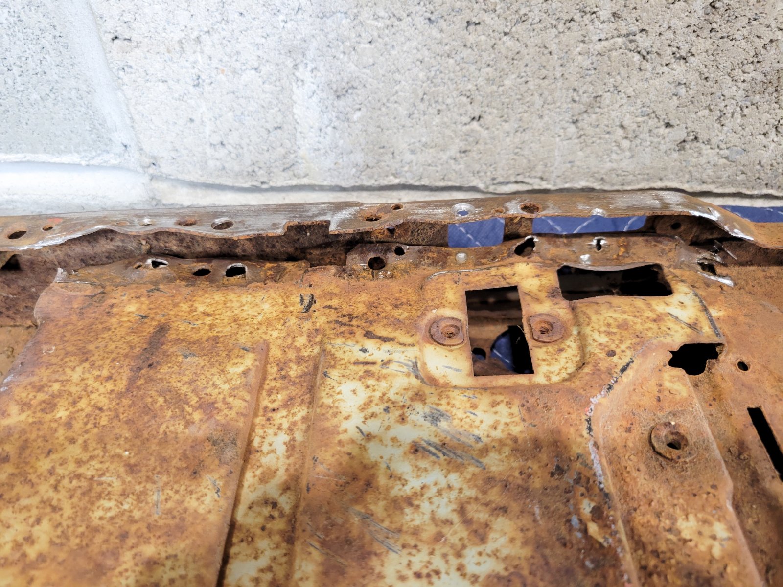

    The inner panel of my driver's door has issues. It's bent, has cracks and the guys who put it in sealer ground right through the metal in certain areas.
    I had looked for an inner section for a while and ended up finding a worn-out A coupe door to pull the section from. It's crusty but I think it will clean up well.
    This is something I've never done, which is exciting. I'm glad to have done this one first, it was good practice for the door on the coupe.
    The first side. Most of this hammered back straight.
    Once I got both sides done with minimal damage, I tapped it out with a dead-blow hammer.
    The worst of the panel, which really isn't all that bad. It needs some broken screws removed, a couple cracks fixed, and a little more hammer/dolly work. I'm going to sand blast it and figure the best way to get this panel replaced.

    -Brent-
    Thank you, I truly appreciate that.
    I'm sitting in the coupe as I type this. I just put a couple hours in on it, tedious/fun stuff.
    I remember the old days of the HAMB when some of the legends of this place took the time to post up details in threads that were so helpful.
    So, while I'm pretty much a hack, personally, I do try my best after a lot of thought.
    What's nuts to me is that there's still stuff that we haven't gone into depth/detail around here. So, if I stumble on it (usually when I can't find amswers/pics) I try to post it up... and that takes time, haha. There's been a few nights where I stayed up late for an update.
    Maybe it will help someone out, someday? Or maybe my kids will look me up to see just what I was doing all those nights in the shop when I came in with dirty hands, smelling like "hot rod" to tuck them in.
