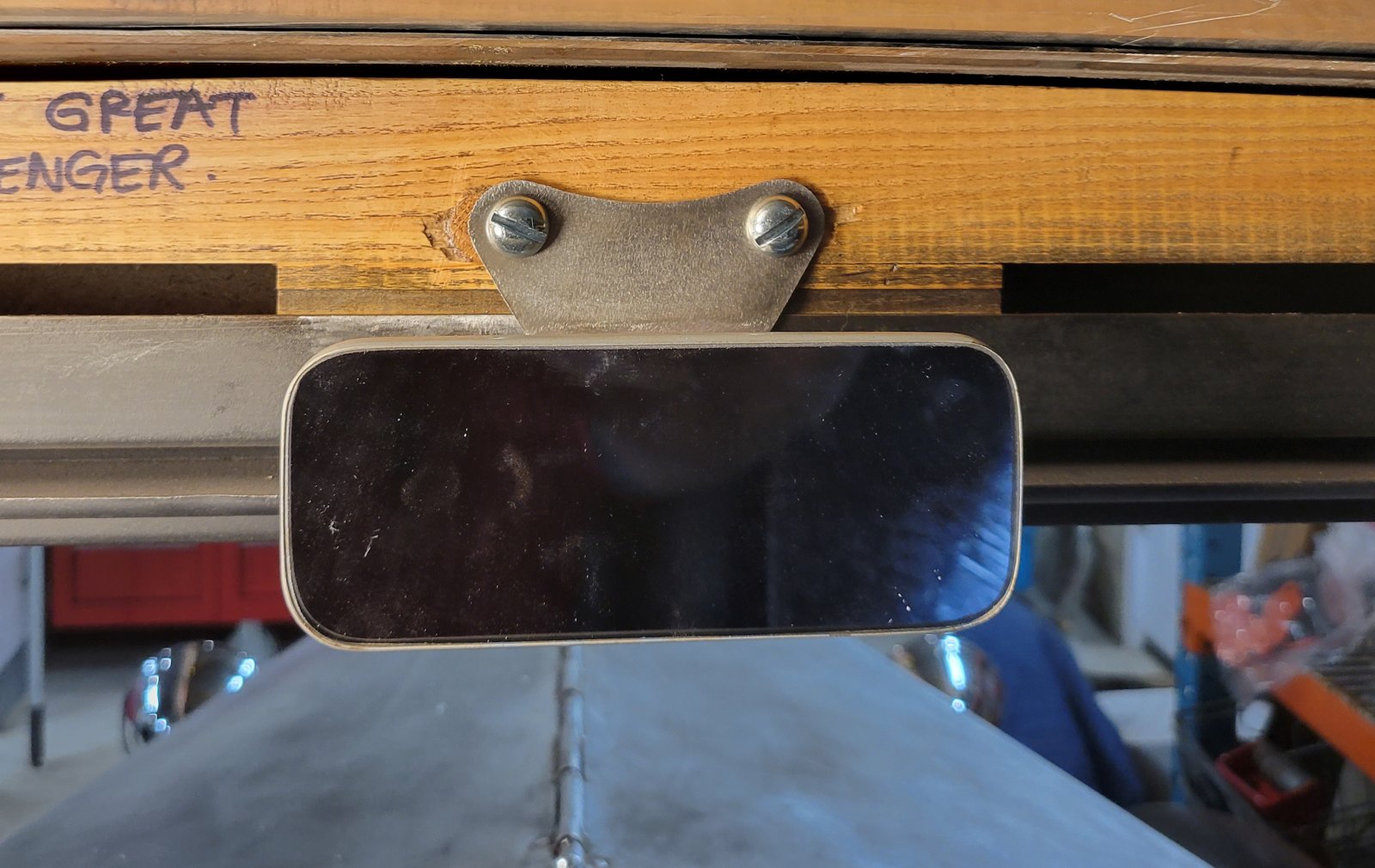

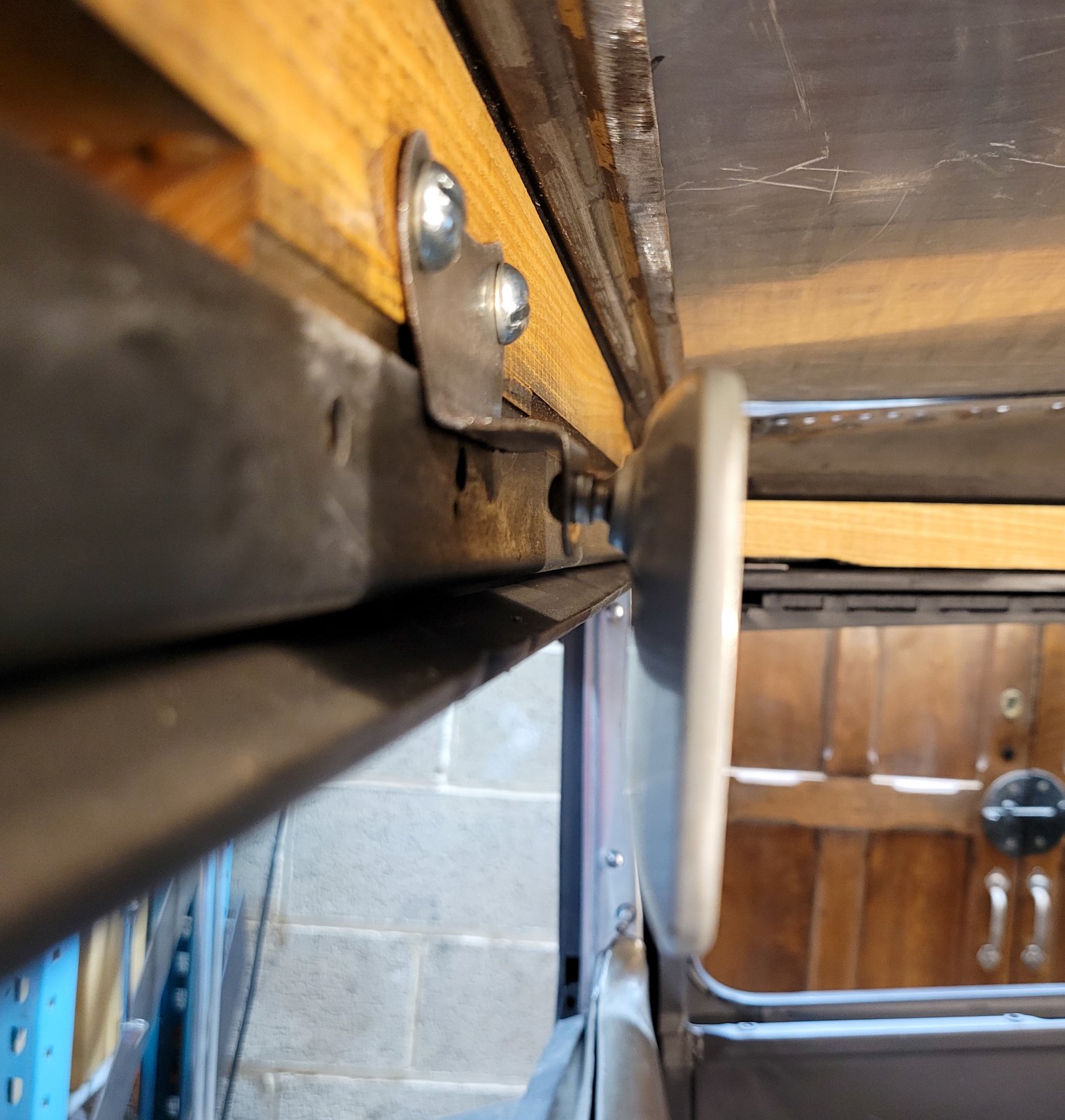

    Mirror Mounted in Model A Wood Header:
    I started this mirror project a few days after I completed the wood. Bad move. Long story short, the wood was too soft when I went to put the threaded inserts in and I needed to do some repairs.
    The tung oil did indeed penetrate and soften the wood. When I inserted the 1/4-20 brass inserts the threads bit and lifted the softer wood right out. I made some repairs and bumped up the size of the inserts. It's an ugly fix but it won't be seen (someday) when there is an interior. It happens...

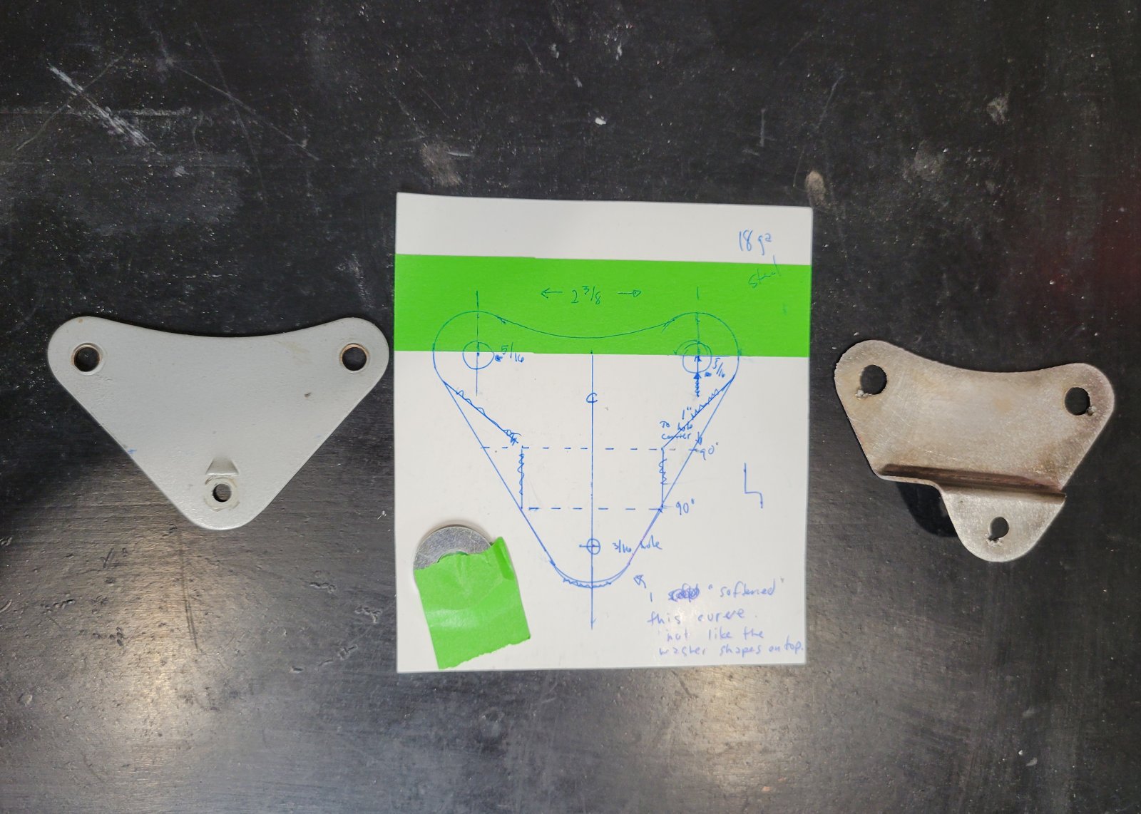

    My neat old mirror wasn't going to work with the bracket it came with because there's a sheetmetal lip. Even with the header covered with an upholstered panel it would still need to be bumped out. Plus, now I messed up the hole width, so I had to make something.
    I made a template and sent it off to my pal, Carl, and he cut this out of some stainless I had. The stainless was for some other projects, which we'll see later. I wanted the shape to look similar to the original bracket, something that looked vintage.
    A few days later, here it is:

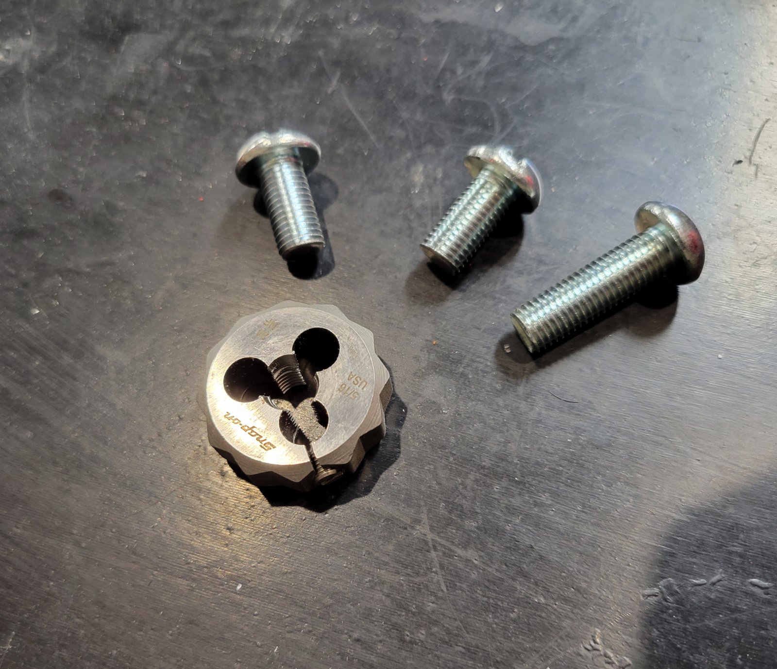

    I had to shorten some screws.

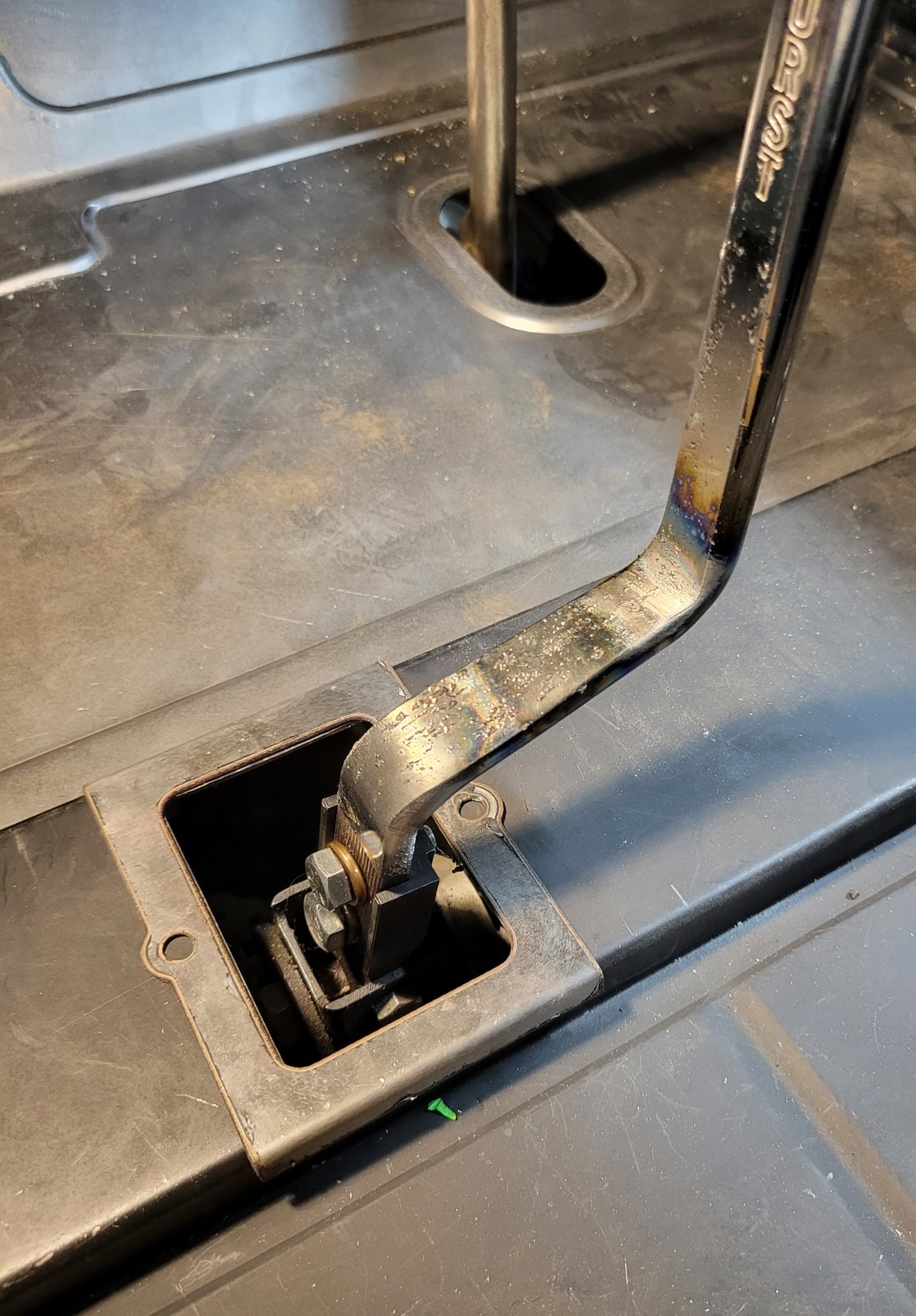

    This shifter boot trim came out kind-of neat. I am going to have a boot sewn when it's time, something simple.

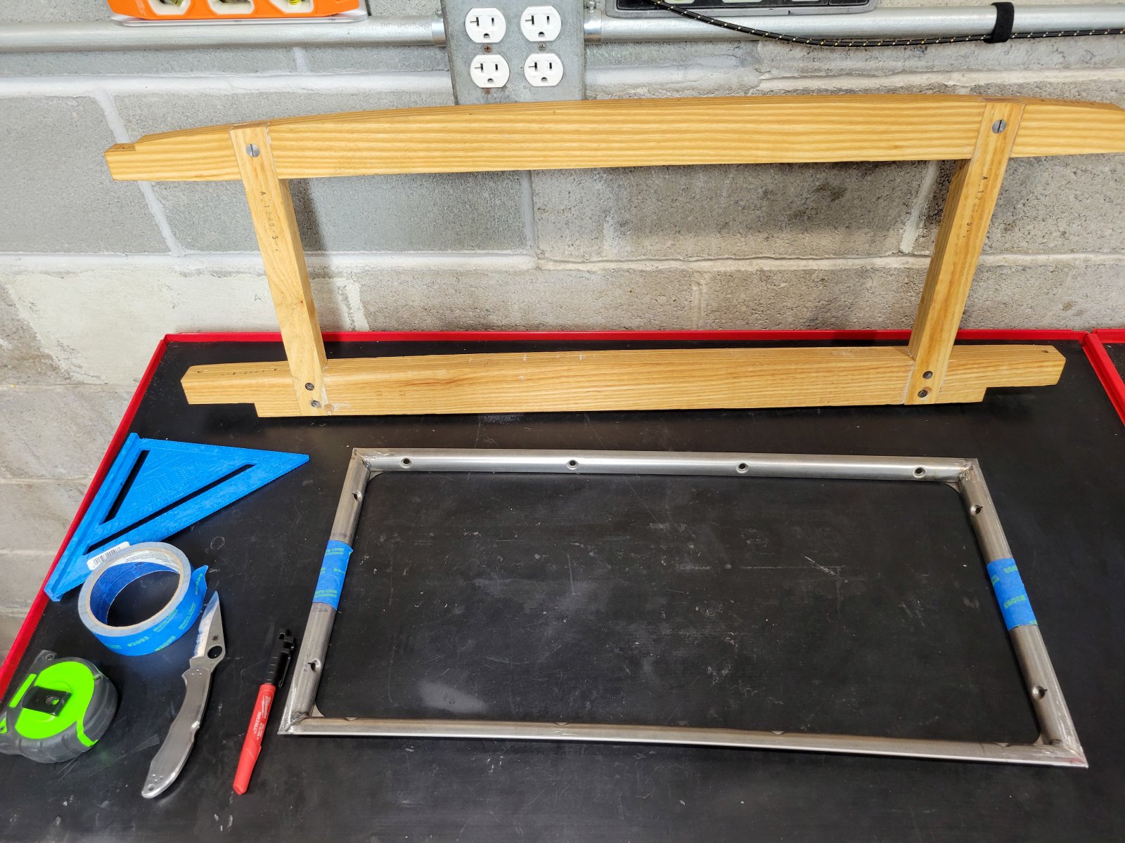

    I could have sworn the rear window was only chopped 3" and I assumed that the wood and the garnish would both have 3" taken from them, too. No, each one had some different amount taken out of it. I'm going to continue telling people I only took 3" out of the rear window, but I can't remember anymore. And these parts certainly aren't proof, hahaha.

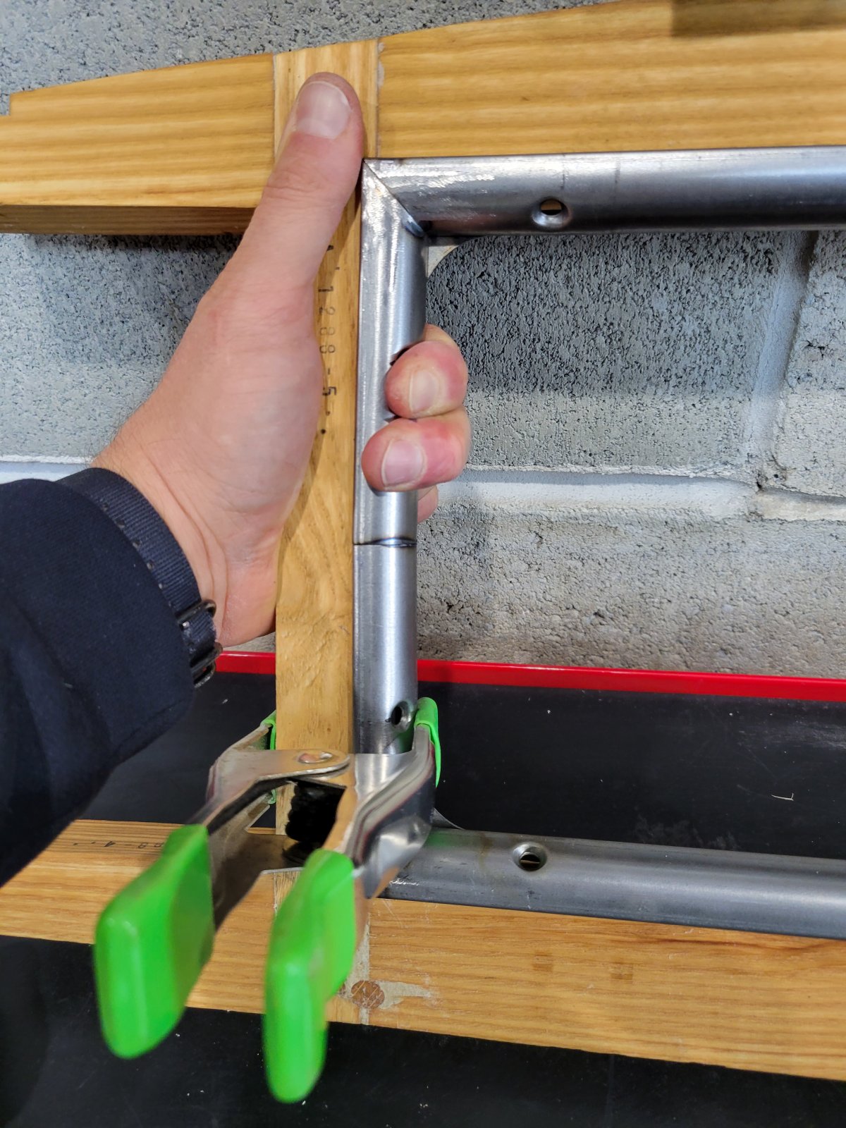

    I found center on either side, made some marks and taped off the portion to be removed.
    Measure twice came into play, here. You can see the marker that was wiped away. Haha. Also, a little tip for anyone who makes a mistake with sharpie on hard surfaces. Mark on your mess-up with fresh Sharpie and quickly wipe off. I do it often. I like to remove any marks like that to avoid confusion/mistakes.
    As soon as I cut the frame on the band saw, the frame sprung out, out of square.

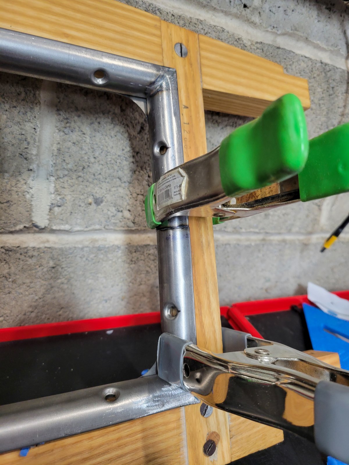

    Some clamps helped me mock up. I used a grinding wheel to square the cuts and to get the fit tighter.
    My pal, Brian, zapped the frame together and also, heated a corner or two to get the frame back into square.
    Tonight, I filed down the welds and gently wend over it with a Roloc. After that, I blended it with the sander.
    One side came out perfectly and the other is decent and will likely have a little wave in it when it's chromed. Which is probably perfect considering the original quarter window garnish has character, as well.

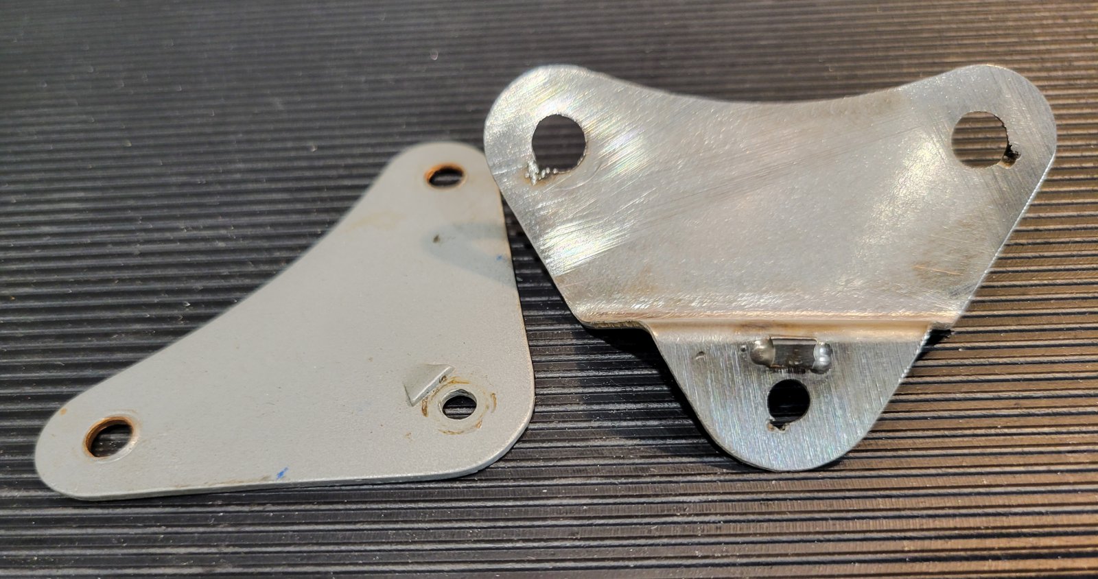

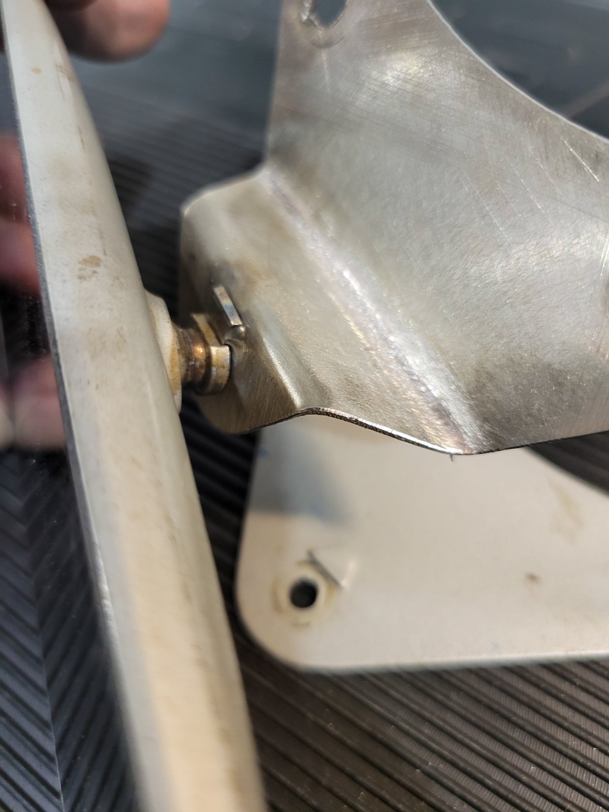

    I'm a sucker for little details.

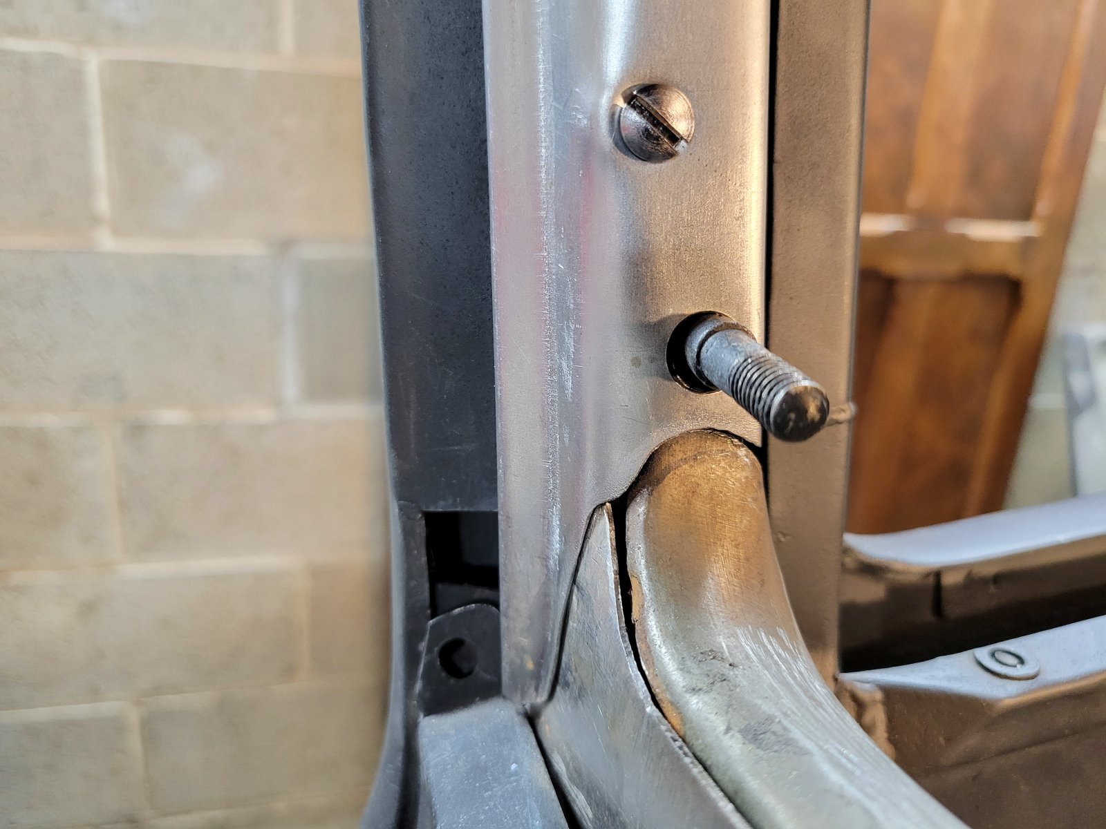

    The little "bump" or "stop" that's pressed into the original bracket keeps the mirrors from rotating on the painted steel. I wanted to preserve that so the mirror worked/adjusted/held the way it should.
    This little piece is smaller than a Tic-Tac.
    And with the mirror fastened.

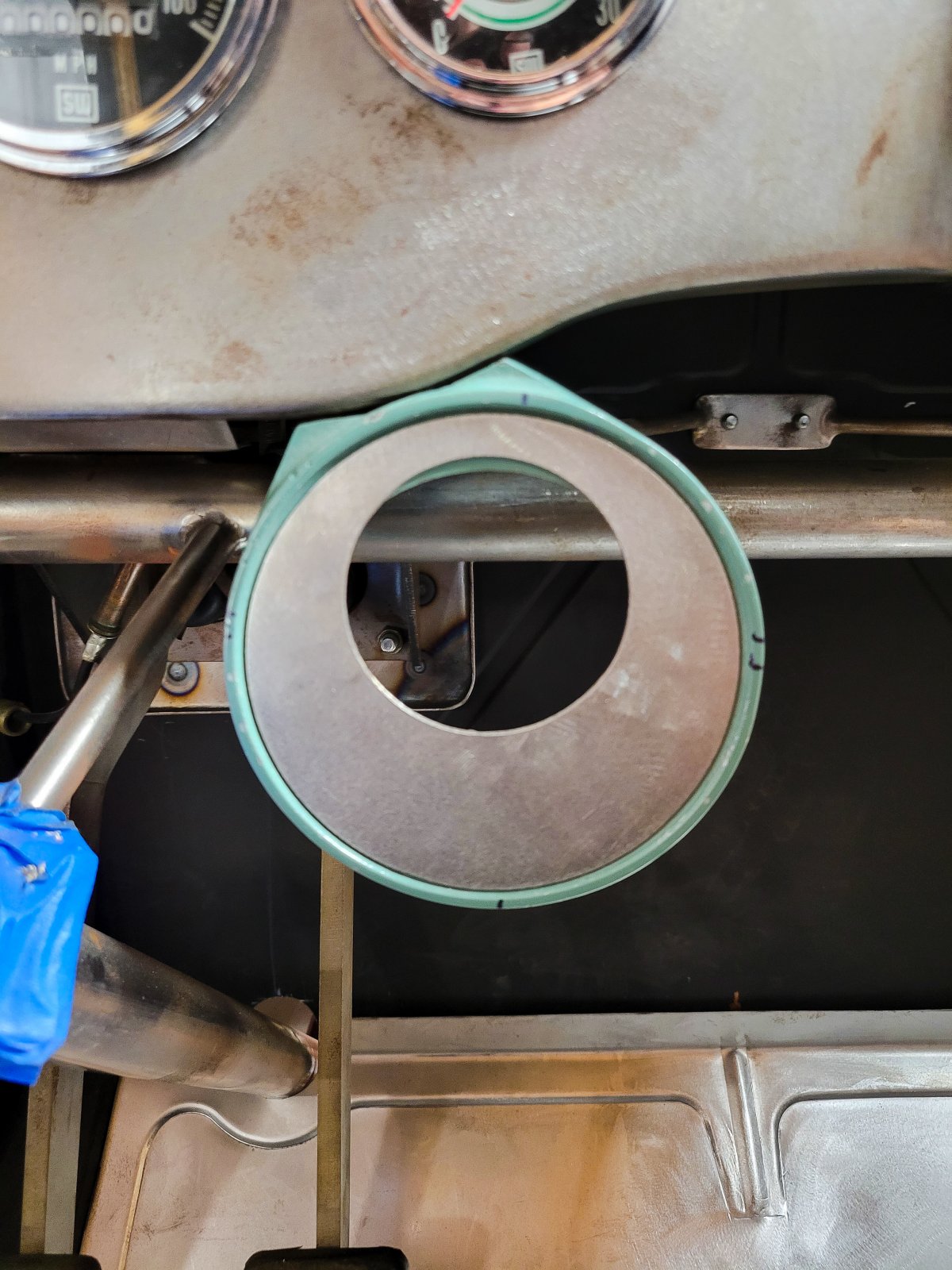

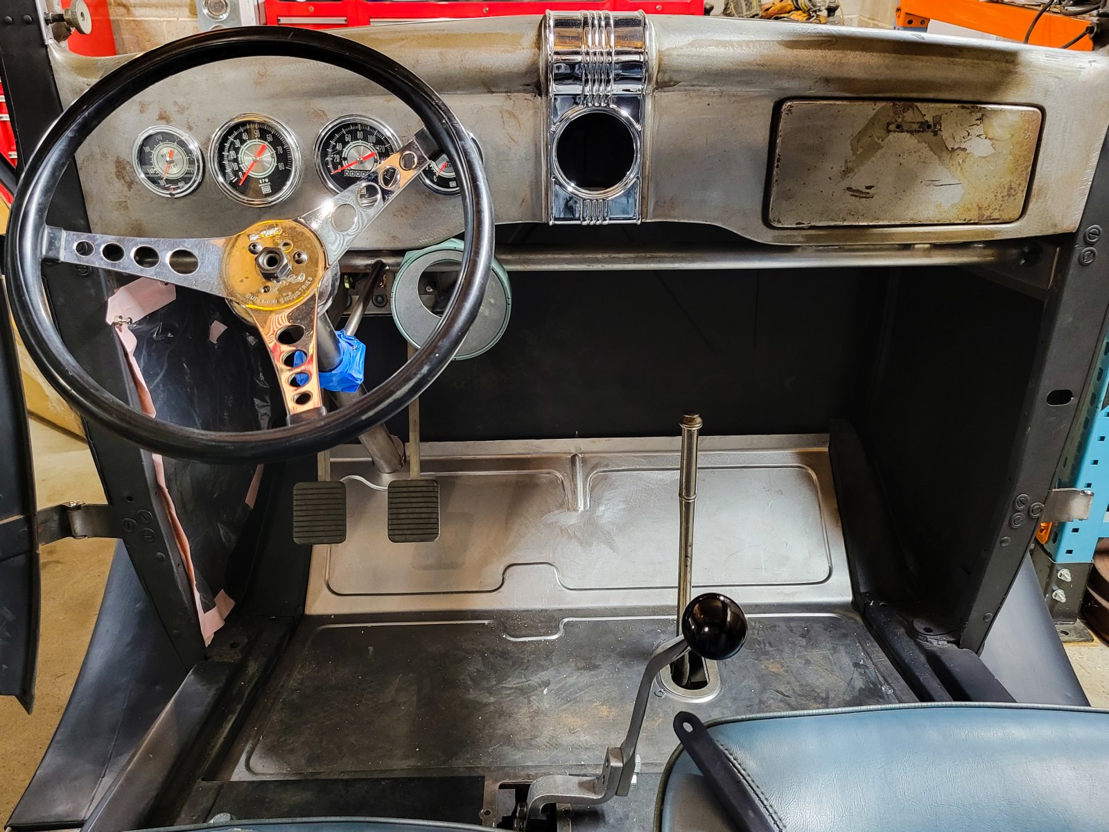

    This little gauge mount is something a few people have asked about but I don't think I've ever really talked about it in this thread.
    This cast aluminum bracket is really neat and it's likely I'll never see another.
    When I first moved to Utah, I worked for a company installing and repairing commercial laundry equipment. We were working at a beryllium mine, way out in the middle of nowhere. These places have laundry facilities on site and the miners' work clothes are cleaned for safety/health reasons. Anyway, there were these ancient machines still in service, but barely. These were beasts, well built from the end of the era where style and artistry were part of craftsmanship. A time when style wasn't reserved for the mainstream.
    We were decommissioning the old stuff to make way for all new equipment. Because beryllium can be quite hazardous, nothing was to leave the site. After we pulled the machines, they were hauled off to their dumping site. As soon as I saw this mount, I knew it was coming home with me. I disconnected the gauge it held, removed the bracket, washed it off and tossed it in my tool bag. It screamed 1950s/60s.
    I remember unboxing my 35/36 Ford dash, well before it was ever modified to fit the coupe and digging the bracket out of a box and seeing if it would fit. It's crazy, it looks like it was designed for the dash.
    I always imagined sneaking one or two gauges or a gauge and an accessory switch or a vintage idiot light on a polished or chromed panel.

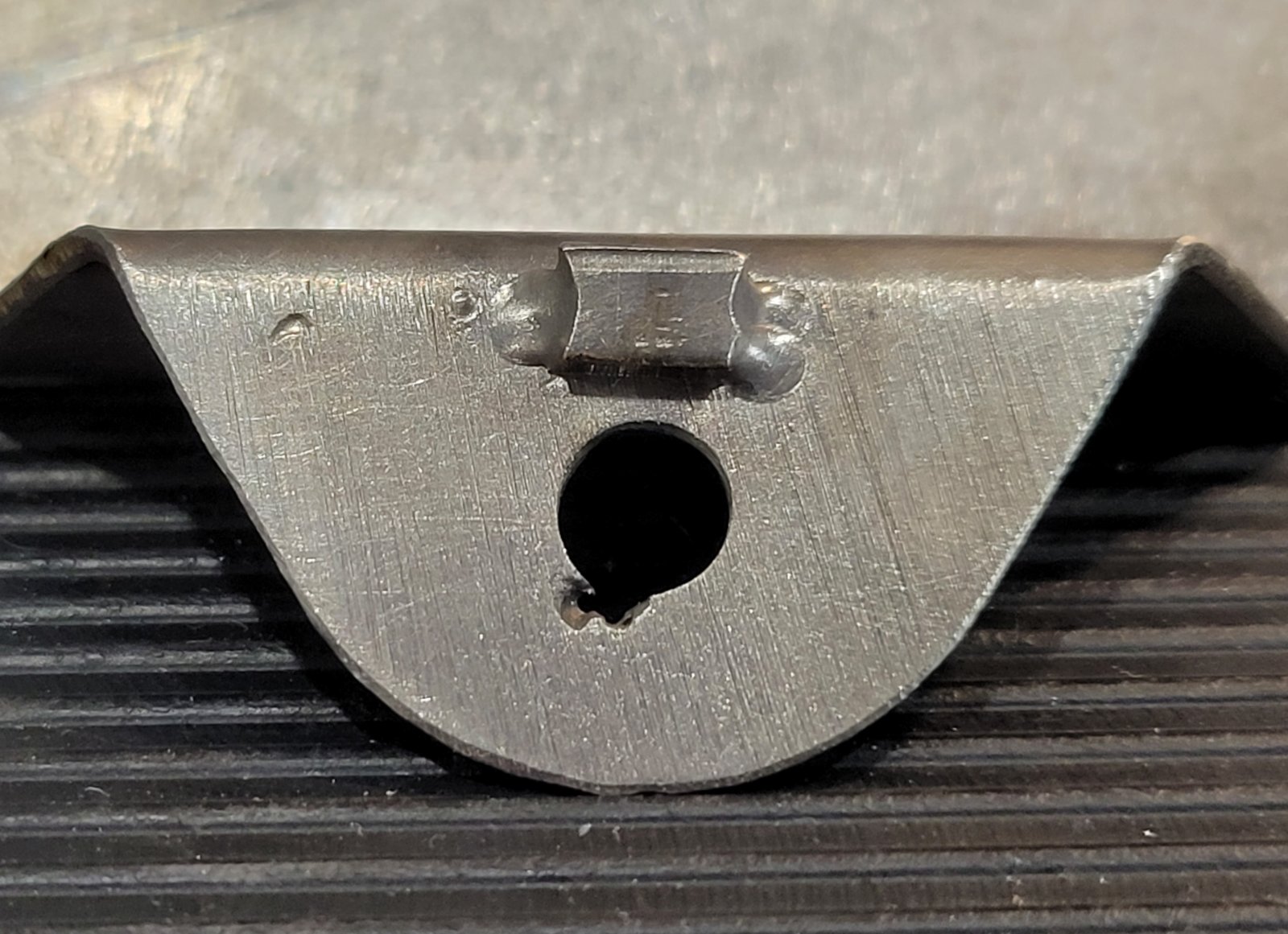

    Back when I had the stainless pieces cut by my friend, Carl, I had him make an insert. The first one had the gauge 3/8" more away from the edge, but it didn't look "right". So, I had him cut another, luckily I had some room left on the stainless sheet I'd brought him.
    I hesitated to show it unfinished but it will 100% fit the era and look like something someone purchased at a speed shop. So, we'll have to bear with its awkwardness, right now. I just dig this thing and wanted to show where it's at.
    The studs are 1/4" stainless weld studs that are tacked on. Rather than make some offset tab/washers, I had my kids go through their piggy banks to find me some 1960s quarters. We struck a deal and I paid them a dollar for each coin. My daughter is pretty slick, even though I already had the two coins I needed, she upsold me on another 60's quarter she found and made 50 cents on that one. I'm a sucker for a great pitch. Hahaha.
    There was a lip around the edge of the original gauge opening. I hit that with the Roloc so the mounts would fasten flatly.
    I'm not sure of the orientation of the panel, yet. Once that's chosen, some material needs to be removed so the gauge will fit.

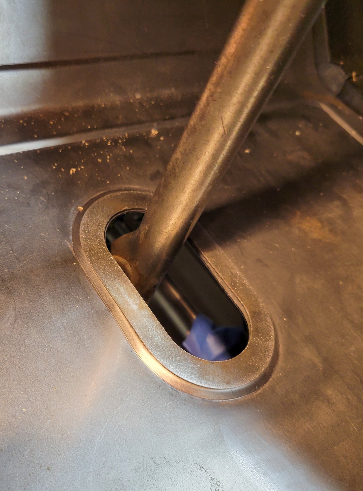

    Are you talking about how the hole is not perfectly round? That's from the plasma cut starting. With a small hole like that, it happens. I could've drilled the hole but Carl programmed the piece to be cut with holes and so I didn't have to spent any time at the drill press. Haha.

  28. The bracket looks great - will you repaint it? Or maybe leave a brushed or as-cast finish to contrast with the chrome on the shifter, gauges & center waterfall? What would a '60's racecar builder have done??:cool:
    Your story reminds me of a technique an old HAMBer (probably emeritus) suggested:
    He looked for "car part shapes" in odd places. A small aluminum kitchen cup is the same shape as a tach cup. A kitchen funnel or a desk lamp shade are the same shape as the flared cone at the top of a steering column.
    It makes accompanying Wifey in Walmart or Bed Bath & Beyond almost kinda fun!:rolleyes::)
    brEad, mad mikey, loudbang and 2 others like this.
  29. -Brent-
    Joined: Nov 20, 2006
    Posts: 7,714
    -Brent-
    I'll spray it black. The insert will be polished.
