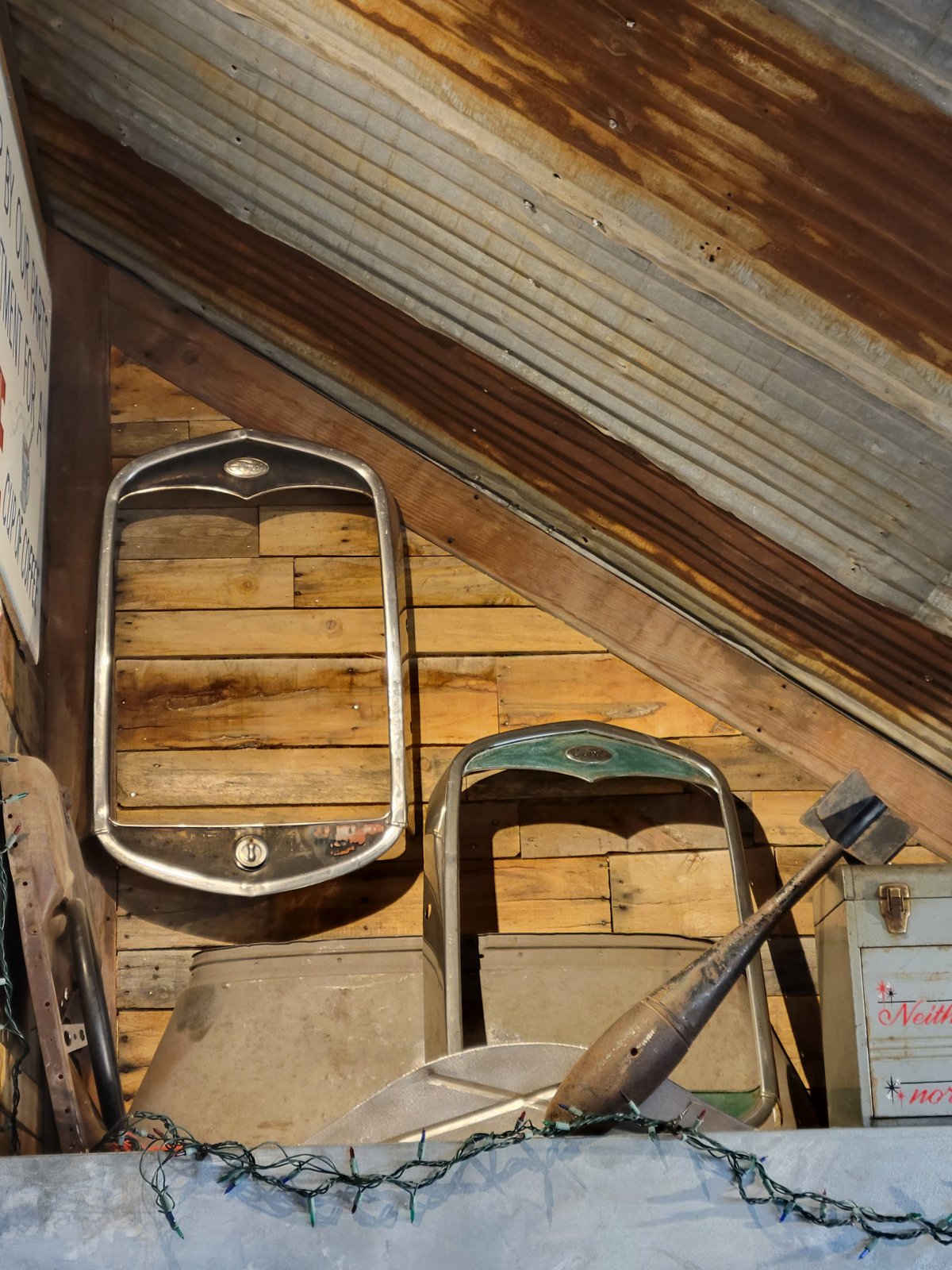

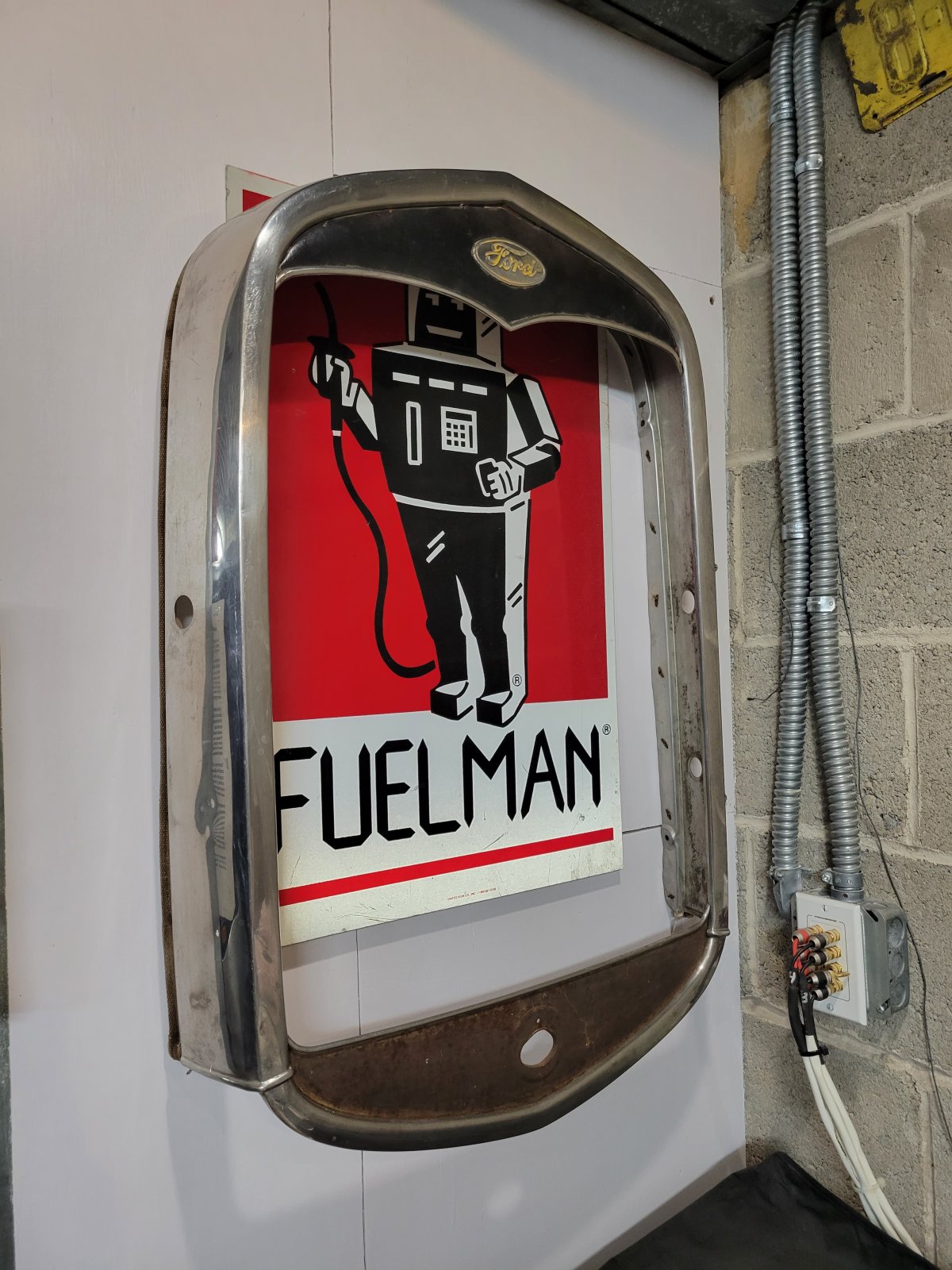

    Cleaning the shop today and a gentleman came by to buy some parts. Being that he's like many of us, he has parts to trade. So, he asked me if there was anything I needed before he came by.
    We went back and forth and then I told him I have a soft spot for 1931 grill shells. And... wouldn't ya know, he had one.
    This one is in the top 2 for quality out of the ones I own... but it's dead last as far as the color! Hahaha.
    At what number does it stop being a "collection" and start being a hoard?

    50 seems like a fair number

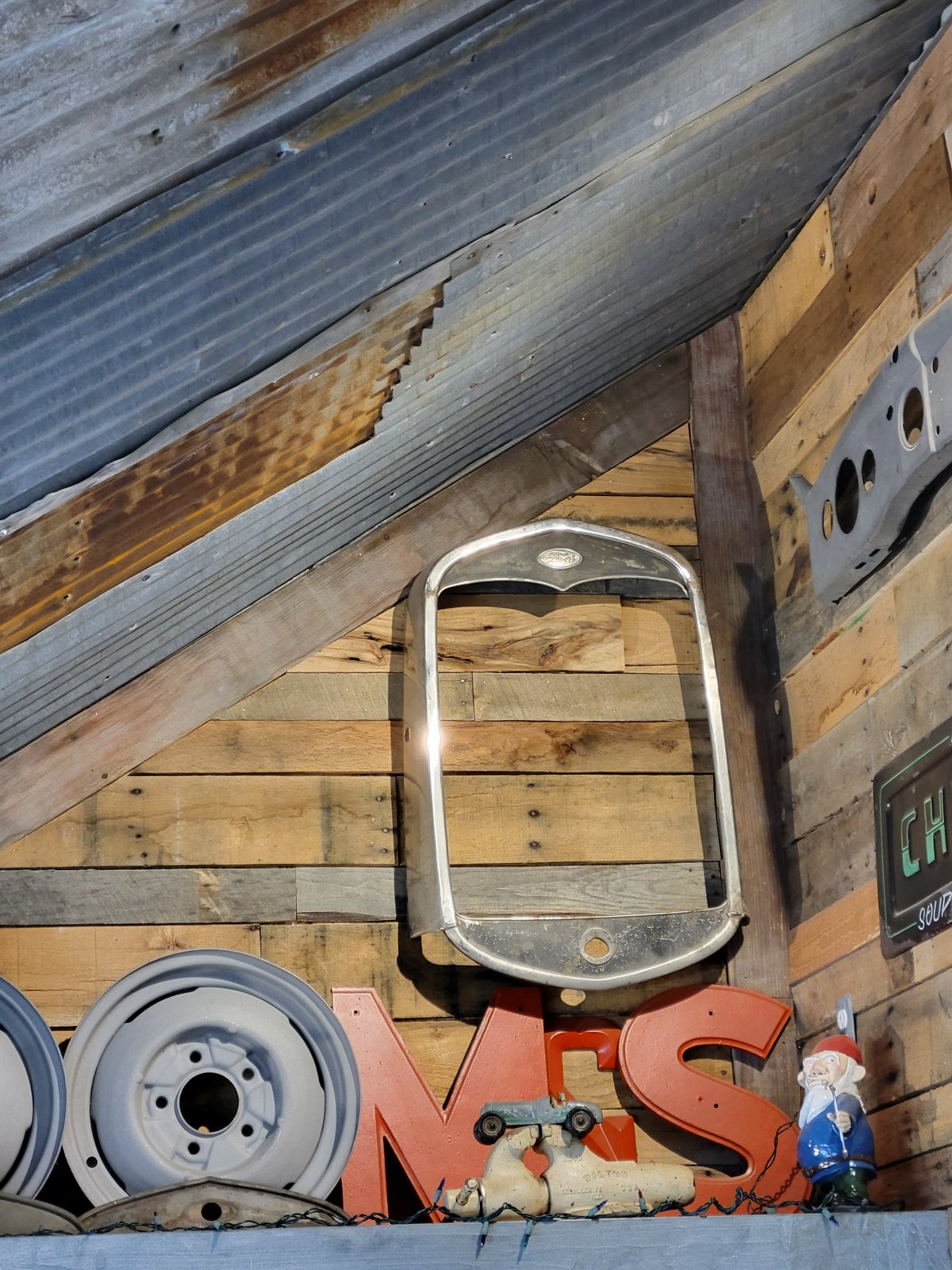

    A couple of these will be nice finished out differently to change up the look once in a while.
    bchctybob, Stogy, AHotRod and 8 others like this.

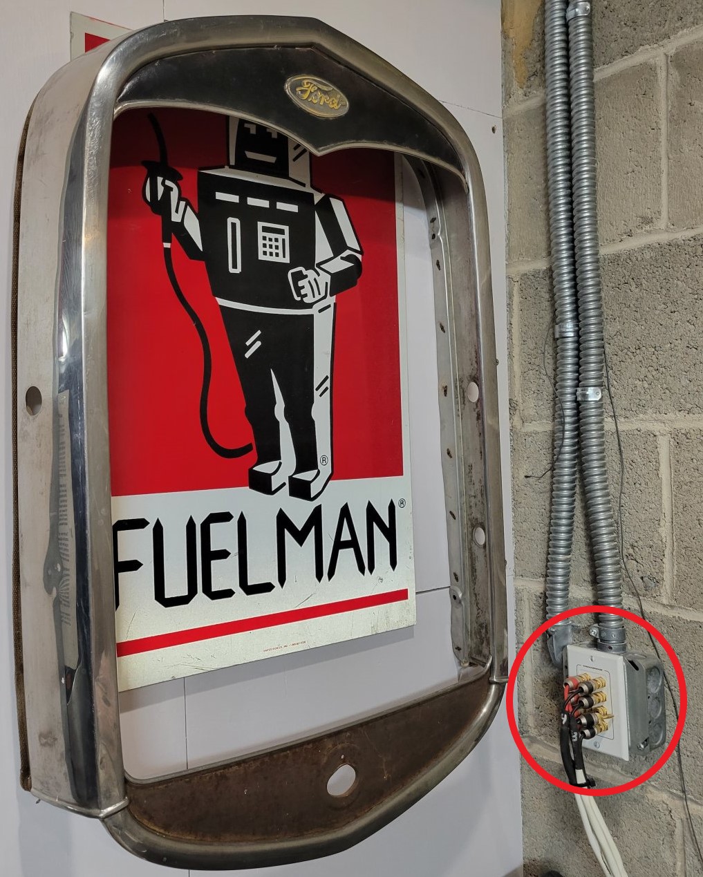

    kadillackid
    Hey Brent, Whats going on here o_O ...kick *** sound system ?
  15. -Brent-
    Joined: Nov 20, 2006
    Posts: 7,864
    -Brent-
    Yes!
    One is unplugged because I got a little rowdy. Haha.

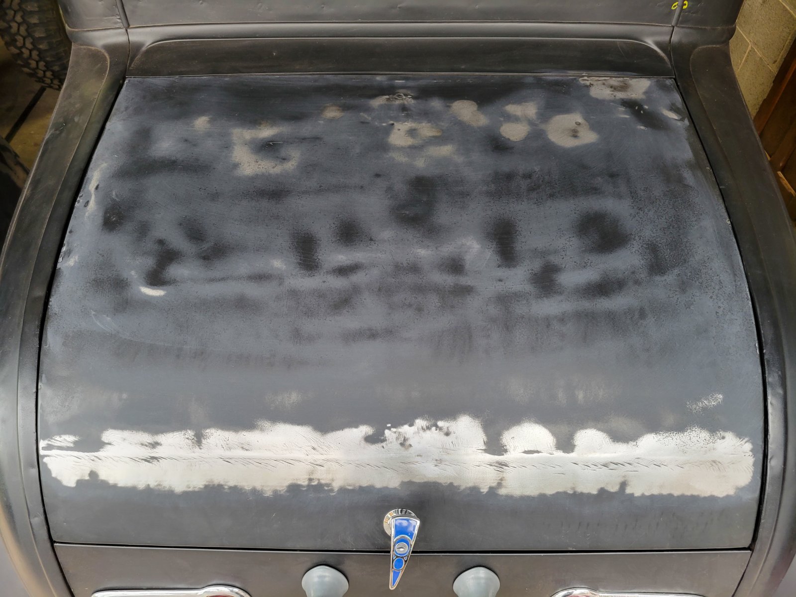

    Model A Decklid Saga - Part 1:
    Toward the end of 2021, I was making great progress knocking dents and getting the body straighter. When the body was dented and dinged the decklid didn't look so bad but with everything improving, I knew it had to be worked on - especially as we approach body work and shiny paint.
    The first thing I figured I could handle was getting the raised weld seam into shape. I'm not opposed to using filler but if I can work the car into better shape and use less, that would be ideal. At this point the deck lid would need a TON of filler.
    The light shows some of the dents in the panel.
    Get it to the point where it would mostly just need a skim coat of filler.
    This weld seam is from replacing the bottom of the original skin. I should have just reskinned it back when the car was getting all the metalwork done. But the car had a million other more important items to focus on and, quite frankly, I didn't know how to "see" the issues yet.
    Slowly I got the seam into shape and I was feeling more confident. I figured keeping it slow would keep things from getting out of hand.
    I sanded the skin to show highs and lows.
    Here's a different perspective of just one of the "lows".
    I worked from the underside as best as I could reach and worked both the lows and highs. I spent quite a while on YouTube, which was helpful. If it were just the skin, without the inner panel, I could've worked it better.
    Since I couldn't work the areas from underneath precisely but I could pretty much reach every spot and apply some force with prybars and such, I decided to work the areas with heat and that got the lid closer.

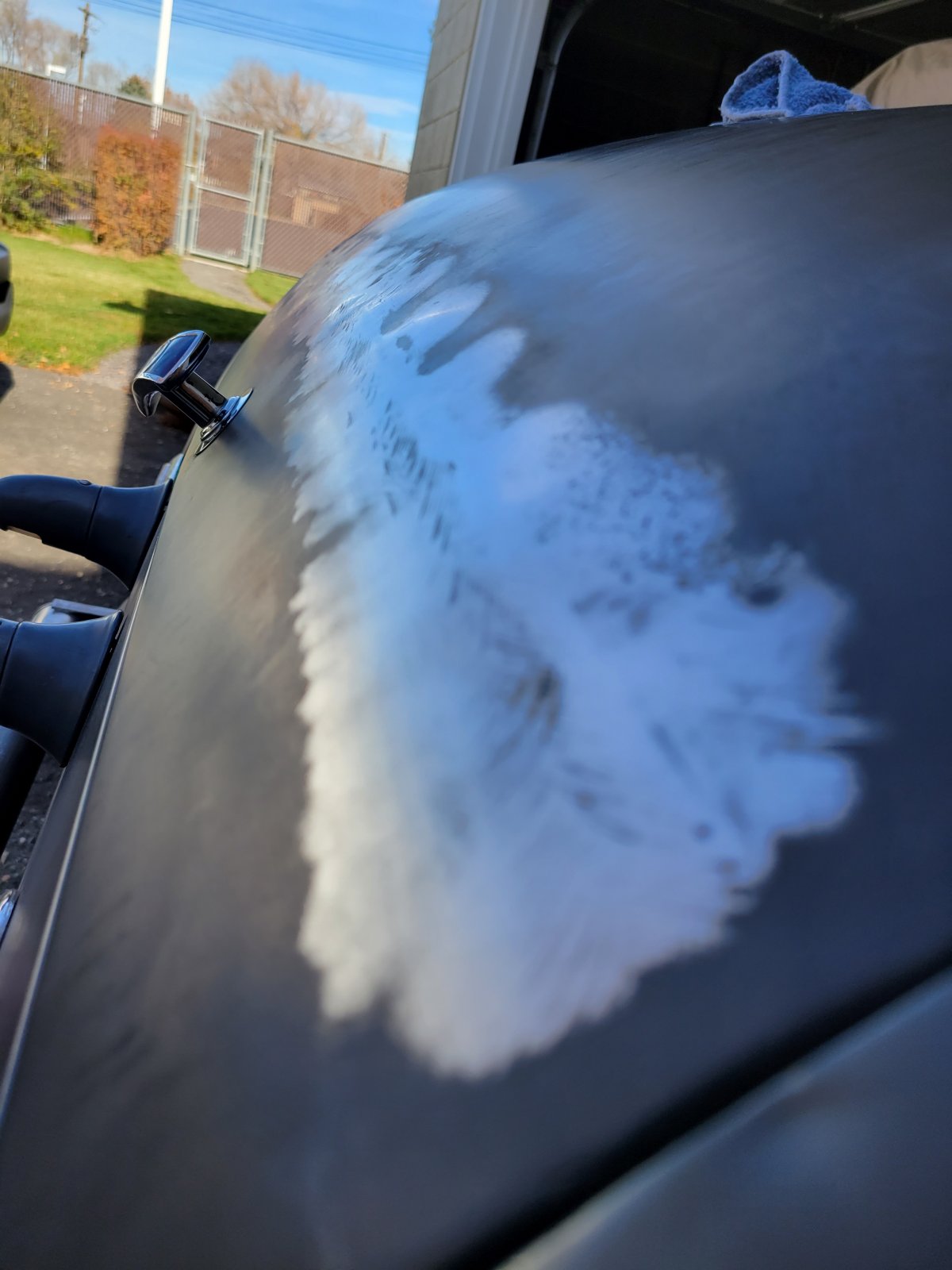

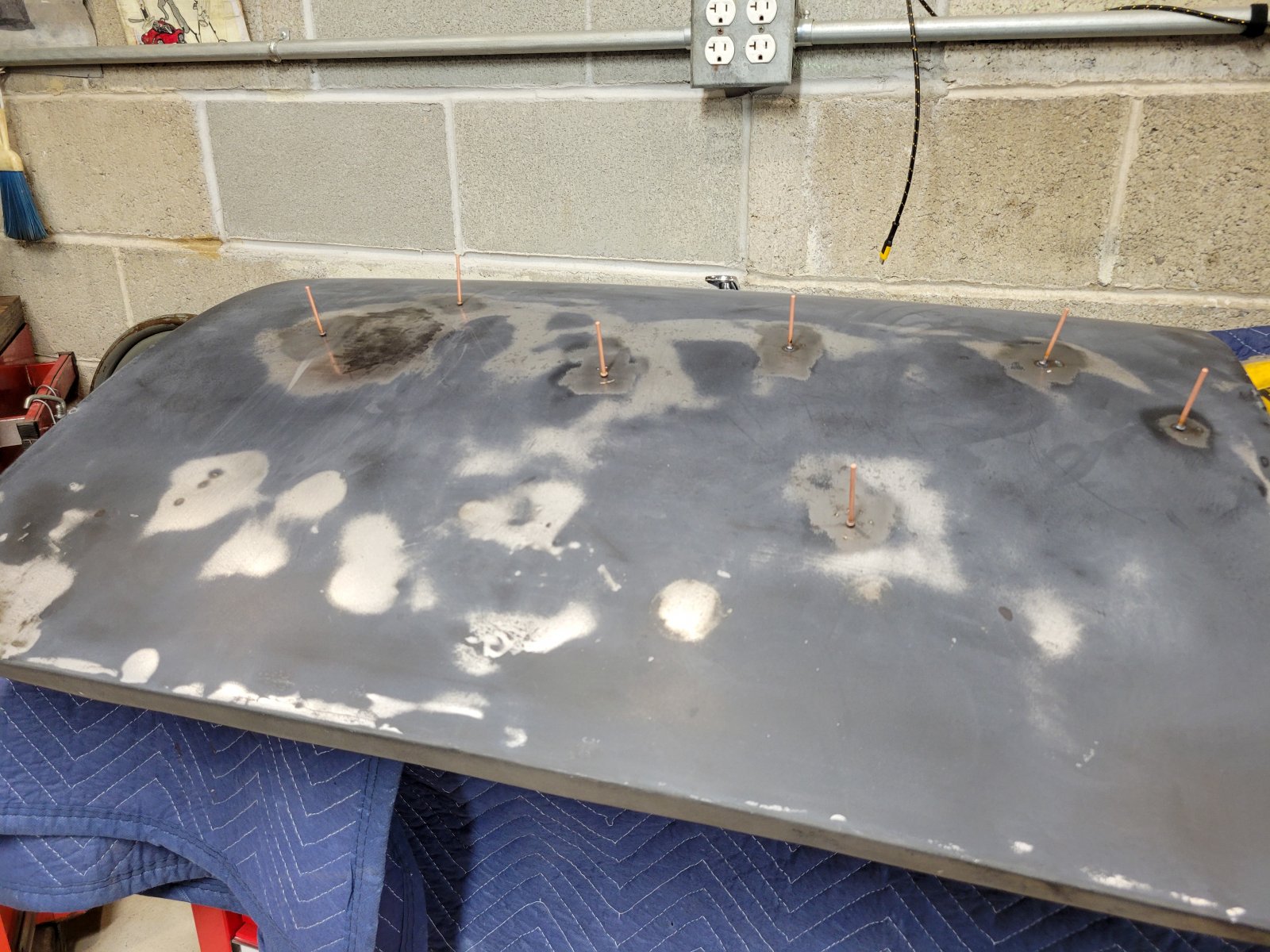

    At this point I had worked it to a better point, but I was watching all these vids and I'm all in, hahaha, thinking I can make it even better.
    My pal lent me a stud welder and, again, I spent a little time researching and then got after it. Slowly, I got closer pulling low spots while tapping/lightly slapping on the highs.
    Stud welding lows.jpg 20211120_003945.jpg 20211119_232523.jpg Stud weld repairs.jpg
    I felt unstoppable (my ignorance shining through :D) so I kept working which is actually code for " moving the issues around."
    I'd stop and watch skilled folks explain the fixes and such but the panel got away from me. I was dreaming of a metal finished panel but ended up with an oil-canned mess.
    Eventually, the more I messed with it, the more the issues I moved around would become harder to fix.
    Frustrated, after while of digging myself into a deeper hole. I gave up and ordered a skin...
    Now, I need to say that I hate useless drama. I don't like being part of it at all. The deal this decklid became was way more useless drama than I care to write about. I don't want this thread to be about that. I don't like being dragged into it and I'd feel gross perpetuating it.
    So, here's the "what's so" on my 6+ month decklid distraction:
    (Here's where I'll keep the drama out. I'm not looking to disparage this company. I'm not looking to rehash any BS, okay? It was 5-6 months of intermittent BS that I've moved on from.)
    The skin was wrong, it was workable but it had a couple manufacturing/quality control issues. I kept it "just in case" but it looked like buying a new one would get get me back in shape. So, I ordered a new/repopped trunk lid and when it finally came in it looked off, right out of the box. I checked both my car and the lid. The lid was out of square because it had some "twist" to it. One corner was sloped down. Plus, I didn't know that the trunk lid came with the rumble lid style lower edge.
    Rumble Lid Lip and Twist.jpeg Rumble Lid Fitment.jpeg Rumble Decklid Lip.jpeg
    You can kind-of see how the other corner dives down. It's hard to capture in a photo. It could've been modified/fixed to fit but I was so sour with this whole deal, I decided to move on.
    This all took about 6 months from ordering to returning and getting $ back and that lid was in my possession for a blink. While it was all going on, I was actively hunting parts and searching for a solution.
    It seems like (at least in my life) these hunts require me to go on an adventure. More on that in the next...

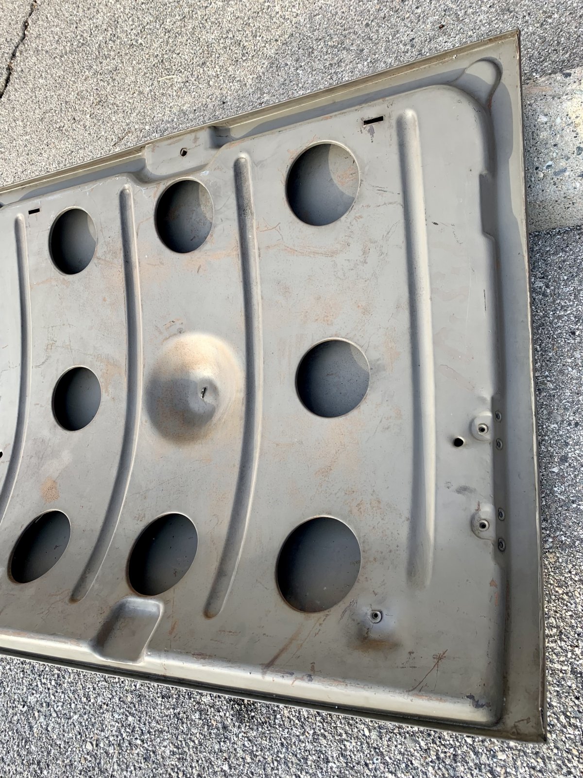

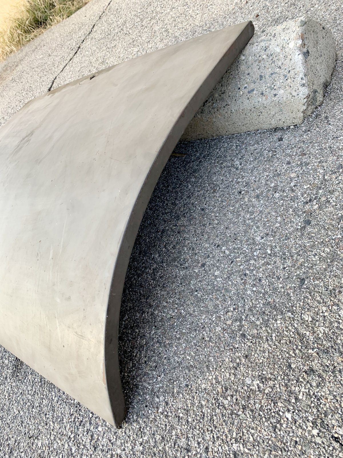

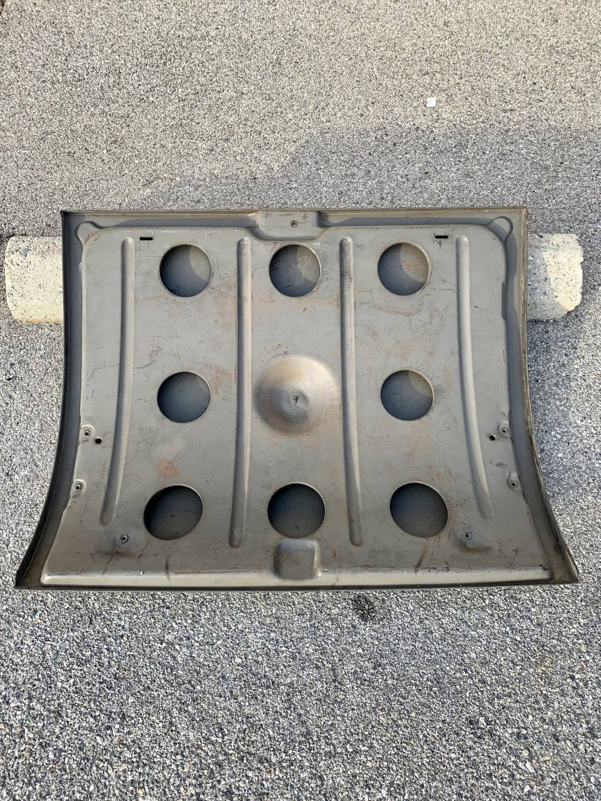

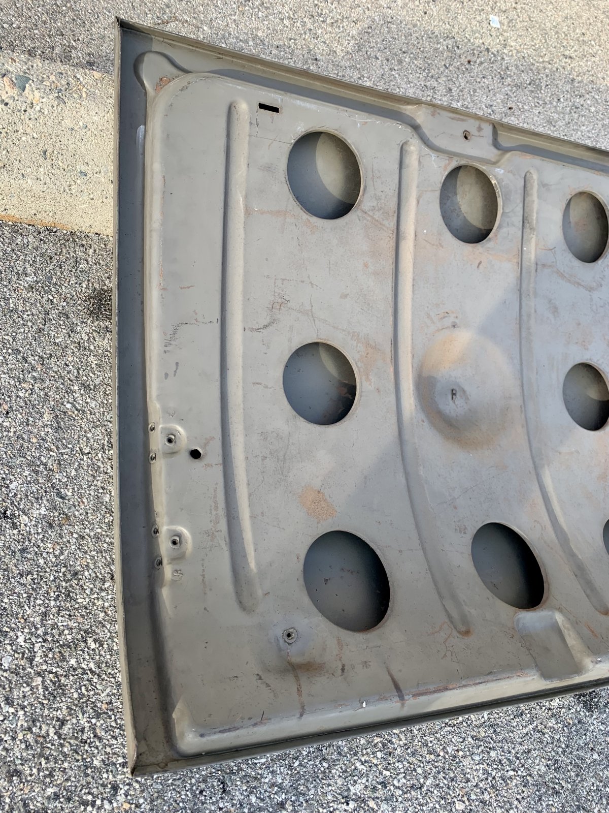

    NOS Decklid 1.jpeg NOS Decklid 2.jpeg NOS Decklid 3.jpeg NOS Decklid 4.jpeg NOS Decklid 5.jpeg NOS Decklid 6.jpeg
    I knew deck-lids differed, slightly, between the 28/29 and 30/31 but I had no knowledge. A quick search and I realized a lot of other people didn't know either and the ones who did swap them, made it work. So, I figured that's that I'd do.
    It wasn't cheap but it was New Old Stock, never mounted and packed away longer than I'd been alive and it was just down the street in Southern California.
    We made plans (I'm pretty sure Dennis didn't believe I was coming out... haha) and I rearranged my schedule and that week I got up way before sunrise and hopped in my little runabout pickup to get my car back on track.
    The next day I tested the 1928/29 rumble lid in place and it fit. It's a million times more workable. The next step is to convert it to a trunk and get it fitting proper.

    The inner panels differ. Some old-timers say the curvature differs, too. This one seems to match up decently.
    This rumble lid will need the bottom lip straightened a bit. I read that I may have to mess with the rumble lid latch area but I don't know yet. I need to get the hinge areas converted first.
    I'm sure there are a few idiosyncrasies that make stuff incompatible between models/years but this looks like it's going to work out.
