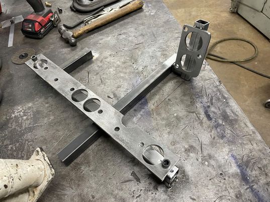

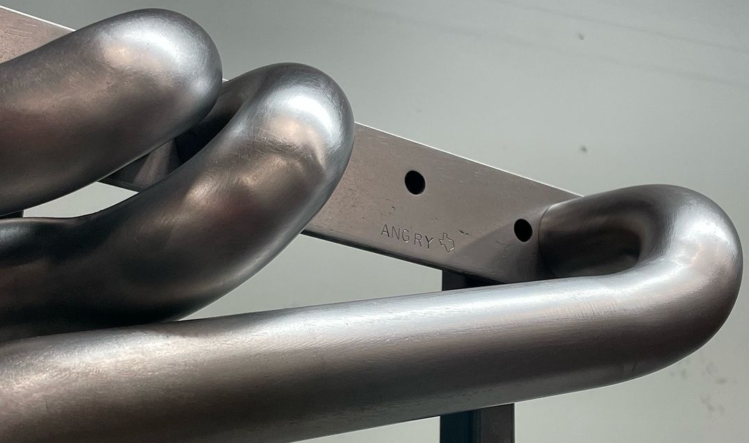

    I'm not spilling any beans, yet, but @TexasSpeed has this cool jig...

  6. Joe Blow
    Joined: Oct 29, 2016
    Posts: 1,600
    Joe Blow
    catdad49, Stogy, mad mikey and 7 others like this.
  7. -Brent-
    Joined: Nov 20, 2006
    Posts: 7,714
    -Brent-
    That joke is witty. You're really using your head-er.

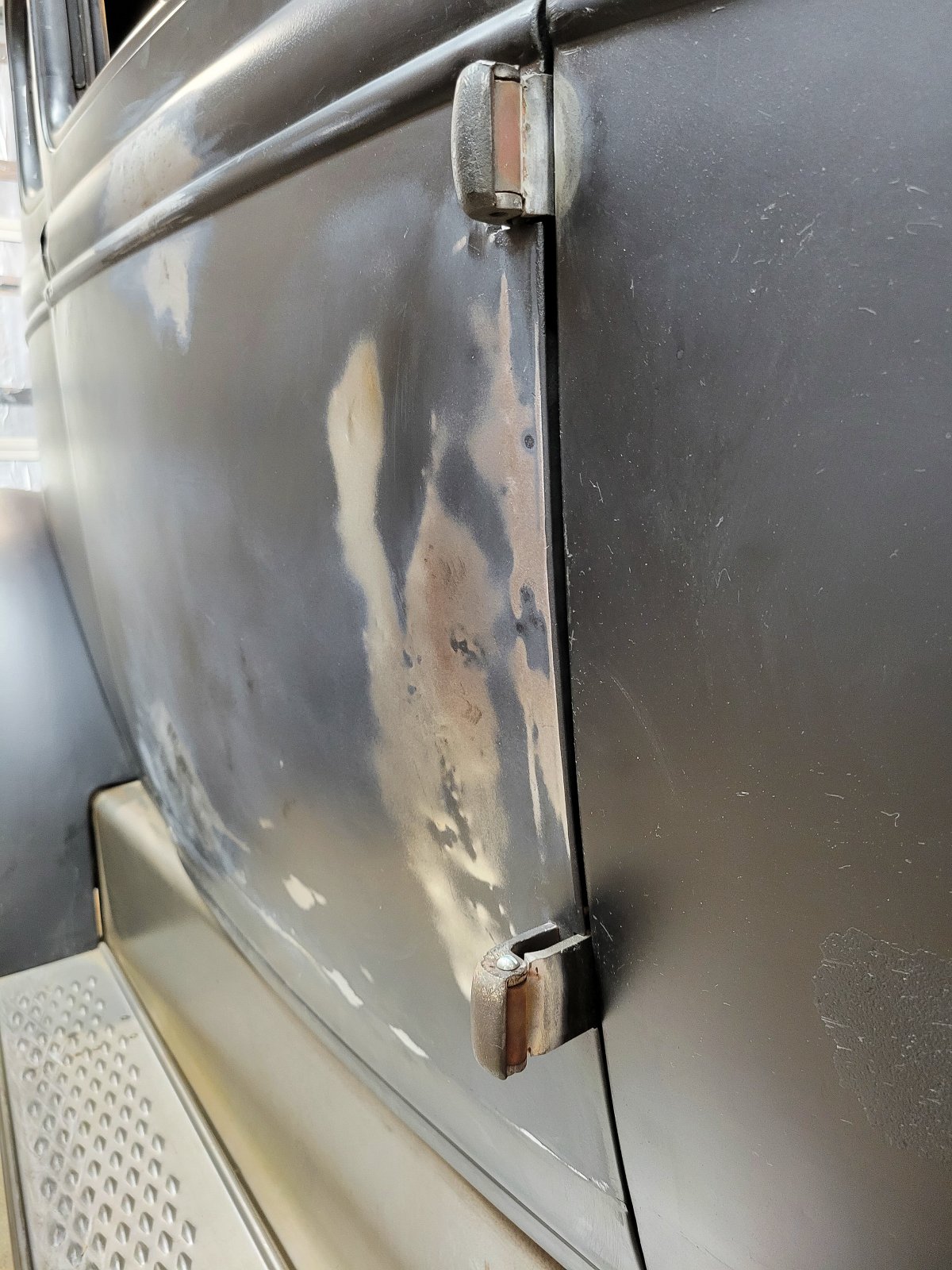

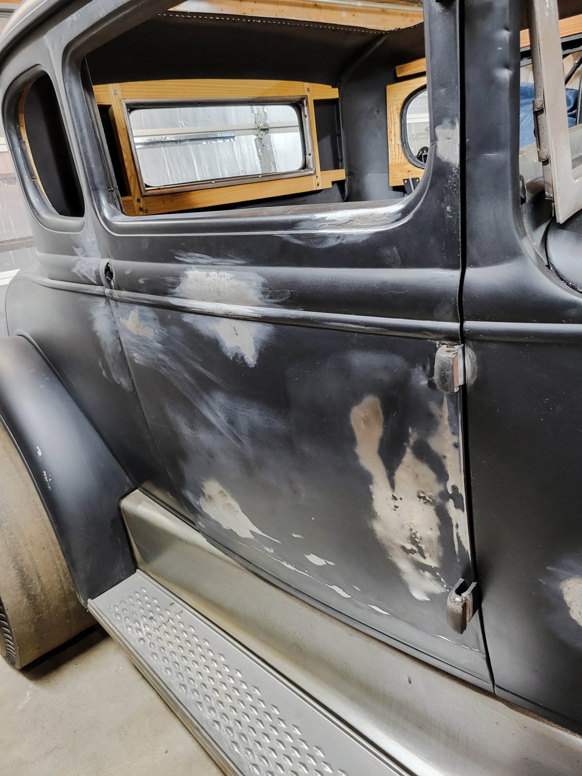

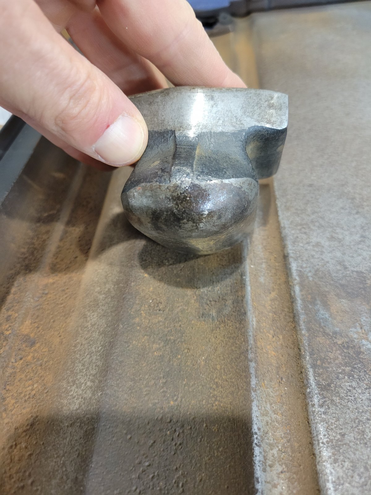

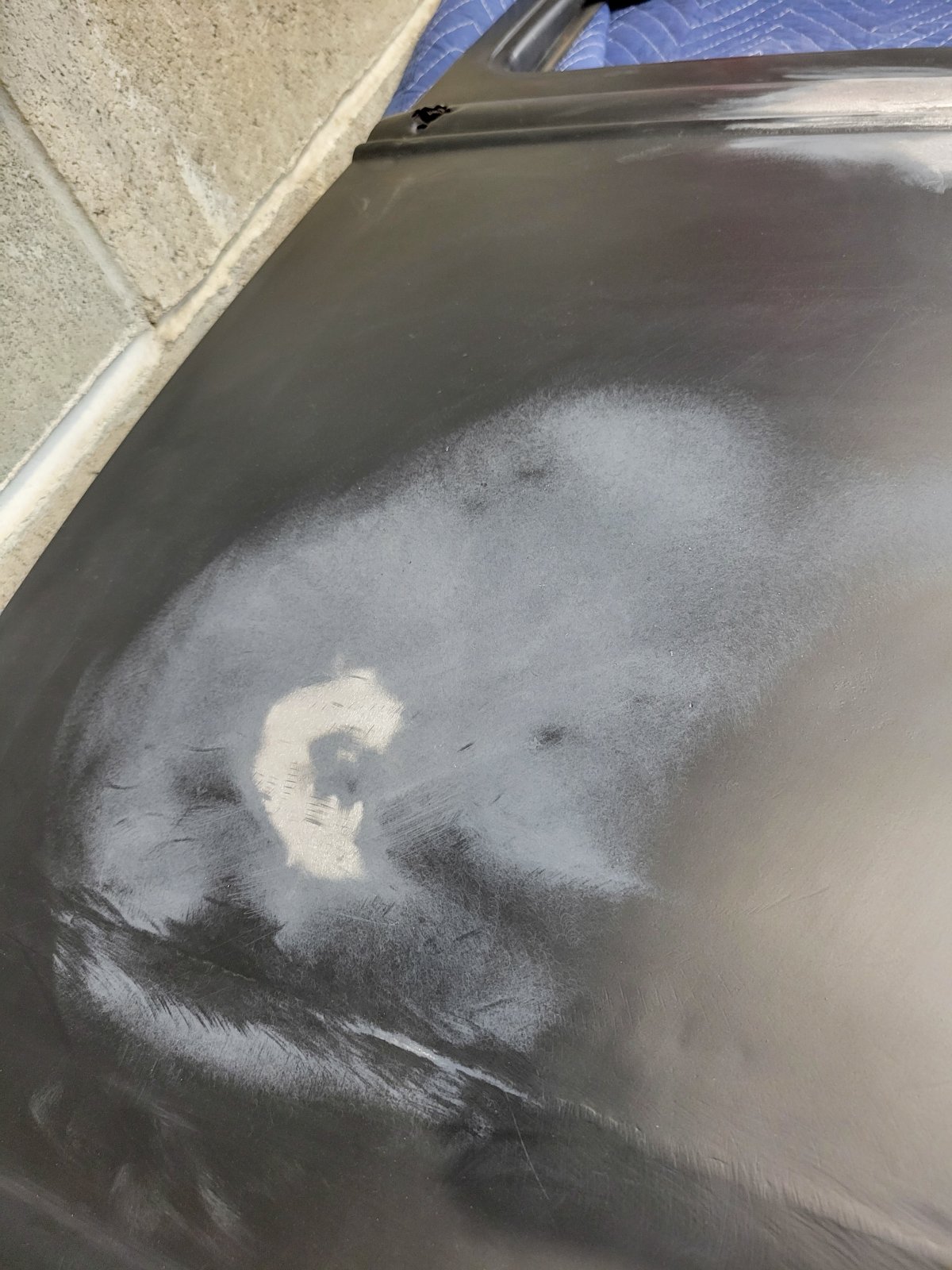

    I hate the oil can effect! Especially when you are replacing a patch!
    I have found, if you do relief cuts and reweld the slices it gets rid of that sometimes. I have not played enough with heat shrink- quenching, and that sort of thing yet. I am too impatient!
    Slice and dice!!!
    Stogy, mad mikey and 31chevymike like this.

    Whew! What a journey, just one door! They surface this way sometimes, usually a 'Surprise!'
    I just found my missing slap hammer, about to start on my doors for my '27 Touring.
    Your door saga was a real lesson! Wrinkles and oil canning are the devil's brew...
    (my former O.T. '52 Porsche convert had an oil canning in the floor! Chased it down, used your 'slice-and-stitch' method. Good fix)

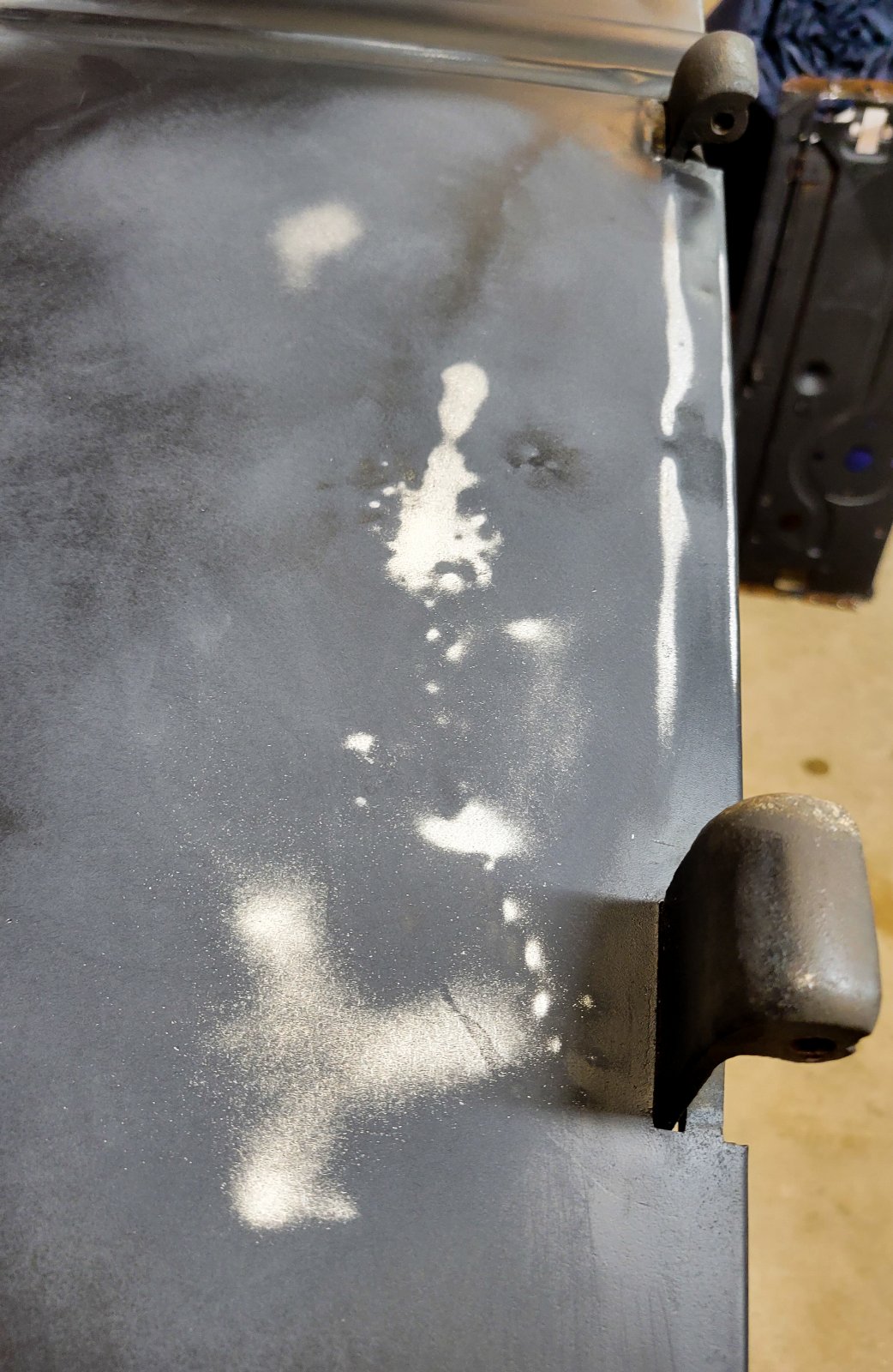

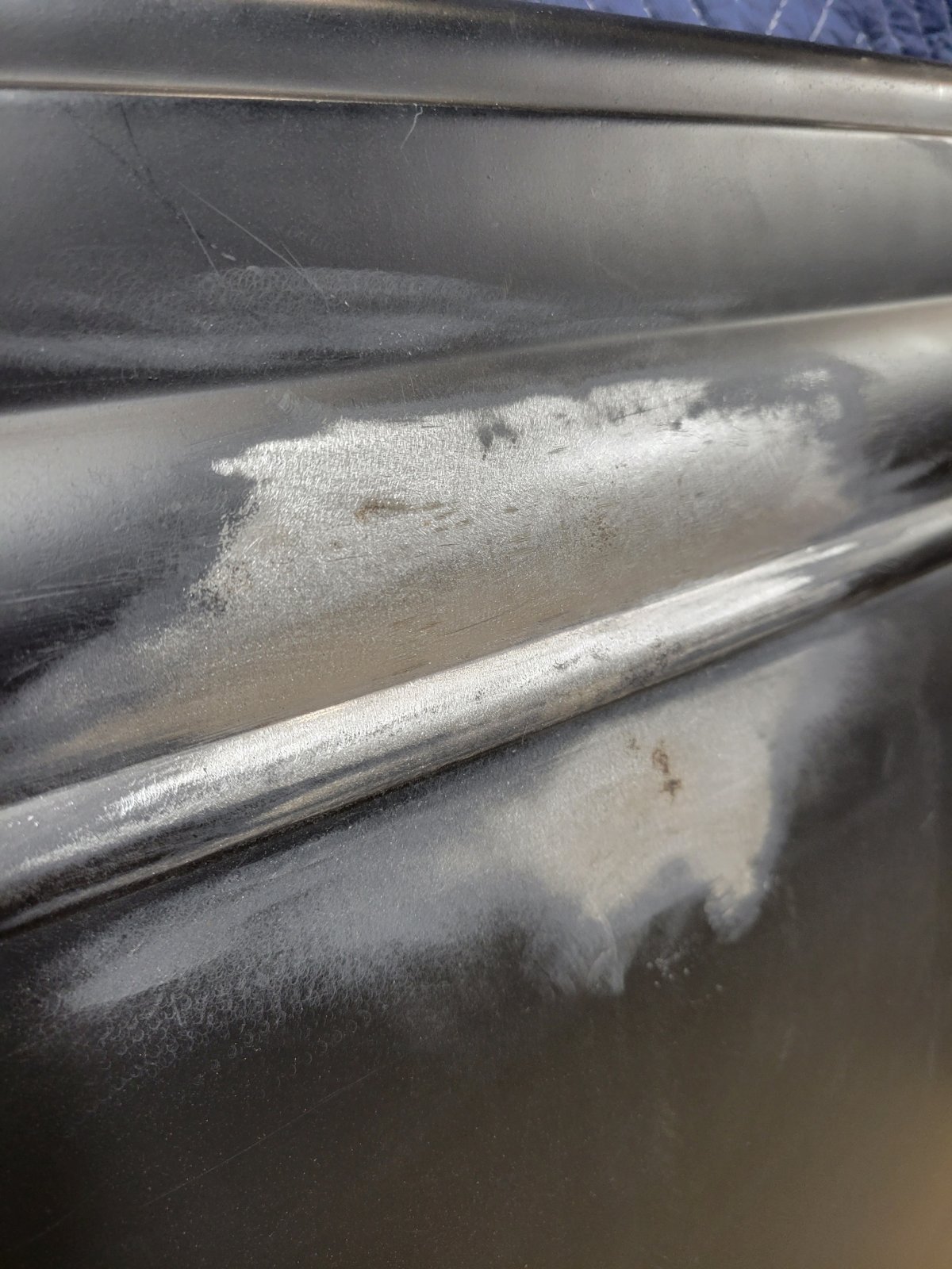

    My thinking about oil-canning was backwards and I'm glad to have messed with the doors up at Chris' because I have a better understanding, now. As the door was worked closer back to the original contour, any oil canning was gone but seeing how he worked both sides was what I needed to see.
    I just helped a guy who is working out some dents on a 60s Bronco. He was struggling and I had the exact experience that he was facing. We chatted through it and the next message I got was a metal finished repair. He now feels like the master of metal, haha, and I understand that... and I'm a goob as far as my skill but when you get it figured or mistake your way into it - it feels so great.
    Thanks, Mike.
    The doors are so much better. I'm glad I kept at it (along with all the help from friends). I have a few little tweaks left and the passenger door has one last issue that hasn't been discussed, yet. It's a weird one.
    Now that summer is over, I'll be getting back to it.

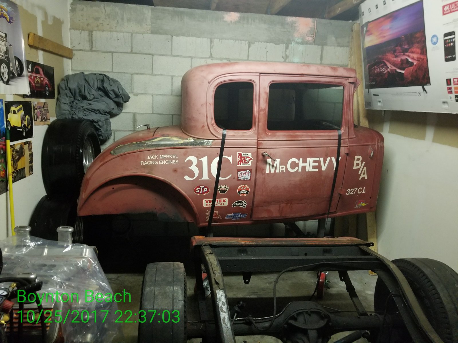

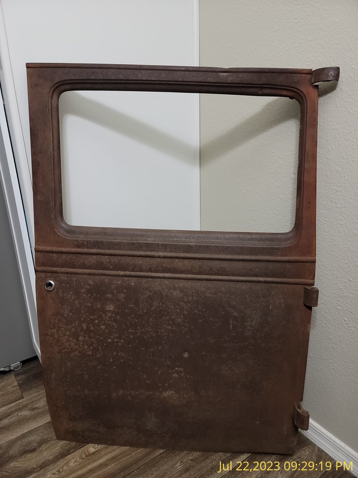

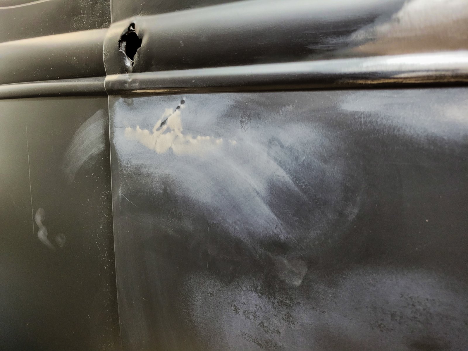

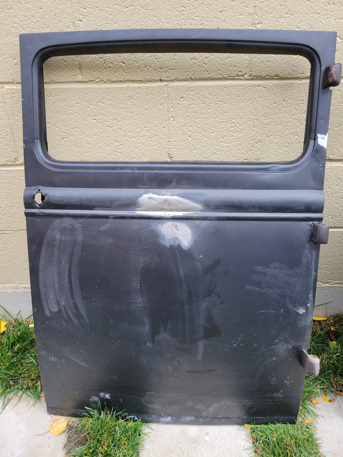

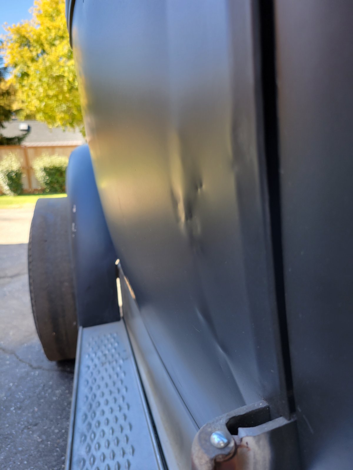

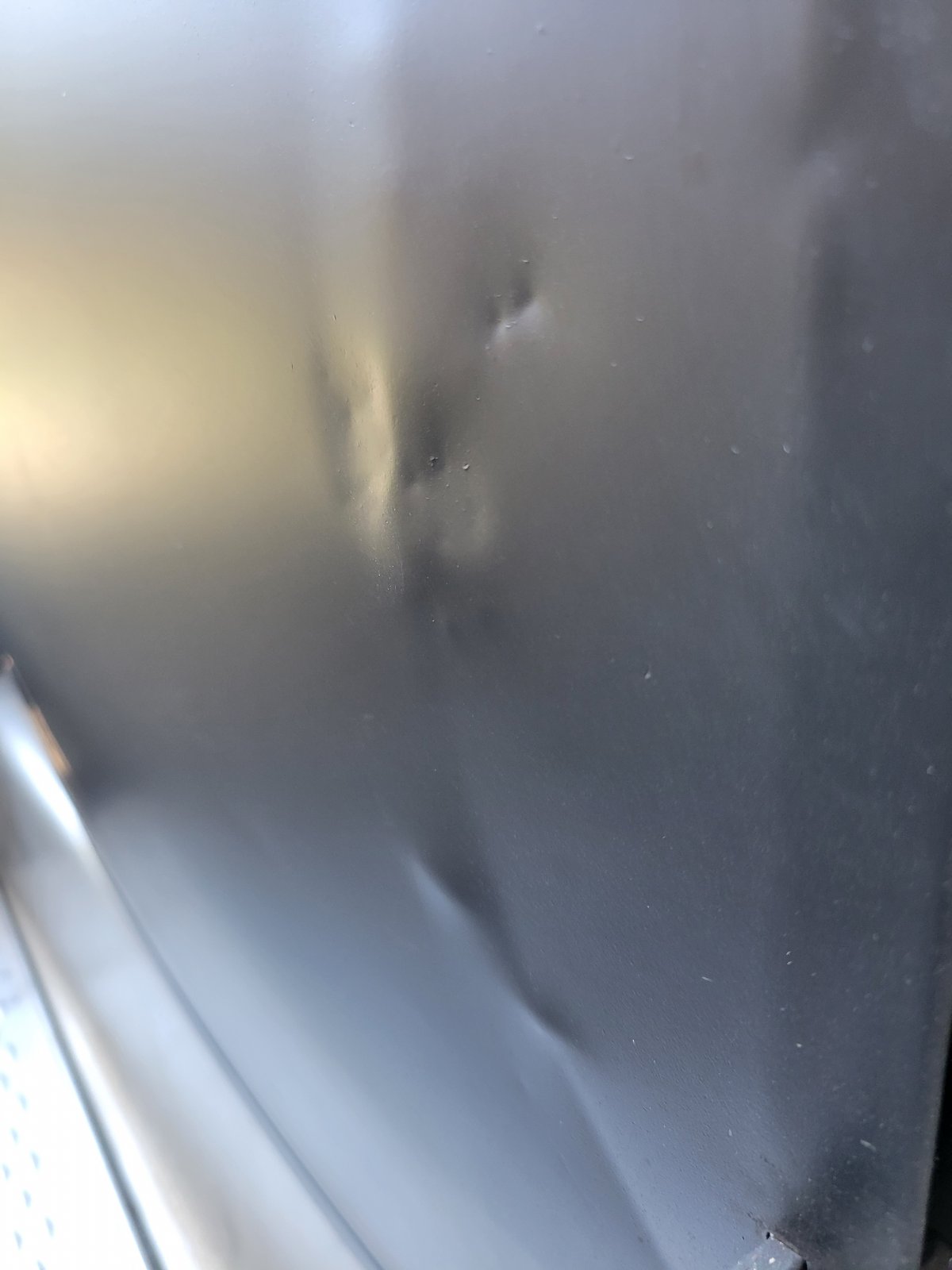

  13. Speaking of doors, I've been looking for a passenger side door since 1995 when I bought my coupe and believe me, they are extremely hard to find and purchase... Ran an old ad that I ran here on the wanted section of the HAMB from 2017 and 4 HAMBERS responded! The one I bought is in GREAT shape, even sporting a bullet hole!
  14. Atwater Mike
    Joined: May 31, 2002
    Posts: 11,618
    Atwater Mike
    Speaking of bullet holes... LOL
    My original tub has bullet holes from small bore, (.32 cal.?) in 2 doors. Driver door has 2 bullet holes, (.45) one went thru the trailing edge of the front door, ripped out some of the 'B' pillar. Other one penetrated dead center.
    Many years ago, I would have been dissuaded to go with something with bullet holes, but oxy-acet (#0 tip) and hammer & dolly have erased any trace. Slap hammer flattens it out w/o losing metal thickness. (Followed by flat filing, very lightly, however)
    Give me the bullet holes, you can have the oil canning! (Even oil canning is easier now that I've been 'schooled' @-Brent- explained this quite eloquently in this thread)
    I recommend getting into this, it can escalate your psyche.

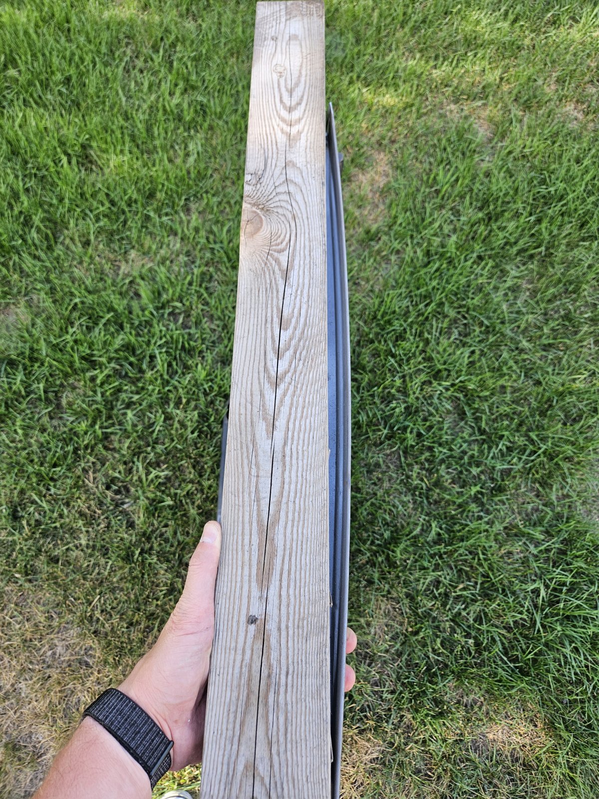

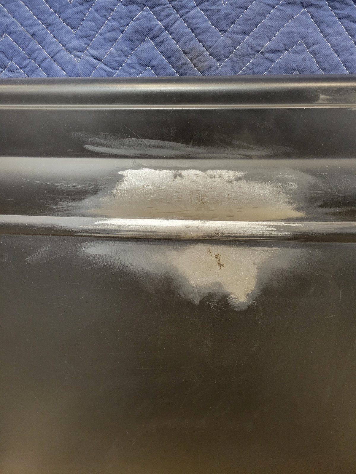

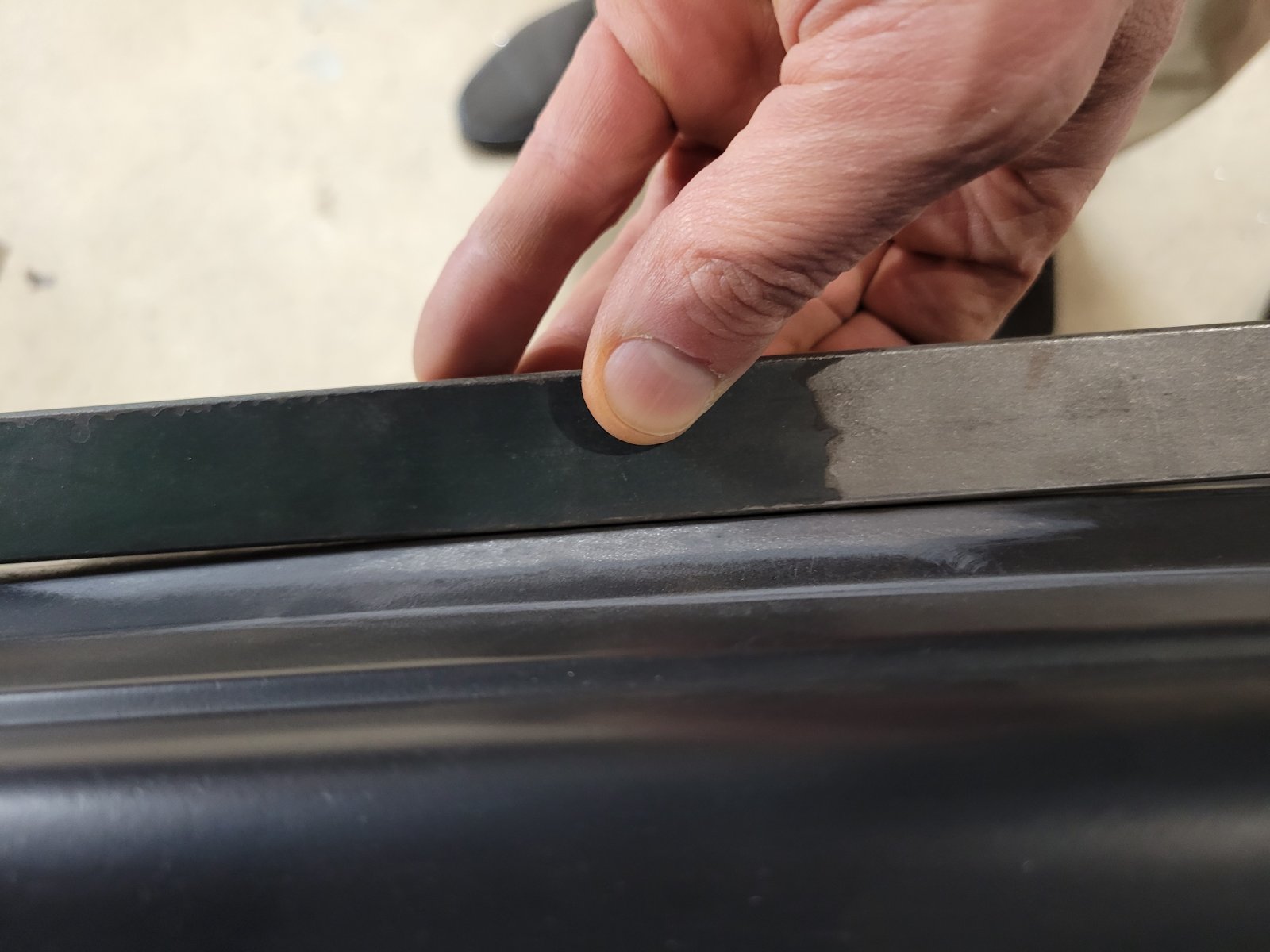

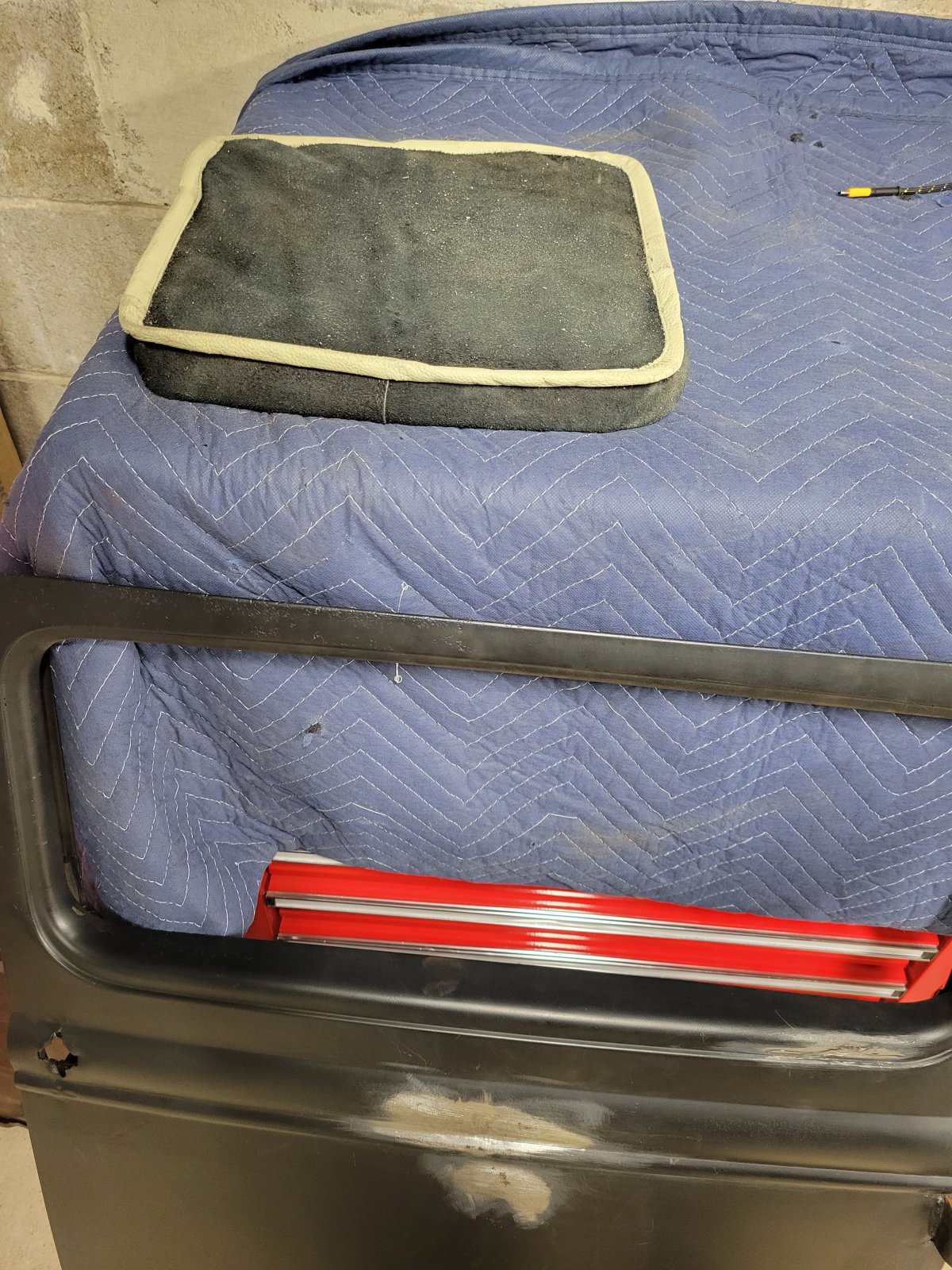

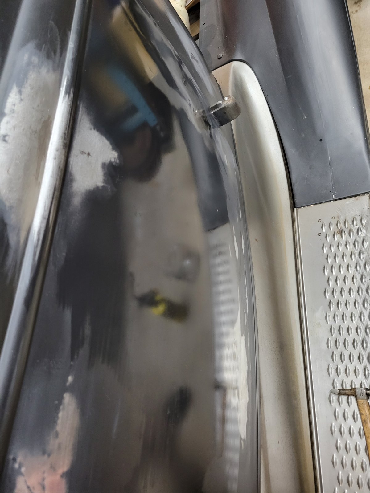

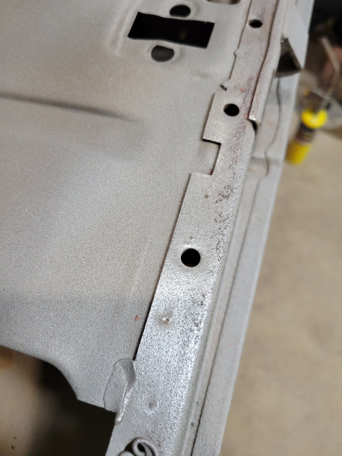

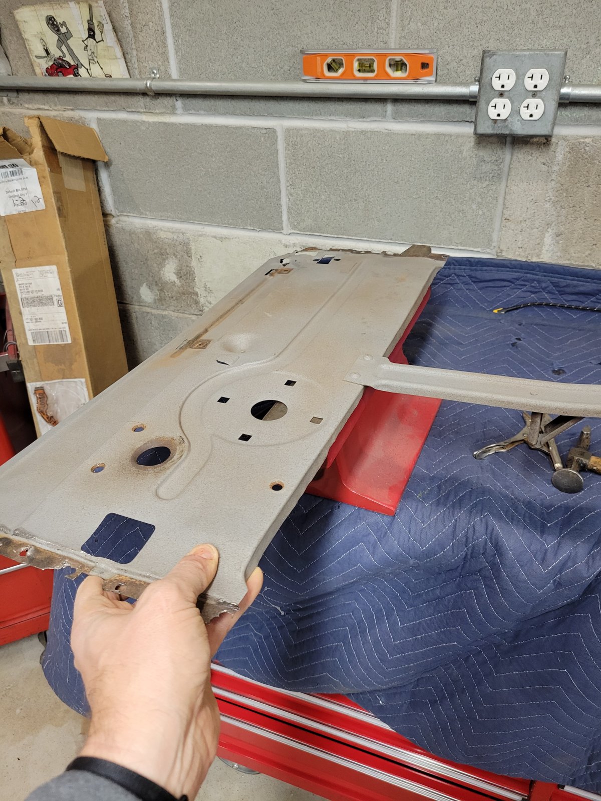

    Passenger Door Top Adjustment:
    Hey fellas, it's been a while!
    I'm back on attempting to get this body into better shape and lessening the amount of issues before I call it good enough and move on.
    The door top on this passenger door must've either warped or just had more curve than the piece it replaced. So, when the door was closed it didn't sit flush at the top.
    For example, here's the driver's side:
    Here's what it looked like:
    The B-pillar side of the top touched the body while the rest had a lot of curvature. The upright part of the door top all sat flush on the b-pillar.
    Pictures don't show just how bad it fit.

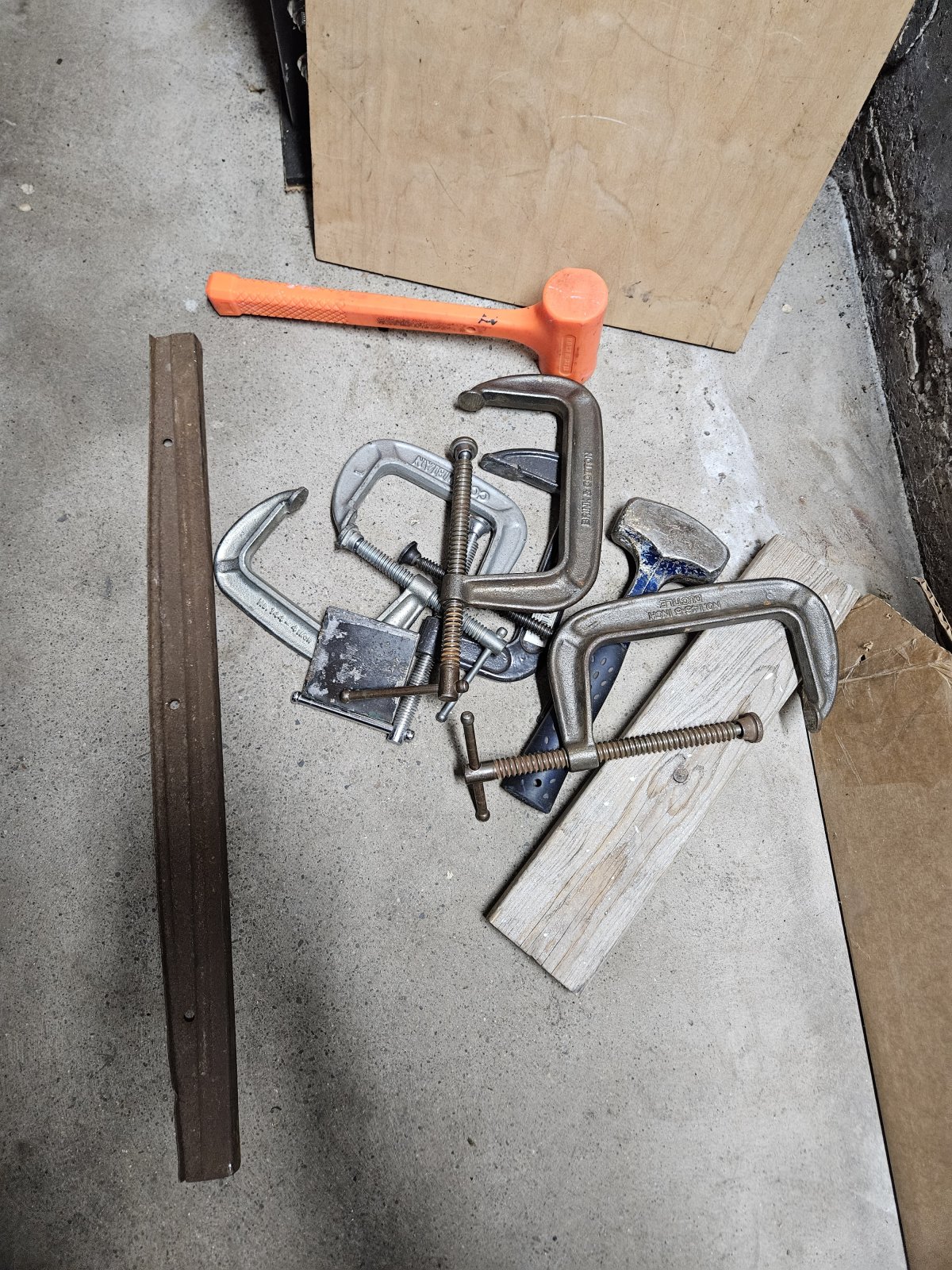

    I pulled the door figuring that would be the easiest plan of attack but with the door off there's no quick reference and I didn't know where to start.
    Once on, I quickly realized that the rear portion of the door (that sat flush on the b-pillar) was the first place I needed to work. A little movement made a big difference.
    Then, as I worked the back (and a little in the front), I could address the center, slightly.
    Now it fits pretty much like it should.
    If this is how it was after it was chopped, I would probably have left it alone. Since I'm messing with it I will fine tune it a little more.
