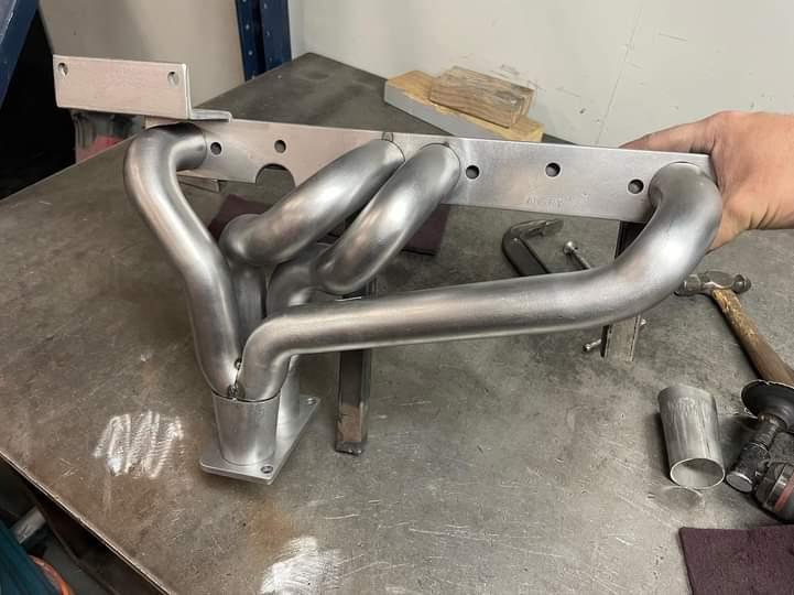

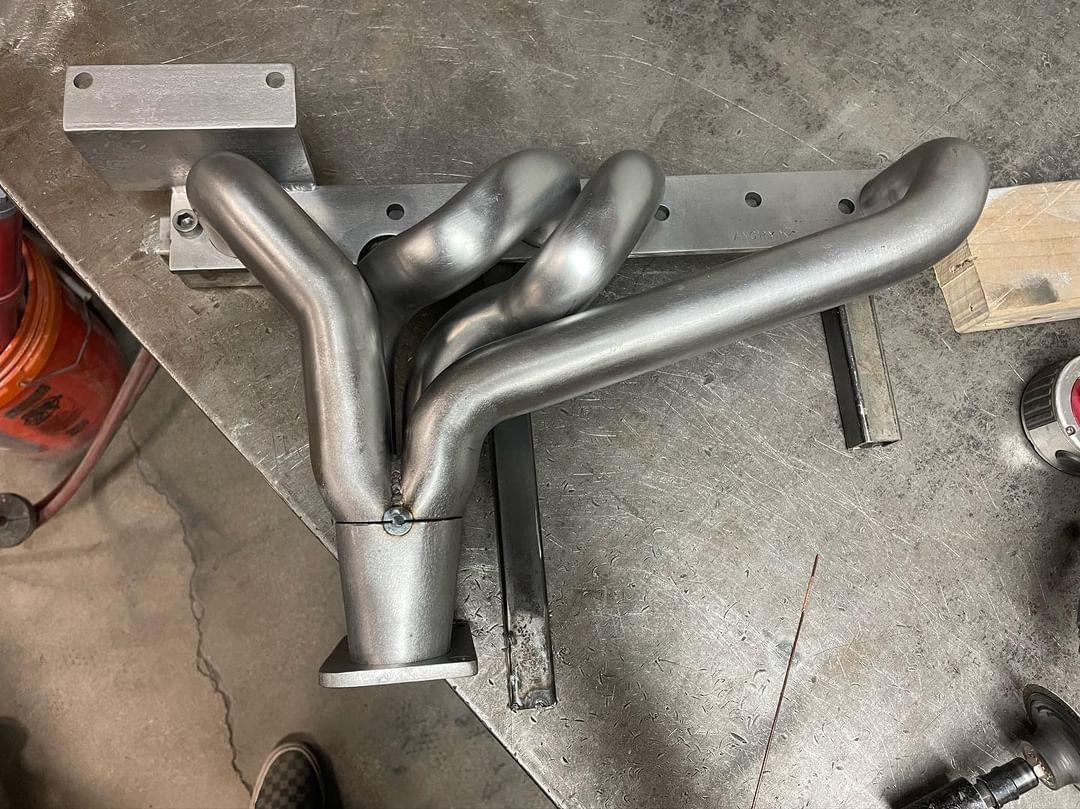

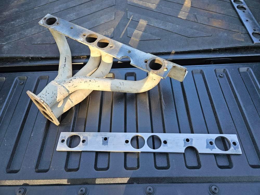

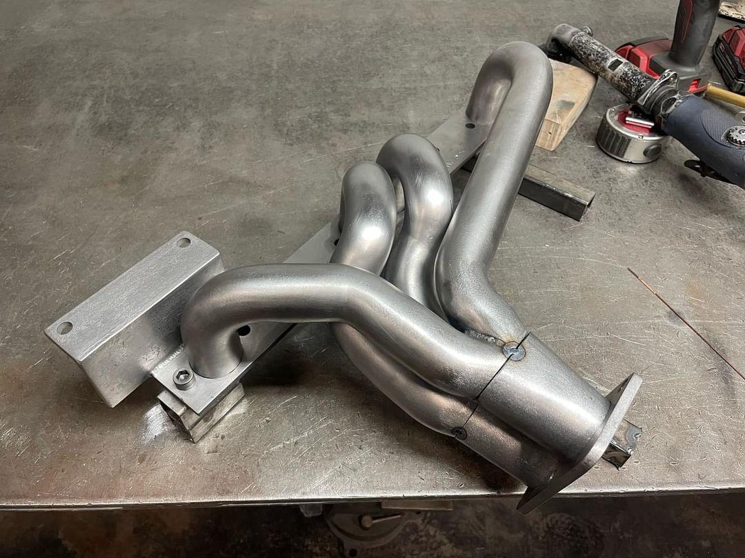

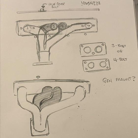

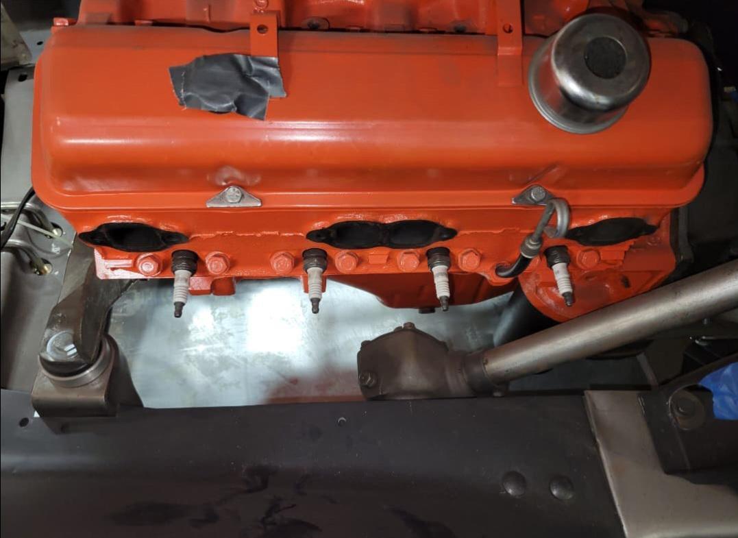

    SBC Header for Model A Ford with F1 Steering Box

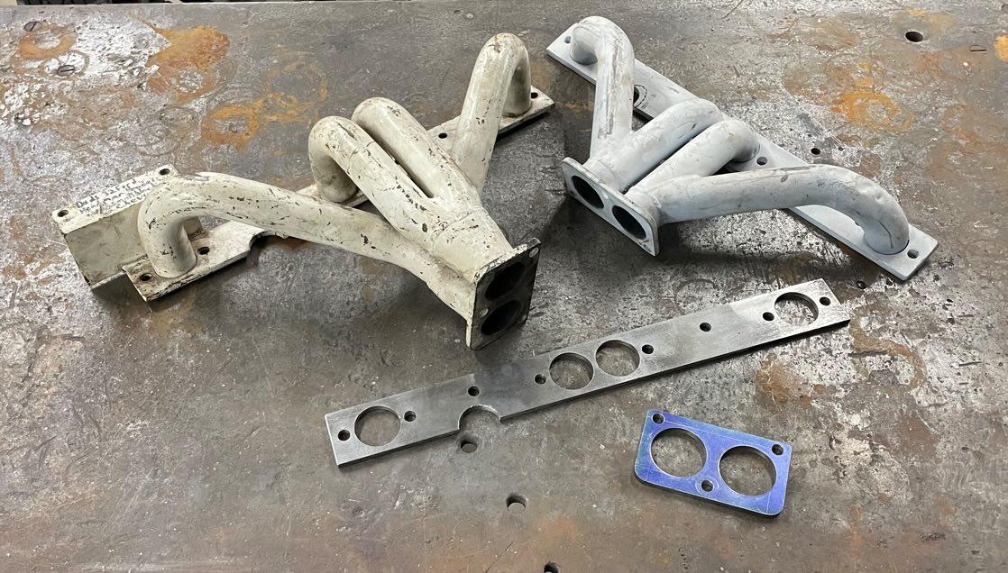

    What seems like yesterday we were discussing headers on the car.
    I had this really great set of Hedmans that didn't have downpipes but were so damn cool. But, like every other guy with an F1 box in a stock frame, I ran into clearance issues. We chatted about it here and that was that. However, I kept the idea of an offset header. I had actually bought a set of Corvette manifolds at one point because they'd solve the problem easily but that would be pushing the issue to a later date. Those manifolds might be fine for a little stocker small block but eventually this car will need to breath.
    A while back, I sent the driver's side Hedman and a new flange my pal Brian cut for me out to @Tex***peed. He had built an offset header for his SBC powered roadster that also had a clearance issue. Since he had already done one, I reached out to see if he'd take on one for me.
    Here's that result:

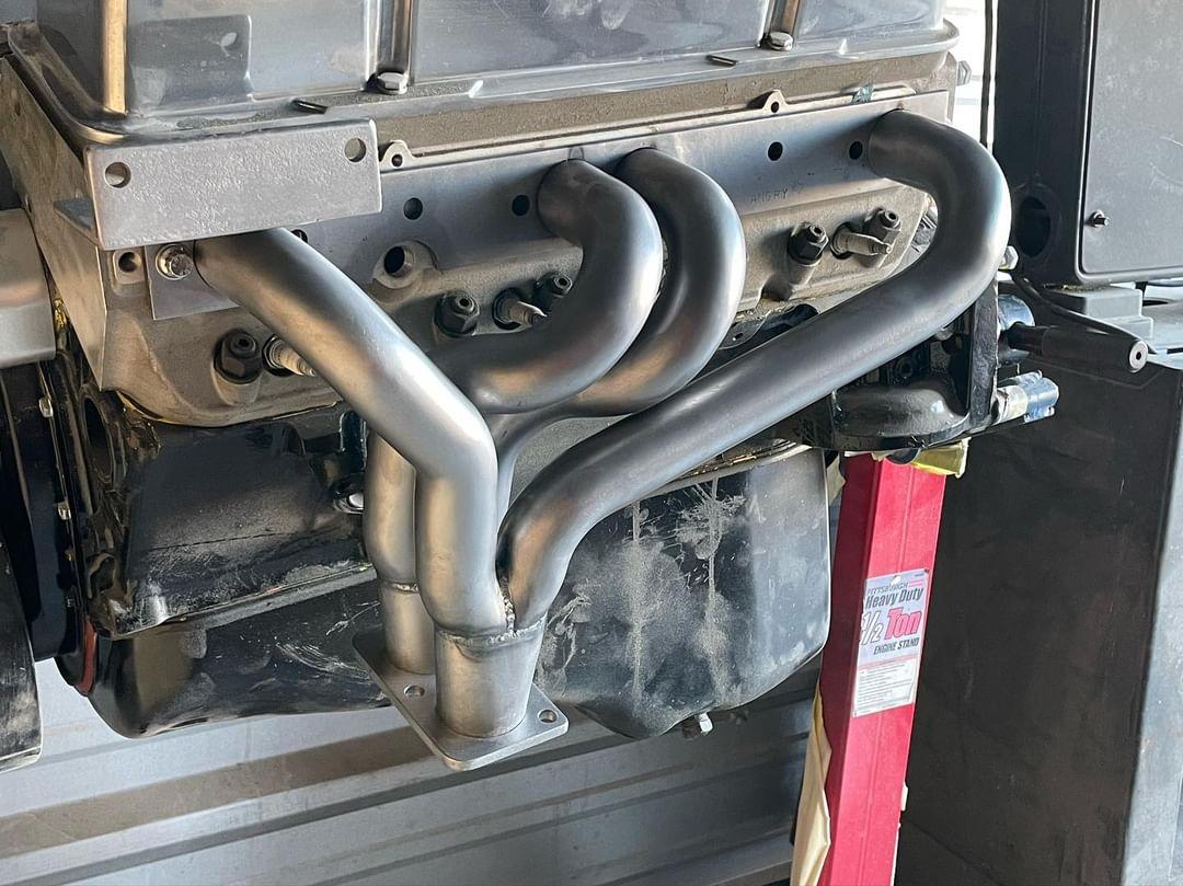

    The space we had to work with.
    The parts.
    Matt putting ideas to paper.
    And then... almost done:

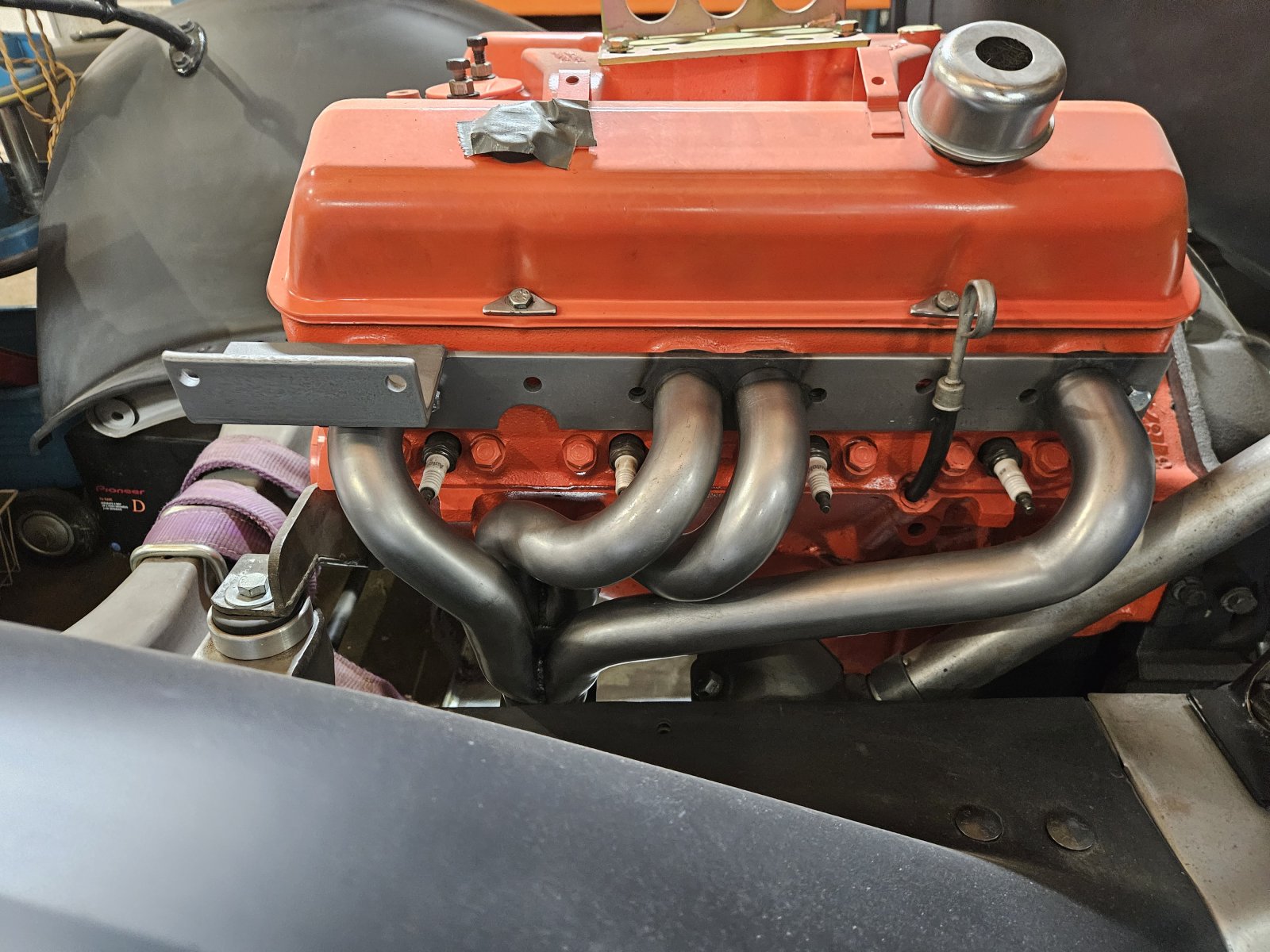

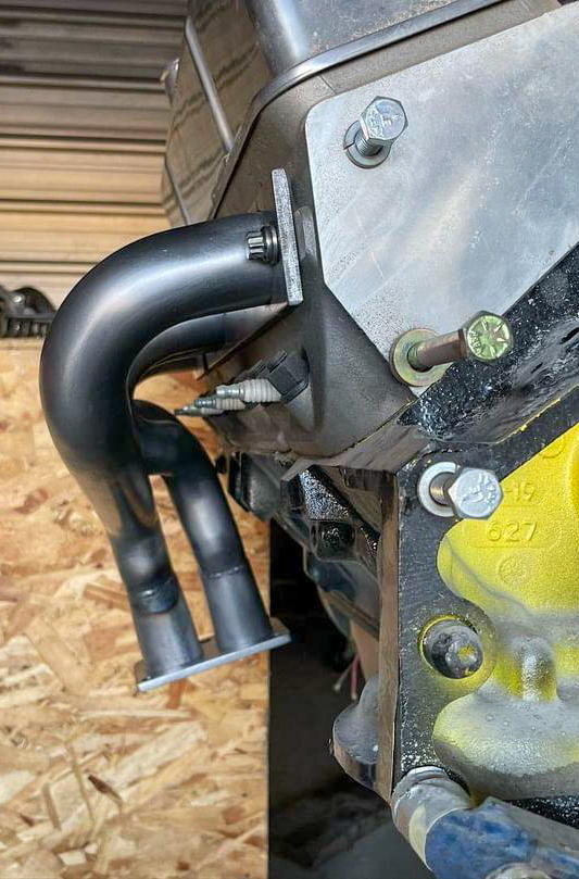

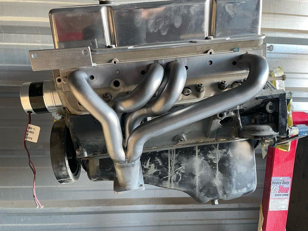

    And the final mock-up:
    Header Done 1.jpg Header Clearance .jpg Header from  back.jpg Header Done 2.jpg
    It's a great sister to the original. The only part retained was the generator bracket. I fully expected to chop up the header but Matt saw that as sacrilege and he fabbed all the critical parts to make them match.

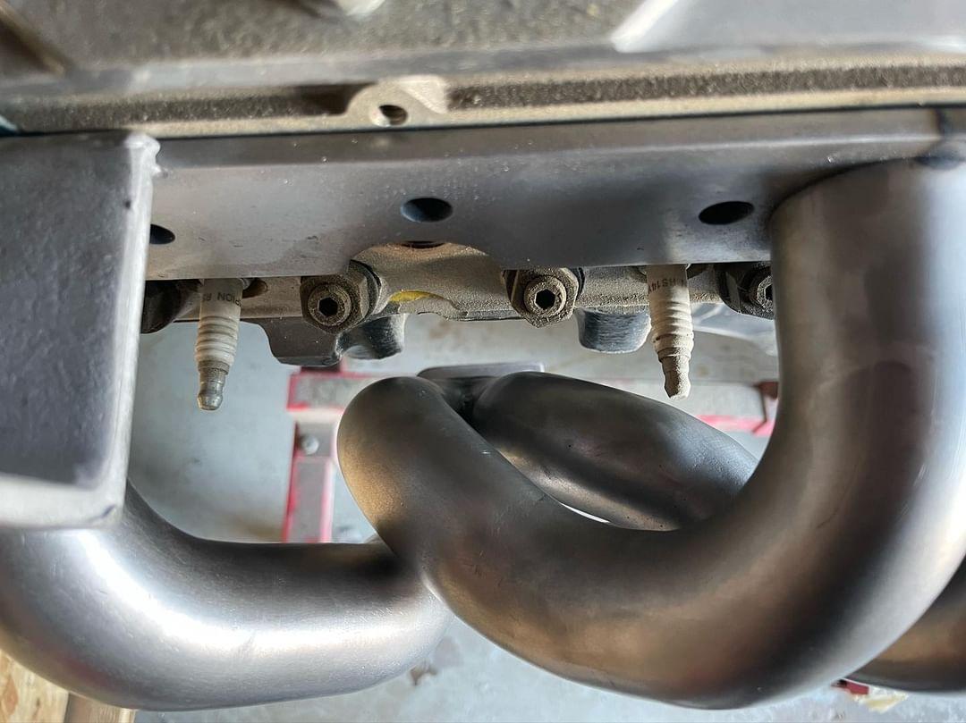

    And finally, it's home:
    It fits perfectly. I'm able to access the plugs and everything clears. It's unique and I think it suits the car very well.

  8. Joe Blow
    Joined: Oct 29, 2016
    Posts: 1,905
    Joe Blow
    A work of art....*****in'.
  9. Tim
    Joined: Mar 2, 2001
    Posts: 20,441
    Tim
    from KCMO
    Man that’s gorgeous. Those tight radius bends are great.

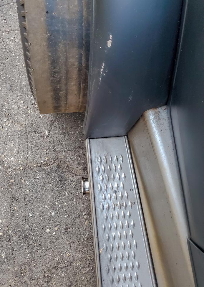

    The exhaust will be "simple" - stainless 2.5" that exits on each side like this.

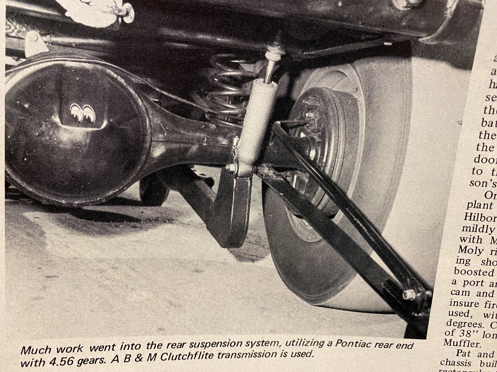

    Flipping thru the May '69 PHR and found this, made me think of your car. Under an Anglia. Same 59-60 Poncho housing. Friggin cool. Keep at it man, headers look great!
    catdad49, Outback, Vic Walter and 8 others like this.
  22. -Brent-
    Joined: Nov 20, 2006
    Posts: 7,860
    -Brent-
    Thanks!
    That's pretty awesome. You have a good memory!
    The builders took the time to remove that center link bracket, too.
