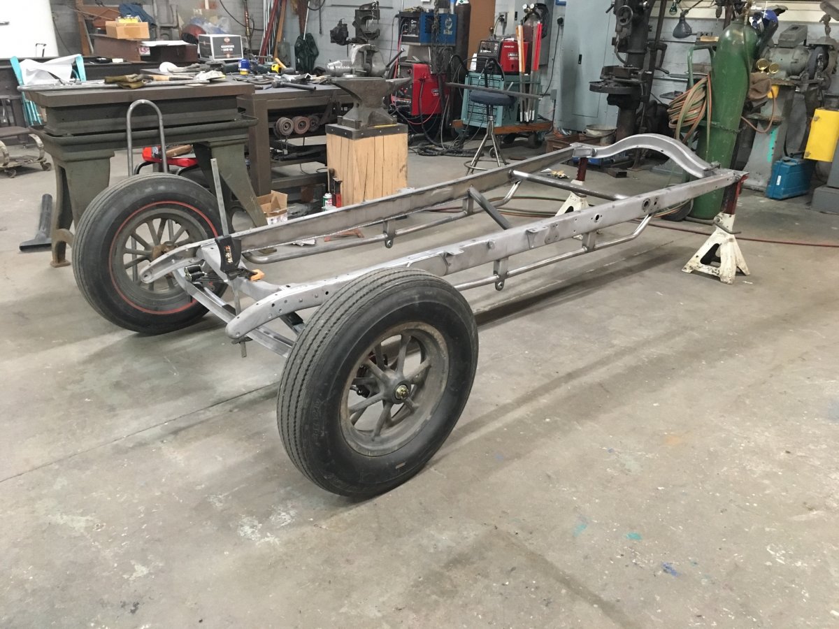

    Half Way To Sitting on Wheels:
    This has been a long time coming! The spindle mounts are for mock-up. I'll be running 16x4, Ford wheels and brakes.

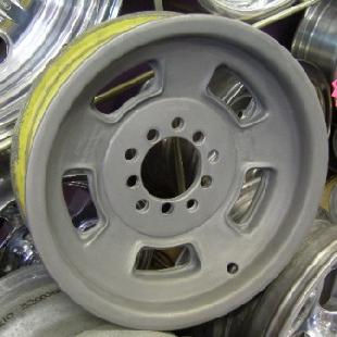

  5. You know Brent, I still have the Halibrand mag front spindle mounts that match the rears I sent you. Front brakes aren’t that big a deal, just 60% of your braking power.[emoji3]

    @duncan et al., no dice, not for me, anyway. Even though I think they're awesome wheels and have pals who run them I can think of a few better wheels that fit the plan. Now, if you had a set of these, THAT would be another story.

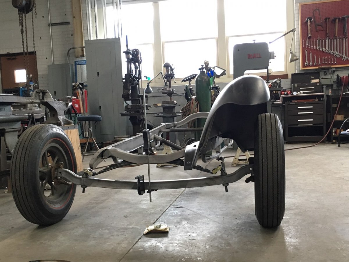

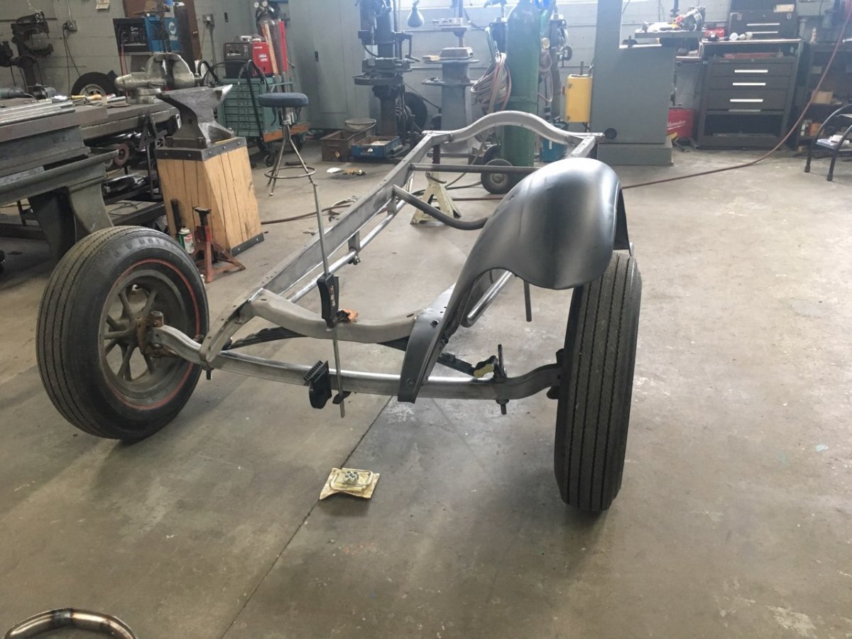

    Sometimes, you need to toss a fender on to see the idea.
  10. Tim
    Joined: Mar 2, 2001
    Posts: 20,460
    Tim
    from KCMO
    It’s cool how radically altered the fenders are but it’s not something people will notice right away.
    Just that something is different

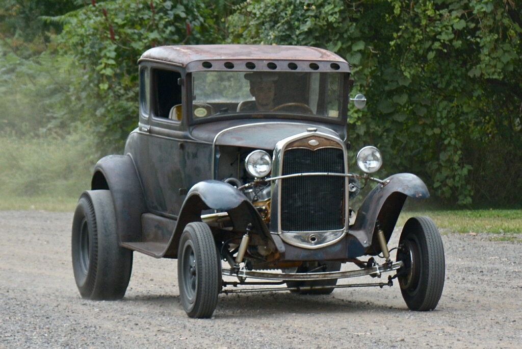

    When I first saw the Maratta car, in pics, I didn't know why it looked fast sitting still. Eventually, the car was found and I've been a student of it since. The fenders from this car are why I did mine.
    I send updates over to Dean, who now owns the Maratta Rake/Missile, and he sent this pic, today.
    It's a good visual to understand the look. Close to the same section width has been removed.

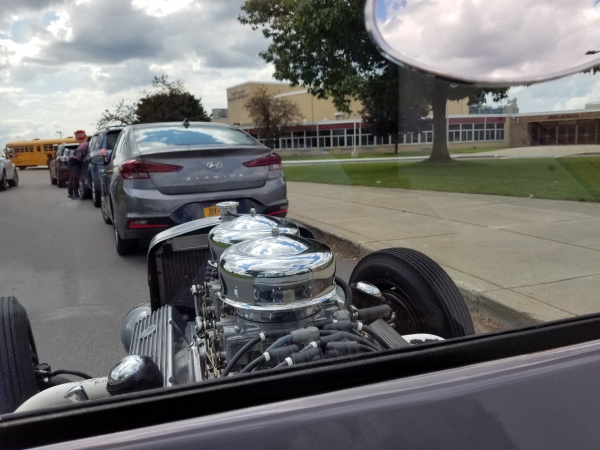

    You know I pick up my son every Friday from school since he was in grade school, if it's not snowing or raining it's in one of the cars and all my cars are rowdy. Kids yell out the windows, a teacher once ask my son if I owned any normal cars, when school let's out lots of kids come by to check them out, they all know it's Connor's dad when they hear the rumble they tell me, even comes up at parent teacher conference...ha ha
    He's asked me to take him to school on the last day in the Henry J and pick him up in the t-bucket, I took off work to oblige, last year he ask me to do a burnout on the last day. Kids love old cars and you better make sure you corrupt their senses when you get that thing done !

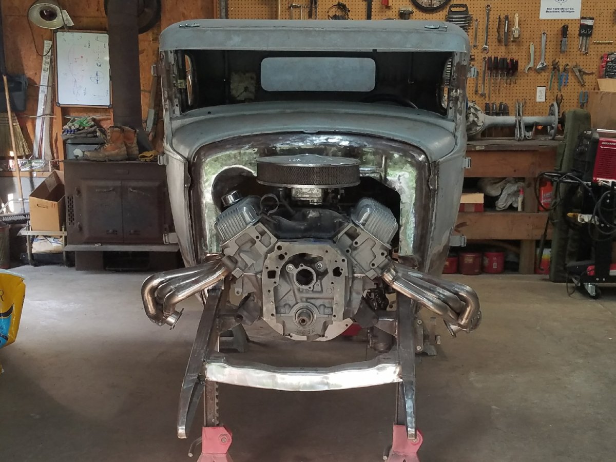

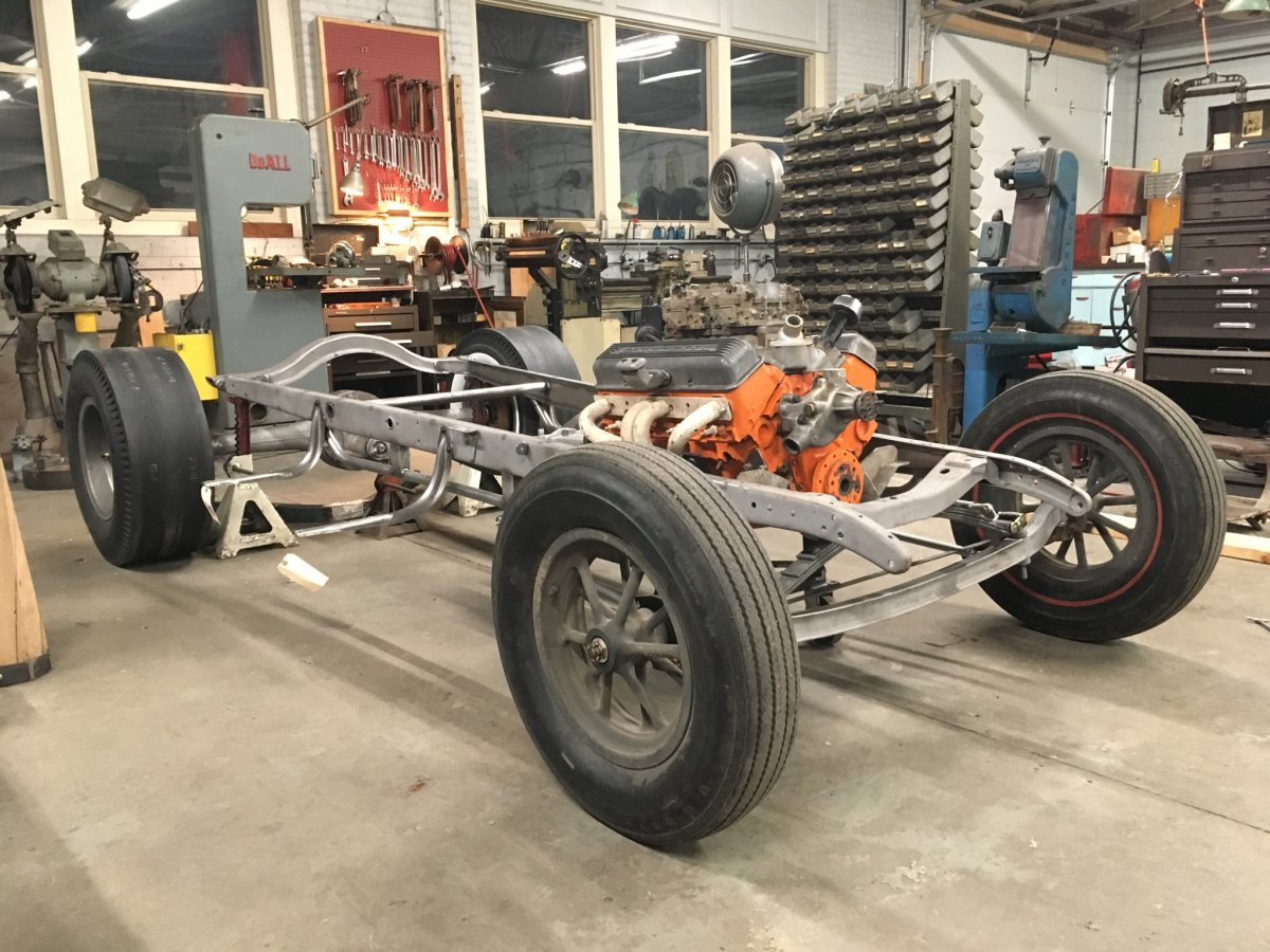

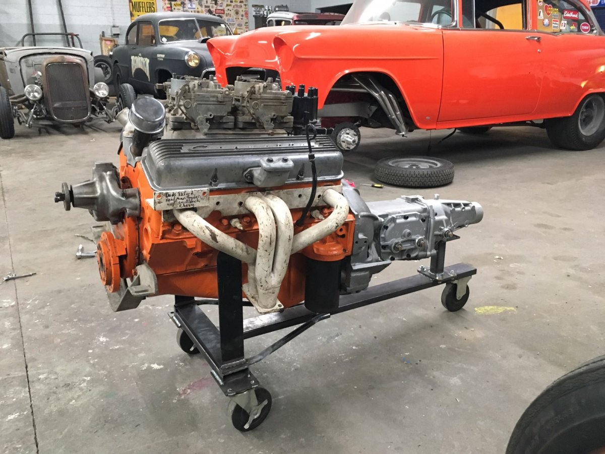

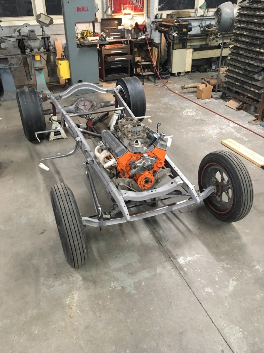

    We're at this point that in order to get the rear situated, we need to get the engine/trans mocked AND in order to set the engine and trans we need the steering box placed AND in order to get the steering box placed we need the body in place.
    All that said, here's a teaser of the mock-up engine with my bellhousing, trans, headers and Hurst mount. Most likely the dual quad will end up on my 327.
    I'd love my motor to be dressed similarly.
    The headers may not stay. If they do, the driver's side is going to need to be modified to clear the steering box.
    Anyway, the teasers:
    It's just sitting there... for the imagination.

    Any idea what brand the headers are? Hedman? Doug's? Or what they were designed for?

    They are Hedman's. Got them from a HAMBer whose dad was going to run them on a 32 but it never happened.
    They're likely not going to work in this car, either because the driver's side is probably going to be right in the way of the steering box.
    Originally I was thinking Nova II manifolds swapped to diver to p***enger and p***enger to driver. Brezezinski's modifies them for racing and they'd probably work well... just not look as cool.

    Consider that a drag coupe deserves wild, g***er style headers to compliment the wicked stance.
    Home built headers are my favorite hot rodding task.

    Keeping restraint in mind, I don't want to go wild. There are plenty of examples of 60s hot rods running stock manifolds. Lots of them chromed. One that comes to mind is Jeff Black's 28/29 roadster with a 327 and a chrome frame.
    Right now, headers/manifolds rank a lot lower in importance. Having slept on it, a neat set-up would be to have something similar to these headers that drops 6" more toward the front. That would allow a lot more clearance.
