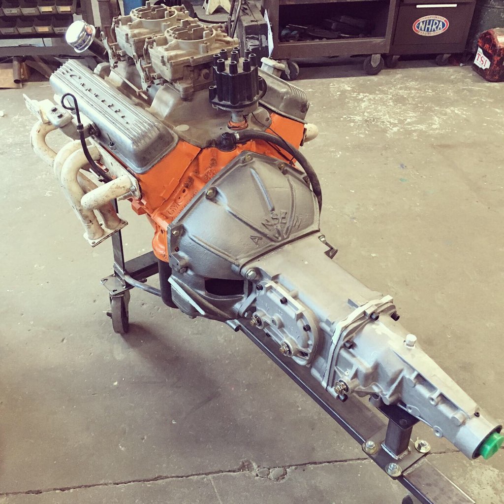

    Ryan made this stand/cart to move the engine/trans around.
    The pics were pretty neat of the motor so I figured I'd share them. The engine is an ol' worn 283.
    Ansen Bellhousing Autogear M23 Dual Quad 283 Headman Headers Hurst Weiand.jpg
    Looking at the above pic has me really wanting to figure a way to rework this side header so the outlet is angled forward and it clears the steering box. I think with a little finesse it could happen.
    The bellhousing is an Ansen blowproof. The trans is an Autogear M23. Headers vintage Hedman. The front mount is an original Hurst. Intake is a Weiand WCV 283.

    I've been looking at them with solving the fitment problem, in mind. It's possible and probably less expensive than replacing them with something else.
    They collector needs to be tilted, say at a 45 and moved forward a few inches and maybe up a bit.

    The fenders are pretty uncommon. There was a lot of modifying and chopping up going on but I think Maratta was onto something with the Missile. His fenders, because they looked rather stock, probably didn't get a second look by many, including the guys inspecting the car.
    I don't have the corresponding ends for the Hedmans. If I end up running them, my plan was to get some stainless flanges cut for the down pipes to continue on.

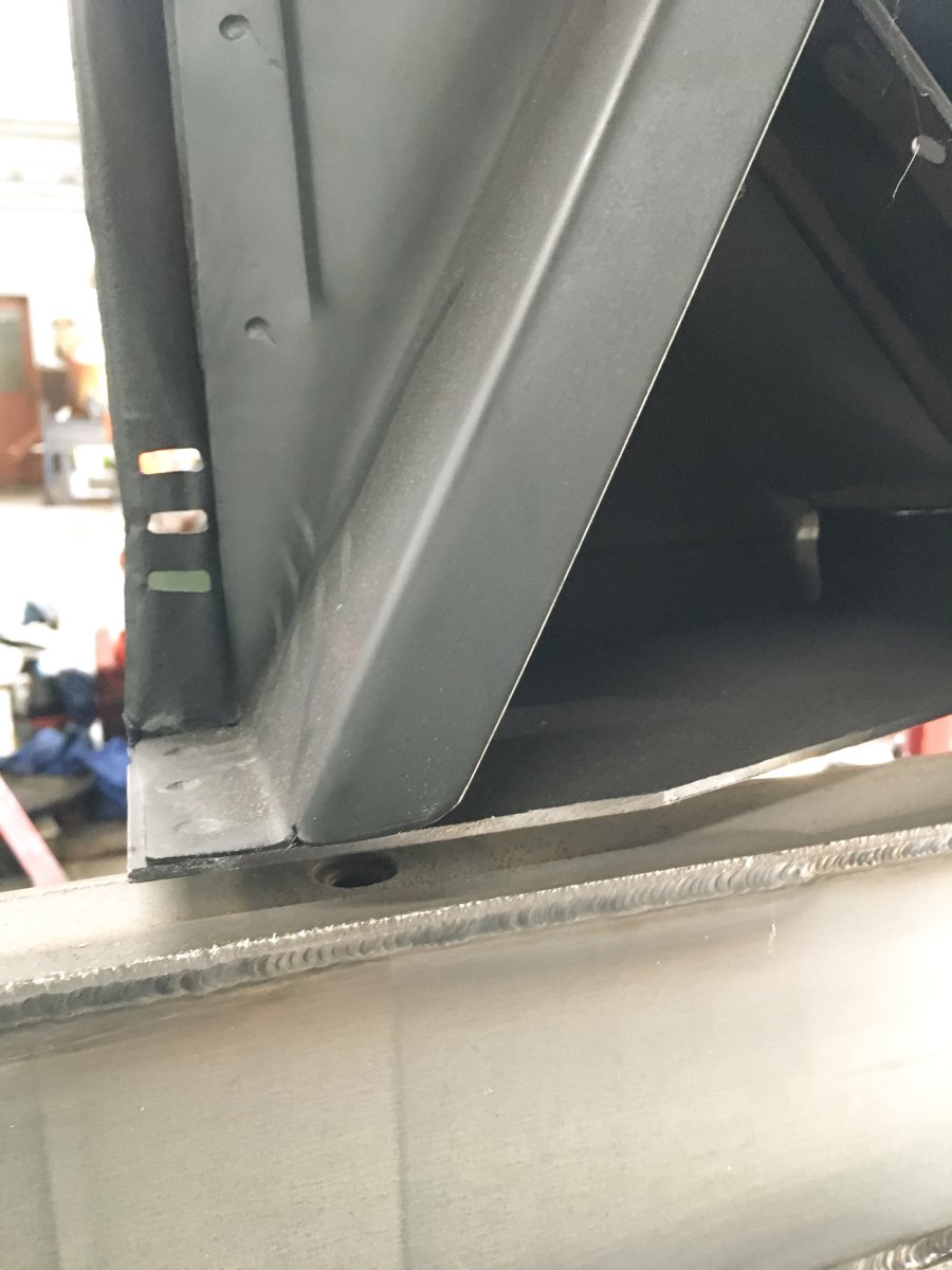

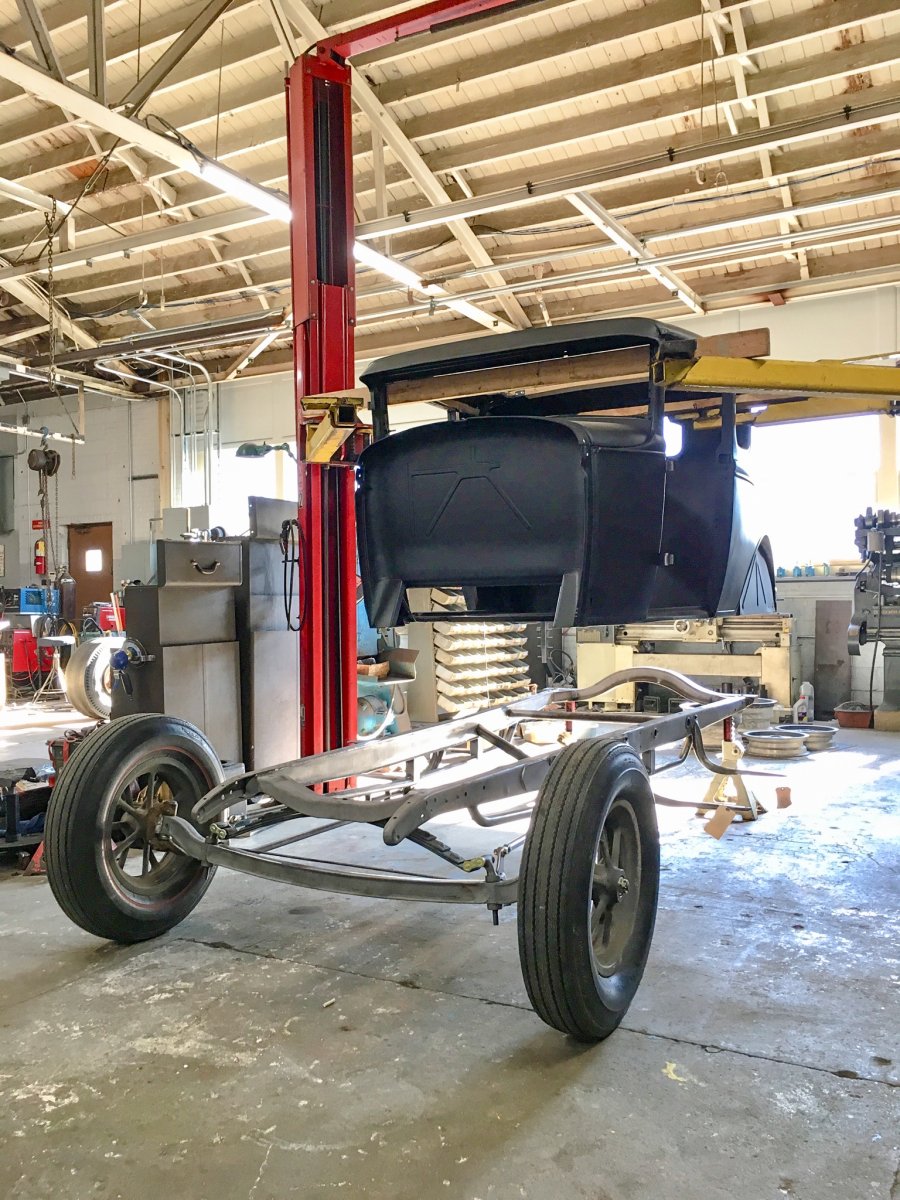

    Starting the body mount process:
    Got to pop a hole in here to make putting a bolt in easier. Later on we'll make a relief or a cap or something.

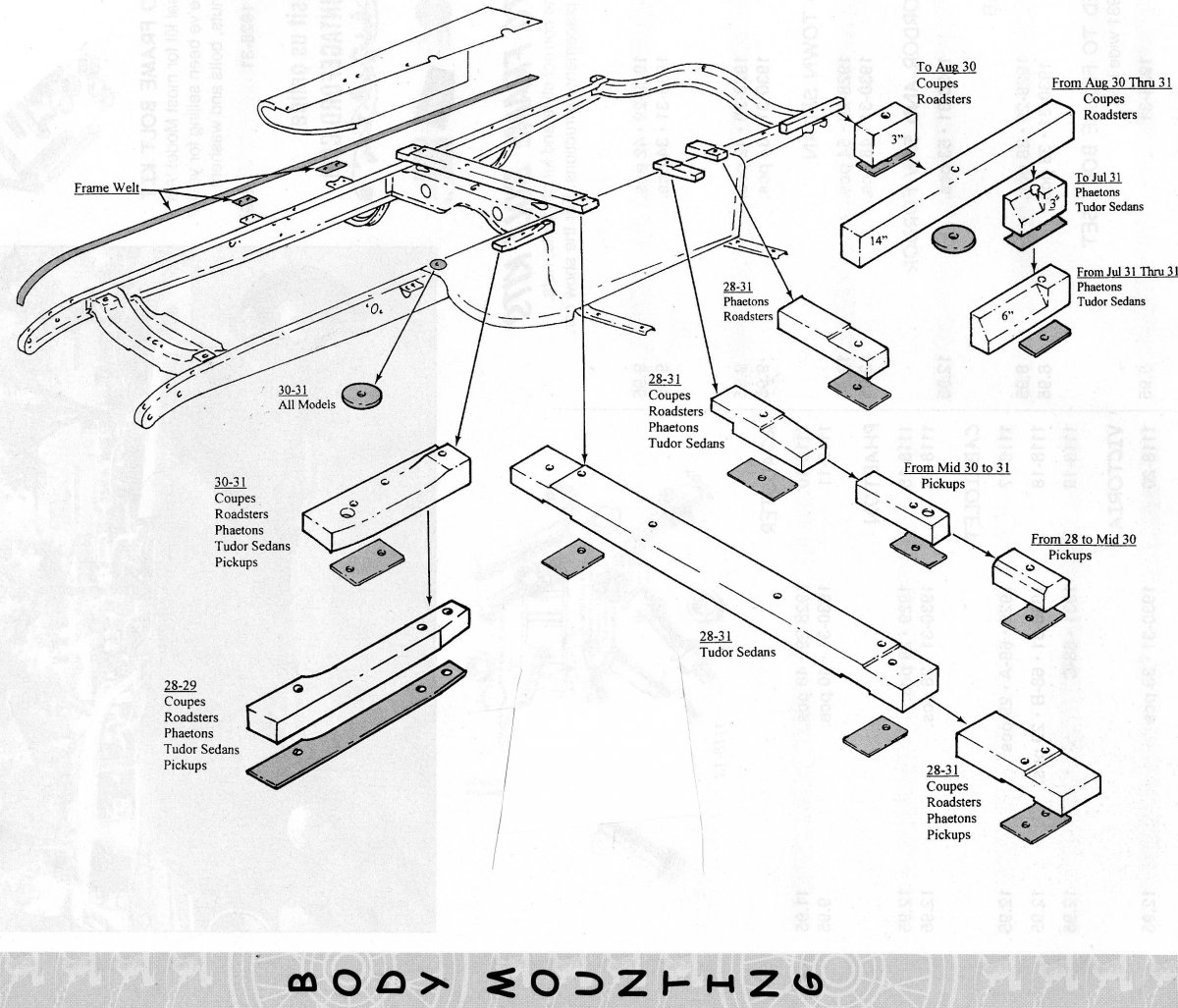

    Information from the archives show that Henry did not put bolts thru the body and frame at the firewall. He said the body needed to be able to flex there
    loudbang and -Brent- like this.
  15. -Brent-
    Joined: Nov 20, 2006
    Posts: 7,860
    -Brent-
    I have pulled bolts from that location from a few cowls.
  16. 6sally6

  18. manyolcars
    Joined: Mar 30, 2001
    Posts: 9,609
    manyolcars
    I have too.They may have been added and its possible the info was for 28-29.I searched Fordbarn but couldnt find that post today

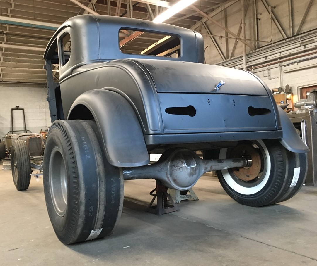

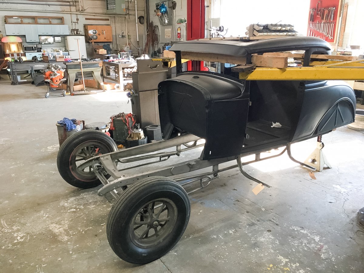

    The kid in me is psyched!!!
    It's not a full mock-up. Just enough to get the body correctly in place.

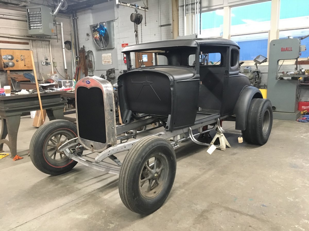

    First person I sent this pic to was Matt. The rear bob is perfect in my opinion.
    It'll likely sit a bit higher than this on the A spring. I'm thinking I may have to get one with a reversed eye main leaf.
    The stance will be different... imagine it with some rake.

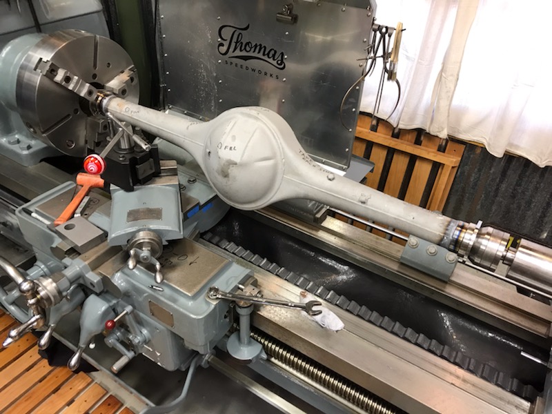

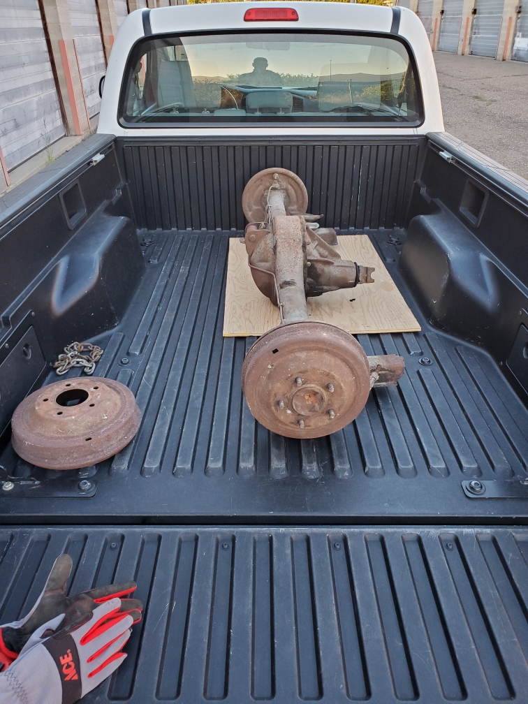

    Actually, the rear has been narrowed 6". It came out of this 59 Pontiac.
    It's big, now, but it was way too big, before. Haha.
    I stripped it down and had it blasted.
    Then, a pal narrowed it and put new Pontiac ends on it. Looking back, I should have used Ford ends and saved myself some money on brake parts.
    Here it is, looking "skinny".
    This is just about what an Early Bronco 9" measures.
    The Maratta Missile's rear is a similar width and that car has been an influence.
