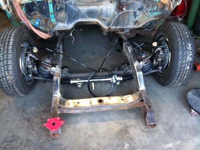

  28. JakeDW
    Joined: Sep 30, 2012
    Posts: 580
    JakeDW
    from Missouri
    I am doing a mm2 kit to get it to lay on the frame I had to Z the front 2 1/2in and get rid of the trans cross.
    Wow just realized this thread is 3 years old lol.
    Jake

  30. JakeDW
    Posts: 580
    JakeDW
    from Missouri
    How far does the cross hang down below the frame.
    Jake
