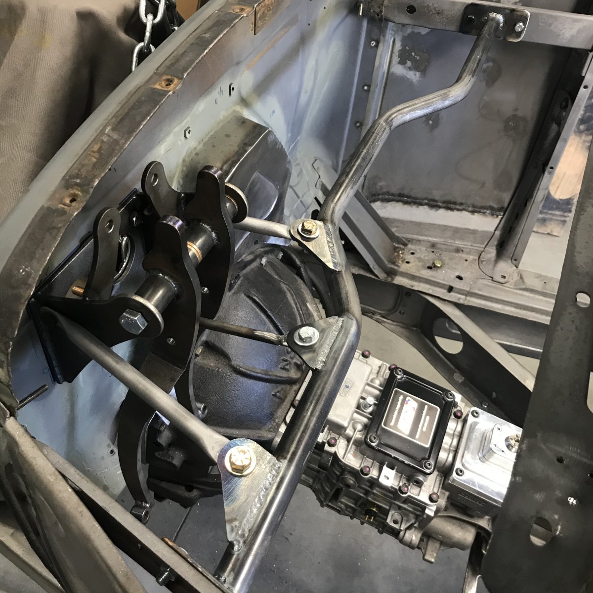

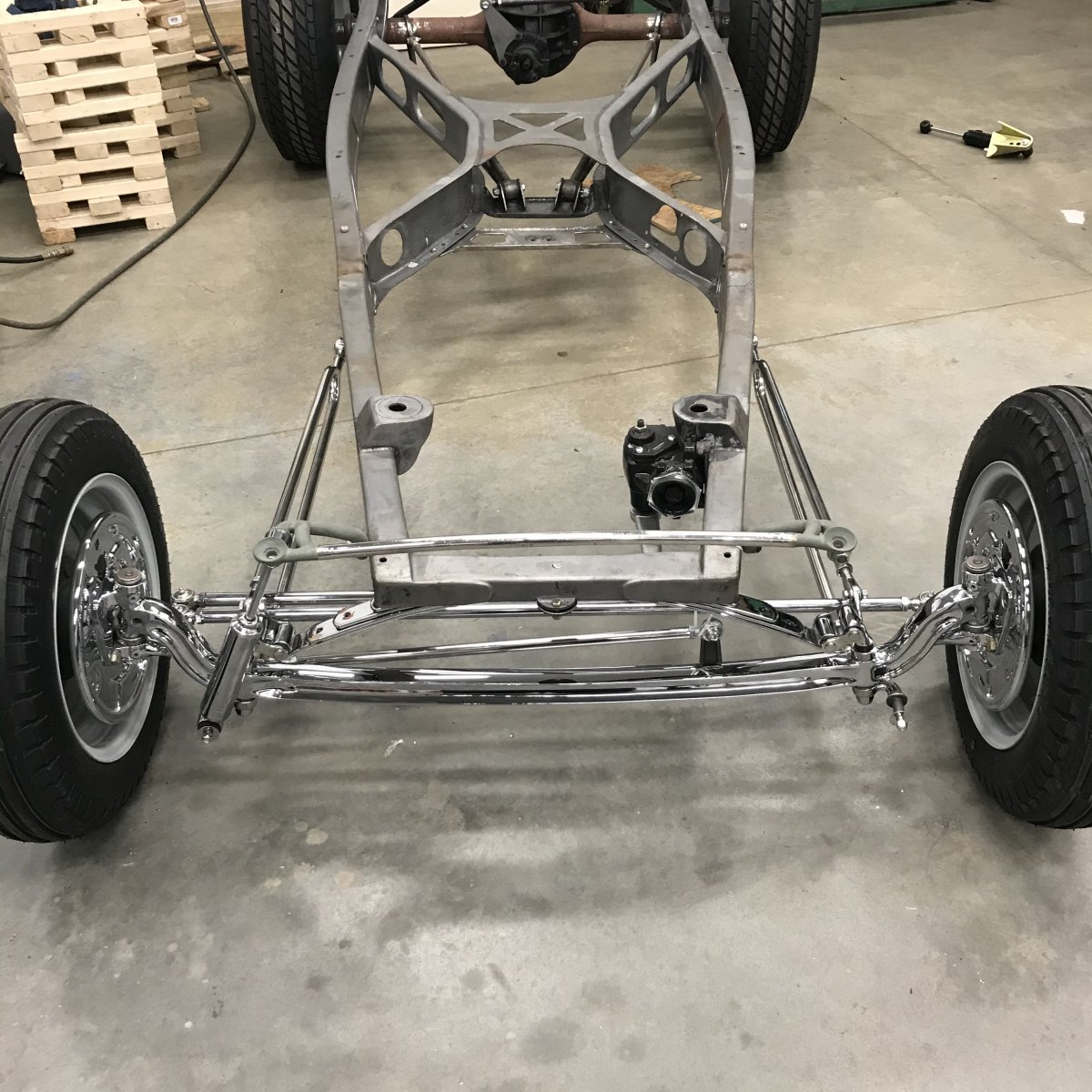

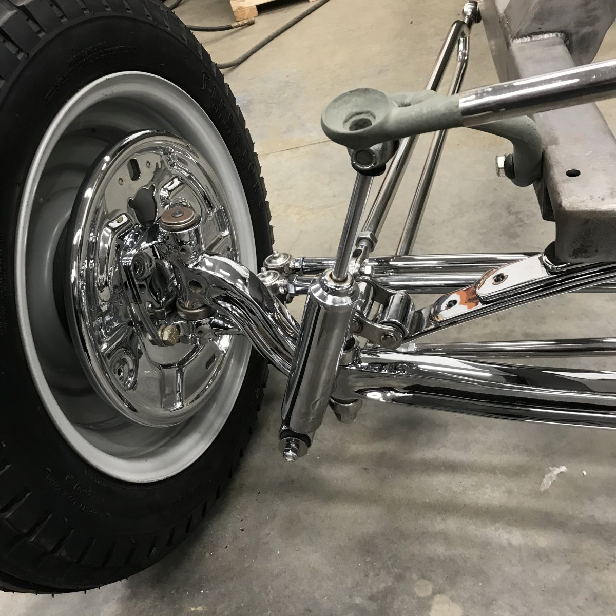

    Its a ubolt elimination style setup. Somewhat visible in this photo. Besides the visible tabs, there is a matching plate under the spring pack.

    Thank you. I really like the clean look of your set up.

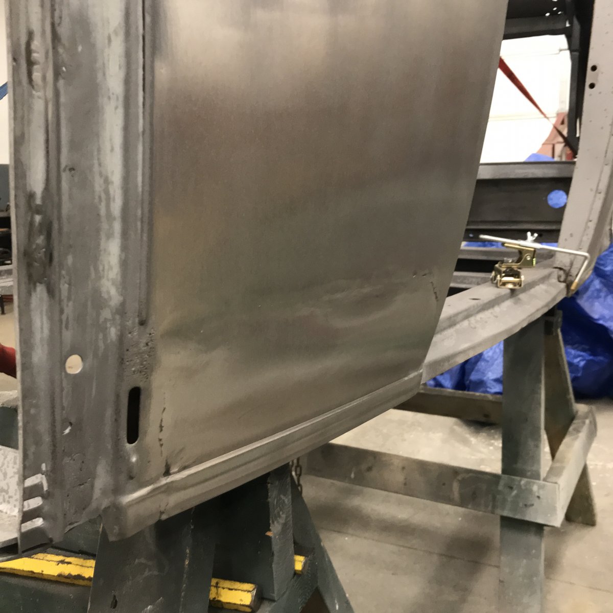

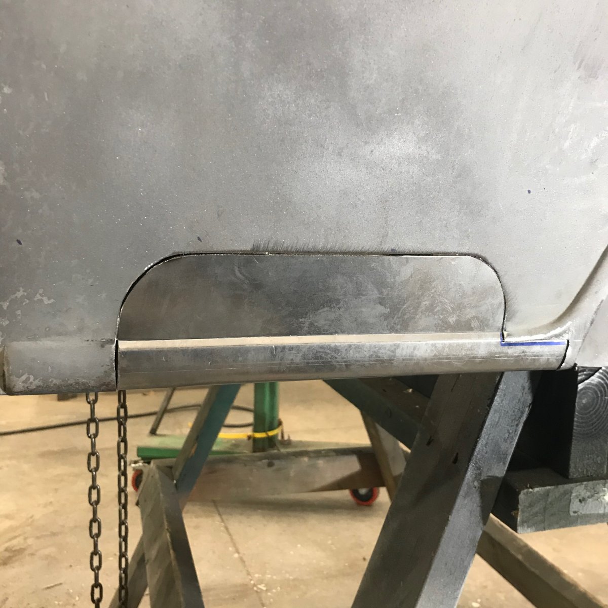

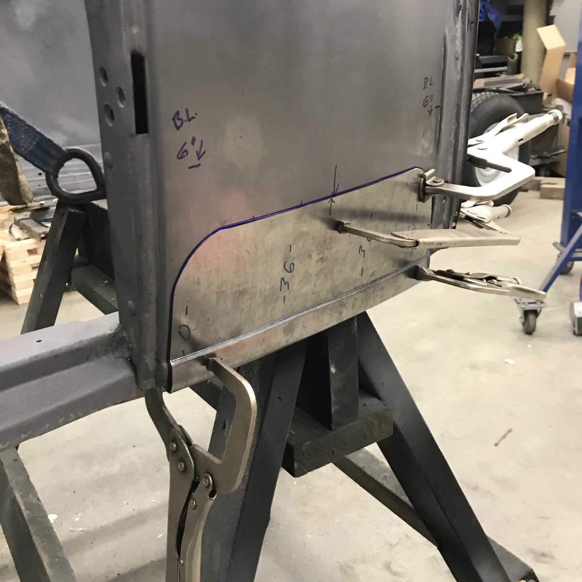

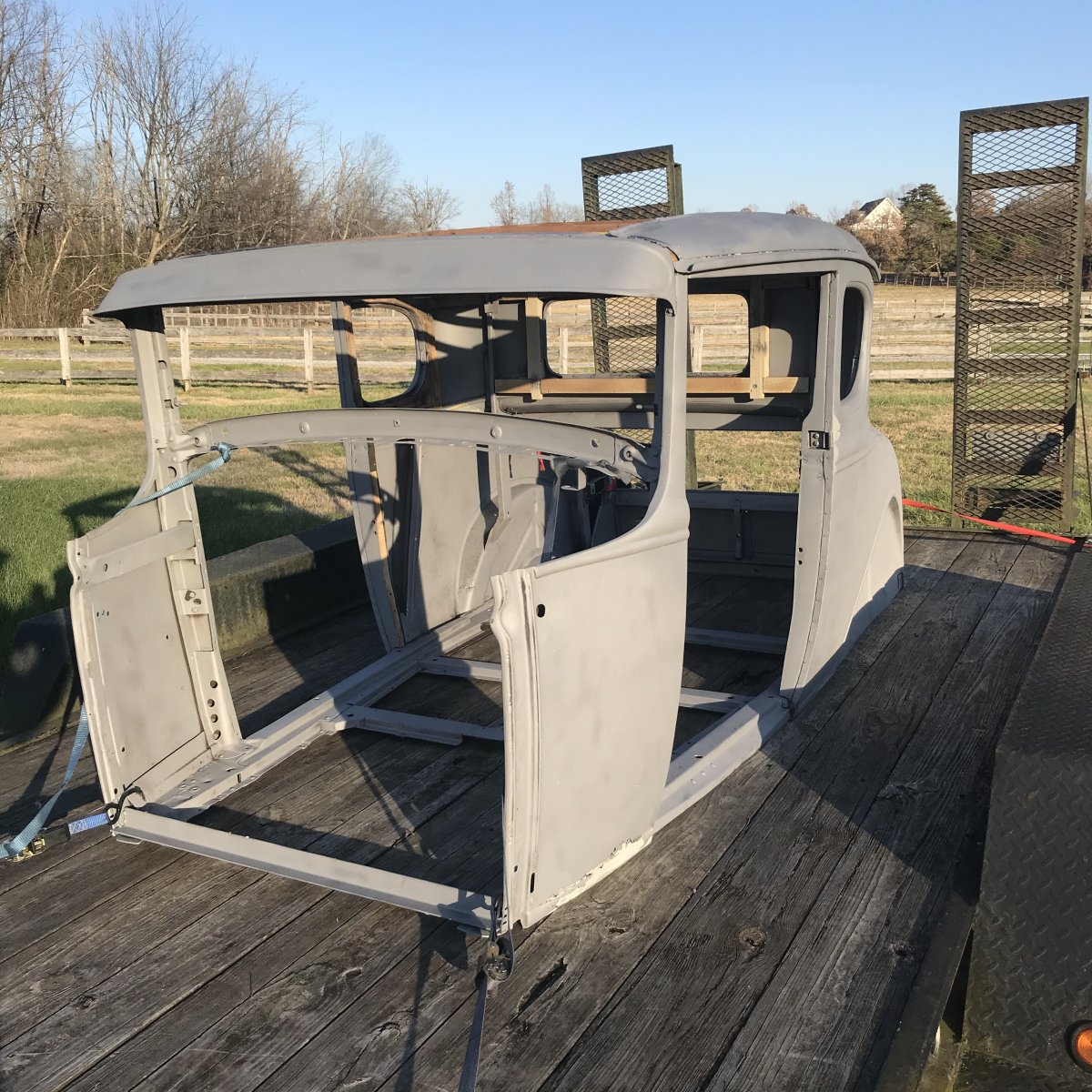

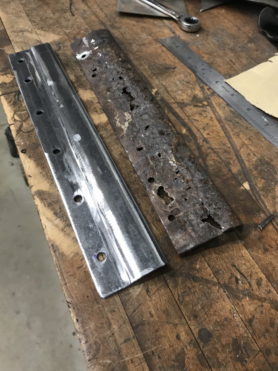

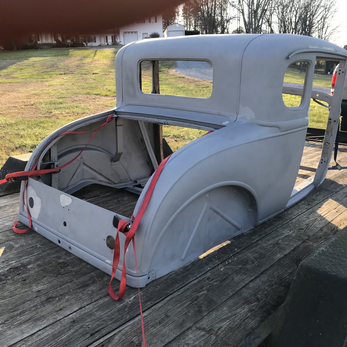

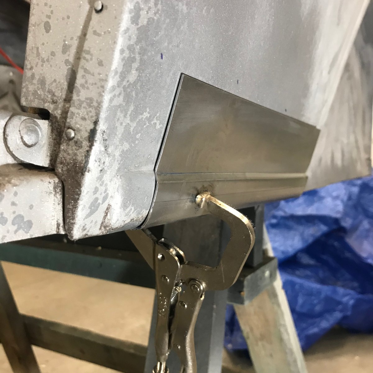

    Took a while to get the body blasted. No surprises. Solid body with a couple small patches. Since patch panels typically aren't the best fit, I'll make my own. Some progress photos.

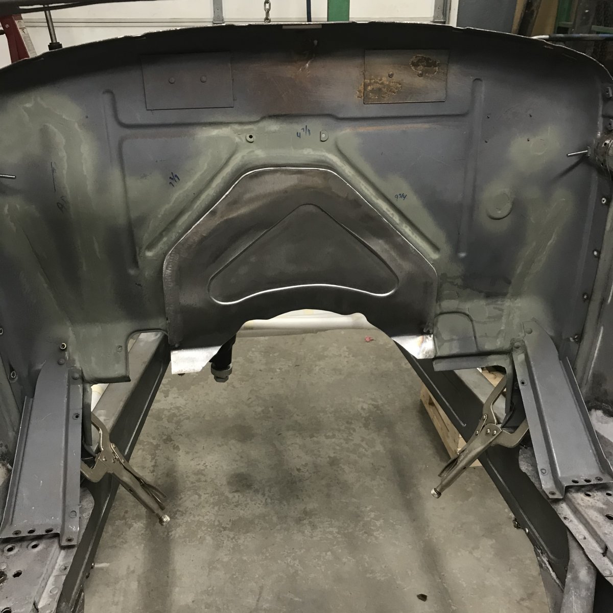

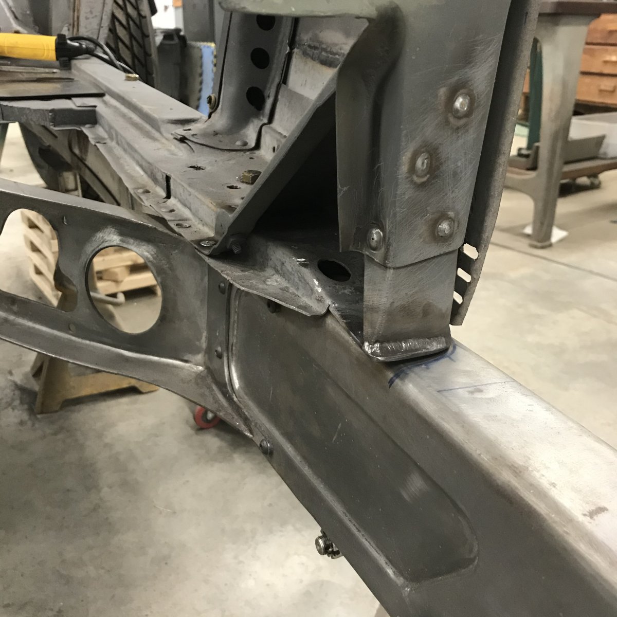

    I have an idea of where you cut your subrails at the front to spread your firewall but I’d love to see some pictures if you have any. Thanks in advance!
    Stogy likes this.
  14. wdglide
    Joined: Jun 21, 2009
    Posts: 310
    wdglide
    I don't have any photos, but it was a few inches back from the front end but still under the toeboard. I'm going by memory, but I'm pretty sure thats where it is.
    Used Up Junk likes this.

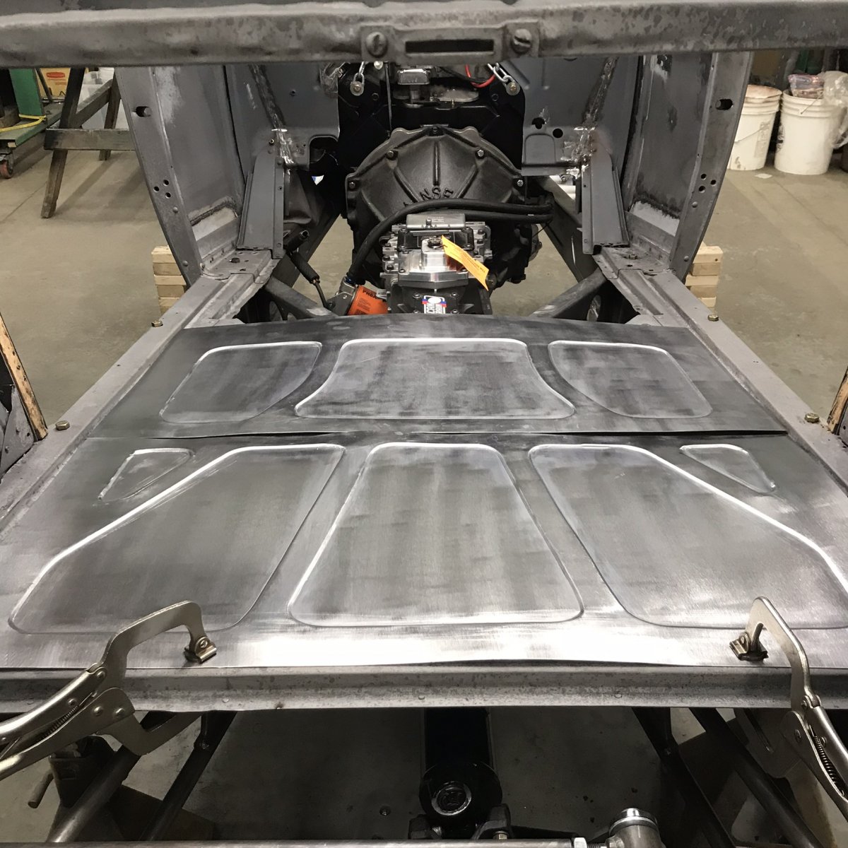

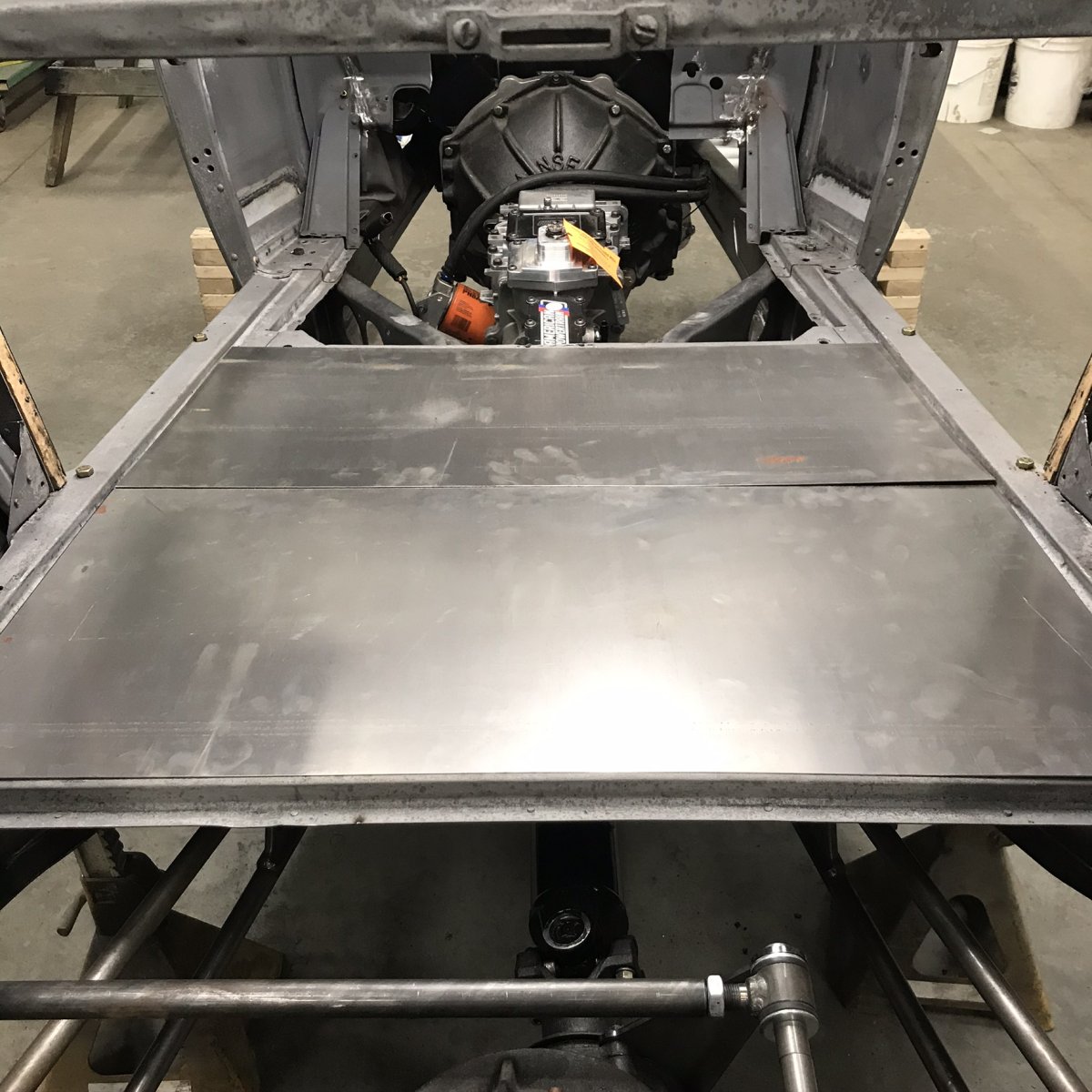

    Floors started.

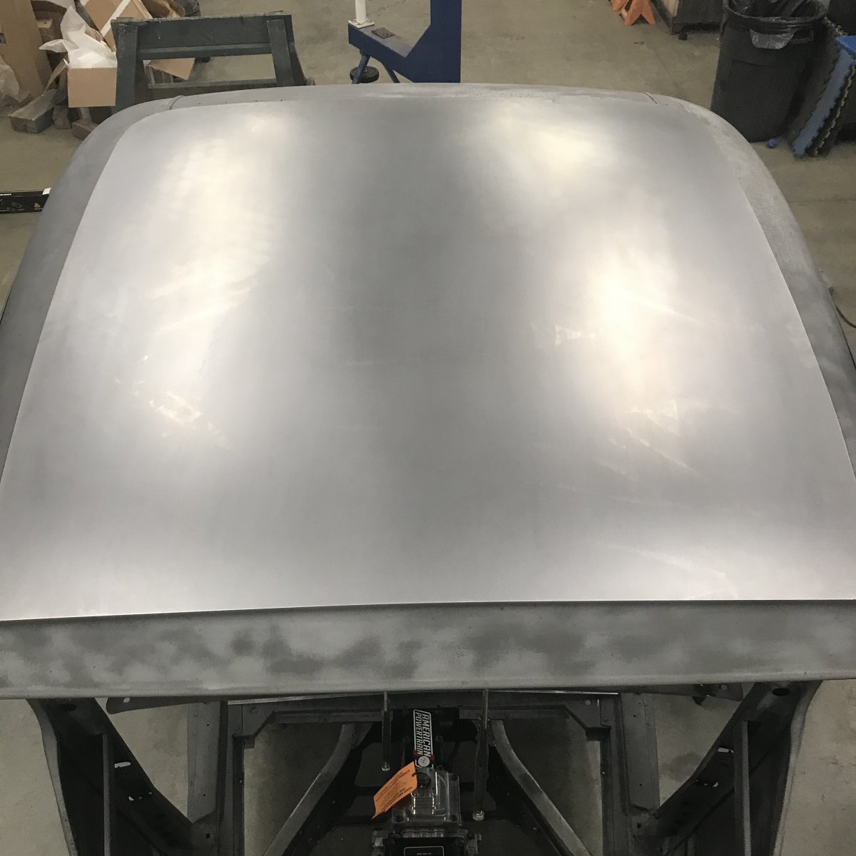

    Roof insert. From Walden.

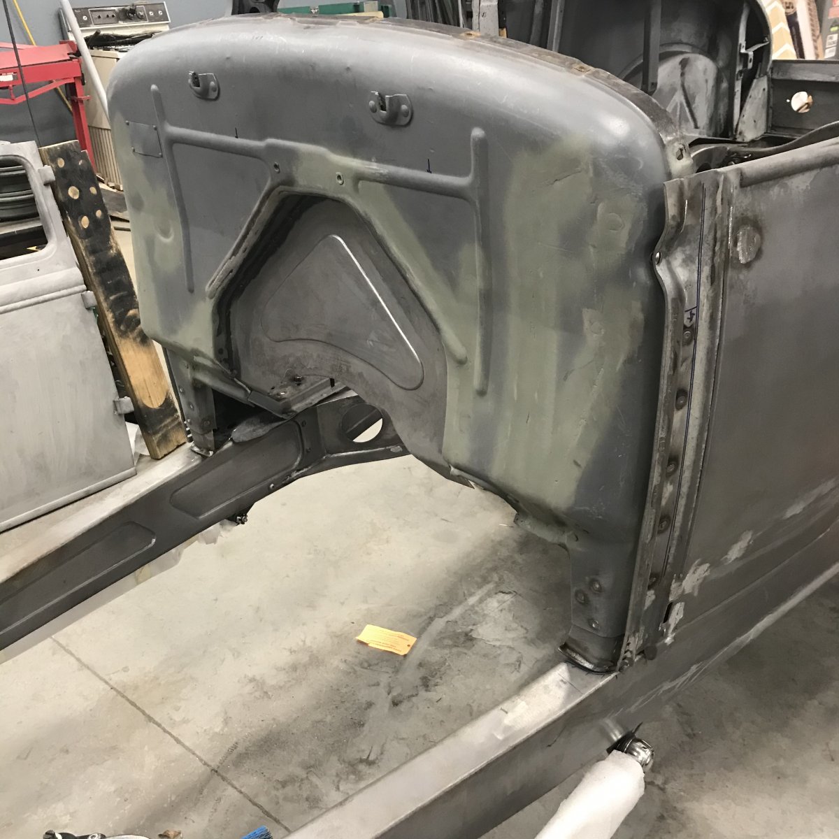

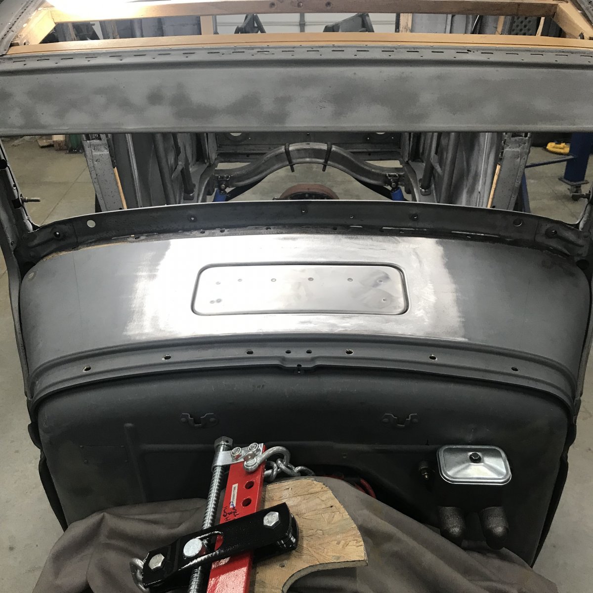

    90% done with the firewall. Probably was as much time and effort as a chop. I had to widen the bottom about an inch, leaving the top stock. Also included some shots of the firewall feet area.

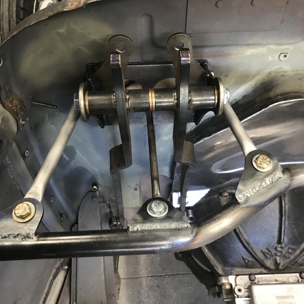

    Some updates. Not sure why I'm doing this. Seems like the hamb is a ghost town these last few months.

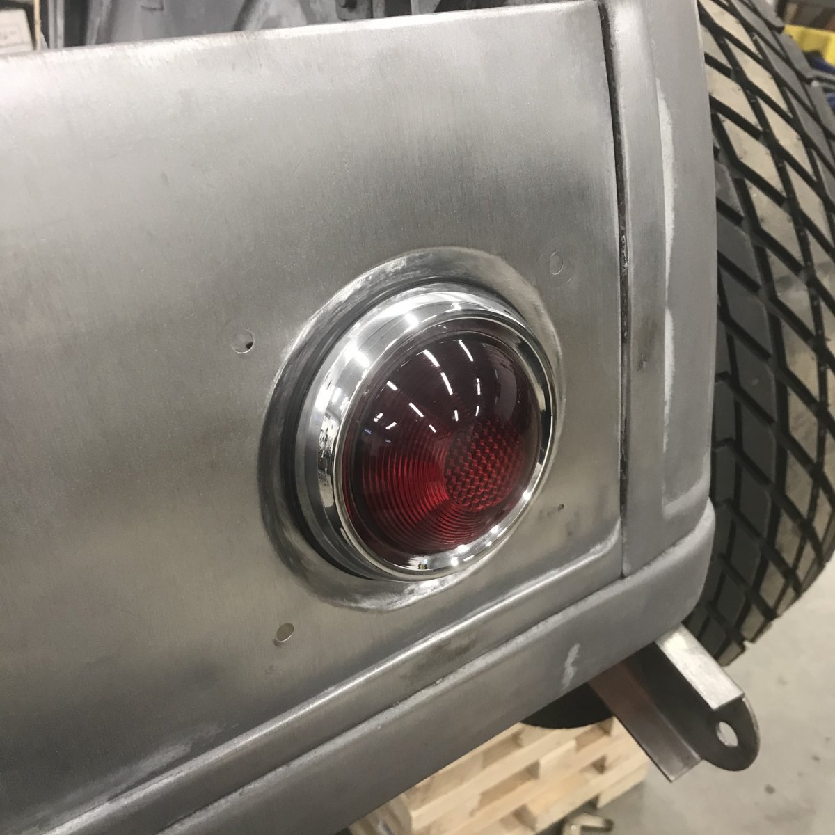

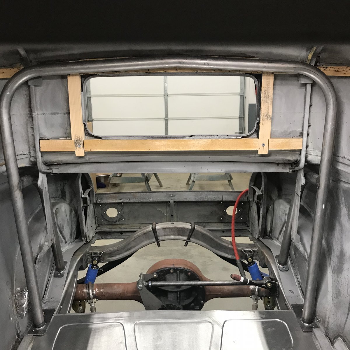

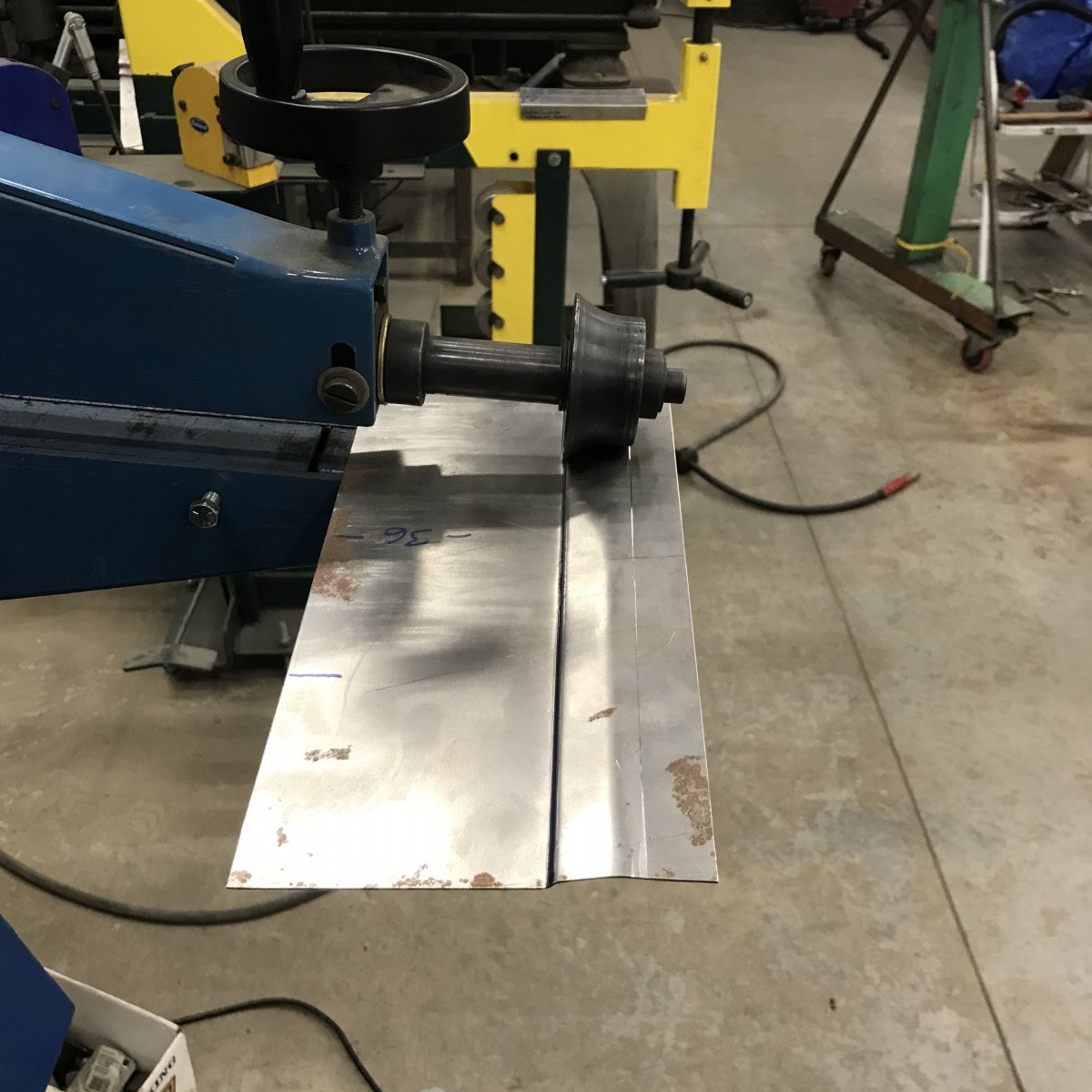

    Rollbar
    32 cowl vent
    Under cowl pedal/column/etc support.

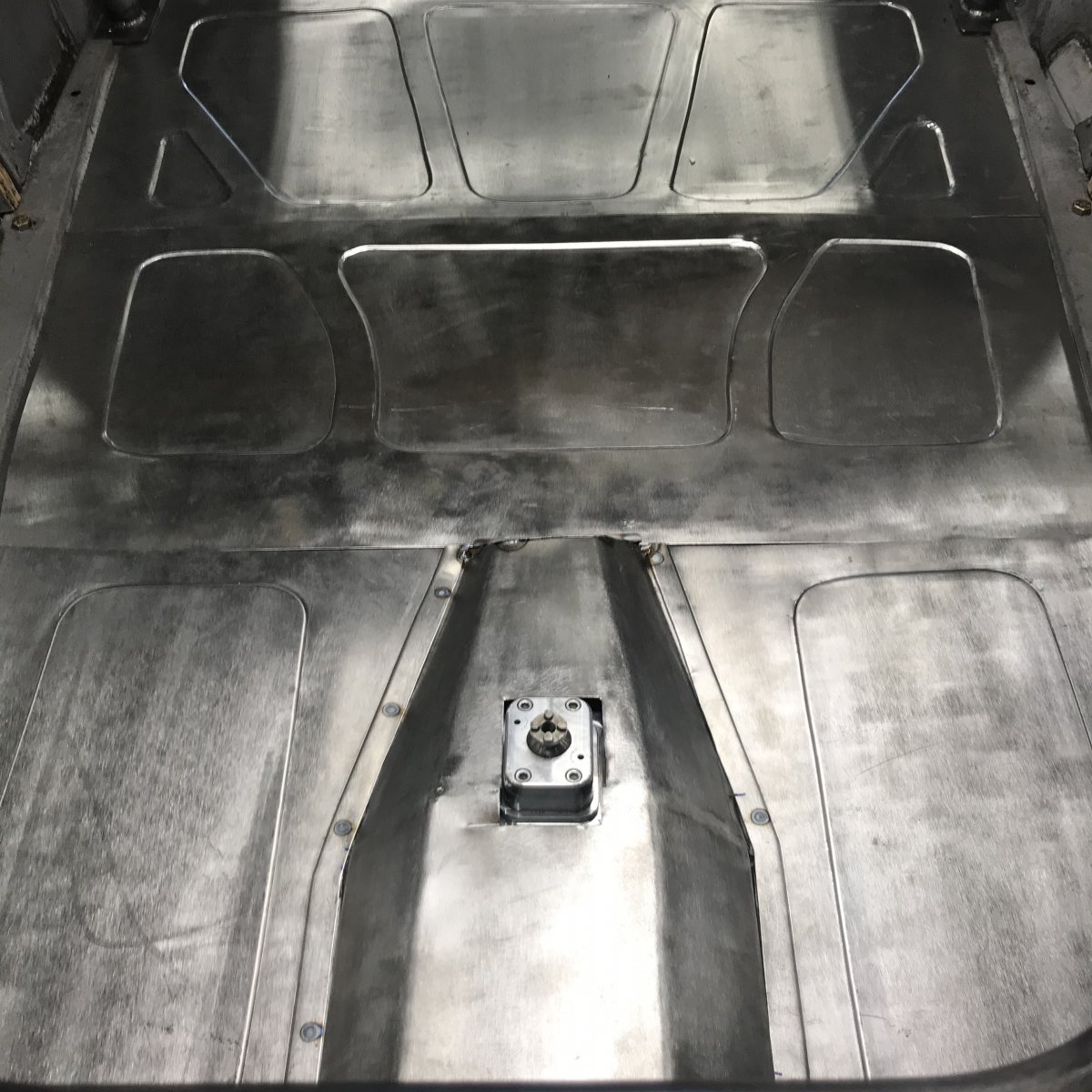

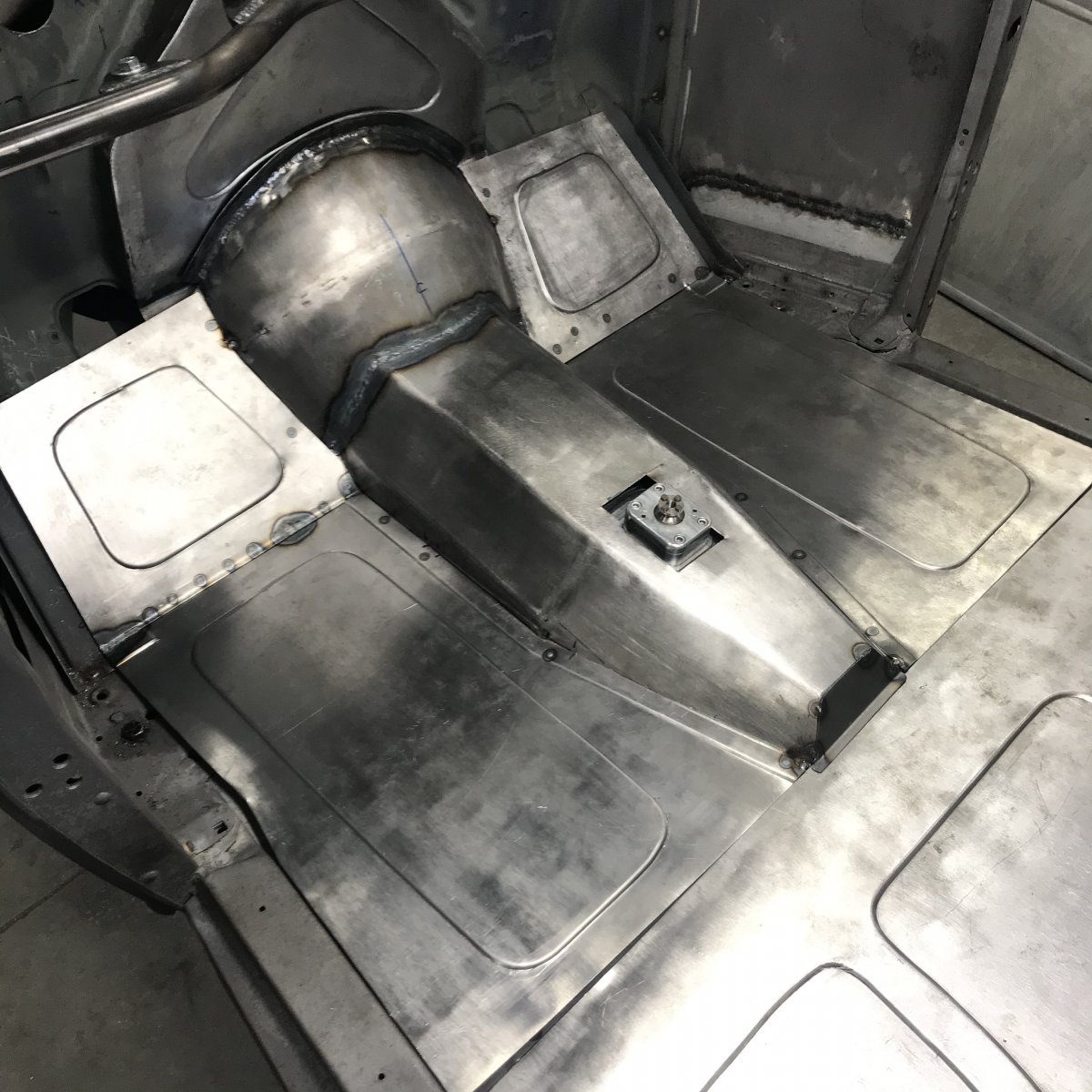

    Floors and tunnel

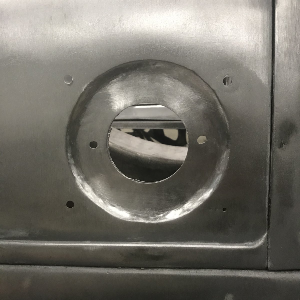

    tail light recesses.
    crazycasey, Gotgas, brEad and 19 others like this.
