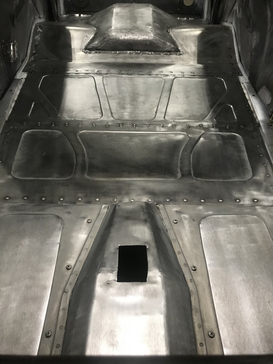

    Floors finally done

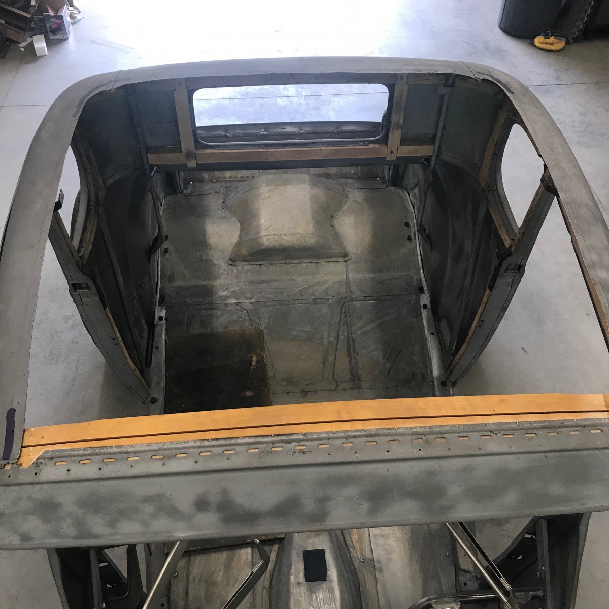

  5. wdglide
    Joined: Jun 21, 2009
    Posts: 310
    wdglide

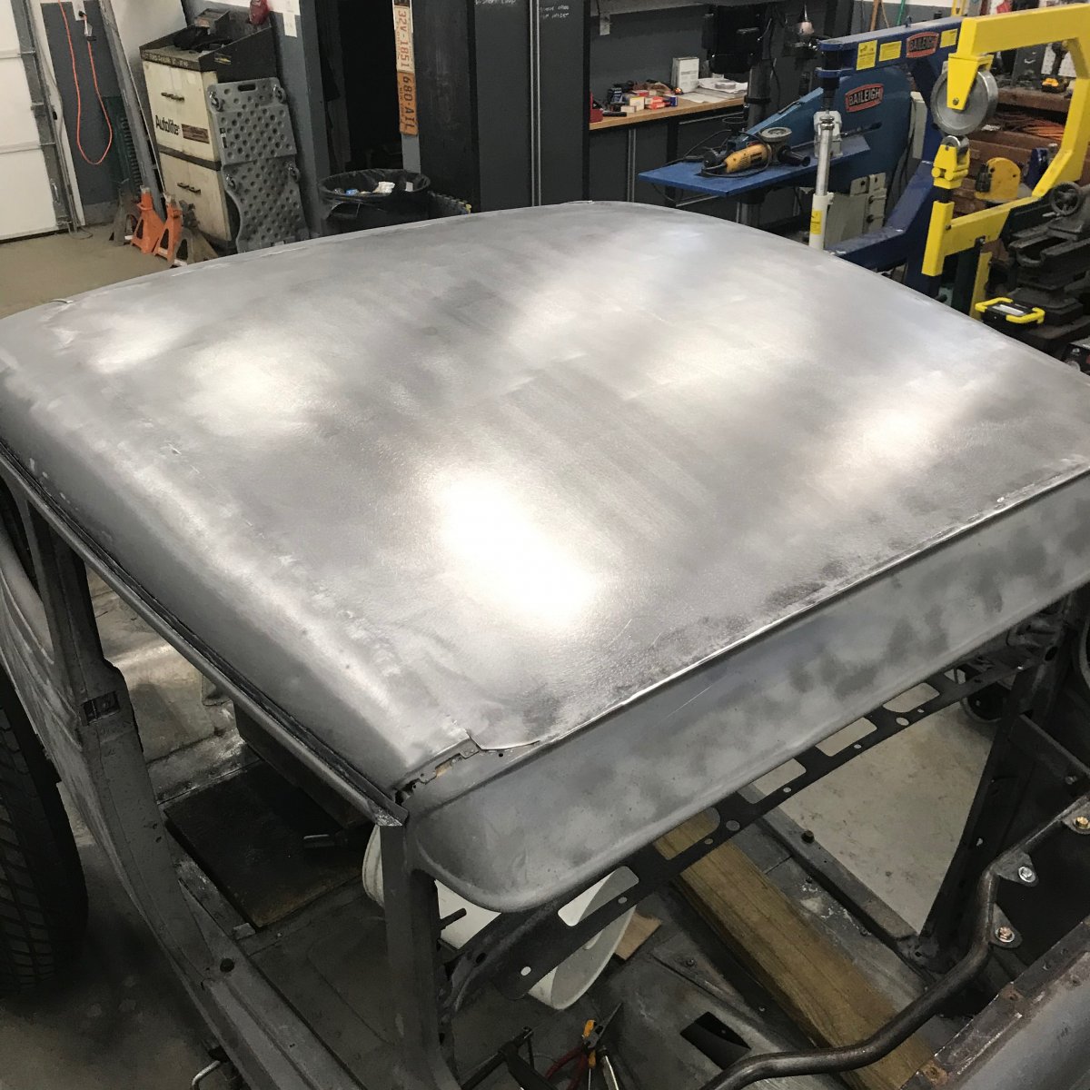

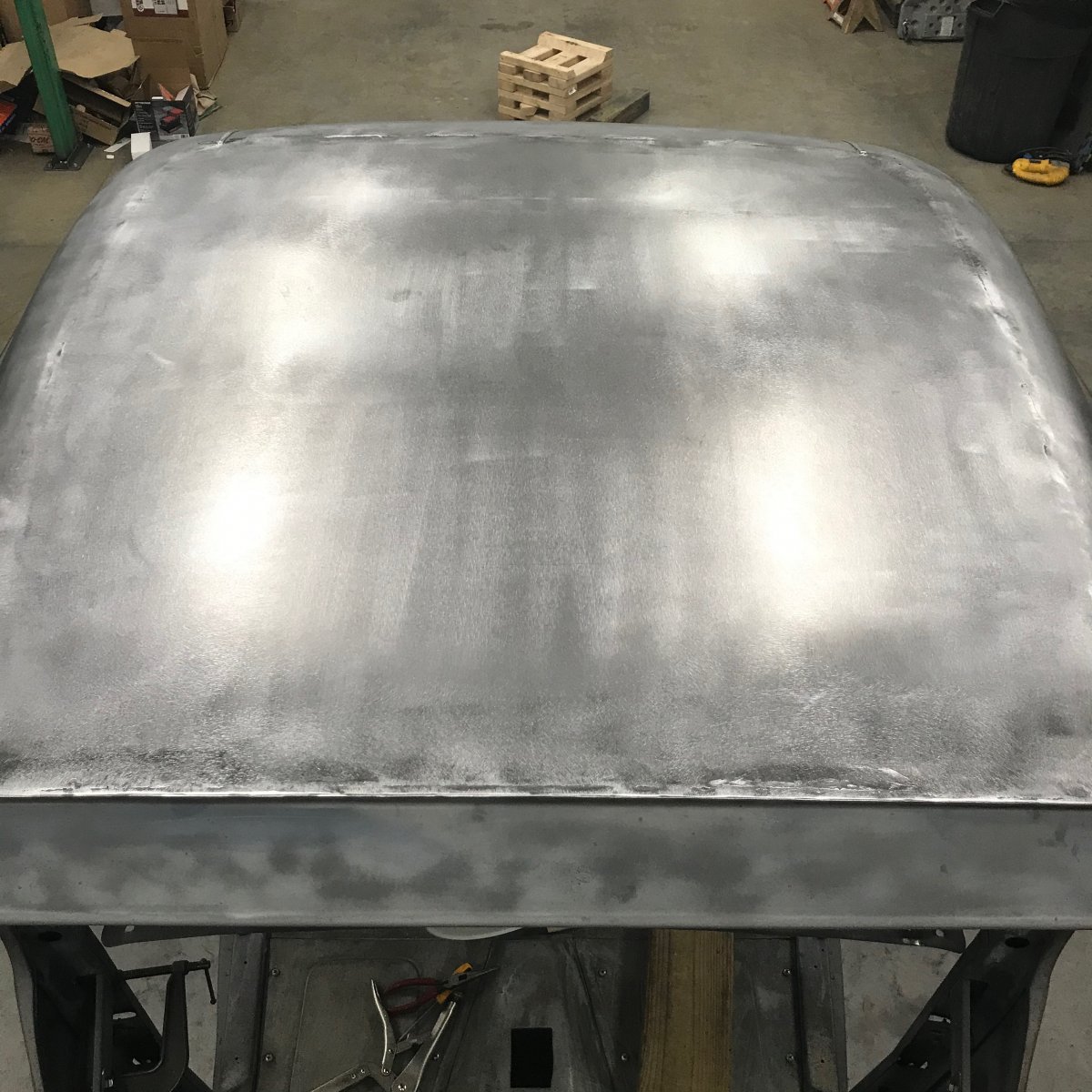

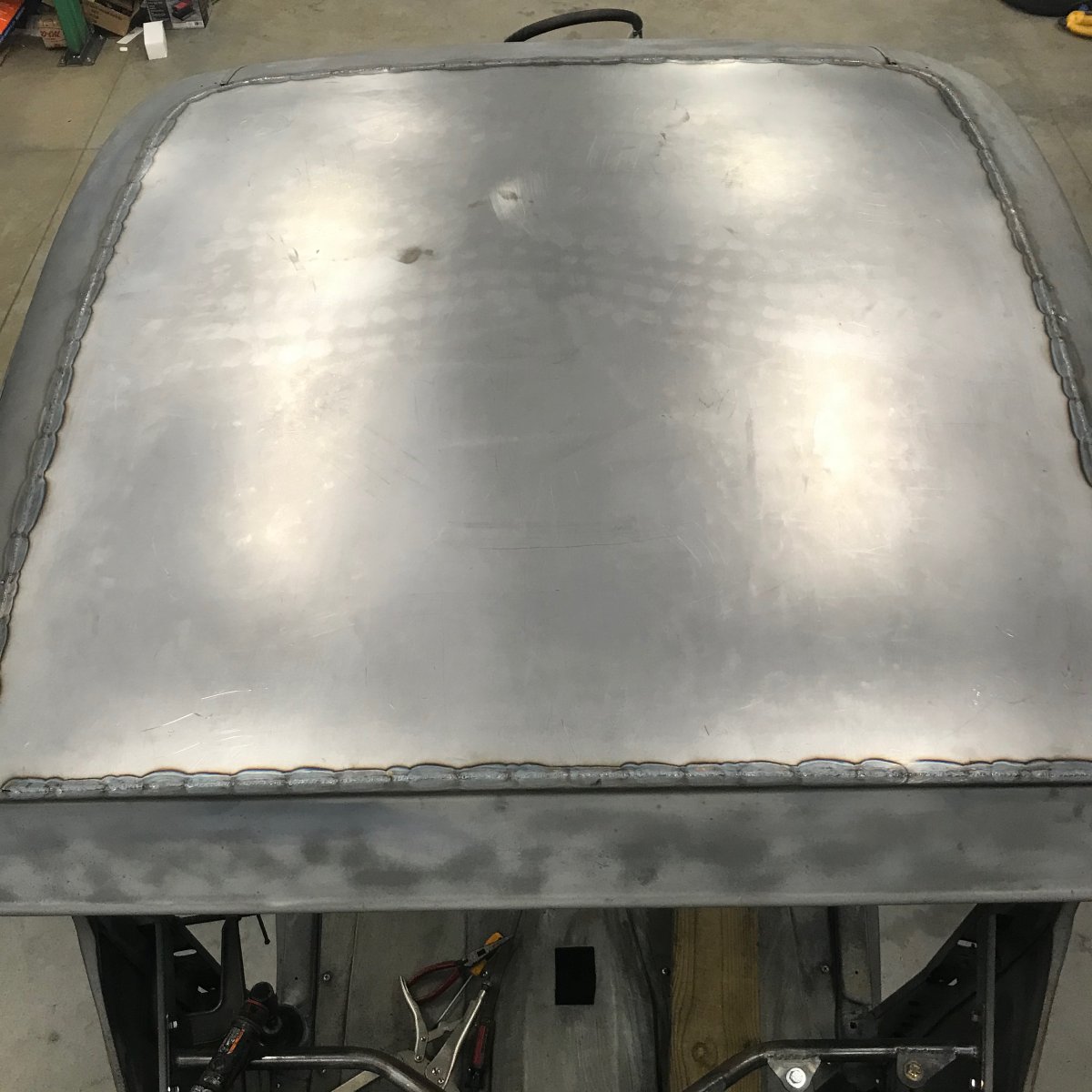

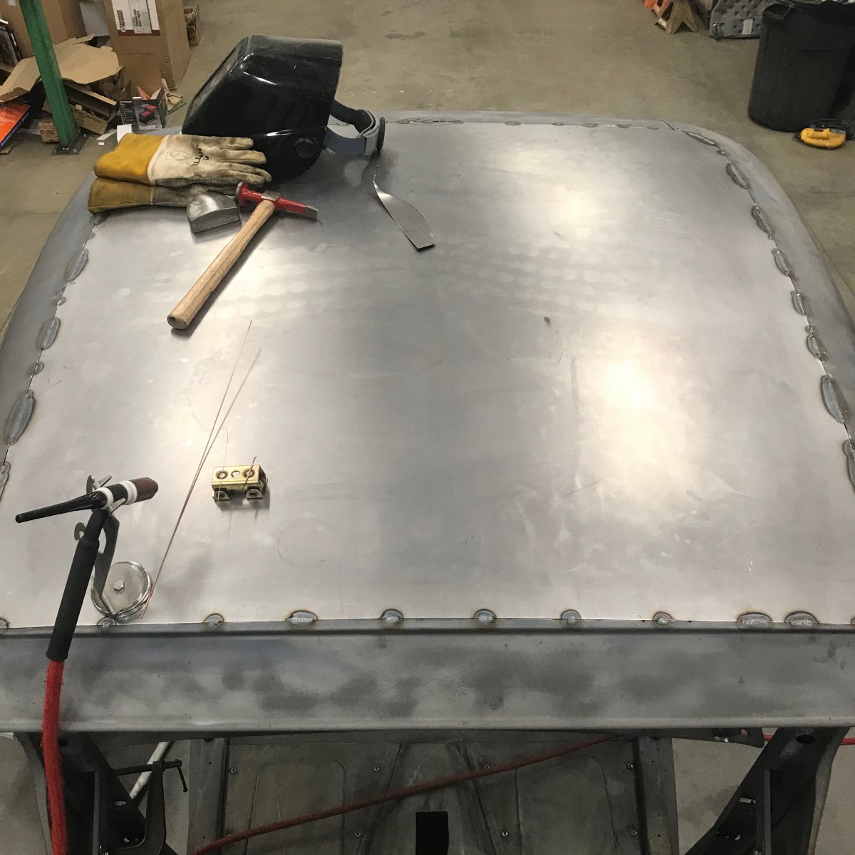

    Walden roof insert welded in. Got a lot of hammer dolly work, then close up the visor corners.

    WOW! Nice work on the roof panel!

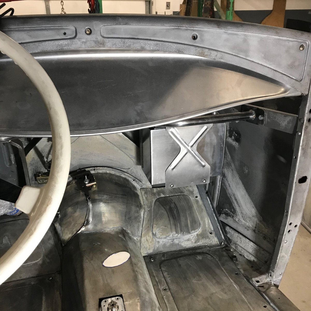

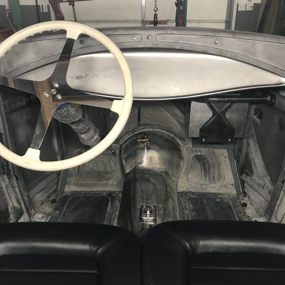

  11. Halfdozen
    Joined: Mar 8, 2008
    Posts: 631
    Halfdozen
    Nice work all round.

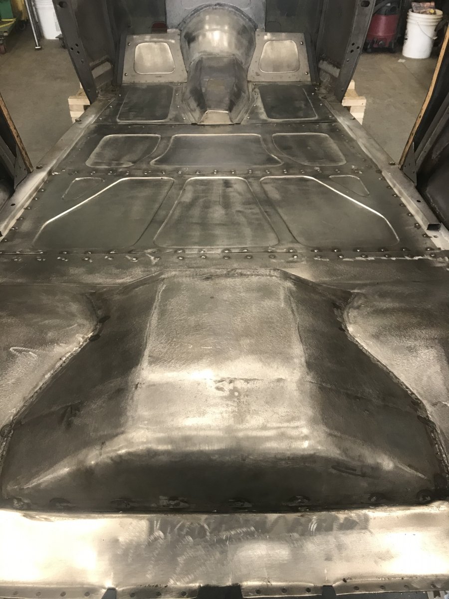

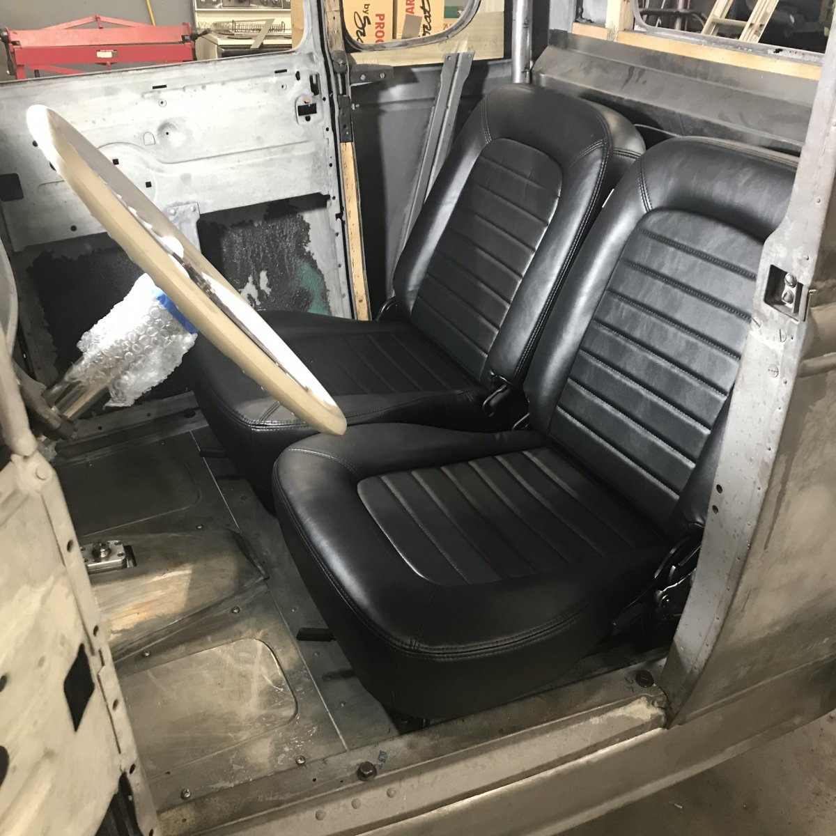

    Pedals look good, it looks like you're going to mount the master cylinders behind the dash, facing rearward. Is that right?
    Also, I really like the recesses in your boxing plates. Care to share a little more detail on them?
  12. wdglide
    Posts: 310
    wdglide
    The pedals will use a 60's truck M/C in the normal (outside) location. The lever above the pivot are for the brake light switch. The pedals are from RJays.
    The boxing plates are doubled. One set had the windows cut out. That windowed plate was then welded overtop a full boxing plate. The cir***ference of each window was then tig welded and ground down to give the illusion that it was stamped. A lot of work -- that I did not do. Mike Wagner from Cornfield did it.

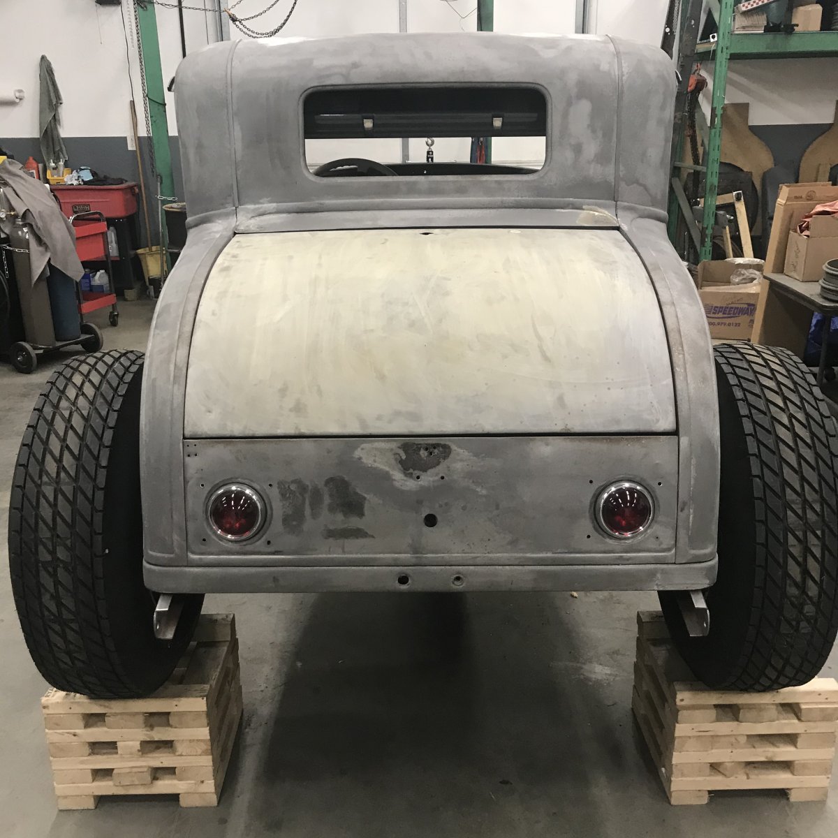

  15. wdglide
    Posts: 310
    wdglide

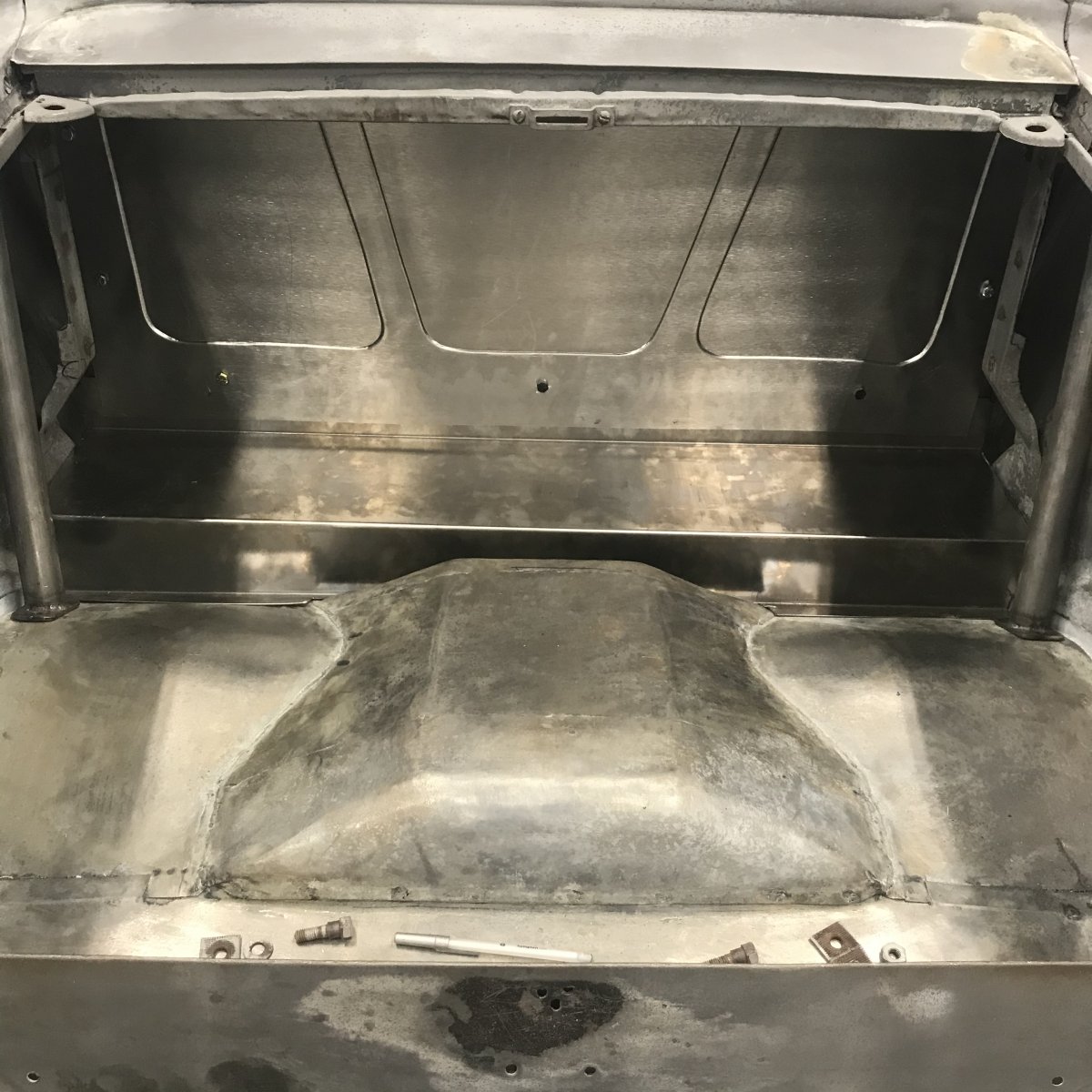

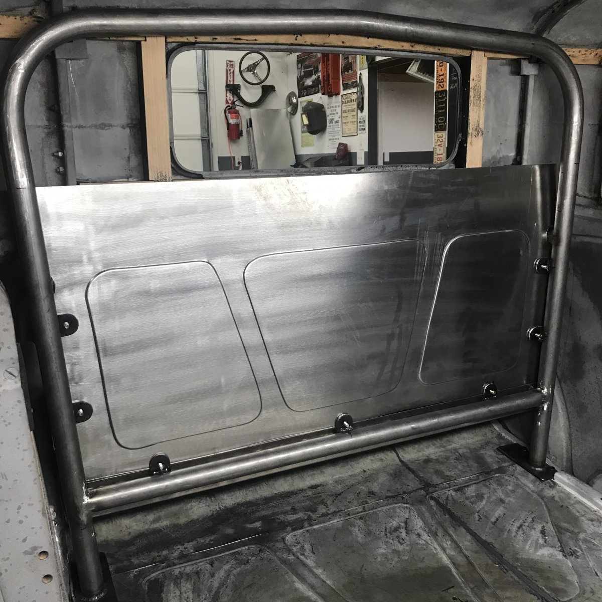

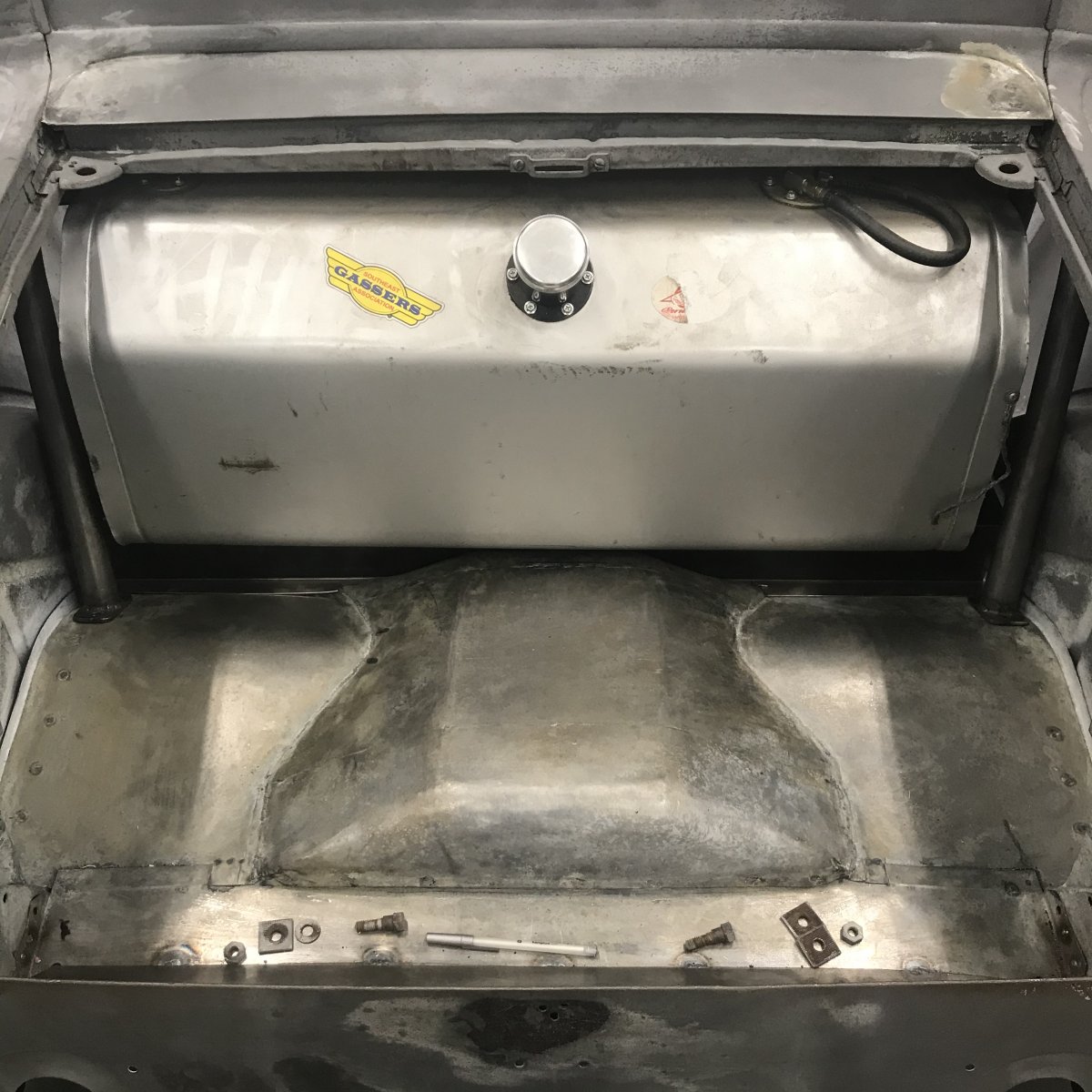

    Some progress on the rear bulkhead.
    Storage underneath...
    crazycasey, Vic Walter, brEad and 8 others like this.
  16. dentisaurus
    Joined: Dec 11, 2006
    Posts: 399
    dentisaurus
    from Boston
    Quality workmanship going on here.
    What was your reason for stepping the rear fire wall out into the p***enger compartment to meet the roll cage? I'm 6.4 so the parcel shelf had to go for me to fit in an A. Maybe it isn't as deep as it looks?
  17. wdglide
    Posts: 310
    wdglide
    Thanks. Needed Room for the gas tank. Any further back and the filler neck would hit the deck lid. It’s only forward 1.75”

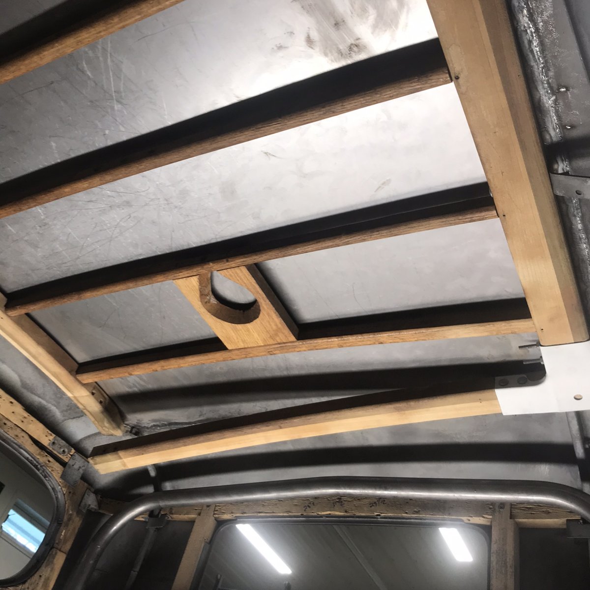

    Got the wood back in. It was pretty easy. I posted a thread on how I did it, in case anyone needs some ideas.

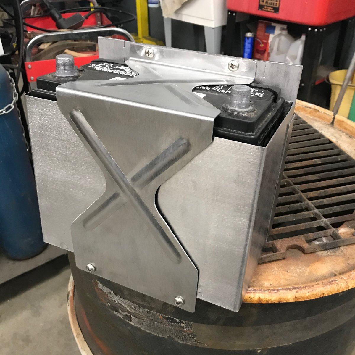

  23. wdglide
    Posts: 310
    wdglide

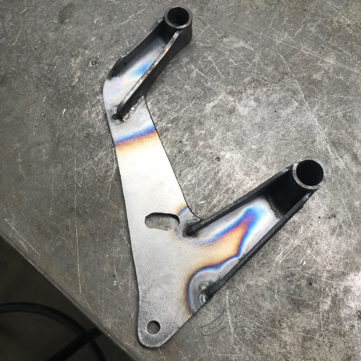

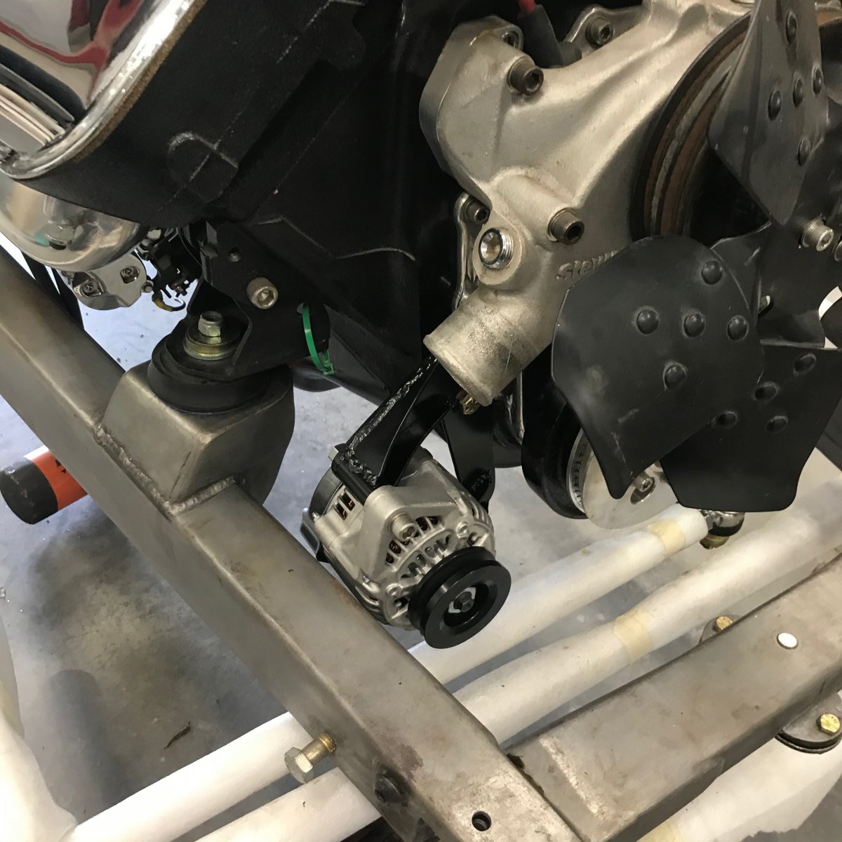

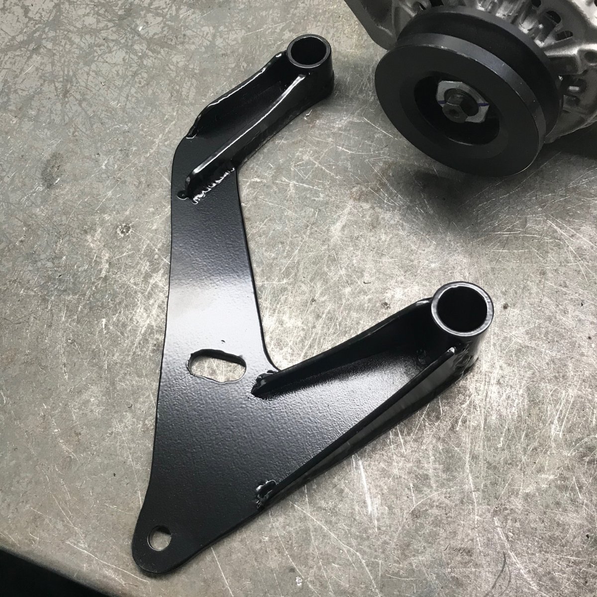

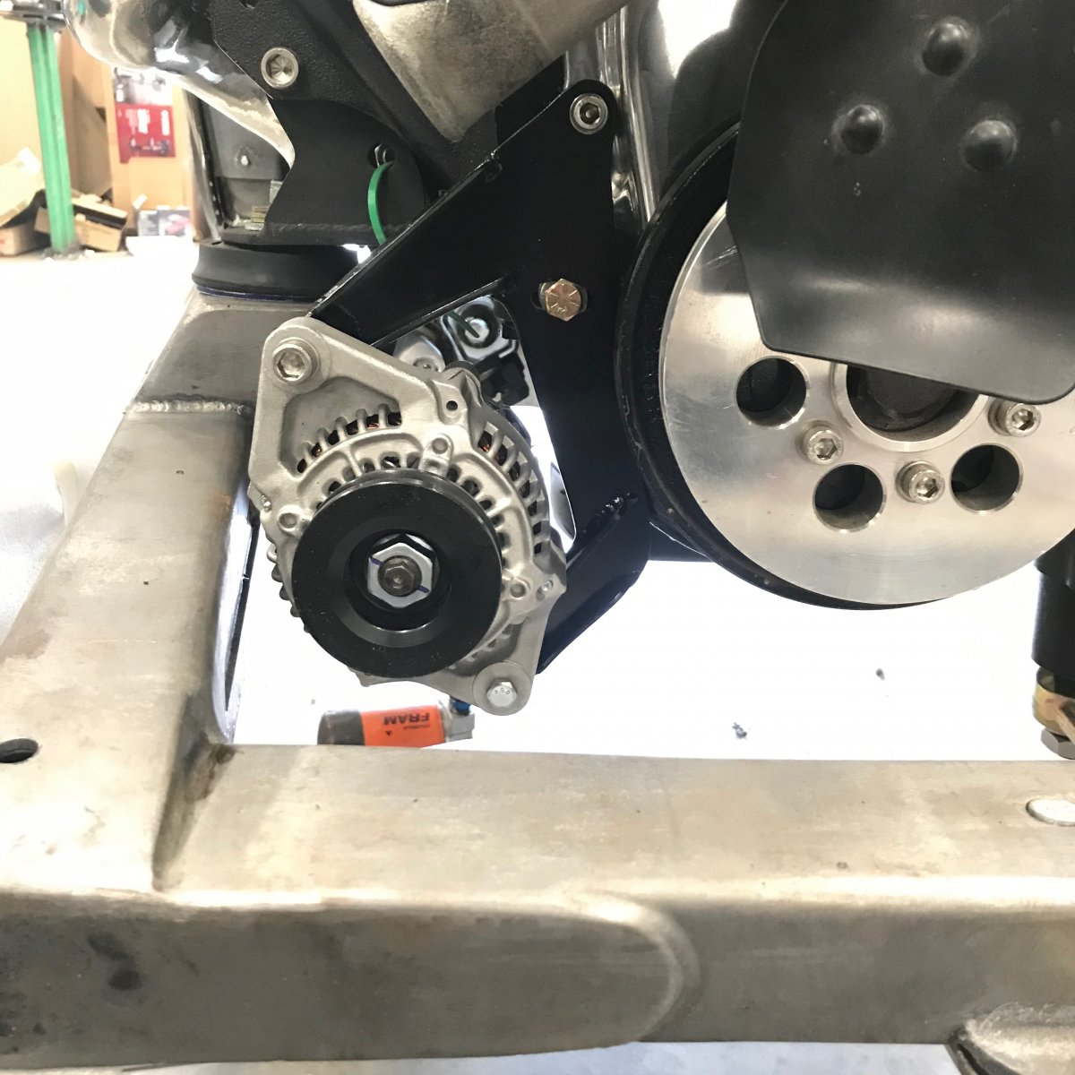

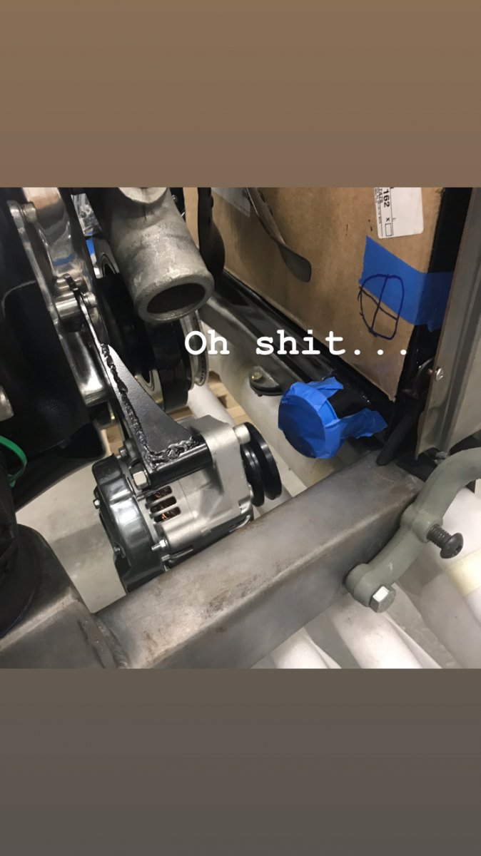

    Spent the week on some smaller projects. A drop-down battery box for a group 51 battery. And a low mount for a denso alternator.

  24. Just Gary
    Joined: Oct 9, 2002
    Posts: 5,811
    Just Gary
    Cool car & beautiful workmanship.
    But how do you adjust alternator belt tension? Does the one little slot give you enough adjustability?:confused:
  25. wdglide
    Posts: 310
    wdglide
    Yes it does. Thats typical with this style low mount. (Hot Heads)
    loudbang and Just Gary like this.
  26. Just Gary
    Joined: Oct 9, 2002
    Posts: 5,811
    Just Gary
    Thanks- good to know. :)
    It's a pretty tight fit down there between the frame, timing cover, and lower pulley.
    loudbang and wdglide like this.
  27. wdglide
    Posts: 310
    wdglide
    Yes it is tight. My biggest concerns are the bracket flexing and the small amount of belt contact area on the crank pulley.
    Just Gary and loudbang like this.

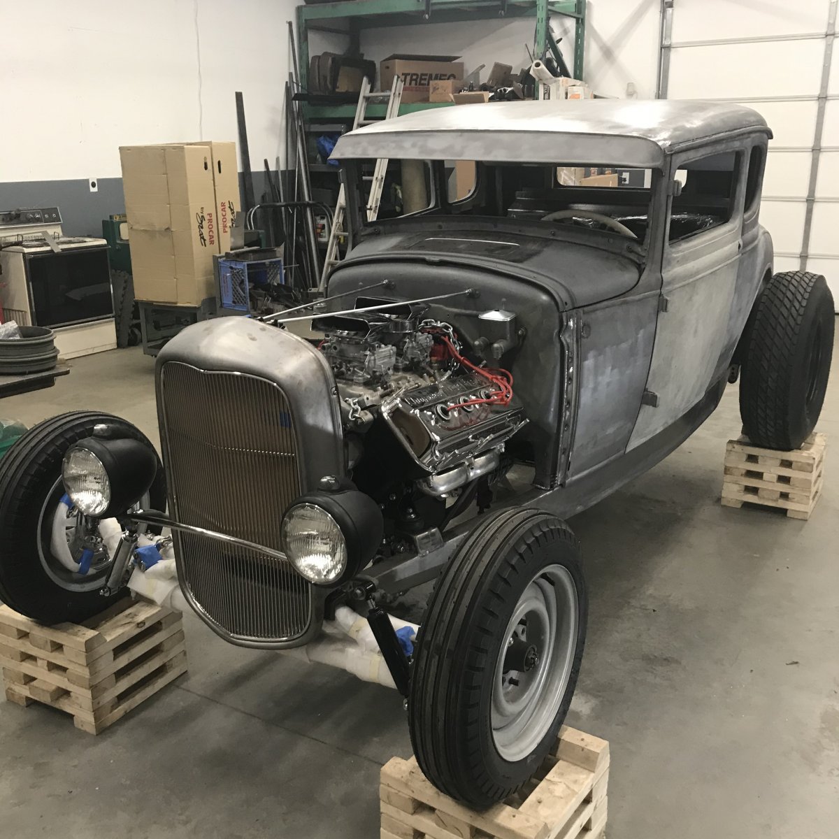

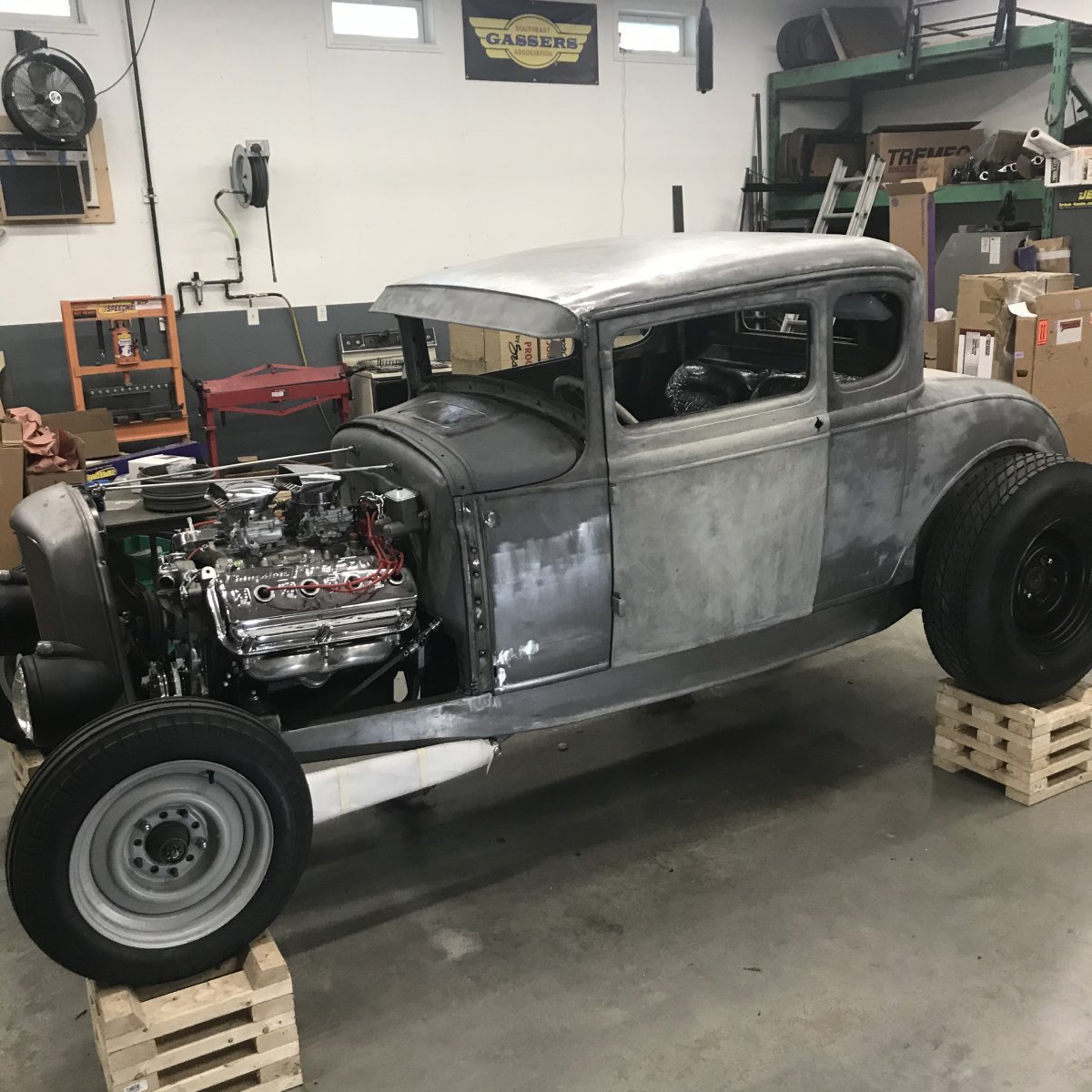

  29. wdglide
    Posts: 310
    wdglide

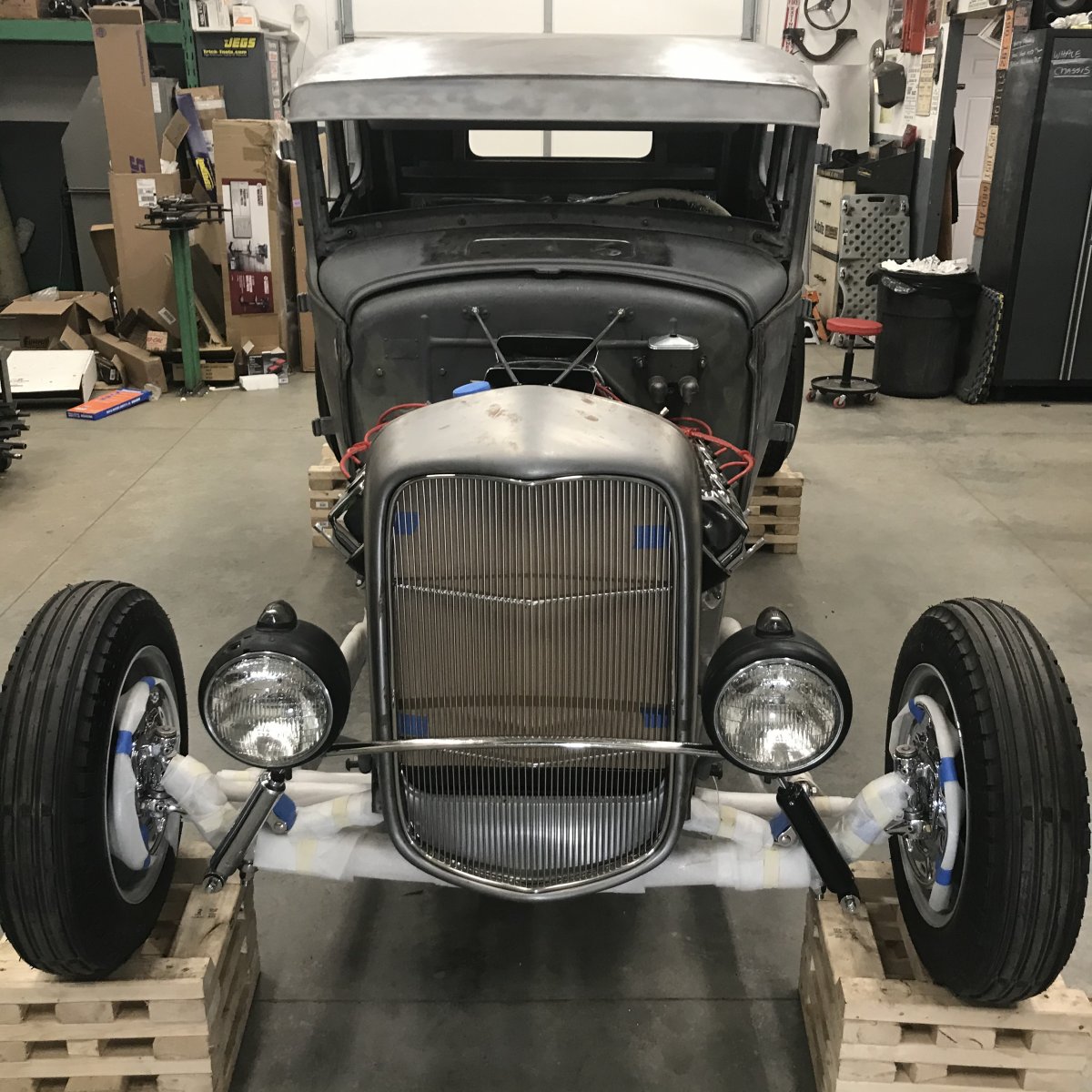

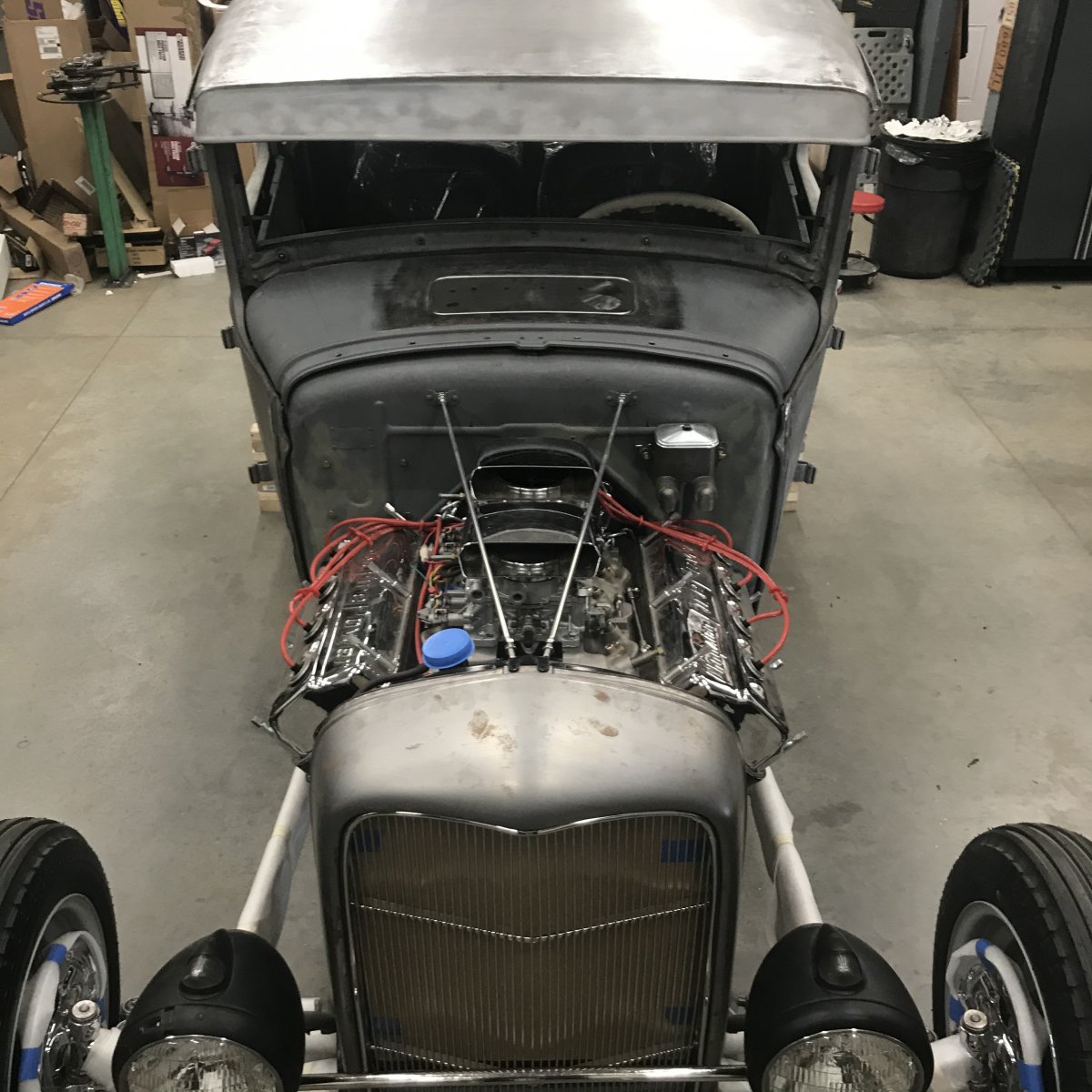

    ***embled to check for clearances and gaps and screw ups.
    E20BF84A-68B4-44BB-9EC7-7D553E2E7E09.jpeg 94F64455-CF24-41E9-915F-0D3BEA885EFD.jpeg DDCBB3DA-F14F-40C3-8E31-D3B069176F6A.jpeg E9E8A7AA-926A-413D-8548-E0273574B8D9.jpeg 27103B07-9155-48B1-82D8-AE502145FC2C.jpeg A13E905B-5A5A-4E0D-9572-8FD604660FDE.jpeg CCFB0E46-8E81-44F8-8B4C-4FFD2652B7BF.jpeg
