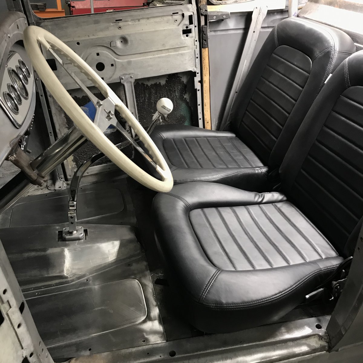

    I really dig the roll bar and how it's all packaged. I've been wondering about how to handle mine, if I were to do it.
    Your Mustang seats, are they mounted, yet?
    wdglide and loudbang like this.
  3. wdglide
    Joined: Jun 21, 2009
    Posts: 310
    wdglide
    Thanks all.
    Yes they are.

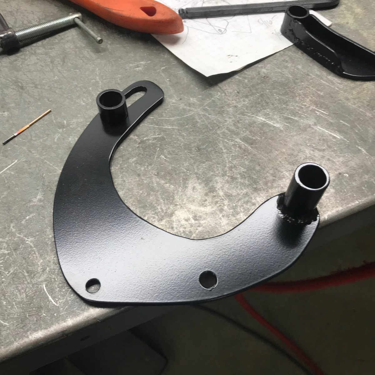

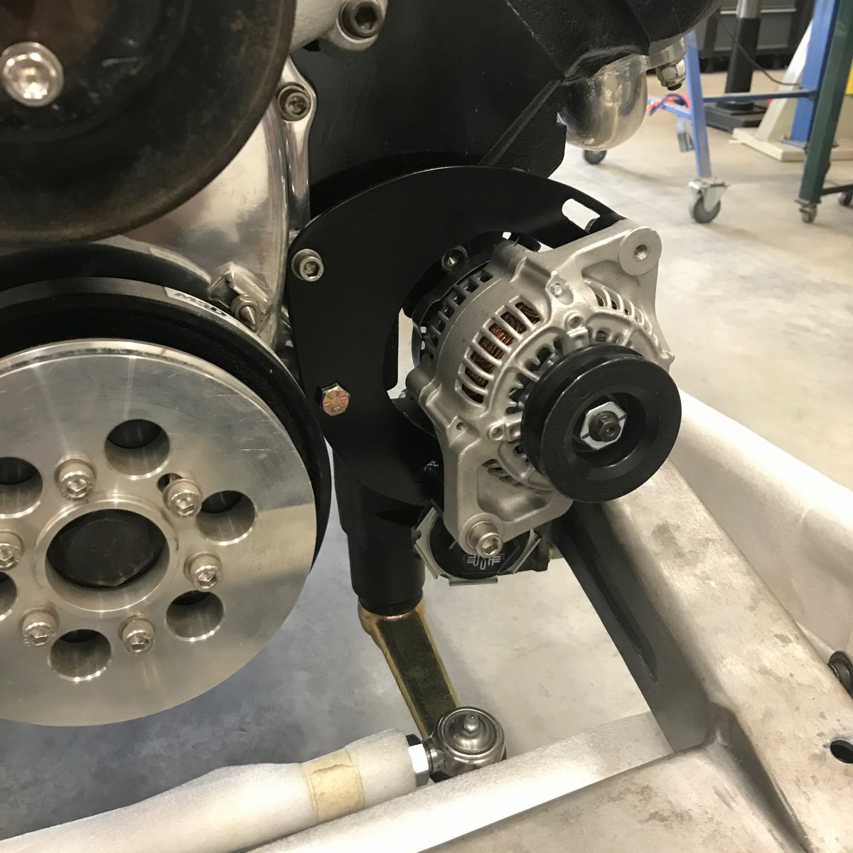

    Lets try this again... Plan "C"

    Much better. I don't think the very low mount on the other side would've given you enough belt wrap on the crank pulley to drive both the alternator and water pump. Been there, done that, like you I'm not afraid to do it again to get it right.

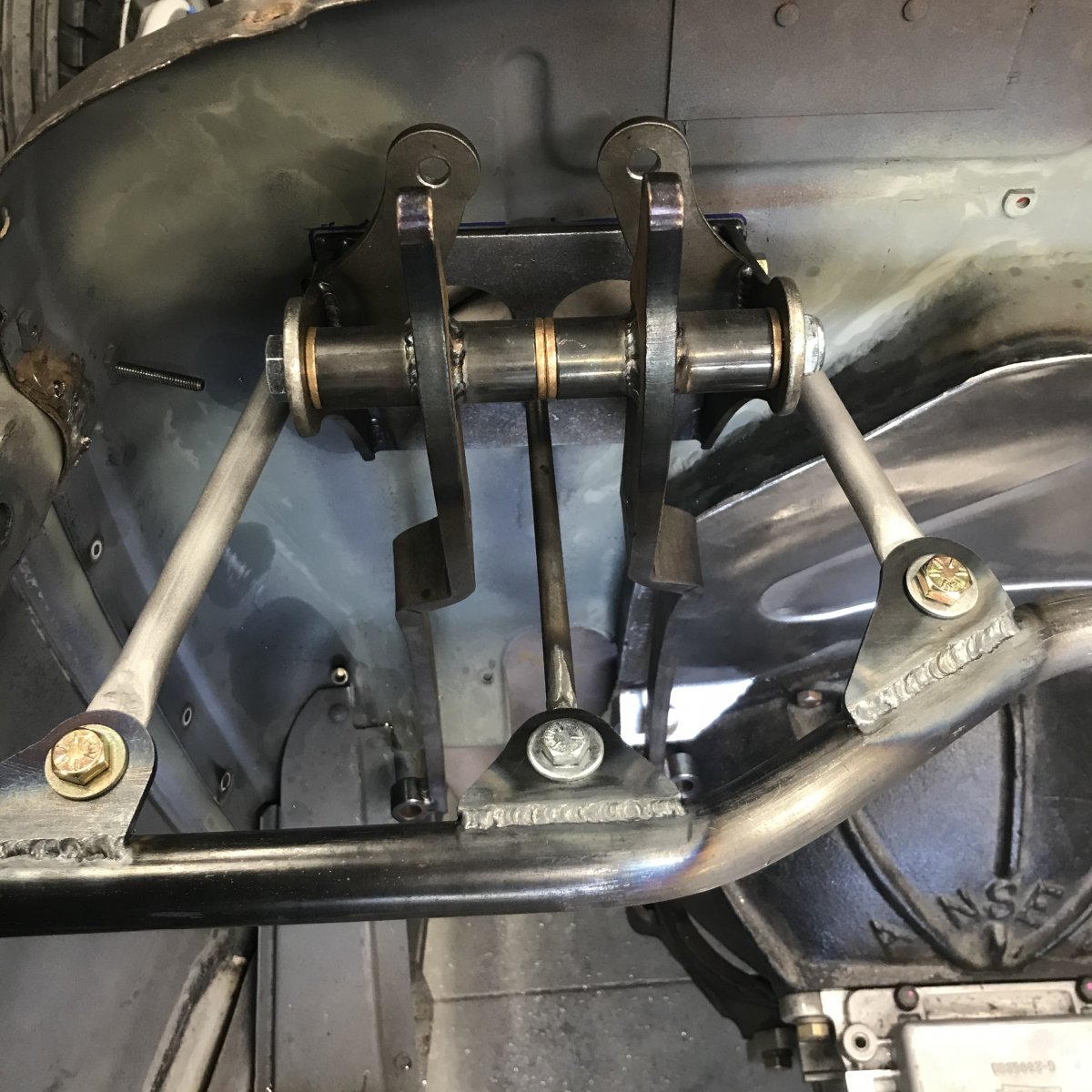

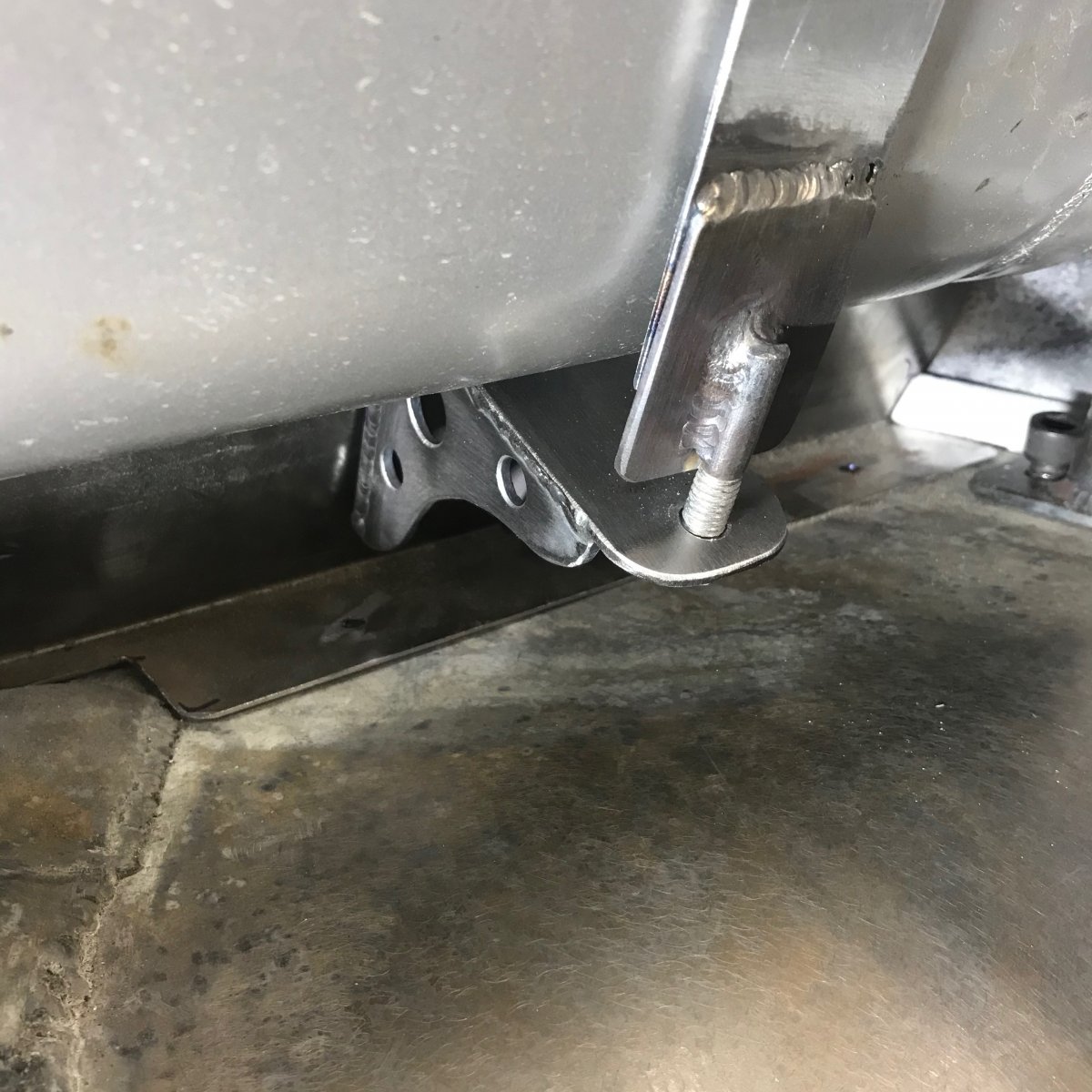

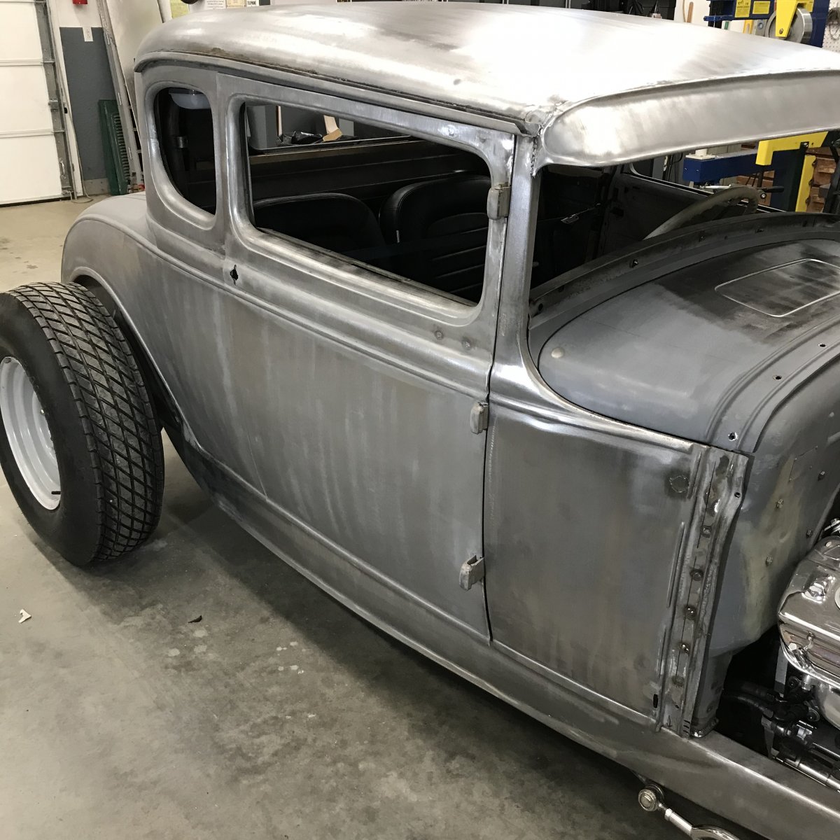

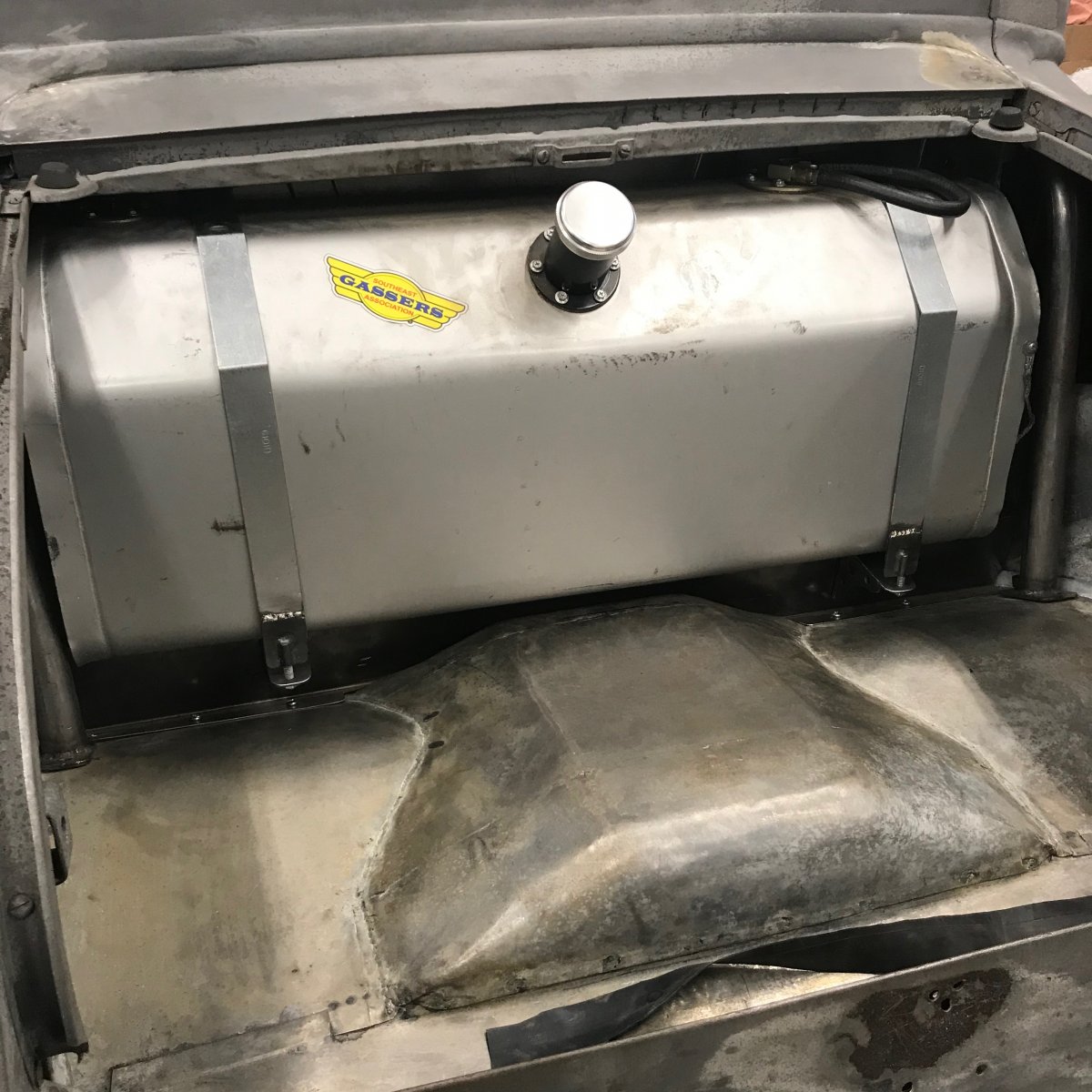

    Still here. Working on small, boring, things like door gaps and tank straps.
    Stogy, Vic Walter, brEad and 5 others like this.
  8. vtwhead
    Joined: Oct 20, 2008
    Posts: 5,305
    vtwhead
    Nice straps, your making headway. Keep at it:)
    loudbang and wdglide like this.

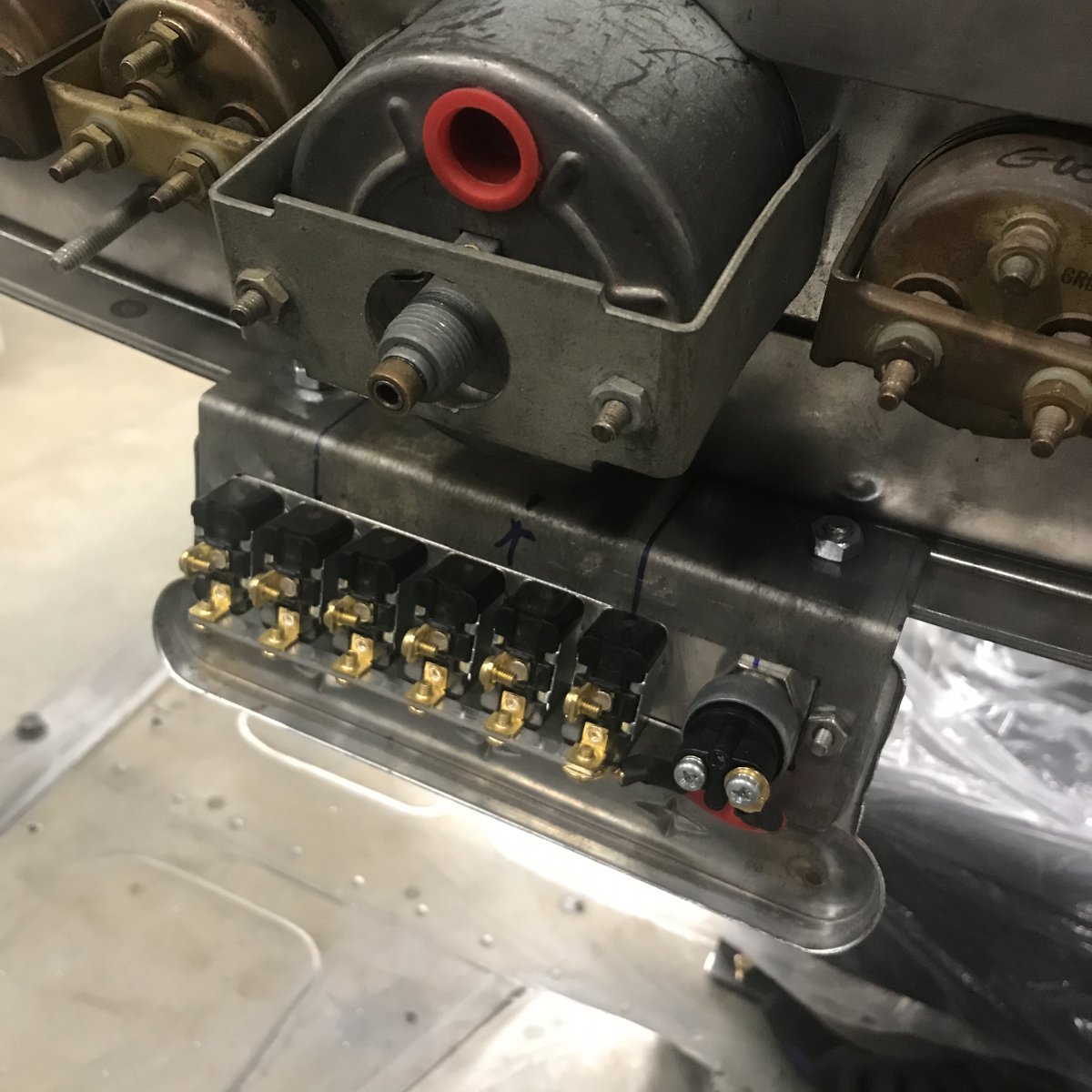

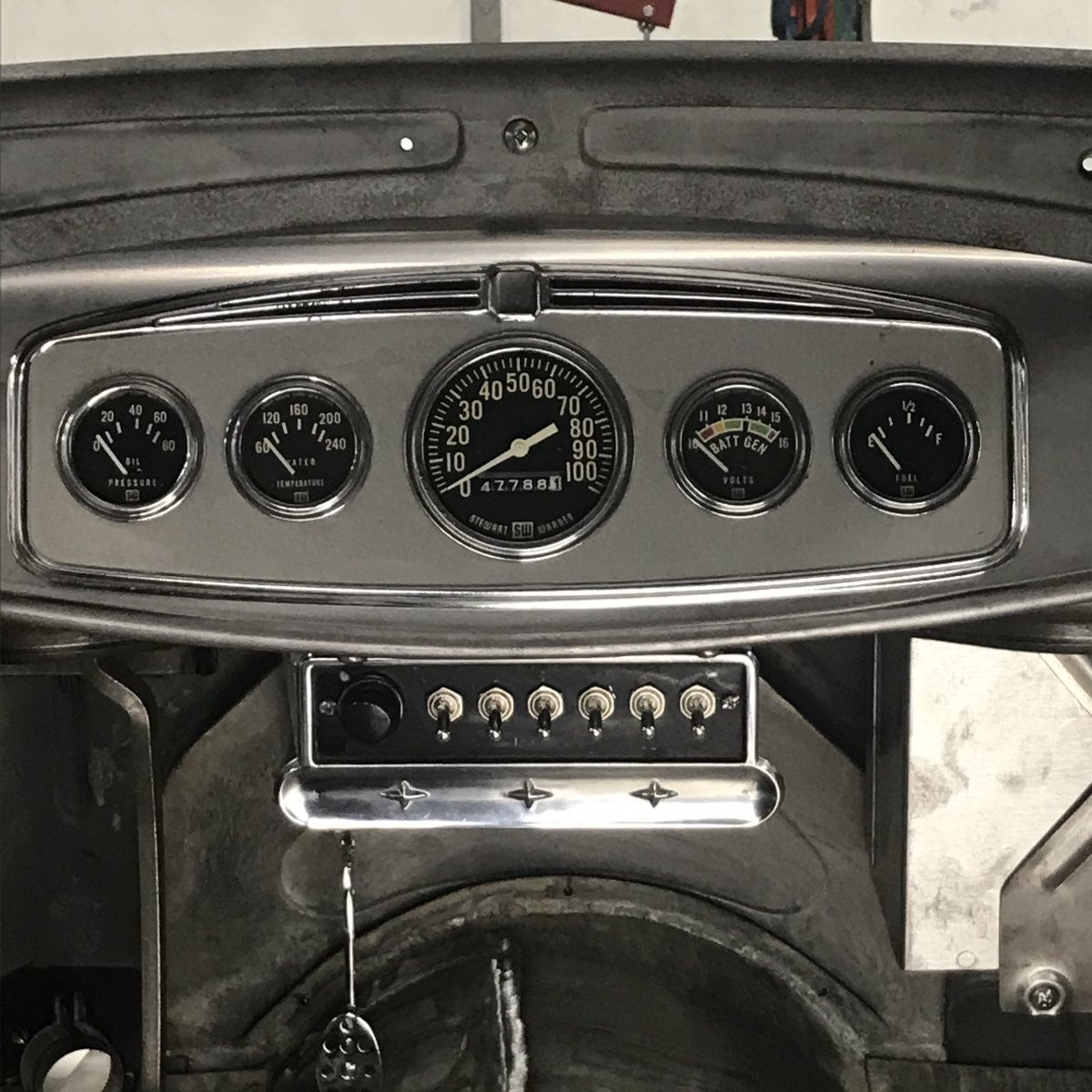

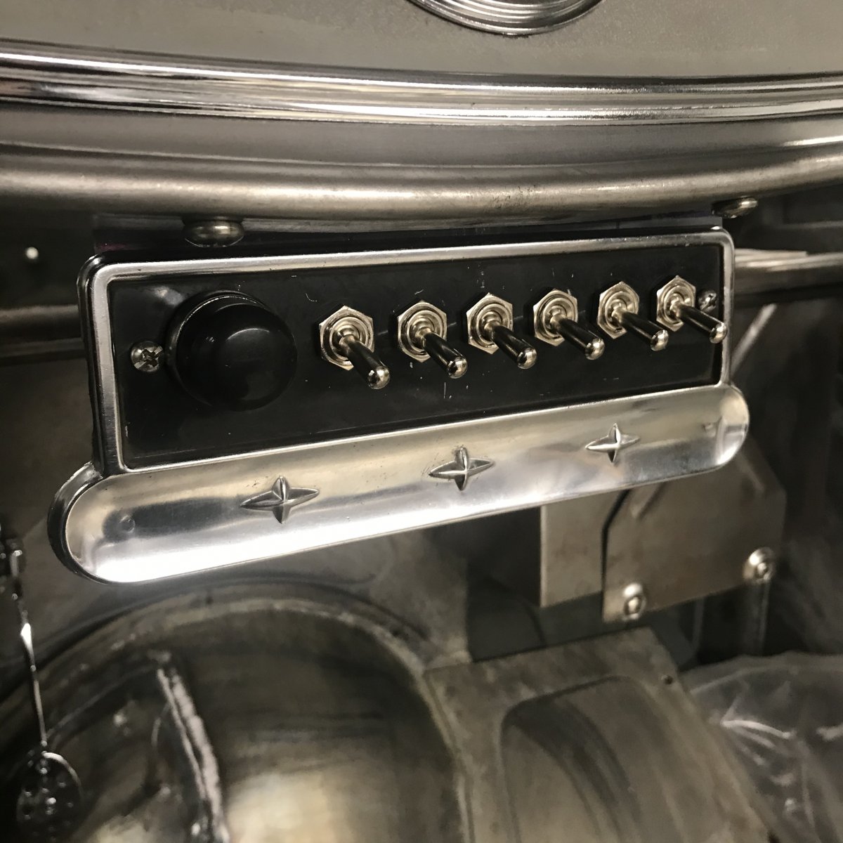

    Used a 50s Plymouth radio delete for a switch panel. I kinda like it.

  10. kadillackid
    Joined: Nov 11, 2006
    Posts: 638
    kadillackid
    Perfect :rolleyes: looks awesome!

  15. Just Gary
    Joined: Oct 9, 2002
    Posts: 5,811
    Just Gary
    Beautiful dash!:cool:
    Are the SW gauges new or restored old ones?
  16. wdglide
    Posts: 310
    wdglide
    Thanks.
    Old Br*** case ones.

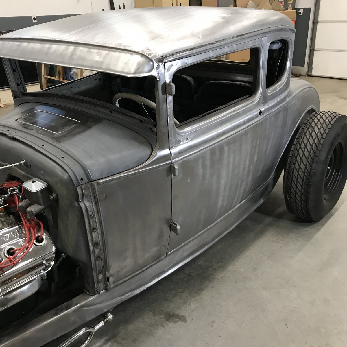

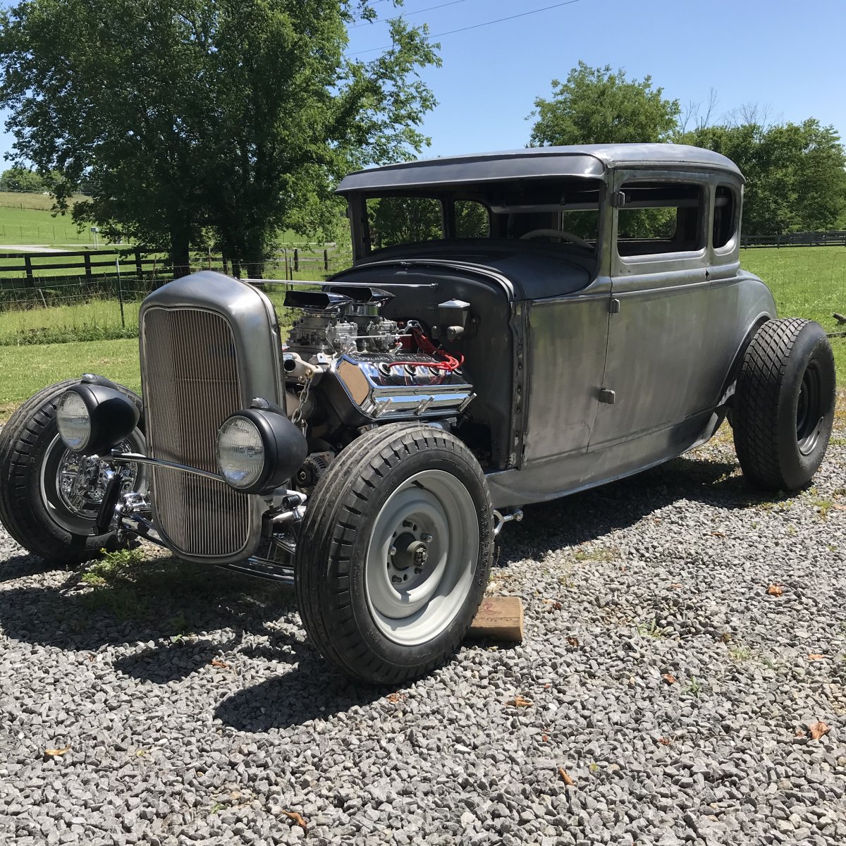

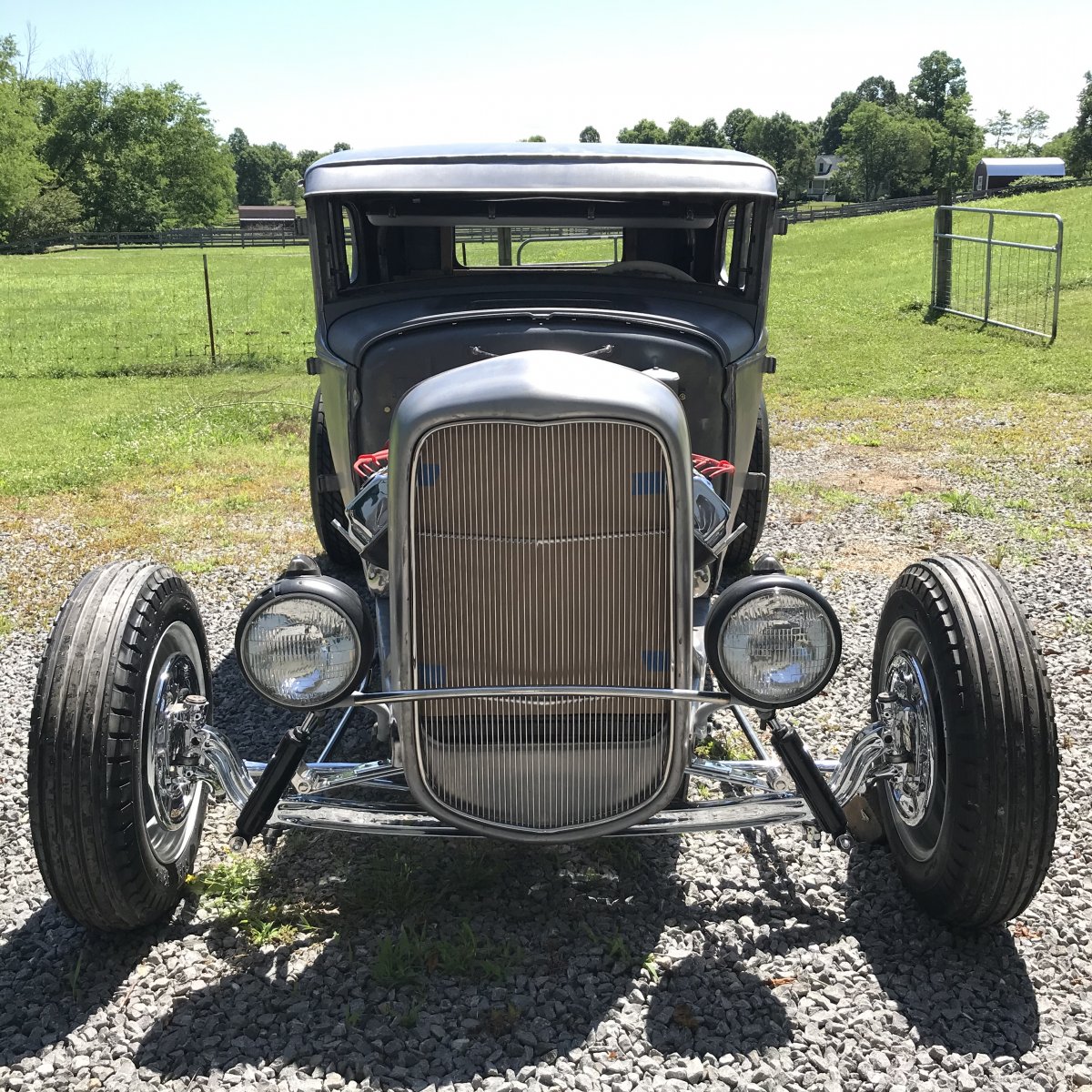

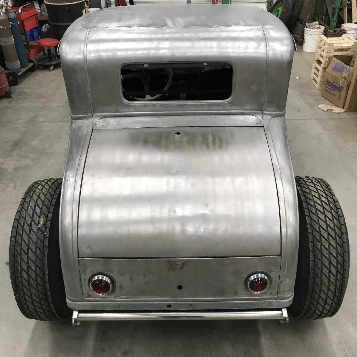

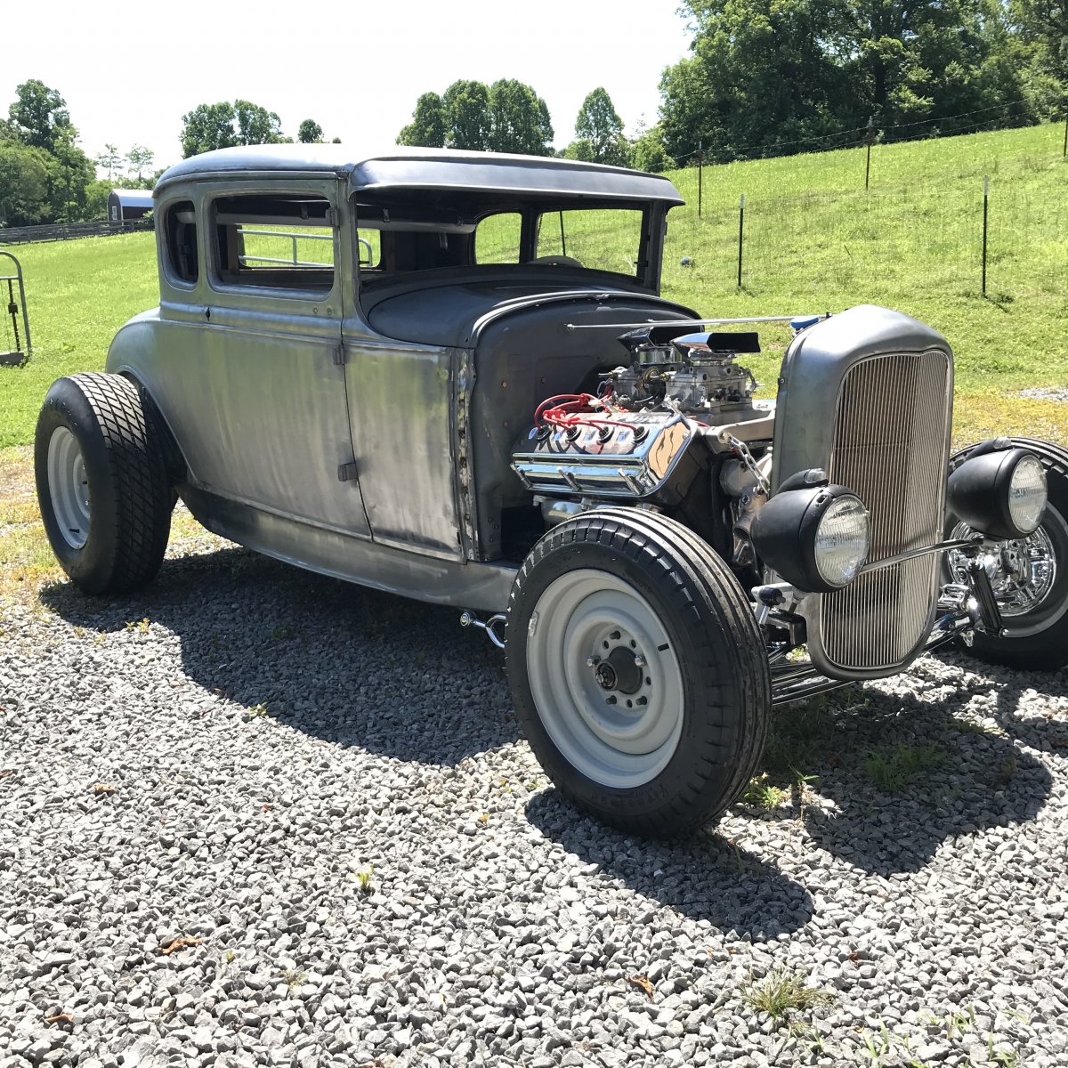

    wdglide

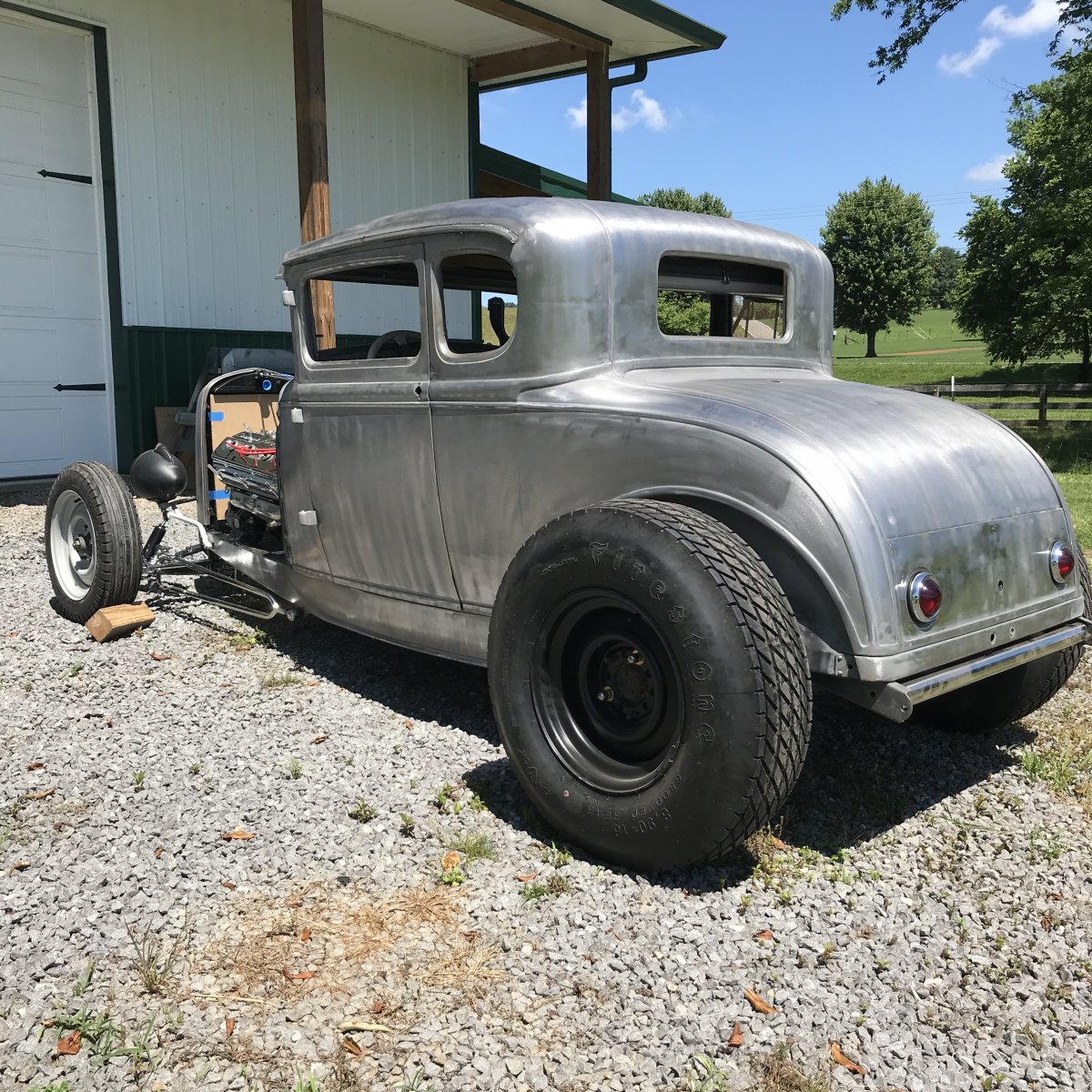

    Final ***embly before paint and body work. Got her out in the sun for a bit.

  22. loudbang
    Posts: 40,346
    Tire combo looks GOOD. :)
