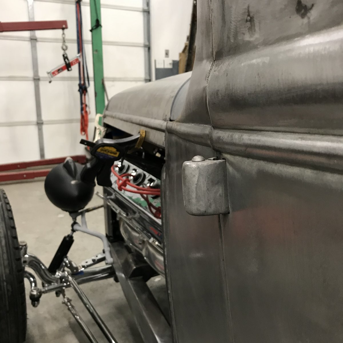

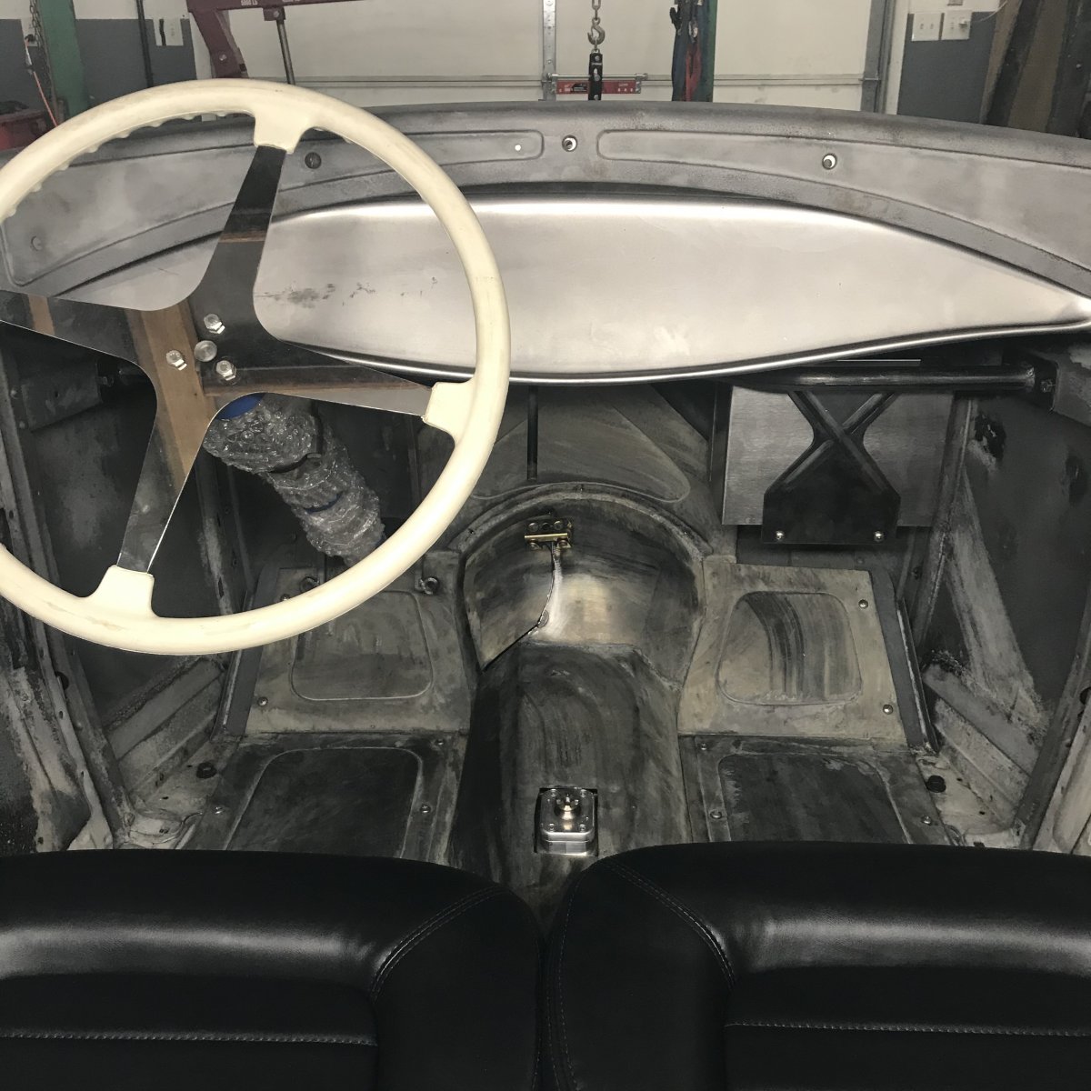

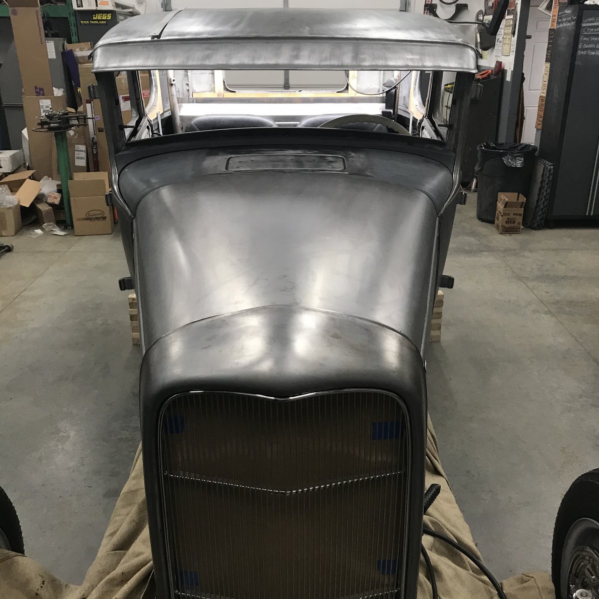

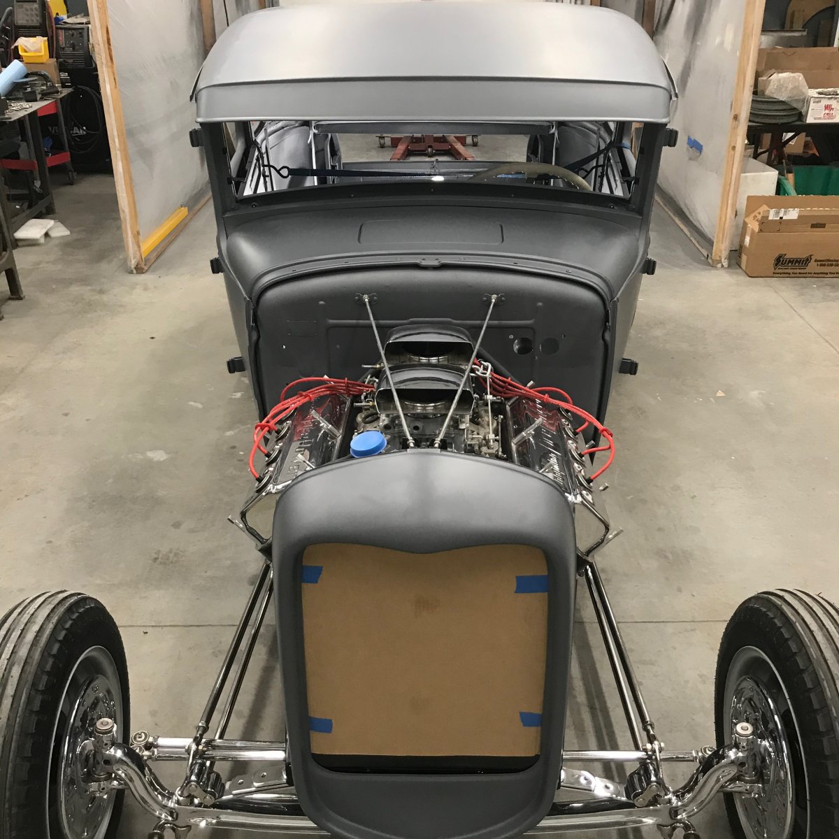

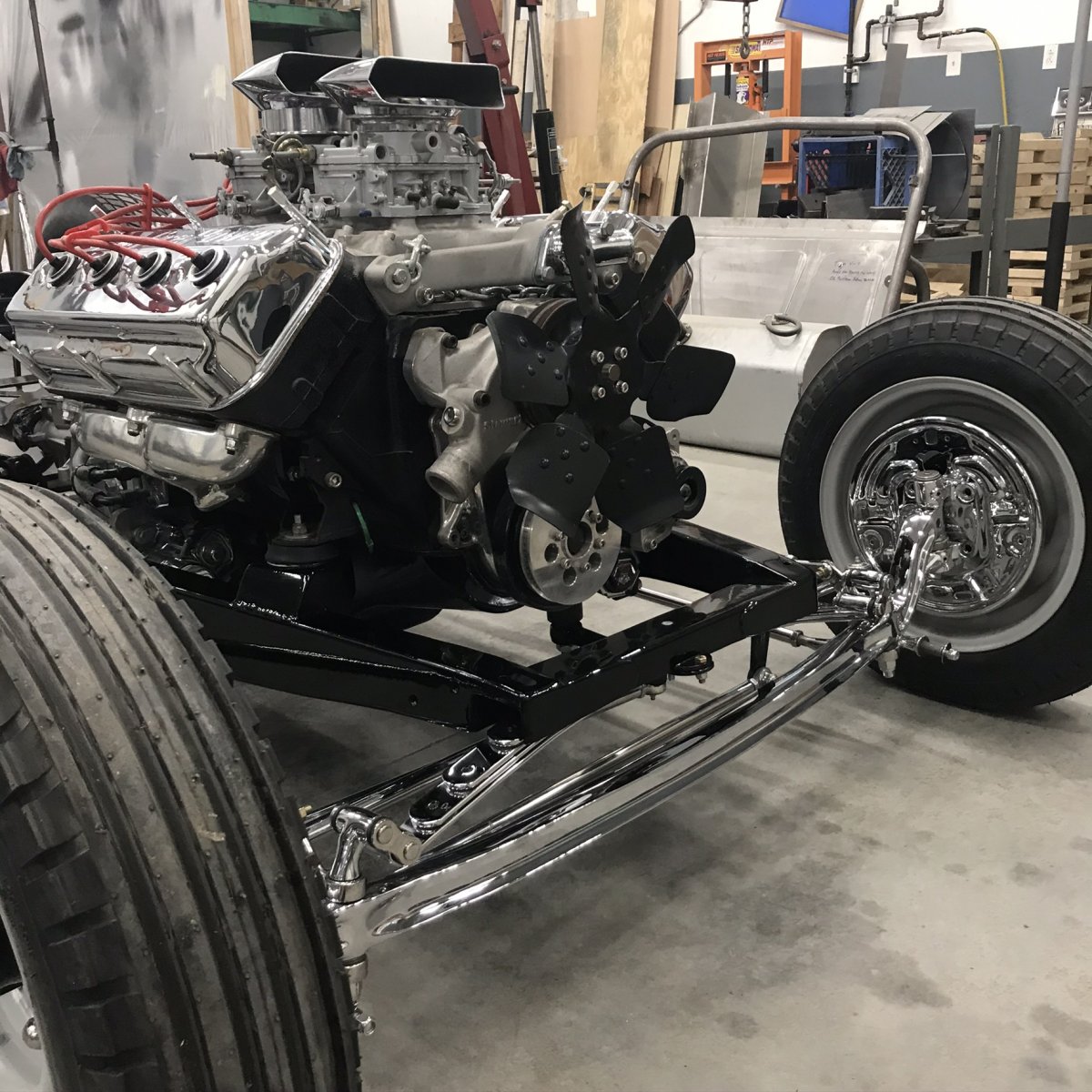

    Thank you. Fabbed up a hood top. Gonna add a couple rows of louvers soon (hopefully).
    8C18646F-9B2B-4E1D-84DE-7800D1A54052.jpeg 12A2C401-7650-4481-801E-52603E453579.jpeg 6F26175B-DADD-42E4-A8A0-4AE478A87488.jpeg 5B0A9DBE-5B83-49FC-AD3B-8DBE67403302.jpeg

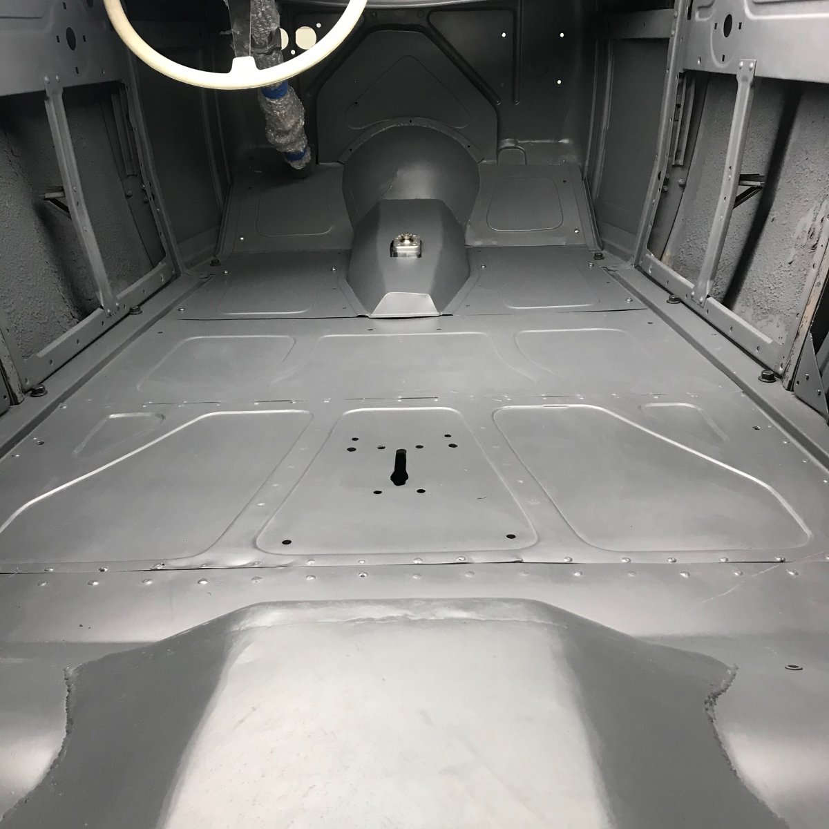

    Gotta say the metal work and detail in floors and firewall etc. it would be a shame to cover it.

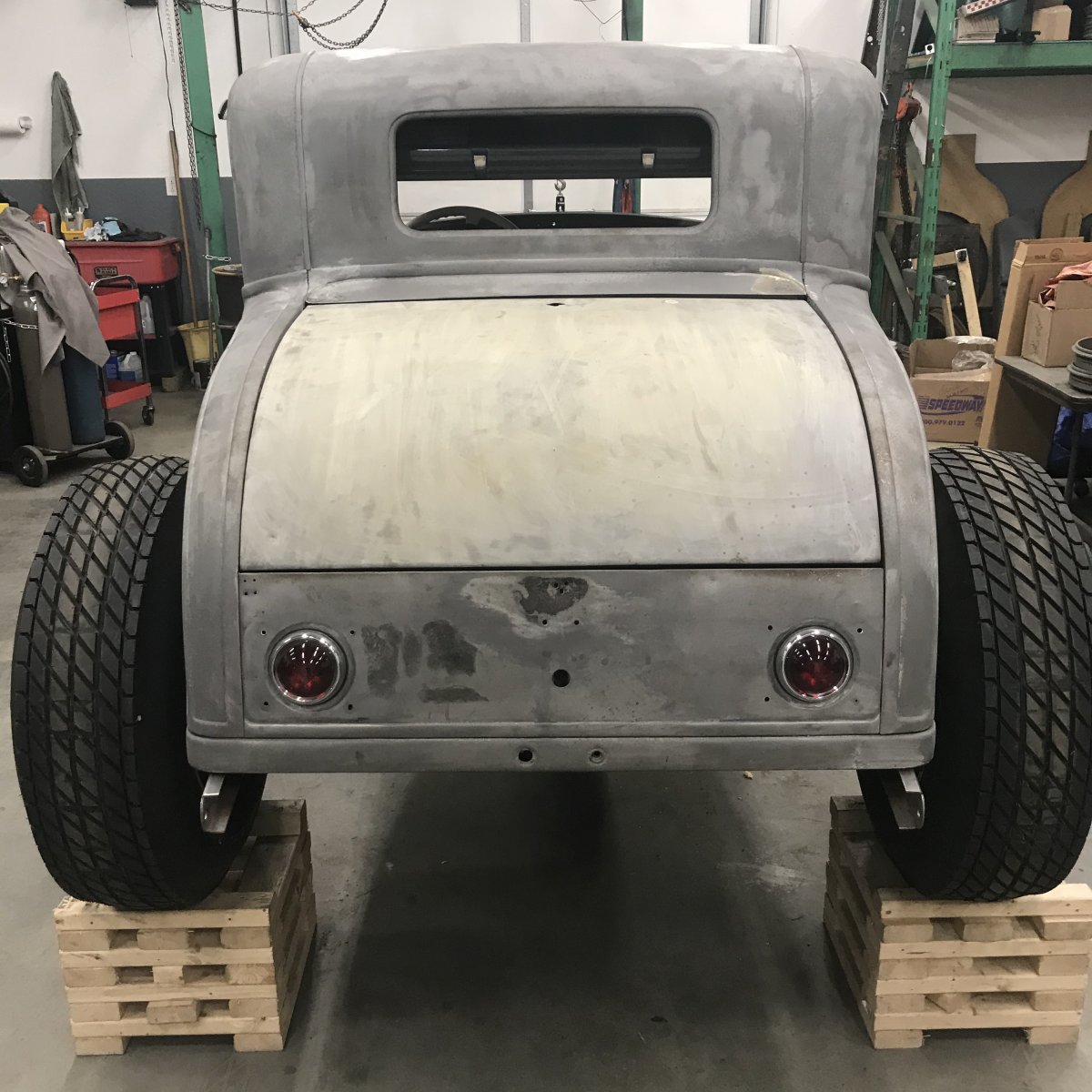

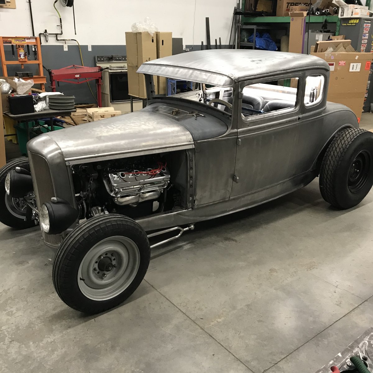

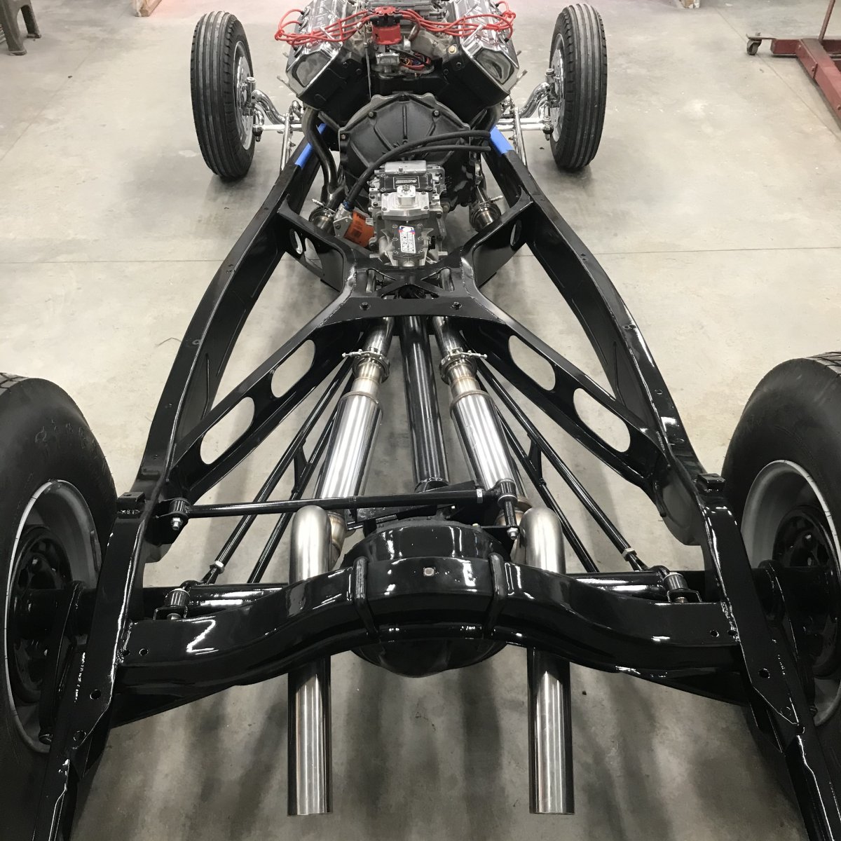

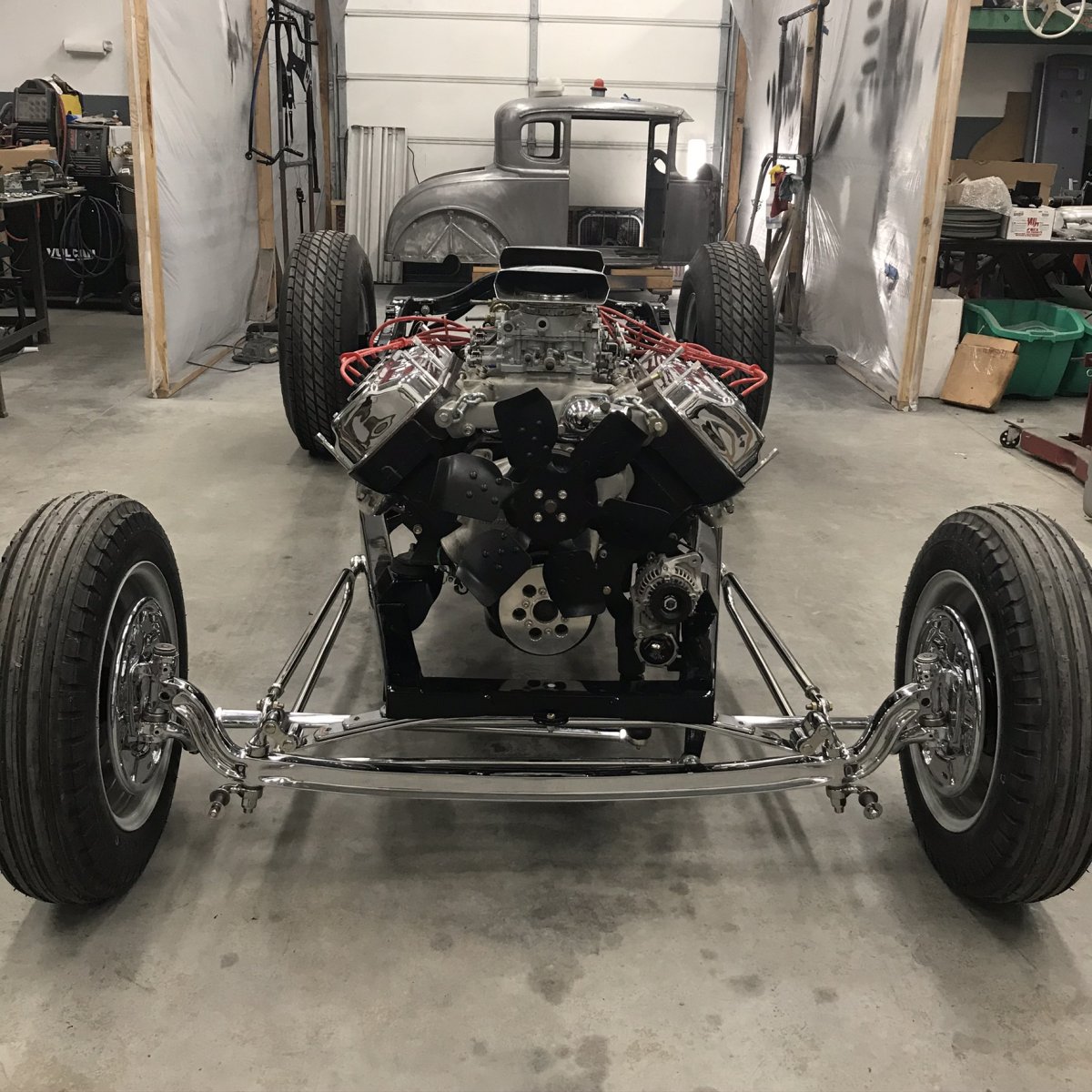

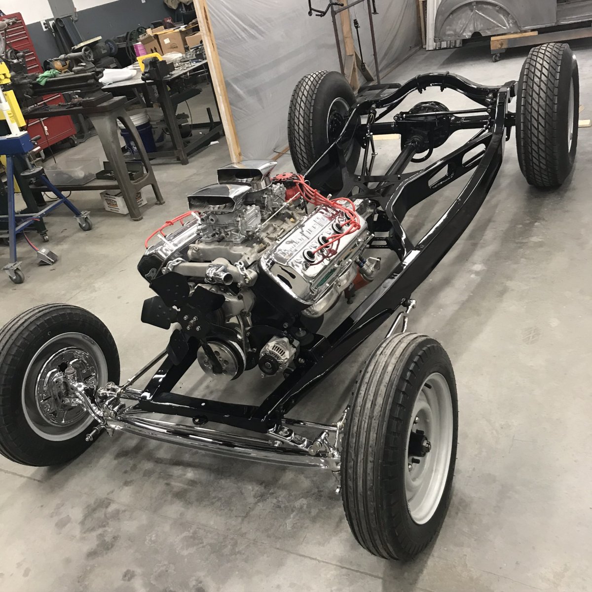

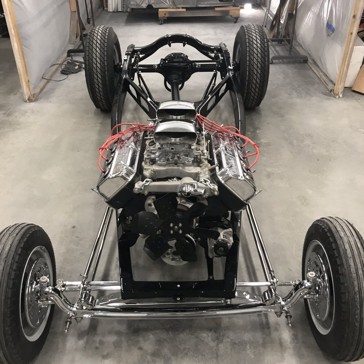

    Ready for headers and exhaust (by Mike Barillaro). Then back to me to finish.

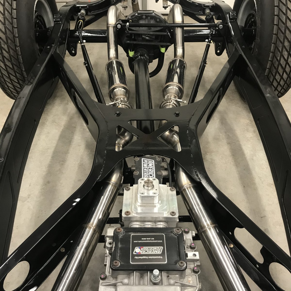

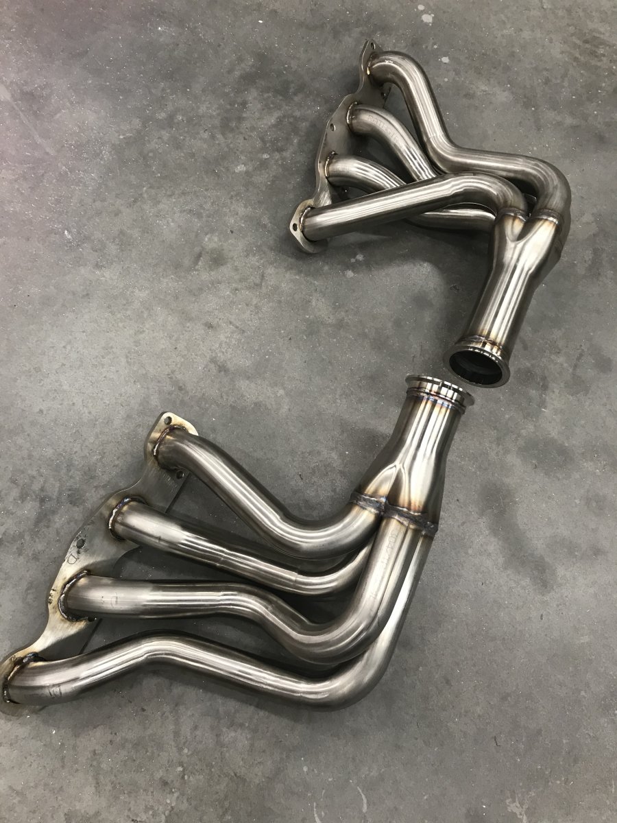

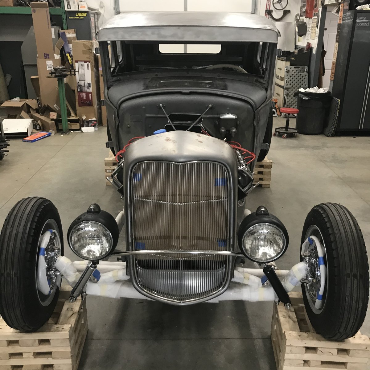

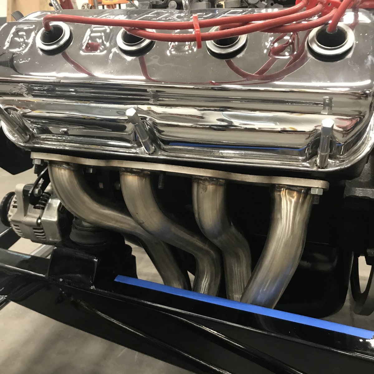

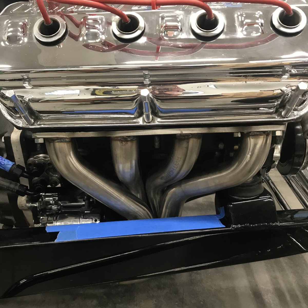

    Headers and exhaust done. Custom headers by Mike @ Barillaro Speed. Came out great.

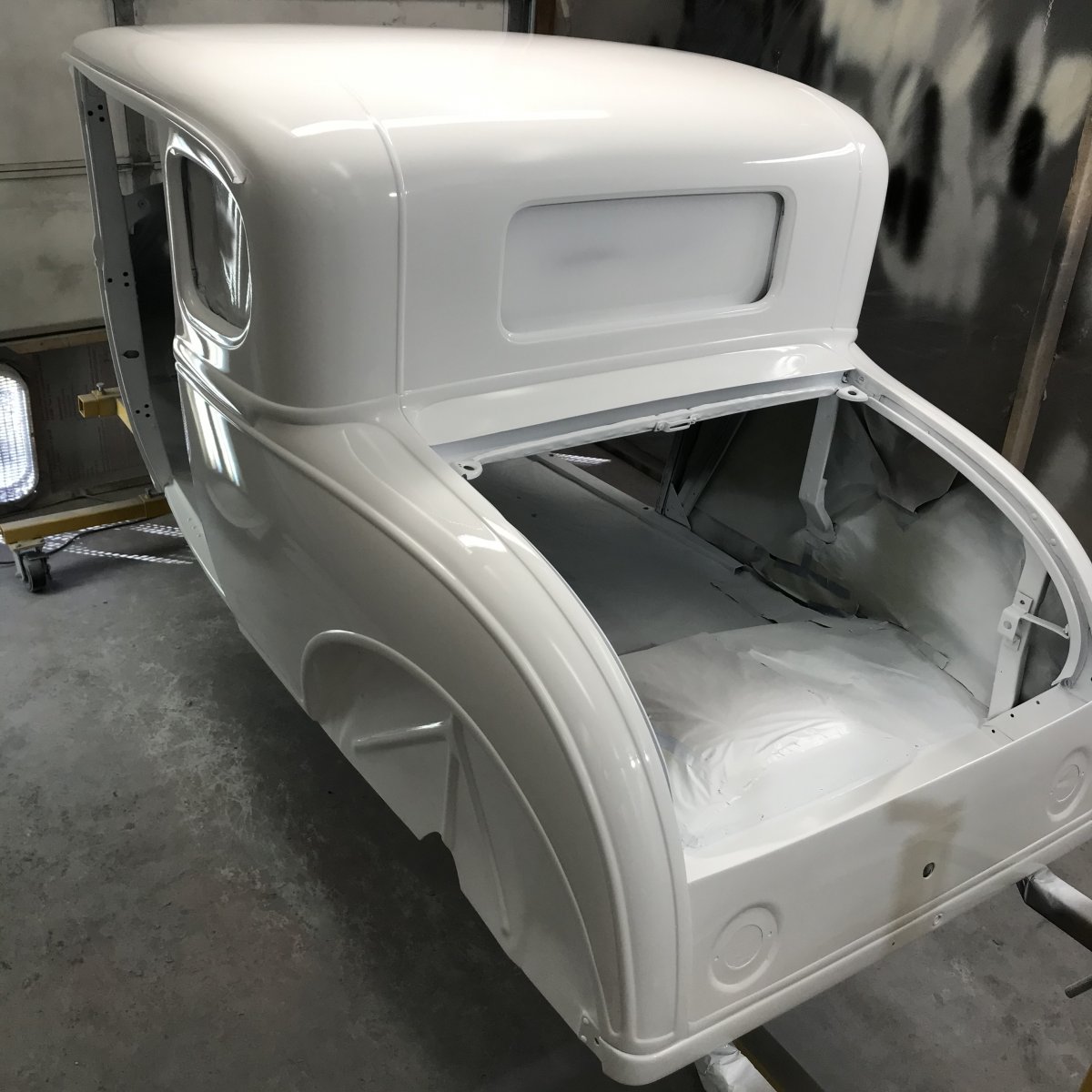

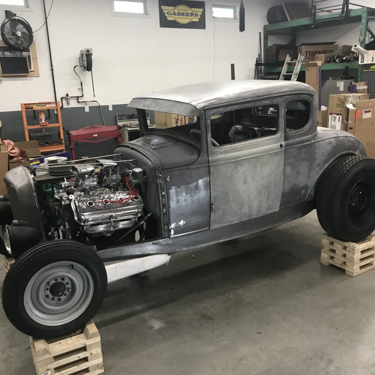

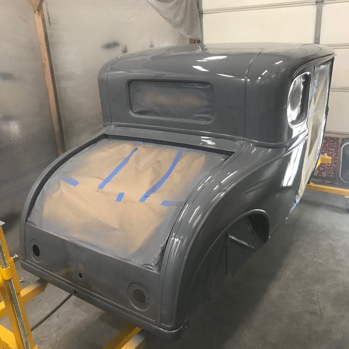

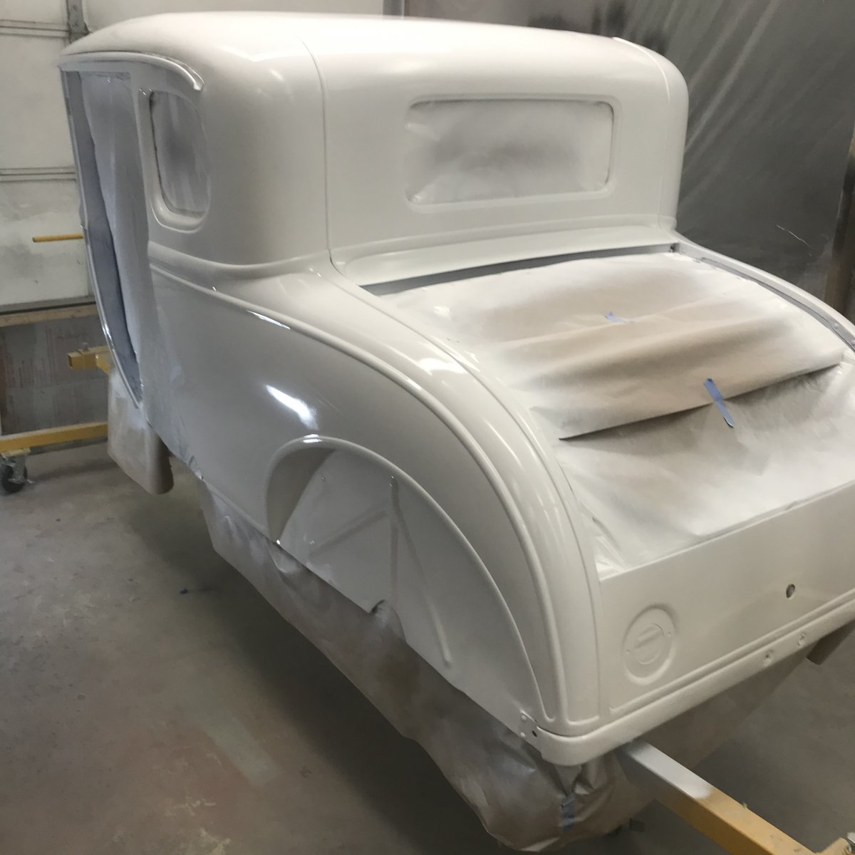

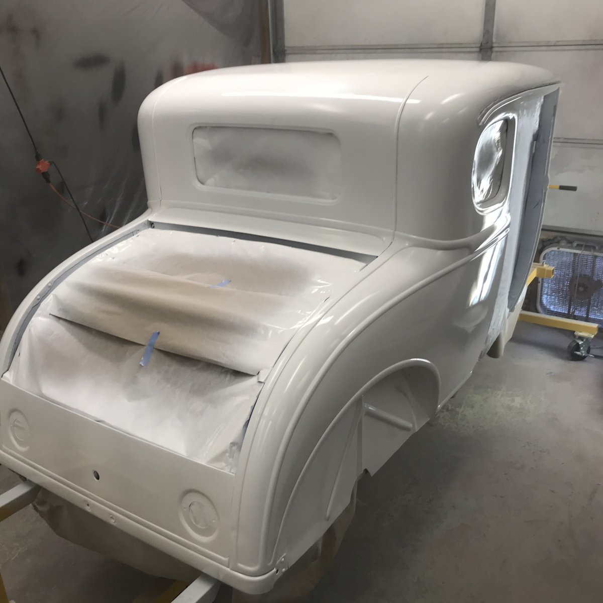

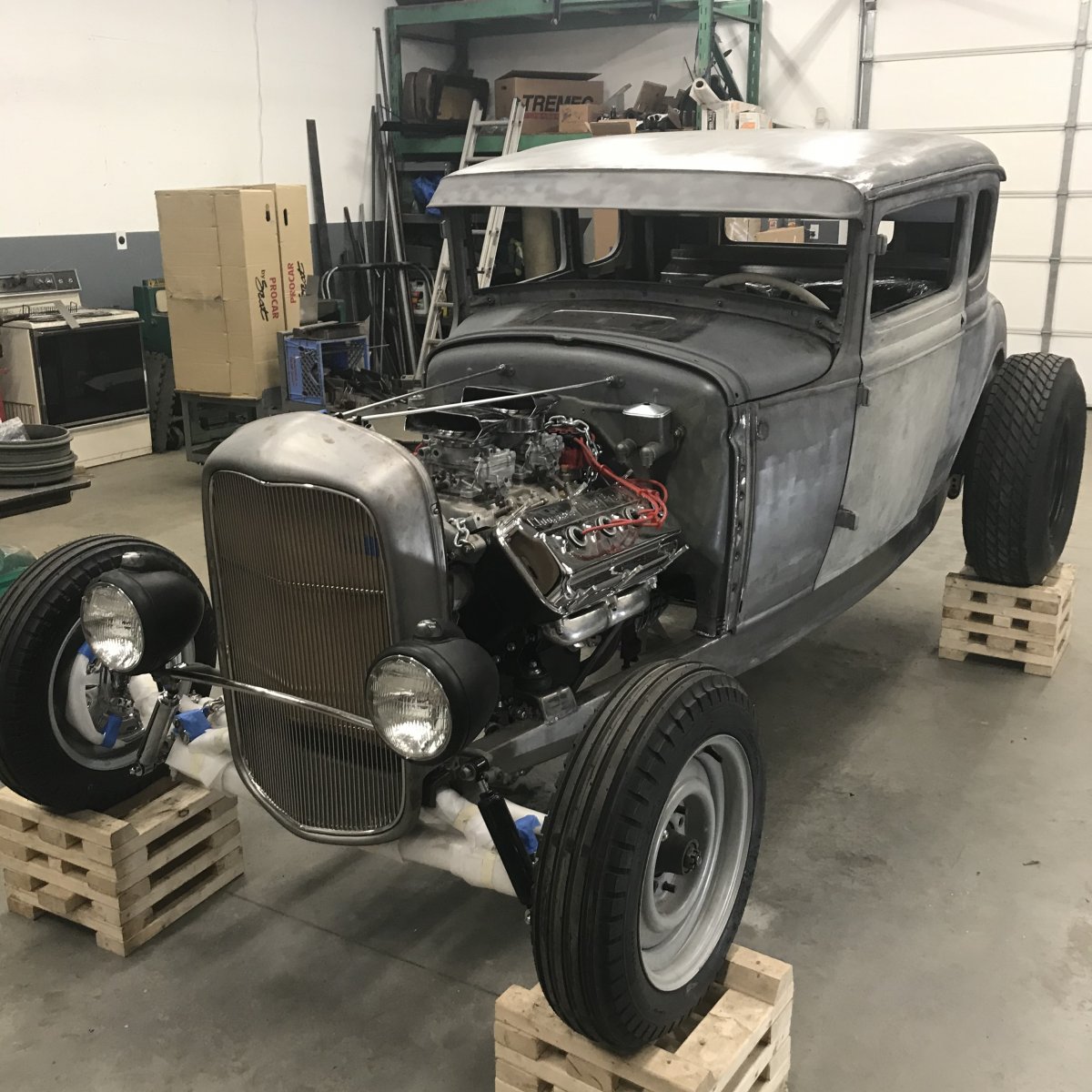

    Long way to go. About halfway through the paint and body. Here’s some shots of it in white epoxy. I plan to paint it Chrysler polar white (or something close).
    D17FC438-36C5-441C-9154-5653302AEDF5.jpeg 064E66F7-CA95-4485-BBA5-2AE9376A4063.jpeg

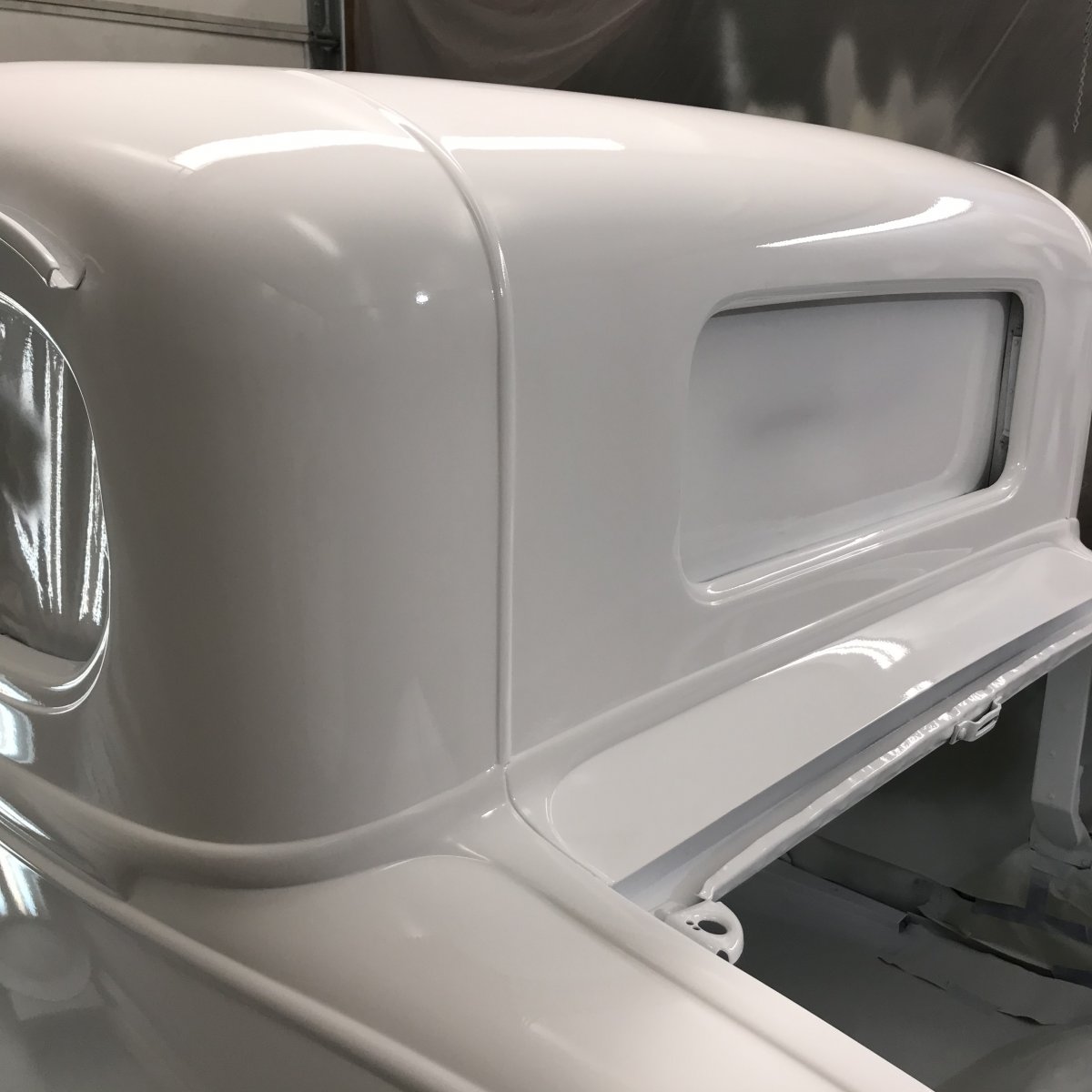

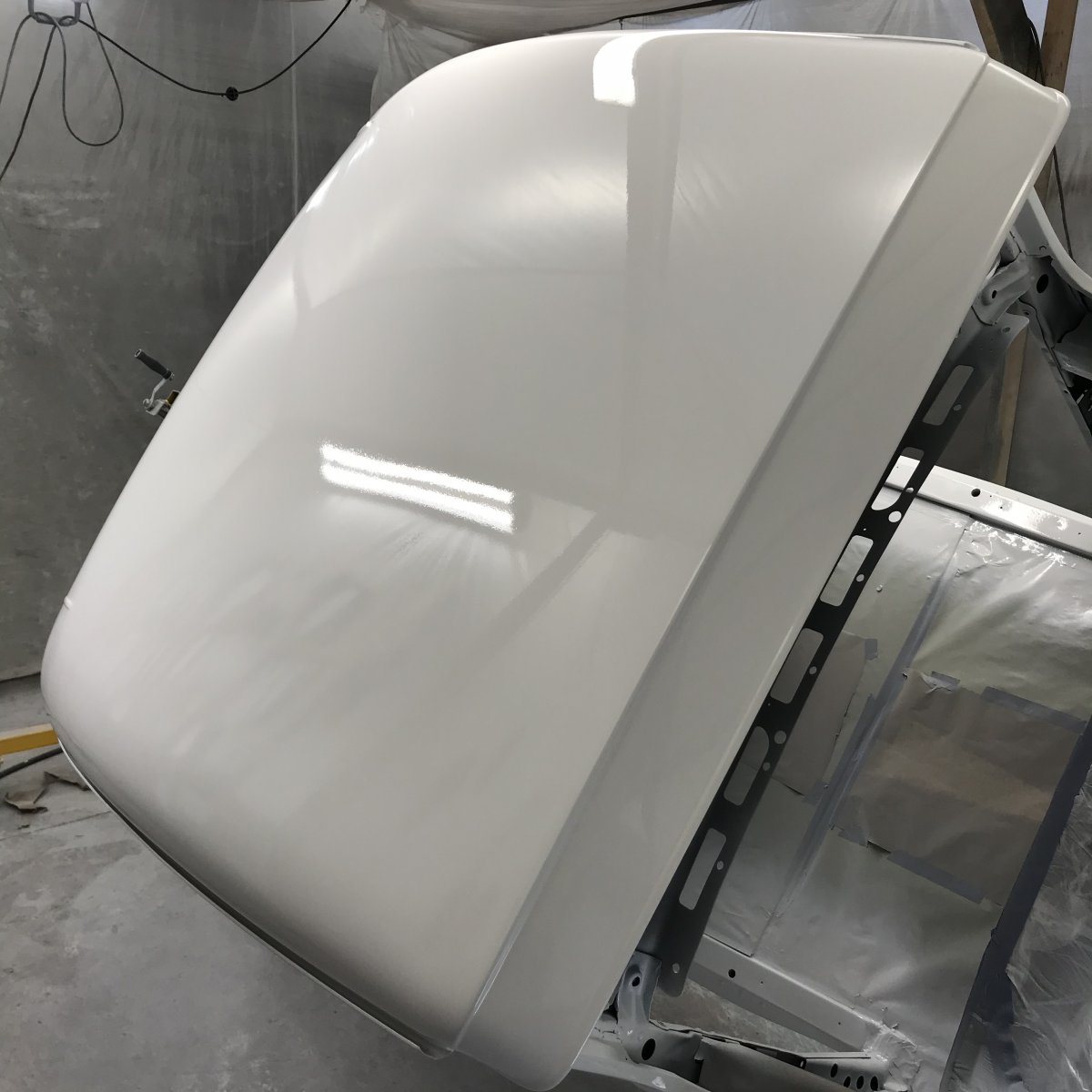

    Finally got some paint on it today.

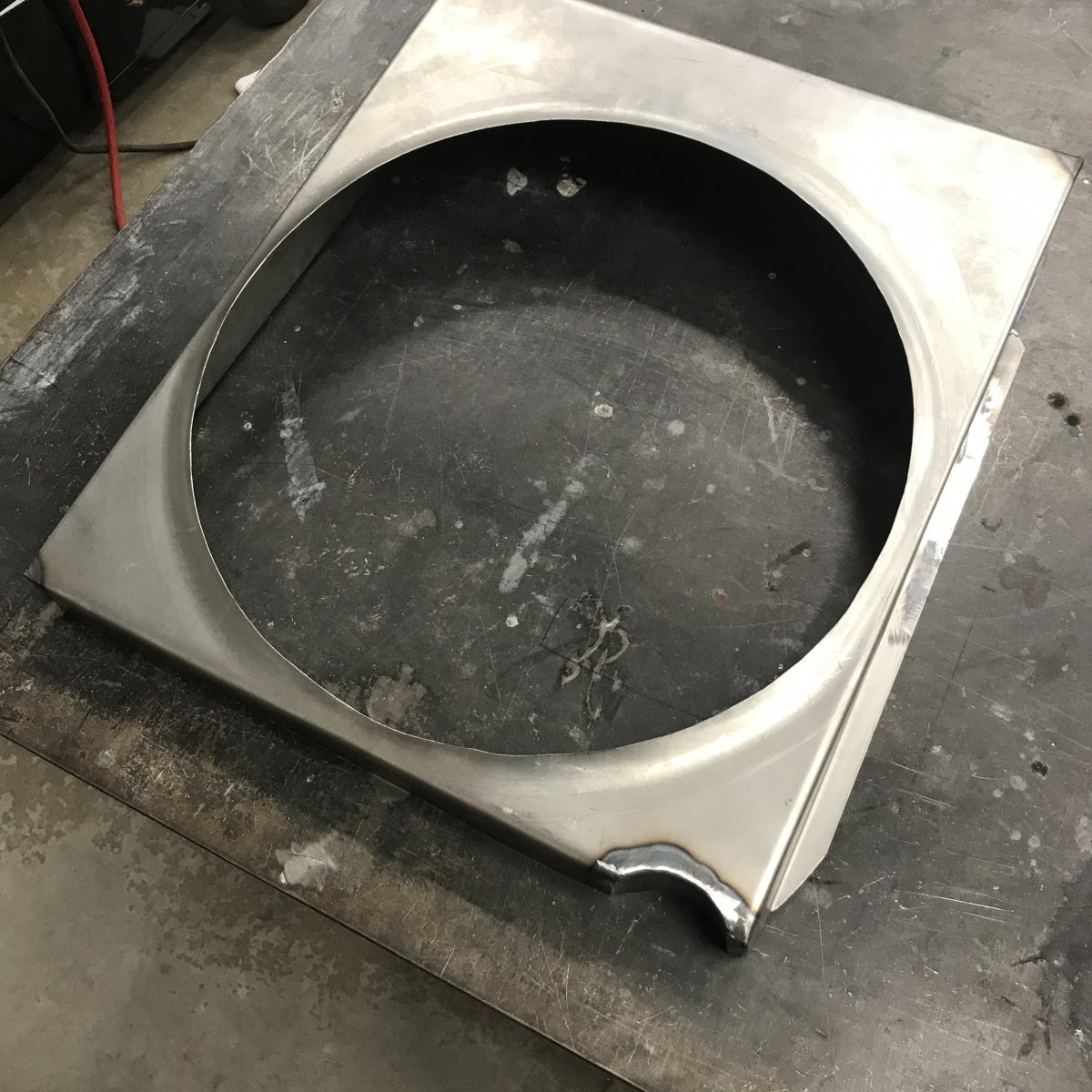

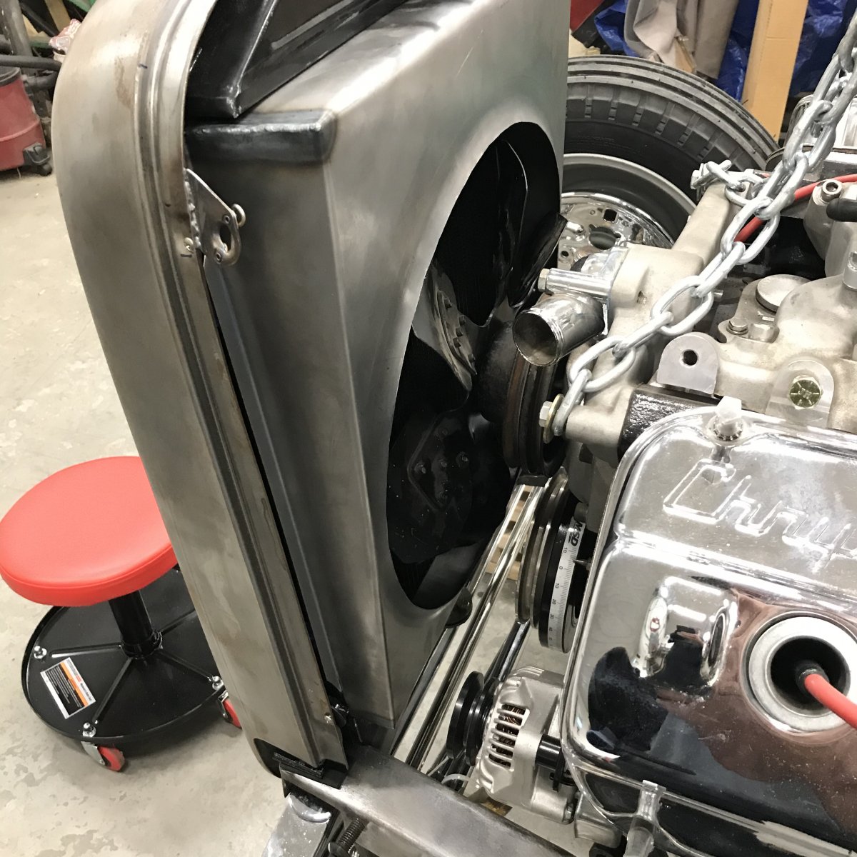

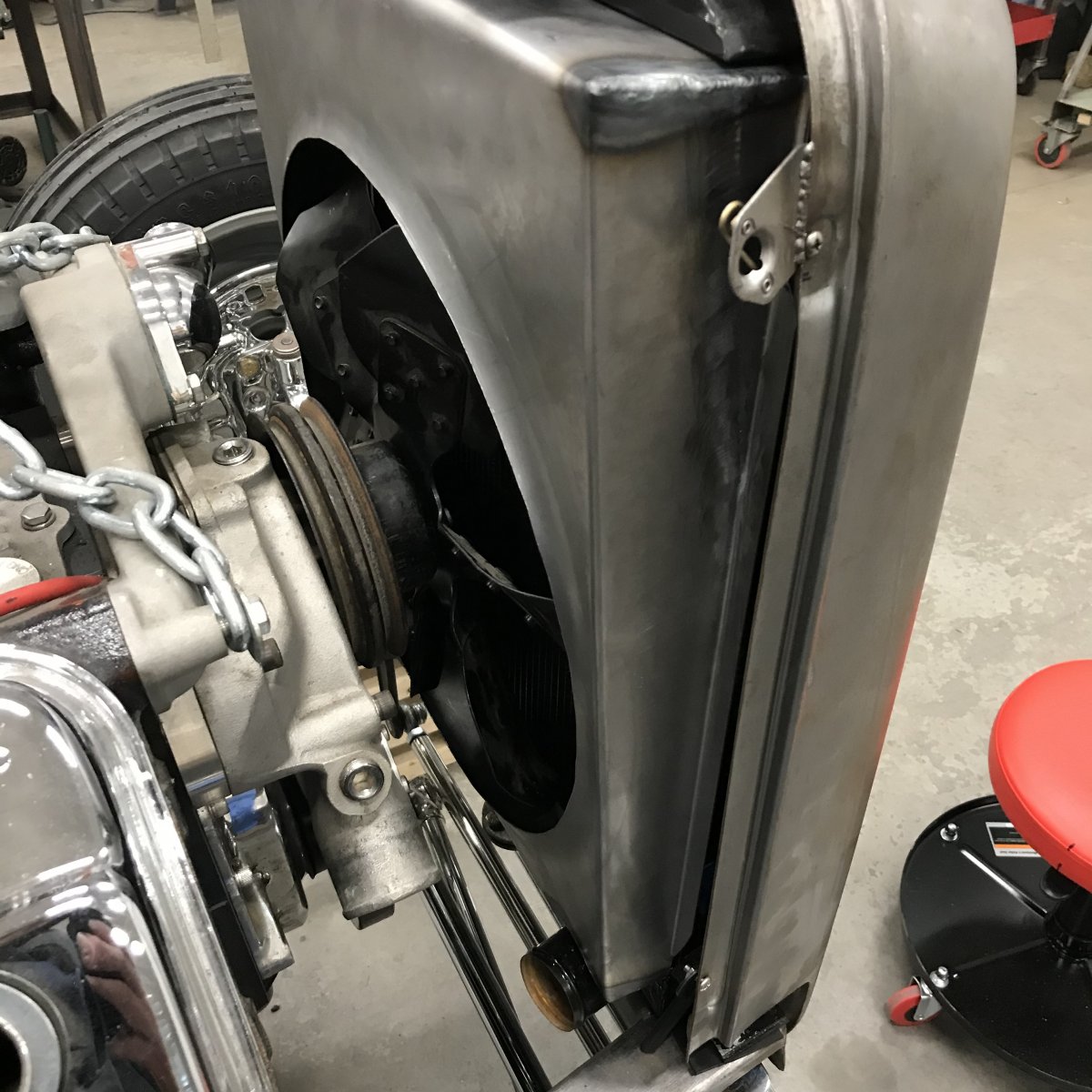

    One question, is the radiator shroud tapered, larger at top than bottom due to grill shell angle ?
    Thanks Jay
  22. wdglide
    Joined: Jun 21, 2009
    Posts: 310
    wdglide
    Thanks.
    It’s tapered to match the angle of the fan (engine).

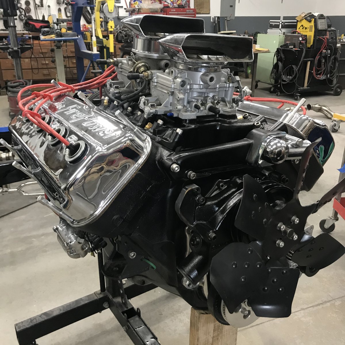

    This is likely a dumb question. What kind of air filter do you run in those scoops? I’ve seen them on several cars on here, but never with a photo close enough to see any details.
  27. wdglide
    Posts: 310
    wdglide
    No filter. Just screen. enough to keep birds and stones out
    I’ve been toying with the idea of putting some prefilter foam between two layers of screen.
