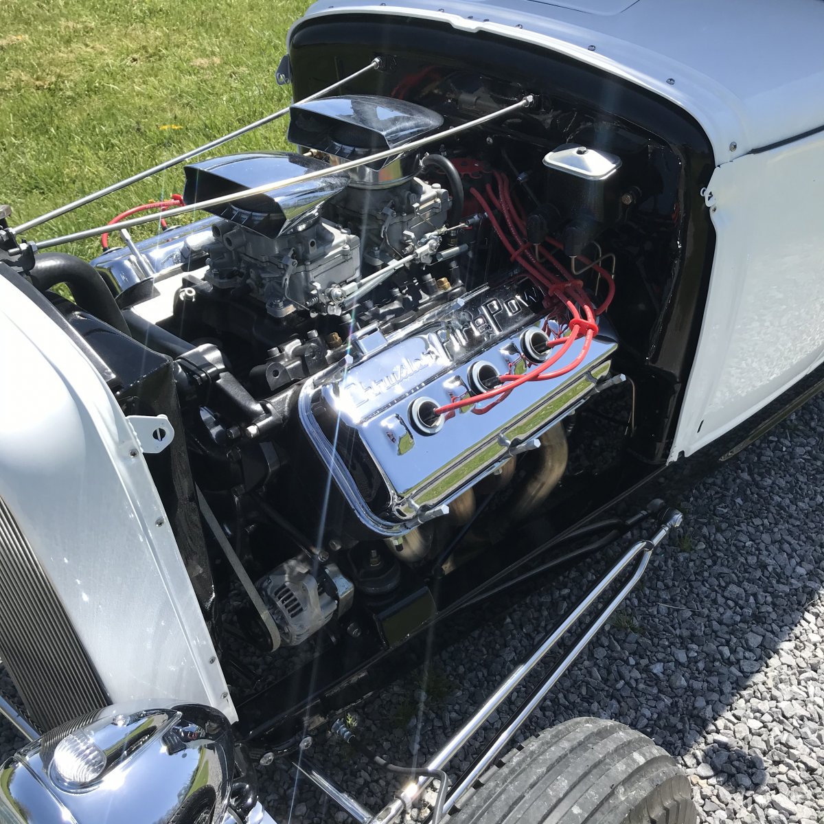

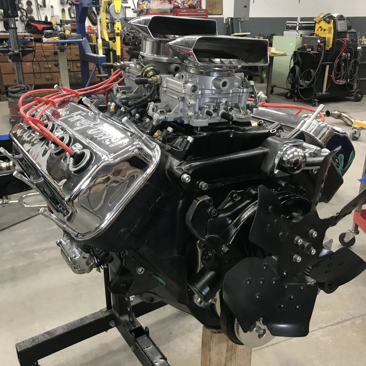

    If you do add that foam, dont be shocked if your engine runs real rich at wide open throttle. That stuff is rear restrictive to air flow.
    Stogy, wdglide, AHotRod and 1 other person like this.
  2. rod1
    Joined: Jan 18, 2009
    Posts: 1,512
    rod1
    Yeah ,and if she backfires that foam turns into a real Mess. Nice Ride!
    wdglide, AHotRod and loudbang like this.
  3. wdglide
    Joined: Jun 21, 2009
    Posts: 310
    wdglide
    exactly why i was hesitant to do it. Thanks.

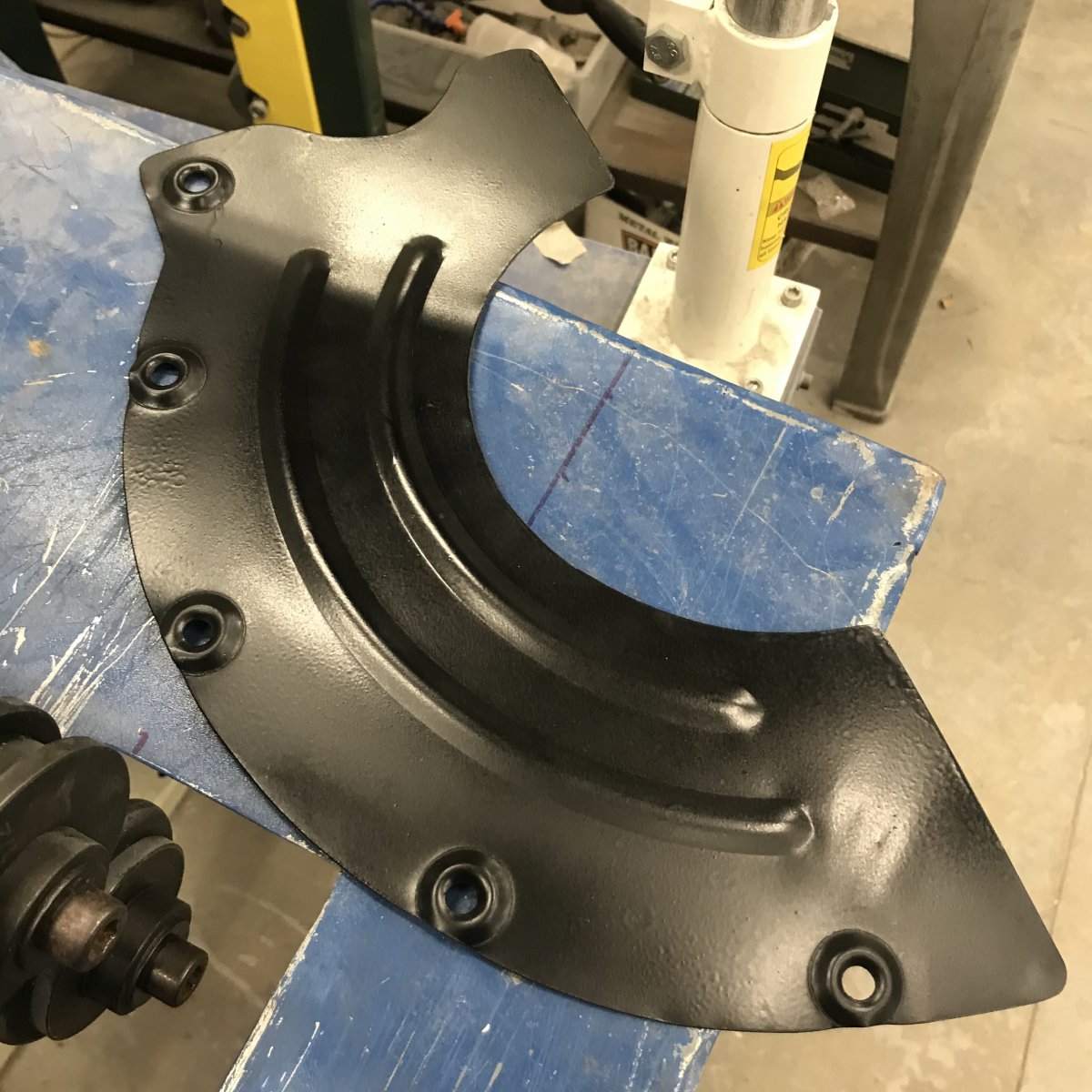

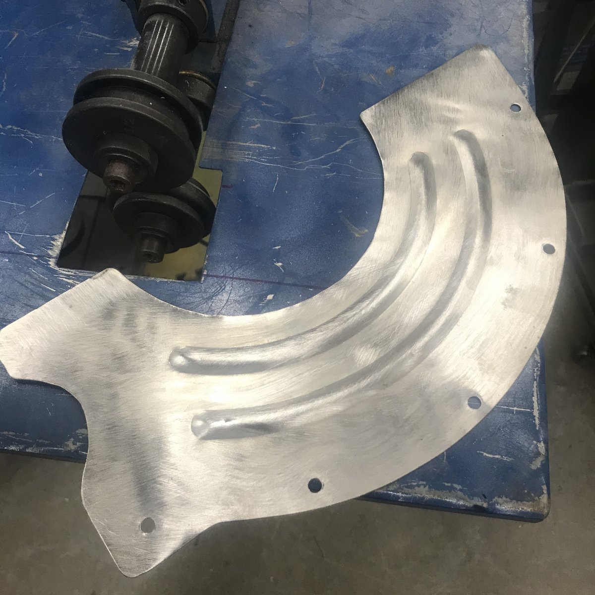

    custom clutch dust cover
    9C40FBBD-6A26-43C6-A811-0E36ED25CC64.jpeg 62B452DF-7598-4F24-95ED-3F3F2DA6E055.jpeg

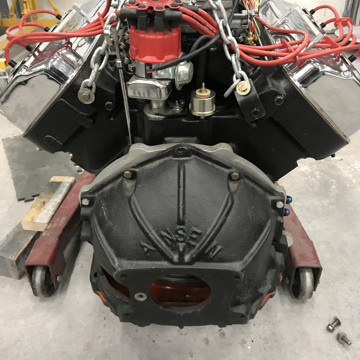

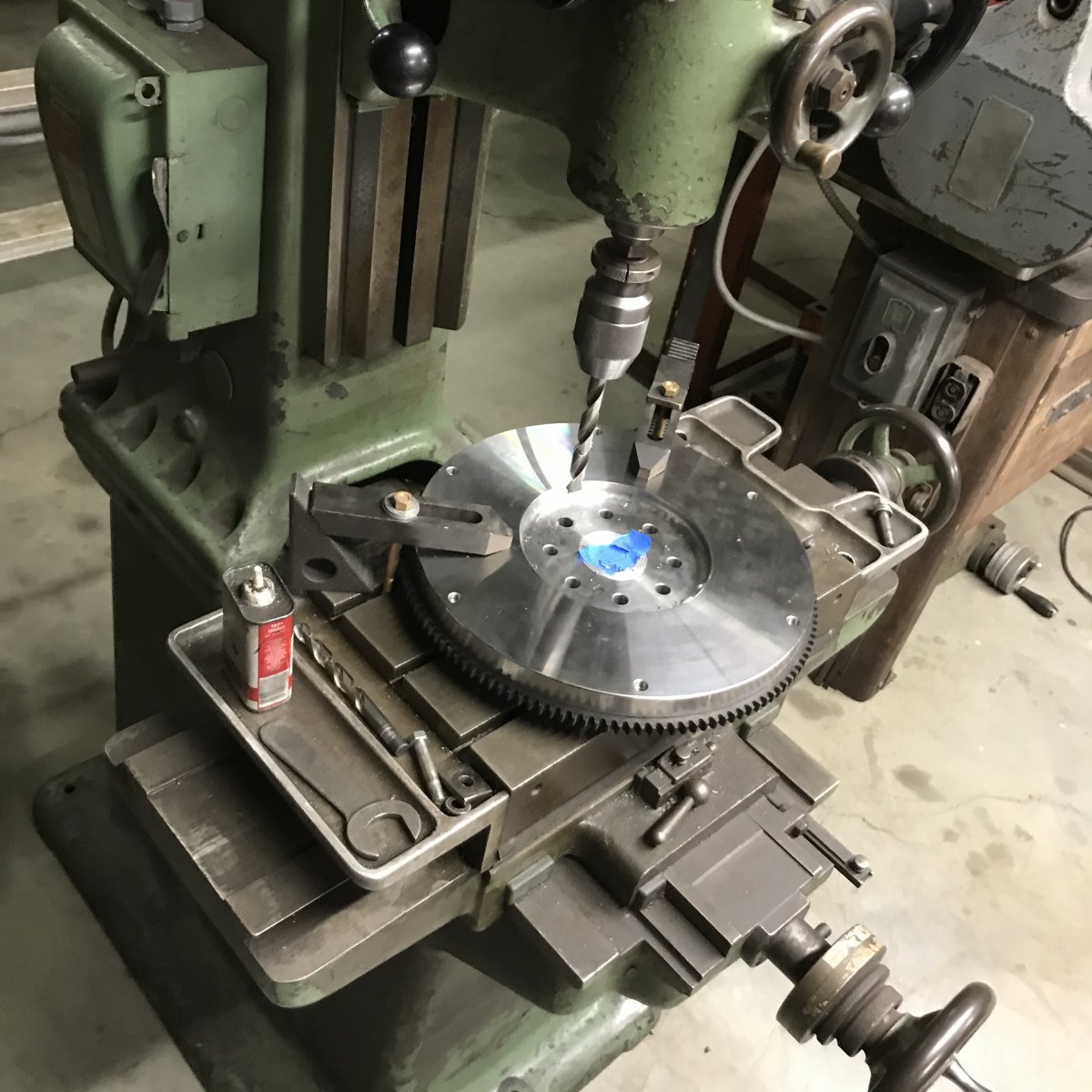

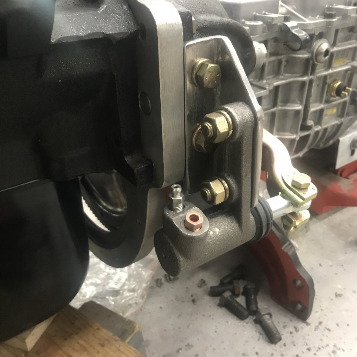

    Clutch slave and mount. I used a slave out of a 57 F-100. I had to machine and tap the side of my Ansen blowproof bell to accept the mount.
    22A4A973-DC48-4A2F-BA49-7806EFE9EEF8.jpeg 06DB97E0-0CA2-45FD-9C09-72F4E9BD5F4C.jpeg
    also had to redrill my flywheel to accept 1/2” bolts

    For your carb scoops, maybe look into an open cell foam. I've used this on bikes and vintage chainsaws without it melting or running rich. I usually soak mine with some motor oil or K&N oil to capture the dust etc. similar to a lawn mower filter. It might sound silly but I saved a couple chunks of eggcrate open cell foam from the last Henry rifle I bought just for air filer elements on vintage chainsaws that I can't find air filters for anymore. Might take some playing around with some screen mesh to keep it in place but if it'll work on a bike at 9,000 rpm I'd think your Hemi should do alright. My vintage Case 446 riding mower gets HOT under the hood and has a foam cover over the paper element, doesn't melt, breathes just fine. Just a thought . . . .
    Remember these things? They effectively gave you zero performance improvement but used a foam element.

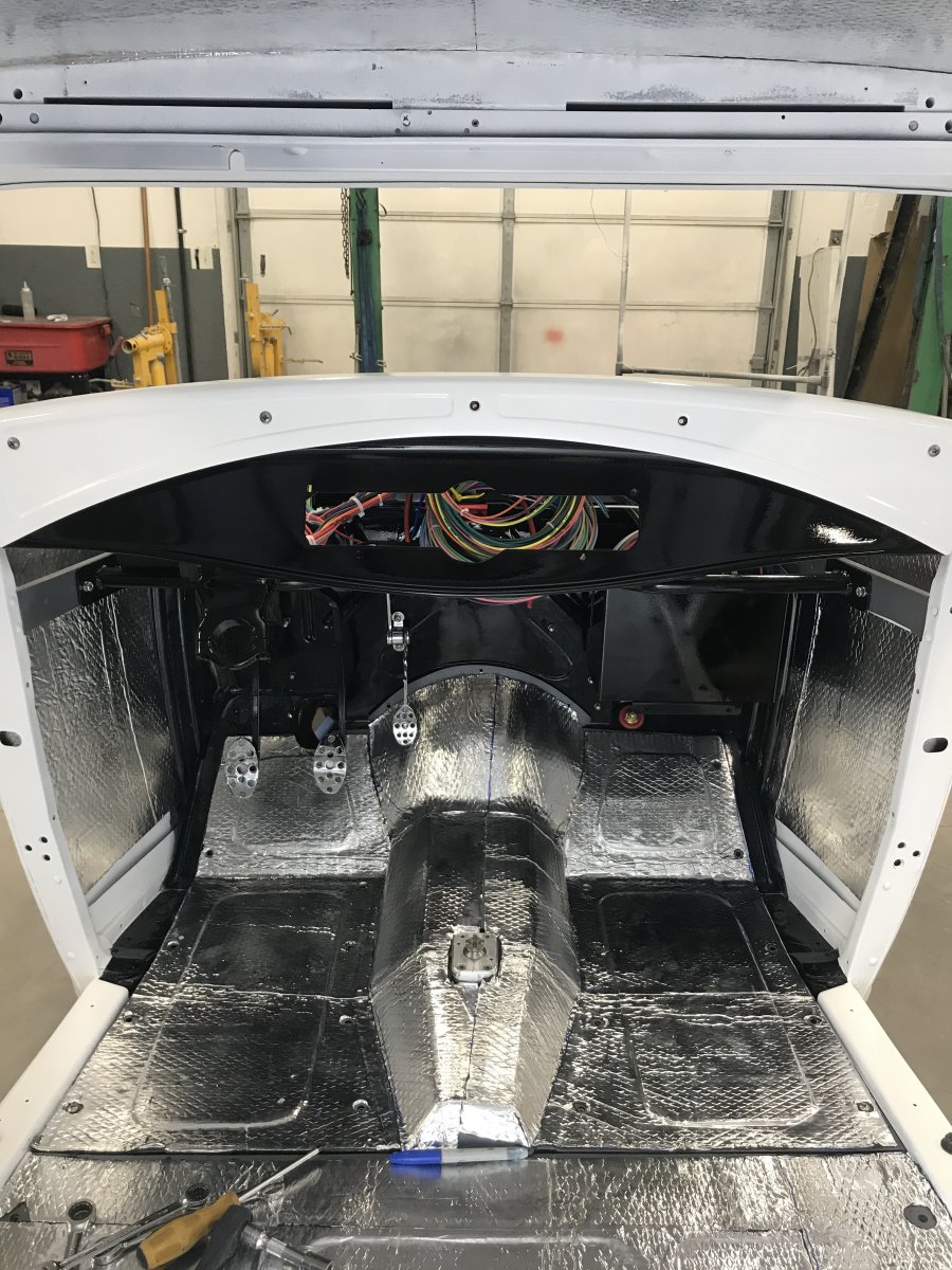

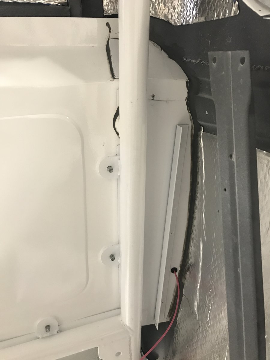

    Great work. Puts mine to shame. I just was working on my bulkhead. How did you seal the sides of the bulkhead to the quarter panels? I plan a fitted piece on each side but can't see how you did it in your pics.
    I'm apparently over the mountain from you to the west.
    loudbang and wdglide like this.
  16. wdglide
    Posts: 310
    wdglide
    I used a couple fitted pieces. I planned to make it all removable, but I caulked it (fireproof). So I’ll likely never remove it.

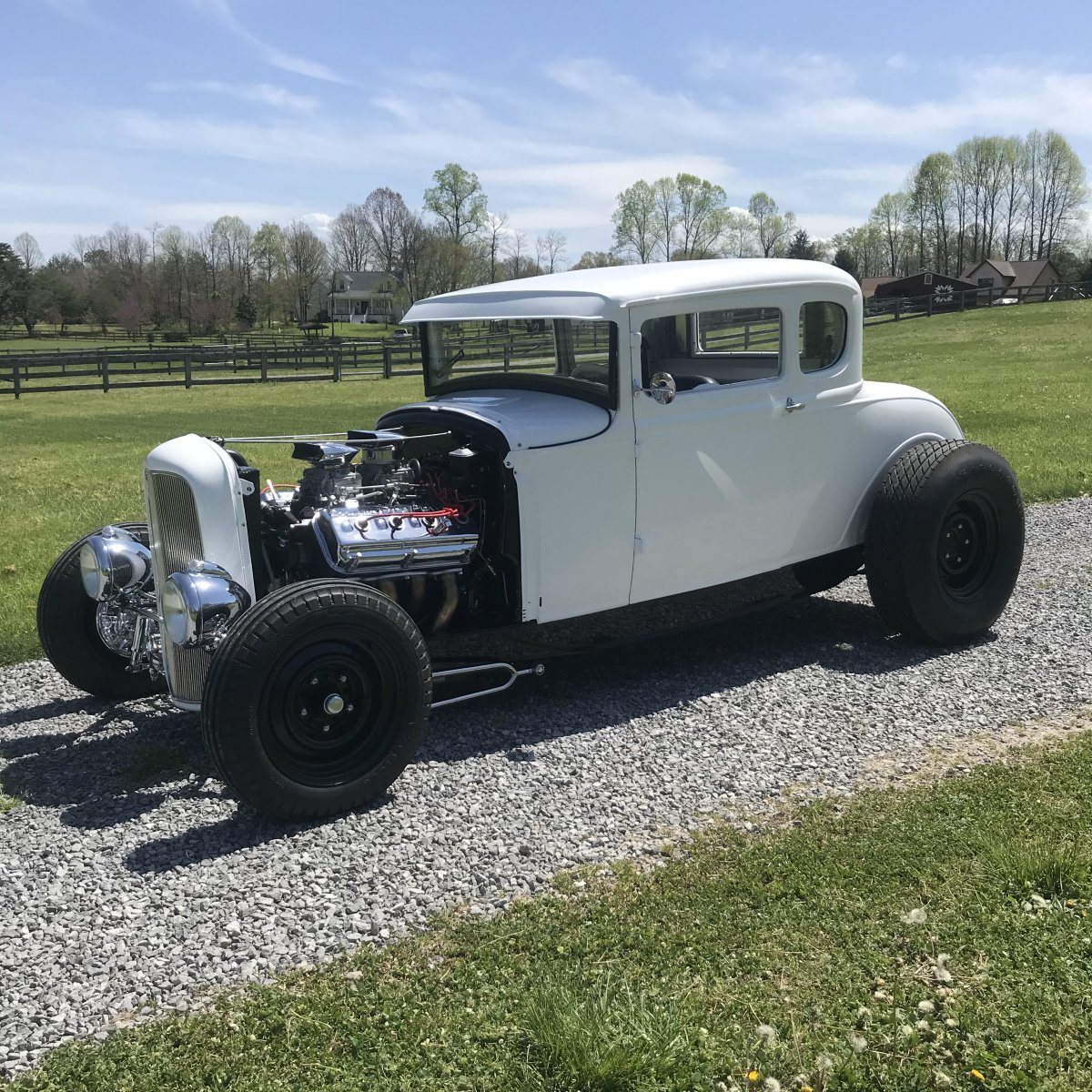

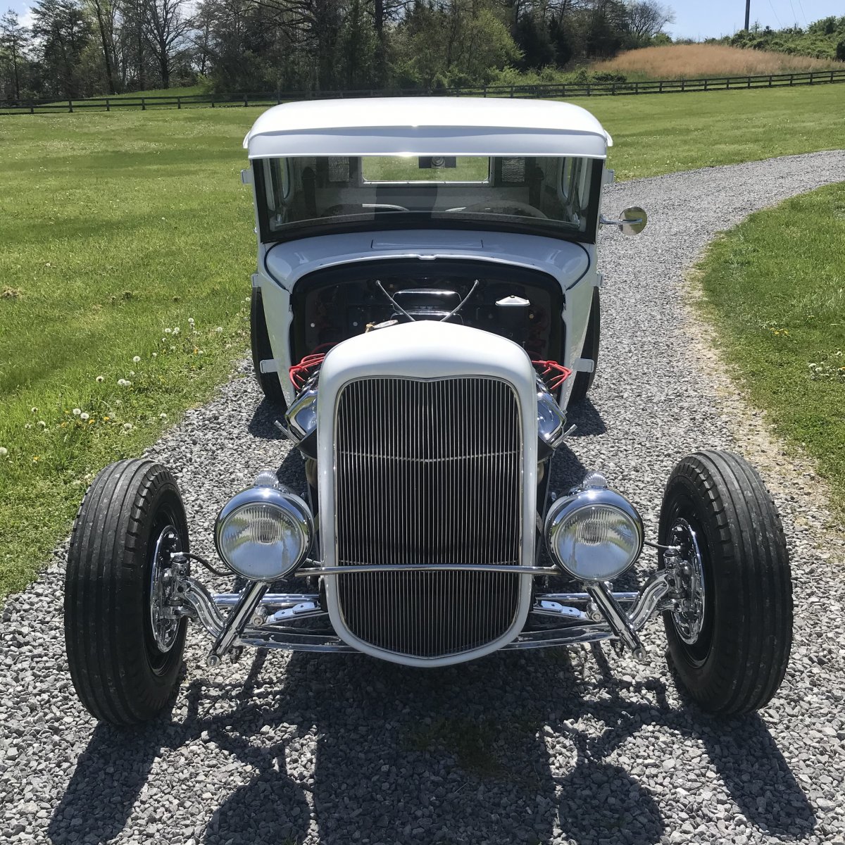

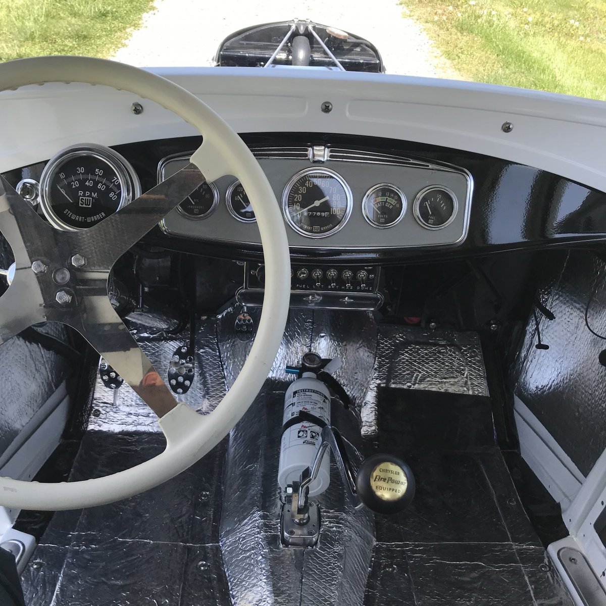

    Feeling like a 16 year old with a new license. Stopped long enough to take a few photos. 2 years in the making! A couple things need tweaking but overall I’m pretty happy with it.

    Looks great, I'm sure you're anxious for some summer weather.
