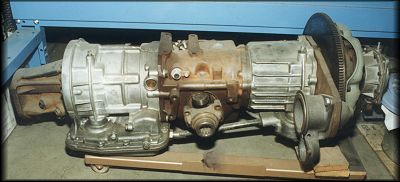

    Here is a pic of the 4 speed powershift transaxles that were in the 63 superduty 421 cars. 2 speed trans on the left, diff in the middle, another 2 speed on the back with a flywheel & clutch hung on the back. Push in the clutch, shift into drive, ease out the clutch & ease on the throttle. When it upshifted to 2nd gear, then nail the throttle & hang on!!!
