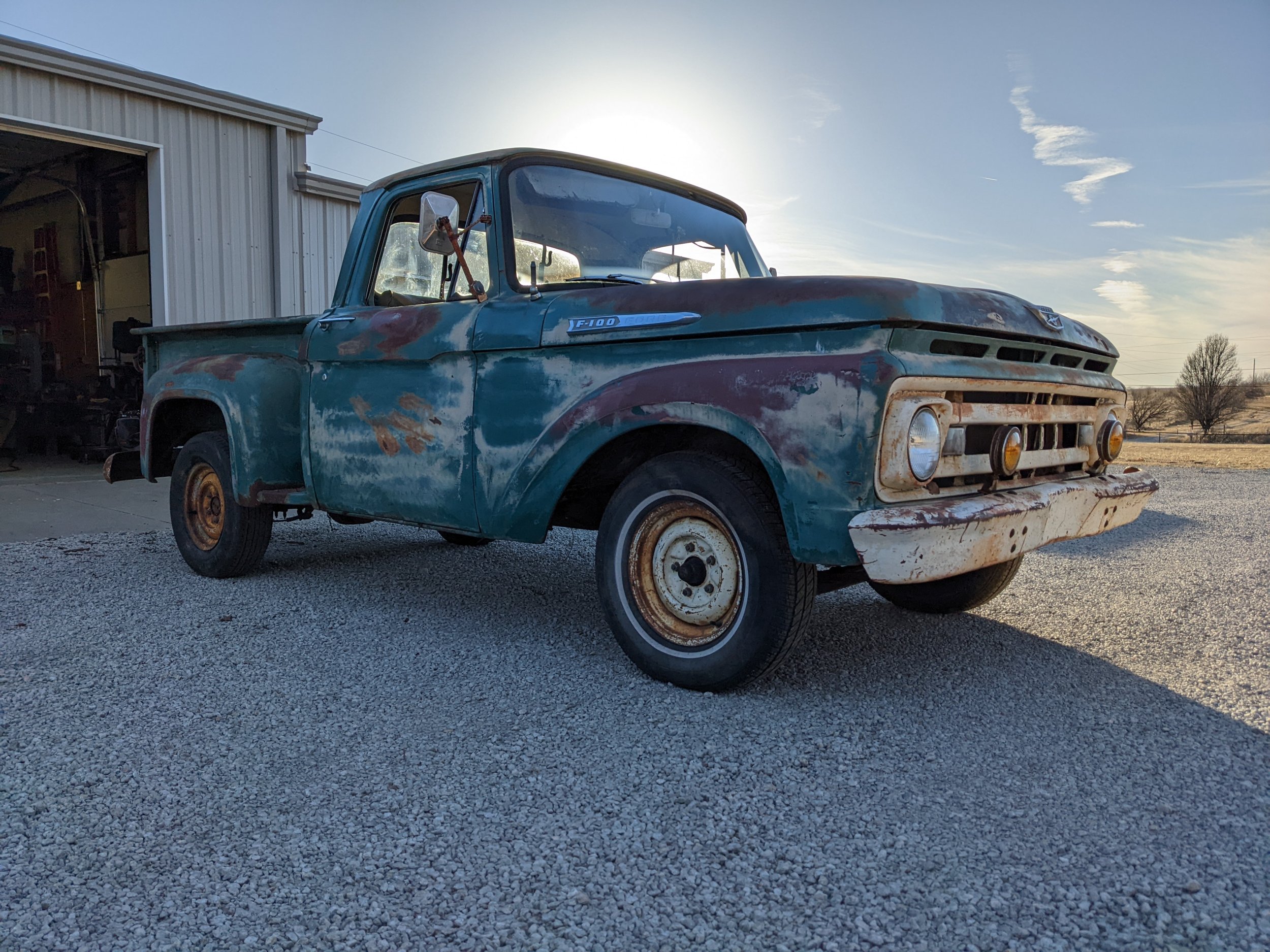

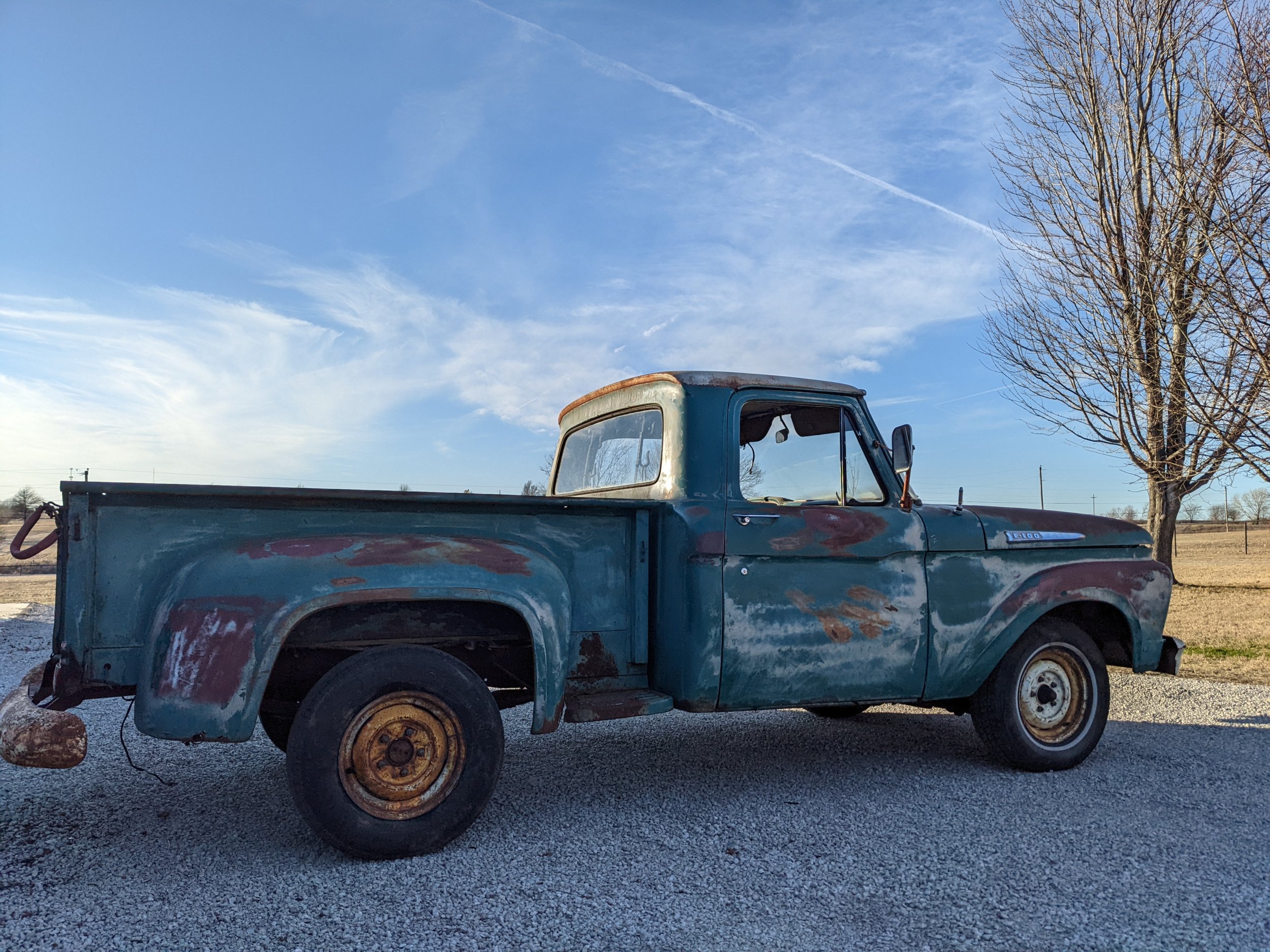

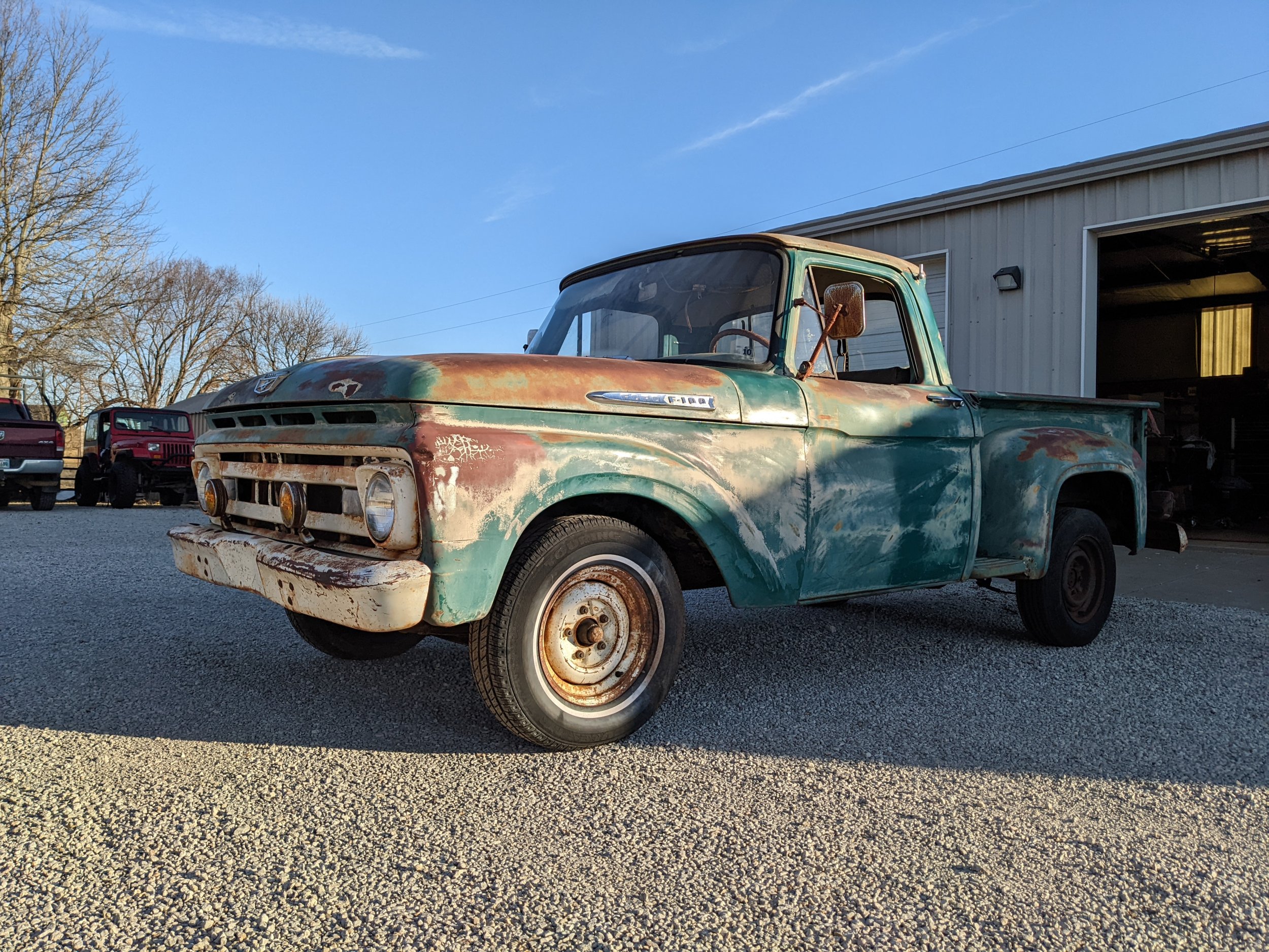

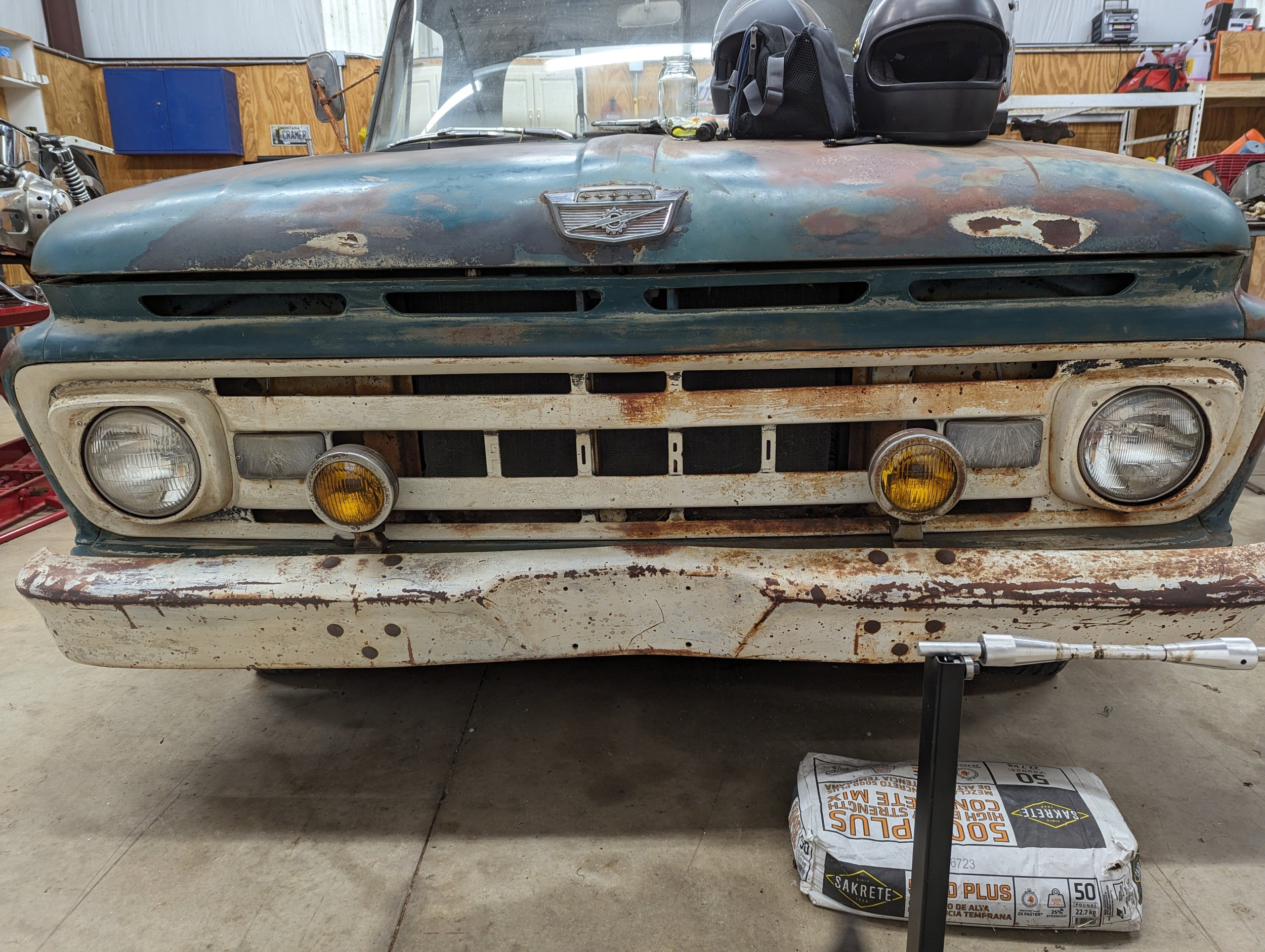

    I never posted any kind of build thread so I might as well post an update, as much for the common interest, as in an effort to re-spark some interest from me in the stalled project.
    A couple of years ago I picked up a couple of F100s a 61 with a 223 and a 64 with a 292. The 292 was locked up (hood up, no air cleaner for years) and believe it or not it was in worse shape, rust through the roof, drip rails, etc so I sold it to help offset costs on the 61.
    As found, it was last tagged in '98 and had been sitting there since.

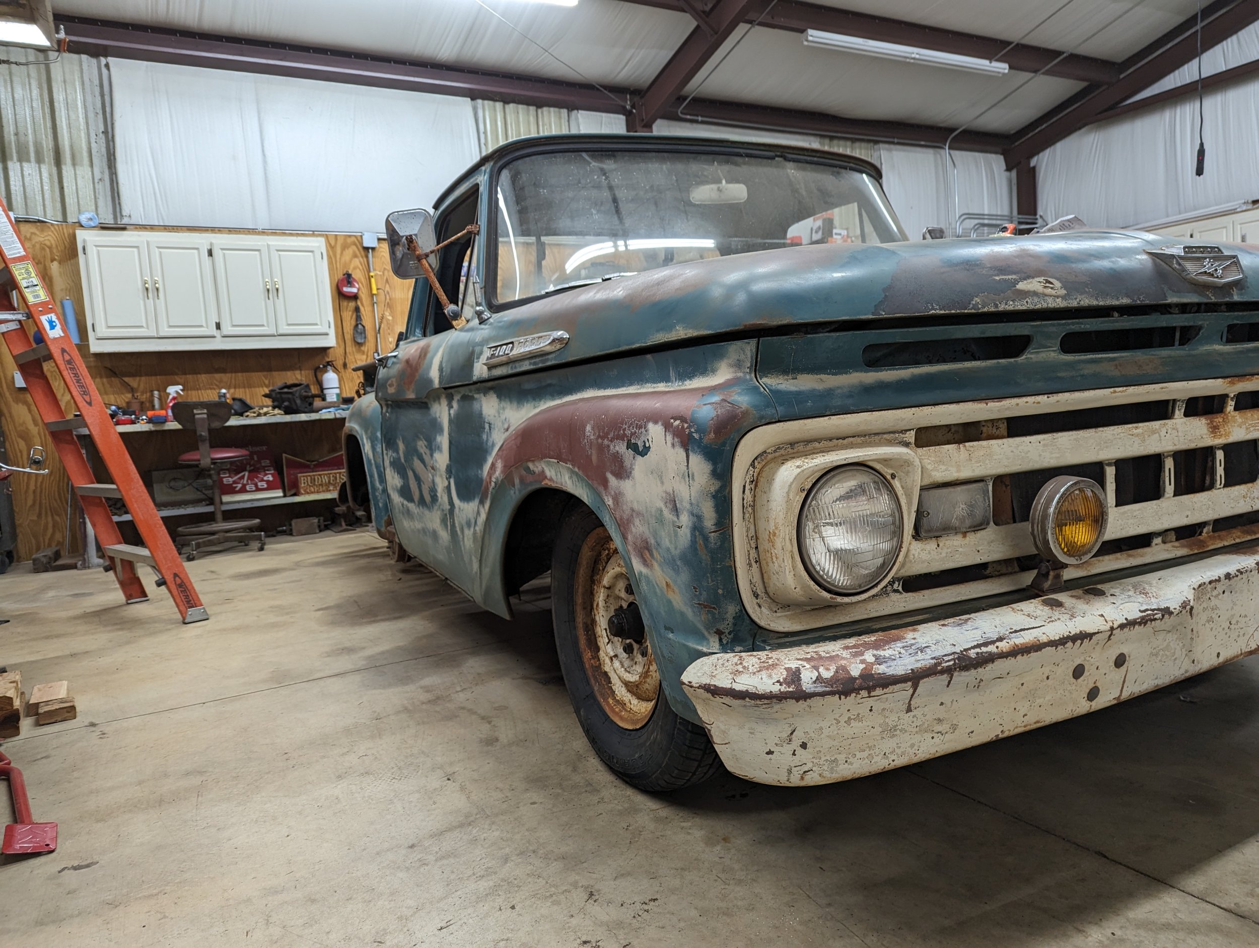

    Now in hindsight, I should have put a better plan together and prioritized work based on getting the thing rolling under its own power, but I wanted to see changes and do fun stuff so I kind of just took a shotgun approach.
    I started off taking the bed rack off of it and just in general cleaning out the years of dirt and debris. PXL_20230116_222035220.jpg PXL_20230116_222017407.jpg PXL_20230116_222000790.jpg
    The previous owner told me first gear was out of the 3 speed, so I opened it up and it was pretty nasty, looked like it had been run dry and got hot. I cleaned it up, washed it out, new seals and gaskets and a fresh speedo gear. Then resurfaced flywheel and new clutch.
    Had Nastalgia Sid drop my axle and put new bushings, Posies, and shocks all around to try and help the stance.

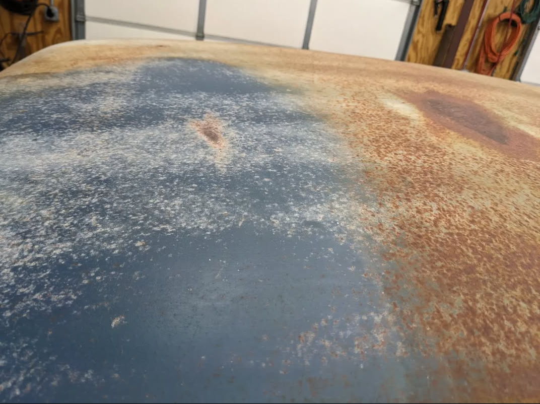

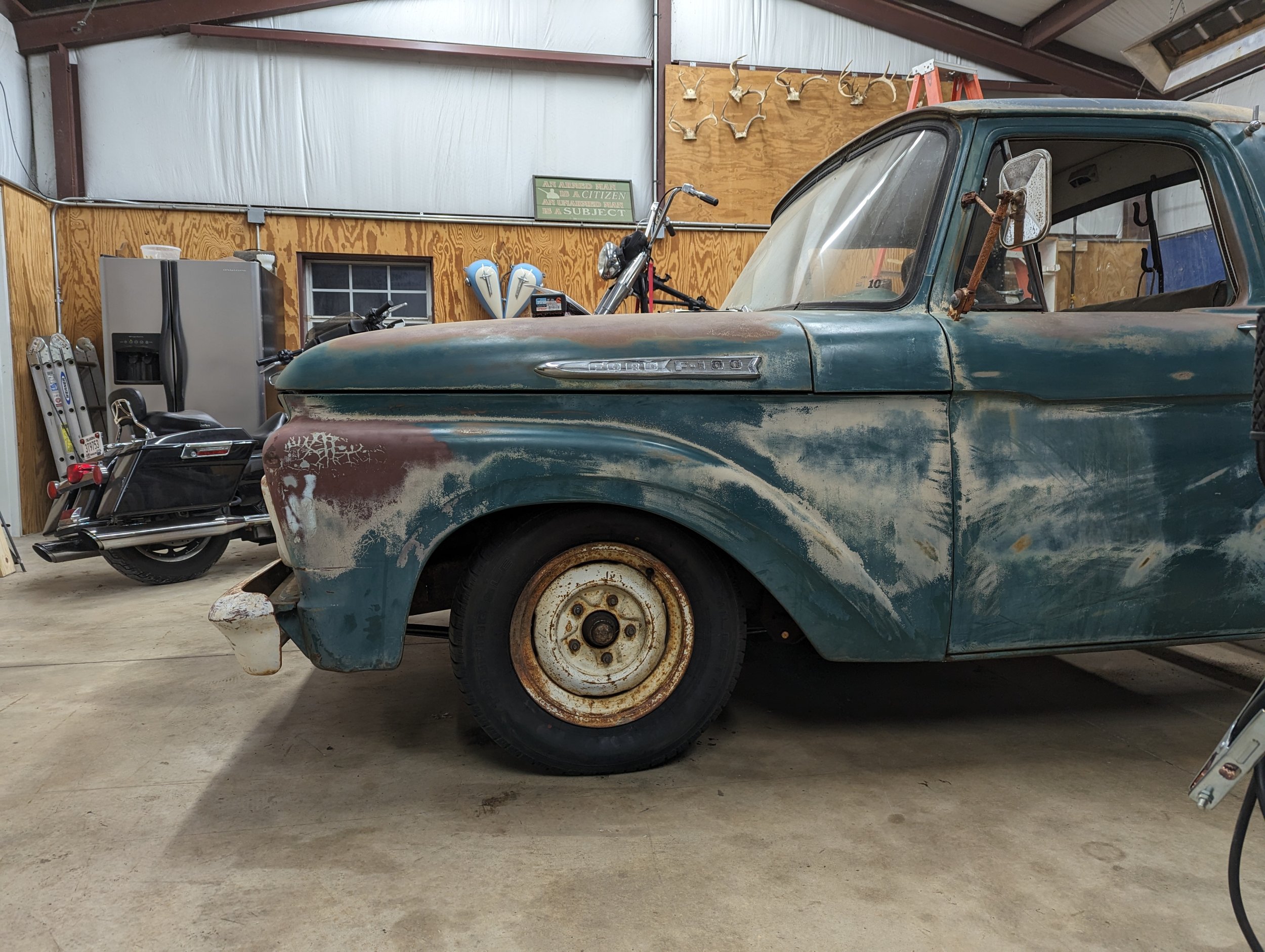

    Some of it has cleaned up ok. Left vs right PXL_20231028_224916687.jpg Screenshot_20250811-211118.png

    From those that have been here with a project beyond their ability to do "right", would it be crazy to just patch the cab/inner fender and get the cab mounts and floors in? For what this truck will be can I get away with lap welding the pans in?
    I know there is a better way, and aside from just the skill, it would require tearing into the rockers and steps as well. But I don't imagine this will ever be a complete resto job. If I'm being honest I imagine getting it rolling and cruising, and just enjoying it until I can save/sell it to get into something more solid in the future.
    I fell bad for a half ***ed approach, but chasing perfection could add years.
    dwollam and Toms Dogs like this.
  12. Budget36
    Joined: Nov 29, 2014
    Posts: 15,303
    Budget36
    Lap weld them and lay a mat on the floors.
    LeoSmalls and Chief 64 like this.

    I prefer to **** weld sheet metal however floor pans are fine to be lapped. Once you have seam sealer over the join and some stone guard the repair is quite presentable.
    dwollam, LeoSmalls and Chief 64 like this.

    Don’t fret about **** vs lap until you buy the panels and see what’s involved to fit them. Once they’re in hand you’ll figure out your skill development path. For a first project you’ll probably be lap welding. Nothing to be ashamed of, and it can always be redone ten years from now.
    complete pans / floors for the entire cab are available now, albiet pricey.
