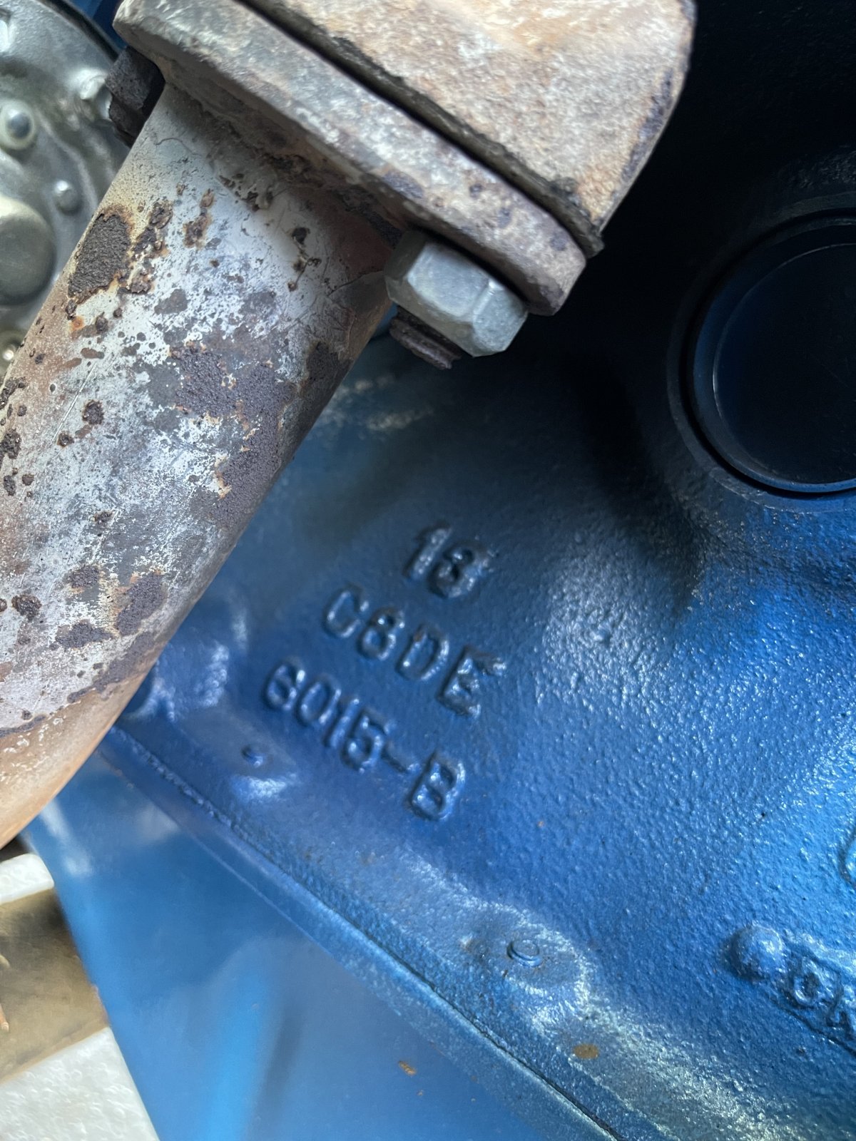

  3. gimpyshotrods
    Joined: May 20, 2009
    Posts: 24,551
    gimpyshotrods
    I added a picture to the previous post that shows where the pad is that should have the ID numbers on it, if it is OEM.

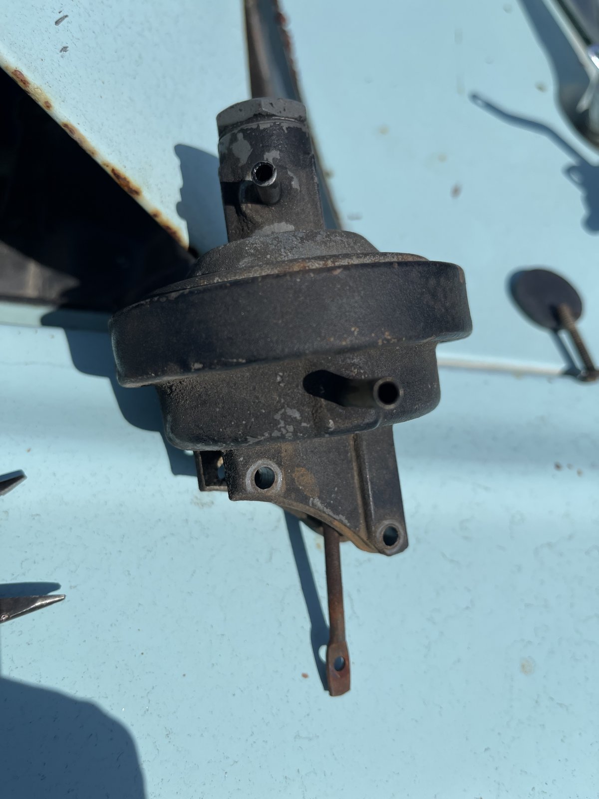

  11. blown240
    Joined: Aug 2, 2005
    Posts: 1,819
    blown240
    from So-cal
    Thanks for the replies! The carb was recently rebuilt, but ya, there is some leakage around teh throttle shaft.
    I have a question about the vacuum advance. Mine has 2 vacuum lines going to it, but when I look up a replacement they all only have 1. Is that normal? The motor is a 200Ci, if I remember correctly its a 70, but Im not sure what distributor I have...
  12. sidevalve8ba
    Joined: Jun 16, 2009
    Posts: 2,616
    sidevalve8ba
    Single lines are vacuum advance only. Two lines are vacuum advance AND vacuum retard, in other words it's usually some type of emission control device.

  29. blown240
    Joined: Aug 2, 2005
    Posts: 1,819
    blown240
    from So-cal
    Time for a little update.
    The engine number is C8DE - 68 Falcon/Maverick
    The intake manifold/head number is C9DE - 69 Falcon/Maverick
    The valve cover number is D1DE - 71 Falcon/Maverick
    Distributor is a D1DF - 71 Falcom Maverick
    While I had the vacuum advance out, I hooked a vac pump to it. The advance side held a strong vacuum, the retard side didnt hold a vacuum at all. So I put it back in with only the vacuum advance side hooked up. I was able to get car to idle nice and low, and I can push the choke in almost all the way without it dyeing. I havent had a chance to drive it yet to get it warm, but were making progress!
    Timing is at 12 degrees BTDC.

  30. gimpyshotrods
    Posts: 24,551
    gimpyshotrods
    That is a conventional distributor, however, it has a Pertronix module in it instead of points.
    There is no reason to replace this distributor. If the vacuum advance side works, run it.
    Just find the other end of where the retard hose was hooked up, and plug it.
