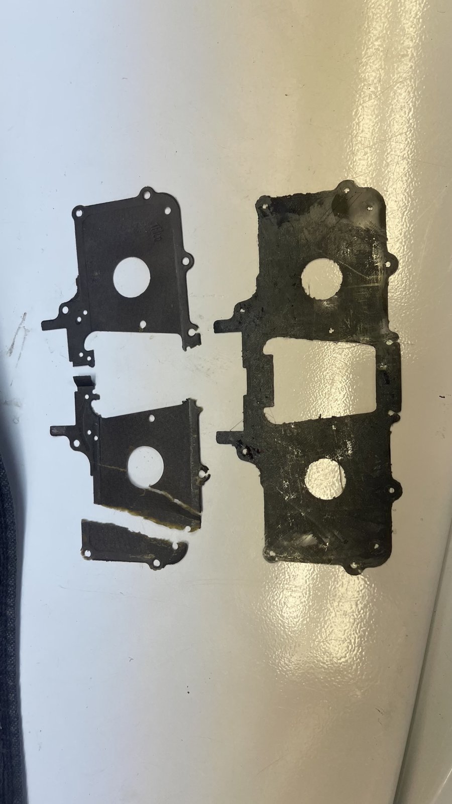

    We’re going to see if we can rebuild the stock wiper motor. The gasket was torn, so we scanned it and 3D printed another in urethane….

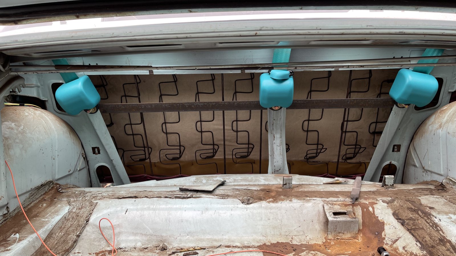

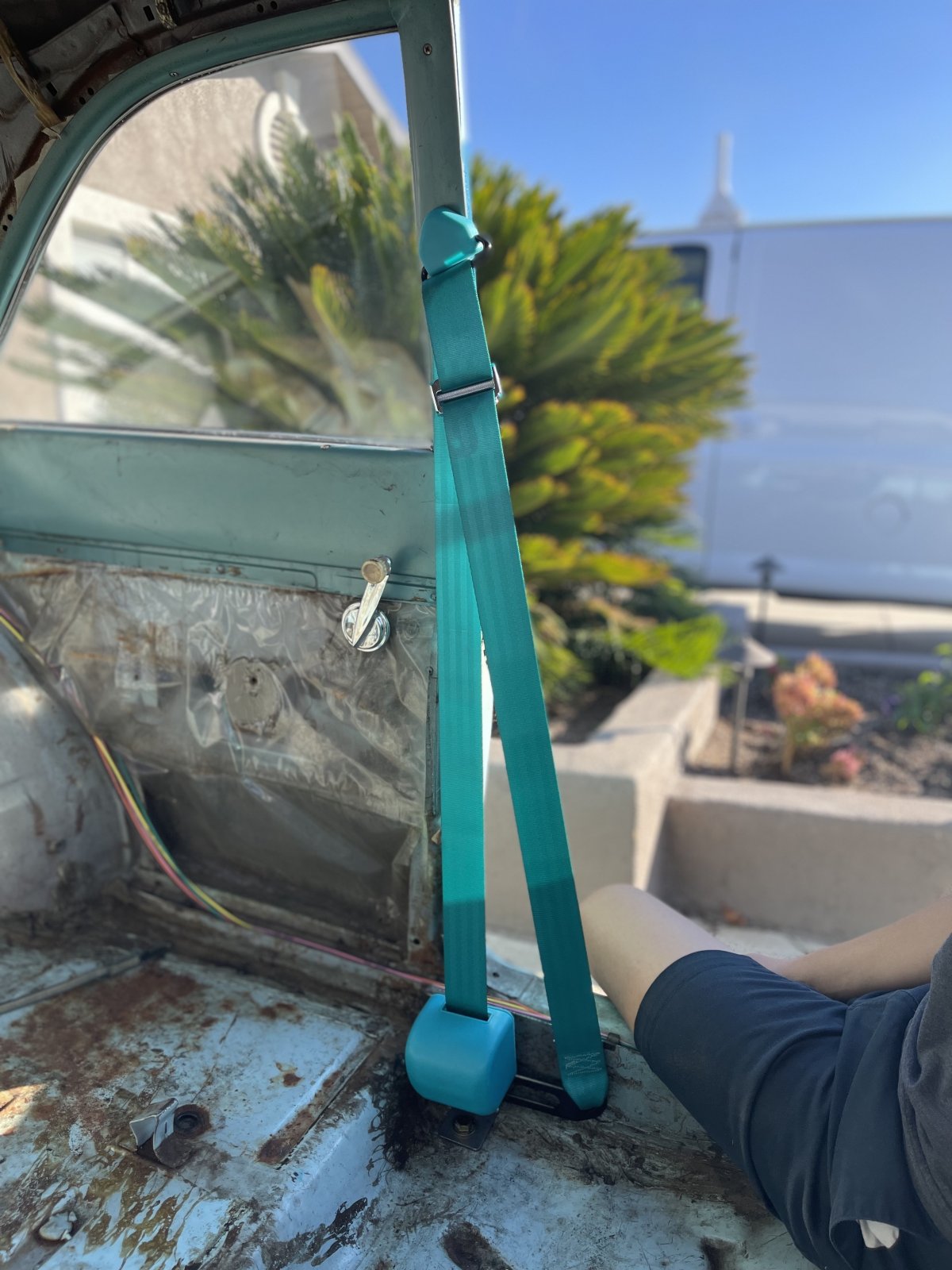

    Small update, we have been working on getting the rear seatbelts in. They are just about done, but we are going to make the package tray before final installation. We used heavy wall 1" angle iron to mount the retractors, and the belt guides.

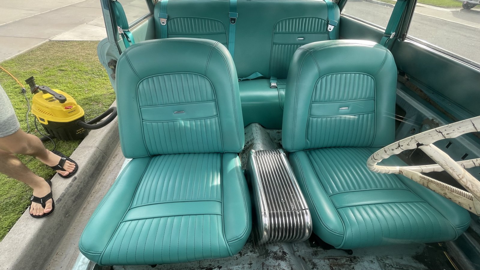

    We have the seats in now... Next is door panels...
