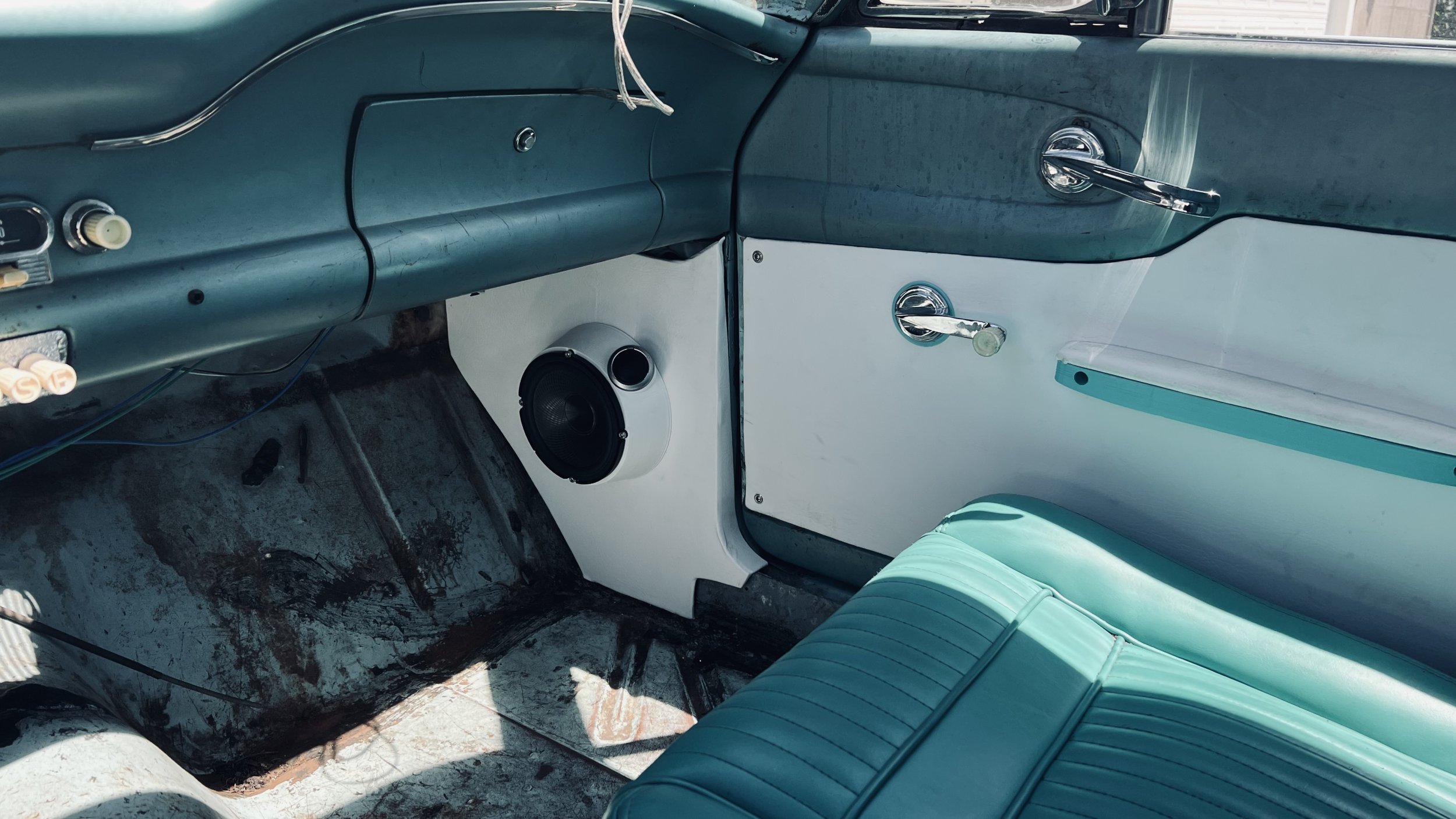

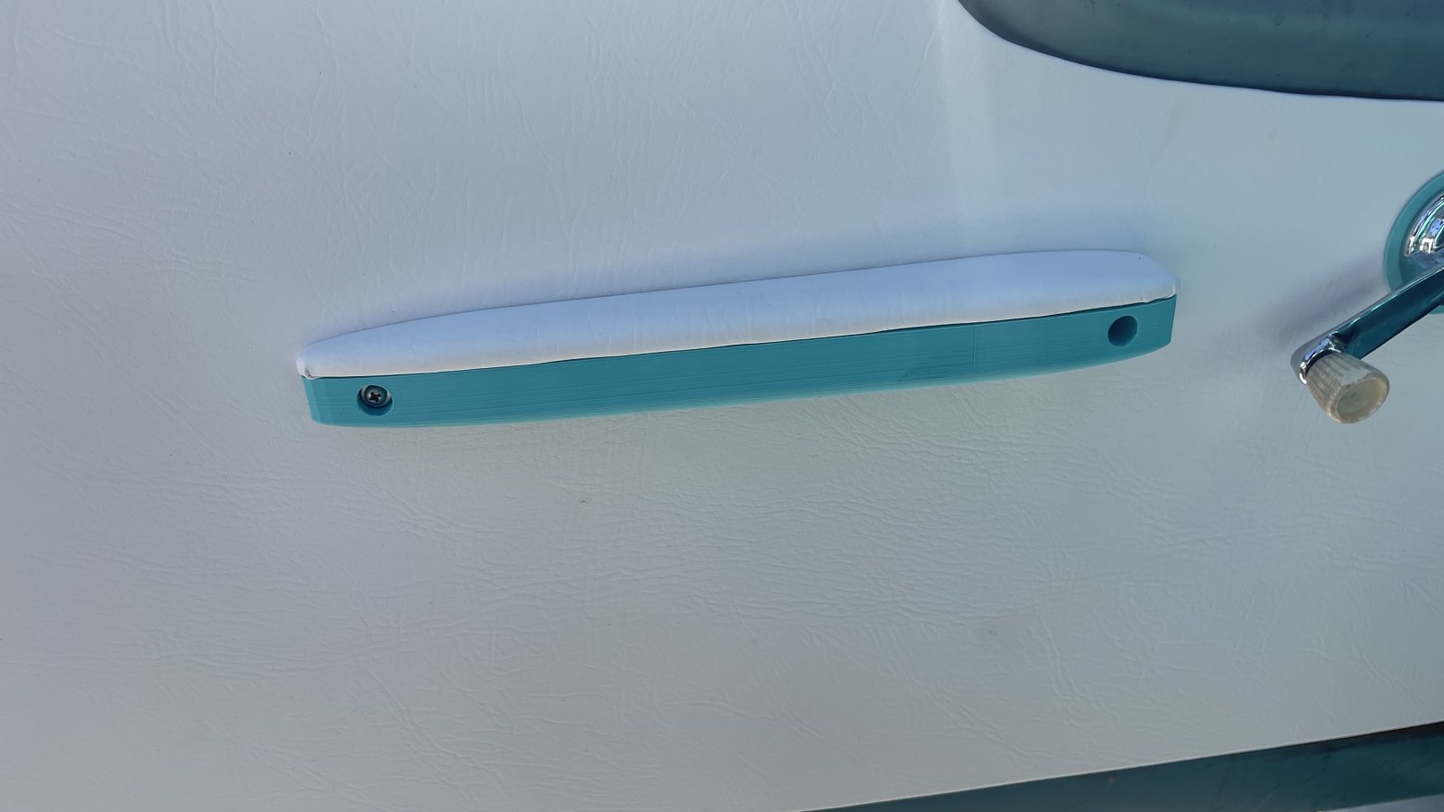

    I haven't updates this post in a long time. We have been driving and enjoying the Falcon. Today we finally had time to work on the door panels and rear side panels. I 3D printed an IMG_0752.jpeg IMG_0753.jpeg IMG_0754.jpeg IMG_0756.jpeg IMG_0759.jpeg IMG_0760.jpeg IMG_0761.jpeg IMG_0762.jpeg IMG_0763.jpeg IMG_0764.jpeg IMG_0765.jpeg inner door pull/armrest. I hope to get the p***enger one done this week...
