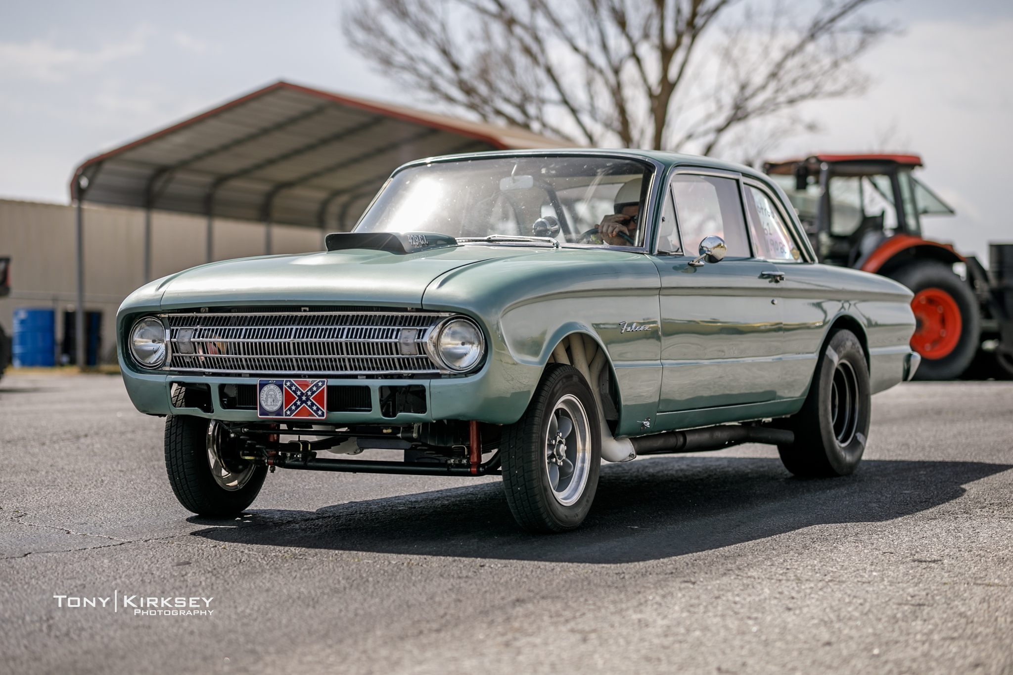

    Welp, I have about 200 street miles on it now. It's about time to take it down the quarter.
