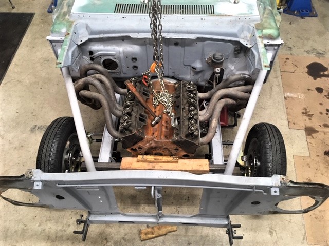

    I'm building a g***er type 61 Falcon. I've searched the web and this forum for fenderwell headers for a SBF 289. Haven't found a pair yet. I've tried 65-66 Mustang ch***is headers but they wont work. Cylinders 7-8 are very close to steering box. Anyone have some info on this swap?

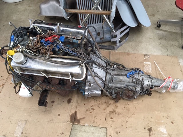

    I agree. I have a chevy SBC sitting in it now with Chevy II headers just to see if it works better. Still would have a problem with pan sump clearance. Might have to change it to front steer or get a front sump Chevy II pan. I have a 289/C4 setup. Wanted to be brand correct but, not sure what to do. LOL

    The 289 does look at home in there. :)

    That is a thought!. Going to pull the SBC today and put the SBF back in. I'll do some more checking.
