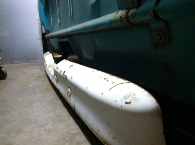

  2. JakeDW
    Joined: Sep 30, 2012
    Posts: 580
    JakeDW
    from Missouri
    I am glad she still had the rear bumper on.
    Jake

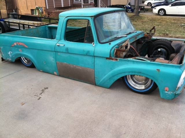

    from Missouri
    My buddy next door helped stick the front end back on so I could get a pic of the entire truck.I hate that I chipped the bondo off the door guess it was hit at one time and the repair is really bad just makes me want to get the door skin on faster i guess.
    Jake

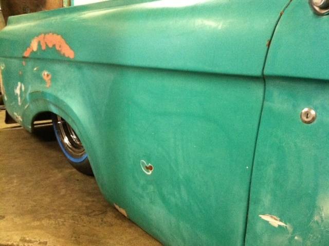

  5. JakeDW
    Posts: 580
    JakeDW
    from Missouri
    Need to take about 1/2 in out of the front cups to get it to lay all the way but its really close now.
    Jake

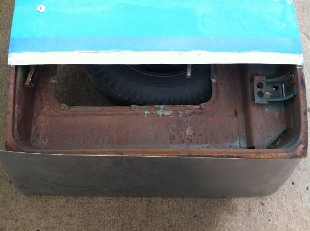

    from Missouri
    Cut out the back wheel well for clearance for the bags and bracket.

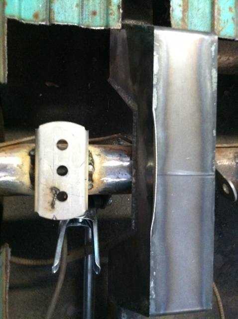

    from Missouri
    Bottom bracket wielded in place.
    Jake
  14. JakeDW
    Posts: 580
    JakeDW
    from Missouri
    I will go back and weld a gusset /plate down from the of the bracket to the top of the notch but I wanted to roll it out side this afternoon as its going to rain all day here tomorrow.

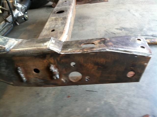

    from Missouri
    When I got the truck someone along its life had replaced the front cab mounts and just put them back where the cab had settled over the years so the front fenders has some gap at the bottoms with no way to adjust it out so I cut out a section of the front of the frame where the core support mounts to give me some adjustment room.

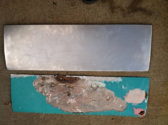

    from Missouri
    Put a 12 in door skin on the p***enger door.
    Jake
  23. JakeDW
    Posts: 580
    JakeDW
    from Missouri
    Cut old off.
    Jake
  24. JakeDW
    Posts: 580
    JakeDW
    from Missouri
    Fitted the new one up.
    Jake
  25. JakeDW
    Posts: 580
    JakeDW
    from Missouri
    Welded up.
    Jake

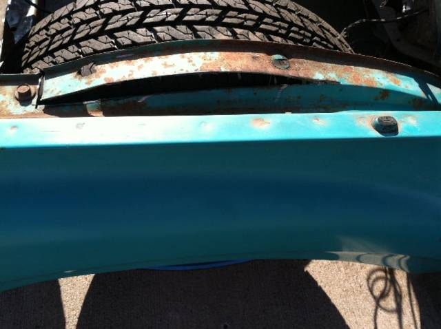

    from Missouri
    Had to cut rebend the top of the fender for the tires to clear I will weld it all back to have a stock appearance .
