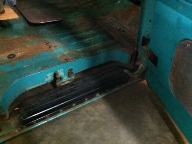

  1. JakeDW
    Joined: Sep 30, 2012
    Posts: 580
    JakeDW
    from Missouri
    Thank you

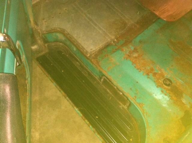

    This is the drivers side I did befor I started the build thread the plan was to make the cab floor solid on both sides befor I cut on the frame ect but I ended up getting the drivers side done and just the steps and front floor board so it was solid on the pasangers side need to finish it up now just hate rust repair lol.the pic ****s because its with my phone and its dark on that side of the truck so I used the flash.
    Jake

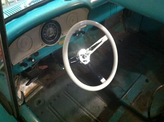

  3. JakeDW
    Posts: 580
    JakeDW
    from Missouri

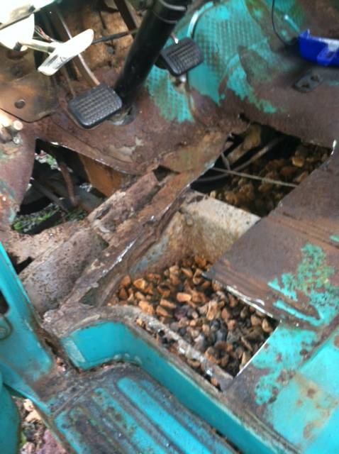

    A pic of the drivers side when I was trying to figuer out just how much I wanted to cut out.
    Jake

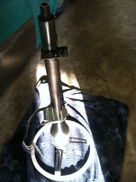

  4. JakeDW
    Posts: 580
    JakeDW
    from Missouri
    Originally I was gona put a ididit straight blinker only column in but found a great deal on a tilt ss flaming river so could not p***it up.Through it in to see what I was workin with.Column drop and floor mount on the way.
    Jake

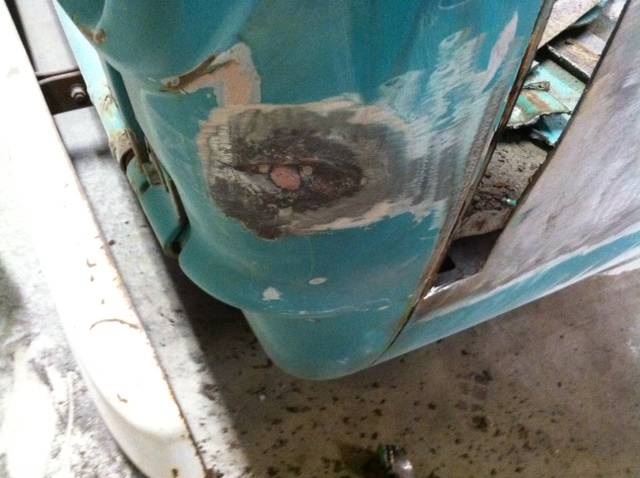

  7. JakeDW
    Posts: 580
    JakeDW
    from Missouri

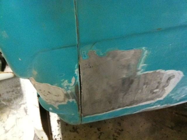

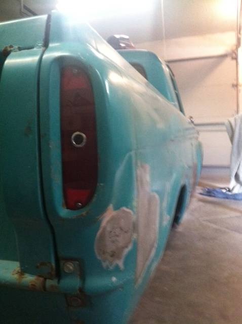

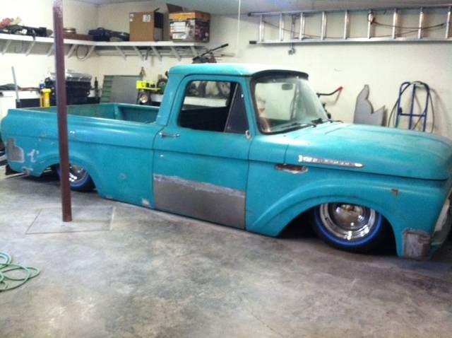

    Talked my self in to doing a bit of rust dent repair used 16 gauge on the bed as it looks like that is what they used from the factory 18 gauge is what I would use normaly.Still need to hammer dolly it out a bit to match the back section still need to grind down the front fender patch more and the door needs quite a bit of work still I HATE rust.

    Beat out patched and welded up ground down.

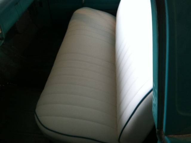

    Got my seat back from my great uncle Bob Sipes I asked for plain bright white with sea foam piping.

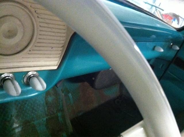

    Ordered up some steering parts and some Mooneyes dash knobs had to cut off the original push pull knobs with a cutoff wheel and drill out the moon knobs nothing is easy lol.

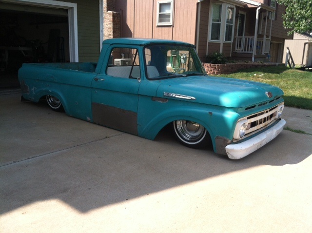

    Have not done much to the 61 but did roll it out for some sun yesterday.

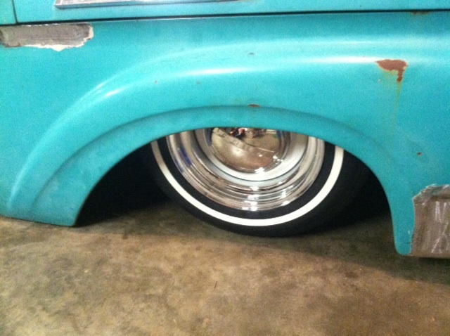

    Painted the center of my Vintiques Ford Oxford white they were raw and starting to get surface rust.and scrubbed the blue off the pinners.

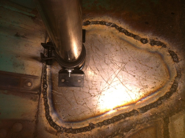

  30. JakeDW
    Posts: 580
    JakeDW
    from Missouri
    Got the steering / clutch hole welded up.And the steering shaft mocked up.
