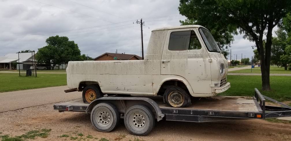

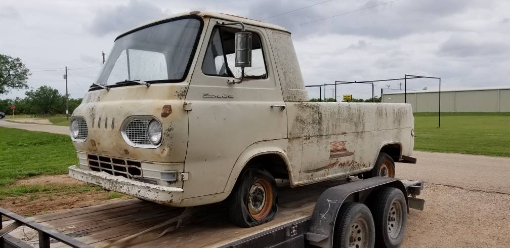

    So, I finally picked up this gem! This old econoline was left to me in my grandpa's will when I was 12 yrs old (34 now)...I then traded it to my uncle when I was 18 for a dirt track car. My uncle p***ed away about 1.5 yrs ago[emoji26] , and my aunt told me to come get the pickup. All these years I've been told it was a '66 and I was a bit bummed to find out it is a '61, but, it's still going to be an awesome project for my son and I!!! It has the little 144 in it, 90 horses of pure muscle[emoji13]. But, I may eventually do a swap for a 170, 200, or possibly even a 302 if I can muster up the courage to cut it a bit...just going to try to get it running as is for now though. Just gotta find a carburetor. 20190527_185412.jpeg 20190527_185428.jpeg 20190527_185444.jpeg 20190524_145708.jpeg

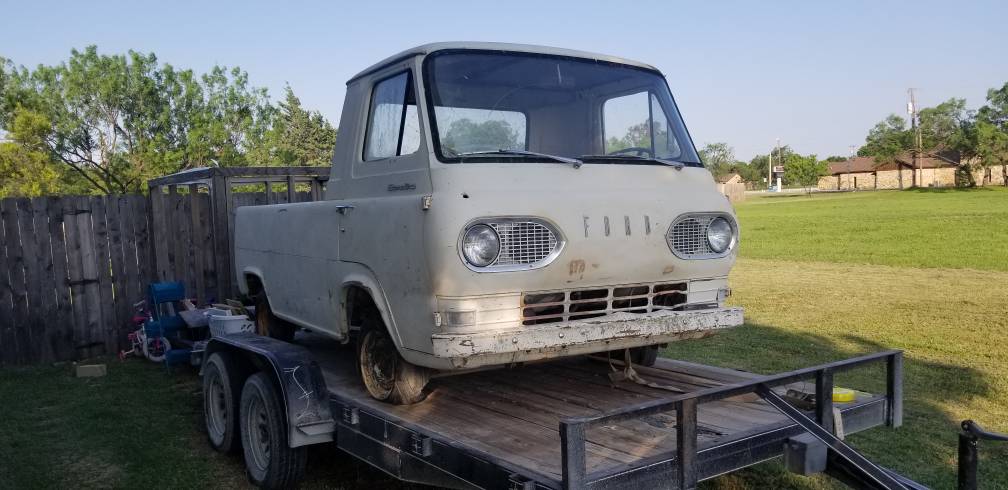

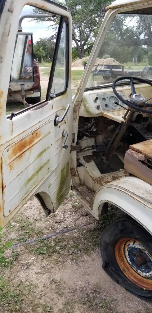

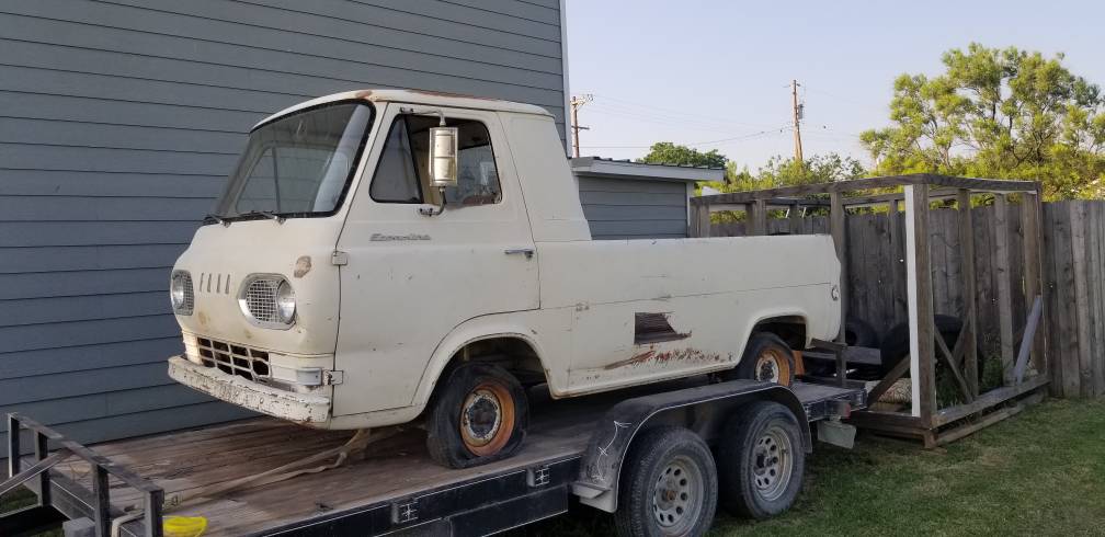

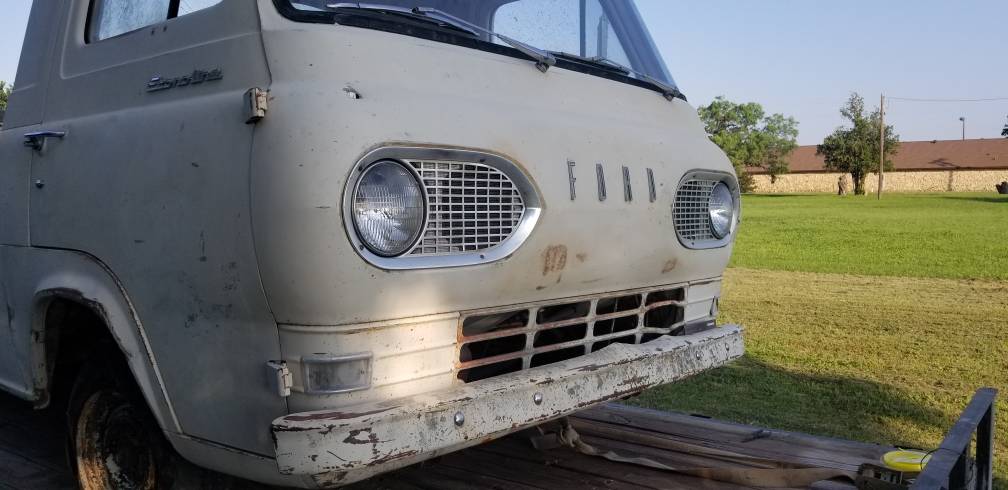

    These pics are before (and during) we sanded all the oxidation off of it today...first ones are after we cleaned it up. Had the boy helping me today!!! He is even more excited about this than I am! It's great to know that he has excitement about this with all the video games and everything else he's into these days. Really looking forward to the memories we will make with this project!!! 20190526_150510.jpeg 20190526_150447.jpeg 20190527_144034.jpeg
