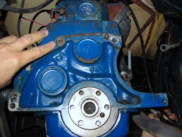

    Yes. It is a bolt-in*. On later year ones, you might need to fenagle a throttle linkage, but that's easy.
    *The 144 uses an 8-1/2" clutch. Later 200s use a 9" clutch. Mid-generation blocks have both bellhousing patterns.
    This is a dual-pattern block. Some of the holes are common with both patterns.
    The easiest way to determine clutch size is to look at how many bolts hold on the starter.
    If it is just two bolts, you have a 9" clutch. If there are three, you have an 8-1/2" clutch.
    A strange quirk of automotive convergence, a mildly modified 8-1/2 flywheel accepts a Mercedes 190E pressure plate. You just need to tap the untapped holes to 5/16"-24, and reduce the height of the step from 1" to 0.870", during the resurfacing process.
    If you pry the throw out bearing from the bearing carrier, you can put the 190E throw out bearing right on, too.
    That's the carrier, with the Mercedes self-aligning bearing on it. No modifications.
    You can buy a 190E clutch, from stock, to stage 5 carbon-Kevlar metallic. You just have to have a clutch shop put the correct hub in it.
    Everyone says that you cannot get a new 8-1/2" clutch, and that the re-manufactured ones are terrible. Here's your workaround.
    Incidentally, I have a BW T56 behind a 200. How's that? The native 190E clutch disc is the exact same spline as the T56! With an extended Ford to GM pilot bushing, and a MeLeod adapter, drilled for the 8-1/2 bell, it just bolts together!

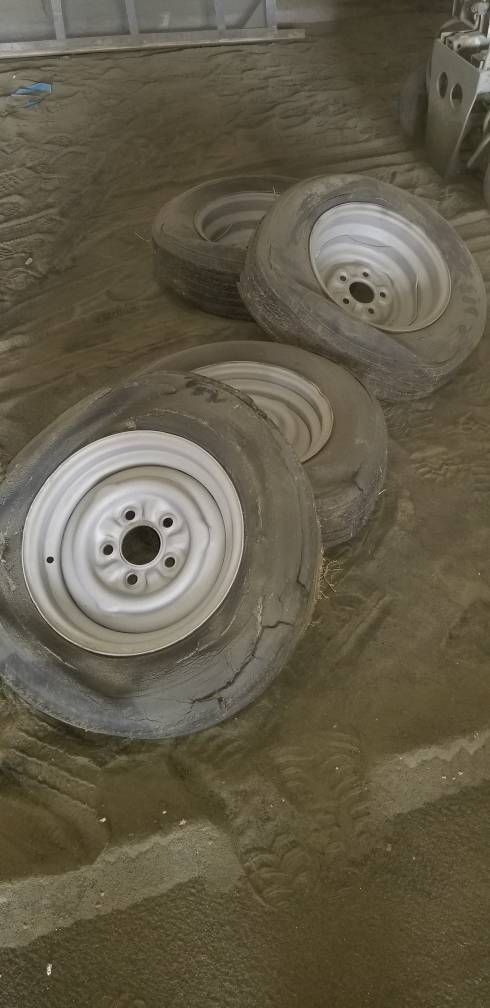

    Thank you so much for this reply! It's awesome to have this forum and great people that offer up this kind of help/time. Will be pulling the wheels off of it today to take them to work tomorrow for blasting (I'm a welding and coatings inspector/quality manager at a welding shop). The guy that has the motor also has a pile of wheels and other random parts I'm gonna dig through next time I'm there. Probably going to find some 14s instead of these 13s. Planning on flipping the front axle to the top of the leaf's. Looks like I may have to cut the bump stop mounts down a bit, which is doable.

    Not sure if 15s would work without some major modifications

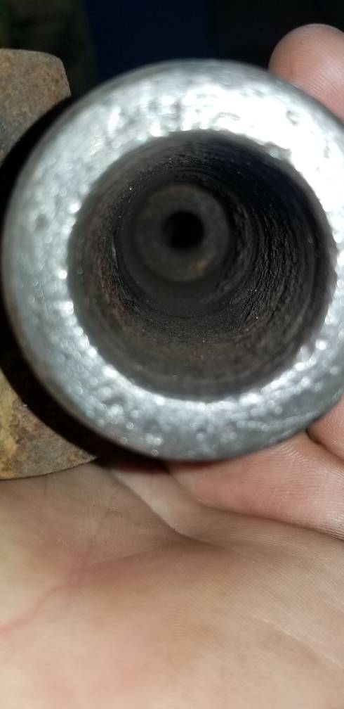

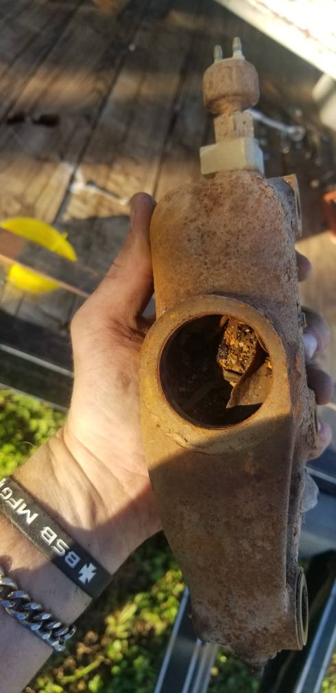

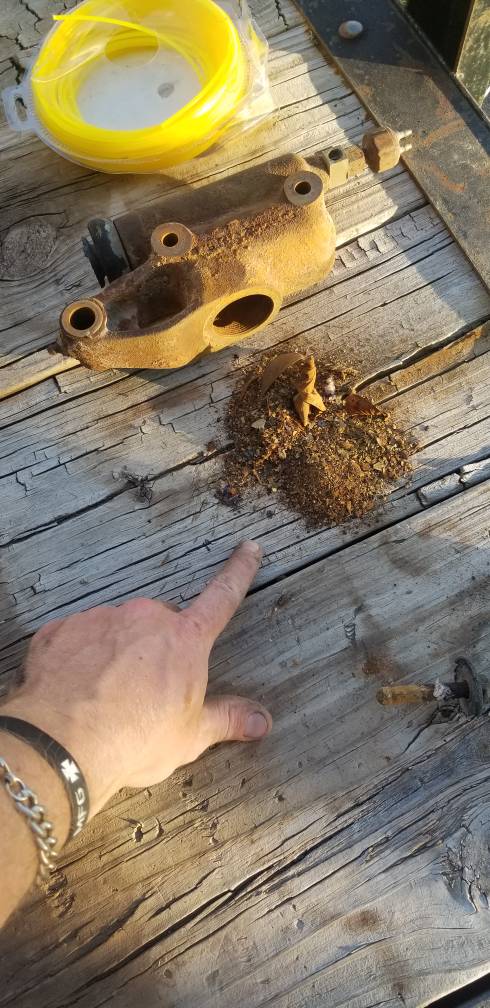

    Well...brake pedal has been locked up...so I pulled the brake lines to see if relieving pressure would help. Bone dry. I then pulled the cap off master cylinder to find this! Apparently the cap was left off for some time and it is pretty bad. Nonetheless, I'm going to attempt to rebuild it before I buy a new one. Mac's sells a kit. Having a hard time getting the old piston out though! 20190603_193919.jpeg 20190603_194142.jpeg 20190603_193923.jpeg

    Let that bad boy soak in white vinegar for a couple days and see who's boss!
  20. Old-Soul
    Joined: Jun 16, 2007
    Posts: 3,795
    Old-Soul
    That looks near identical to the master in a '49 Ford sedan. A real pain in the *** to replace lying on your back in the garage with the car on stands.
    Having grown up on a farm and having worked in parts (auto and HD) for a decade I've done more than my fare share of engineer cursing in my time but I don't think I have ever damned an engineer as much as I did replacing the cylinder on my '49.
    Short story long, for a cylinder that crusty I'd say take the easy way out and replace it with a reman unit from your local jobber or even Rock.
    Terrible80 and loudbang like this.

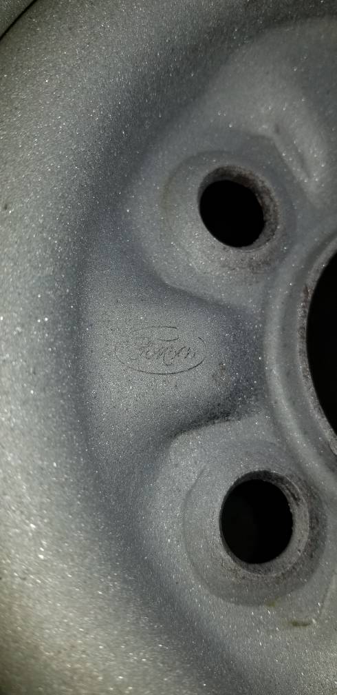

    Wheels blasted. Will shoot primer tonight. Even kept the "Fomoco" stamp on there![emoji12] Oh and also...I scored a running 200 motor for $50!!!! (From a friend) I just gotta go pull it! Master cylinder has some pitting in the cylinder...so I'll just be buying one... 20190604_113247.jpeg 20190604_113427.jpeg 20190604_125549.jpeg

    I'd get another MC, the inside bore has to be perfect, if its pitted you won't make pressure. I believe when they make then they force a ball bearing thru there to create that perfect bore. Be the time to upgrade to a dual MC and split the circuits.
