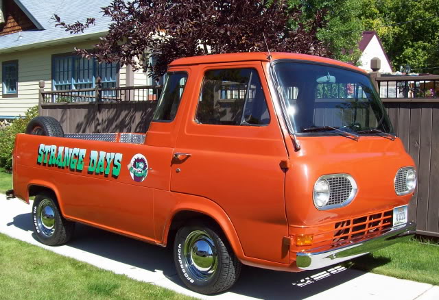

    Slower than the smell leaving cat ****, and you'll be the first one on the scene of an accident.... Nonetheless an easy vehicle to love. I've owned 4 econolines. 62 Econoline.jpg

    This sure is an awesome ride...are those the 13" wheels?

  14. Chaz
    Joined: Feb 24, 2004
    Posts: 5,015
    Chaz
    They're 14's With BF Goodrich TA radials.

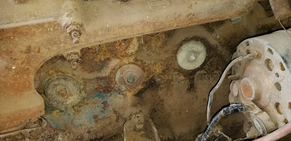

    I did get the motor. Sorry for the late response...plan to get back at it on Monday! Busy week this week... 20190609_174248.jpeg

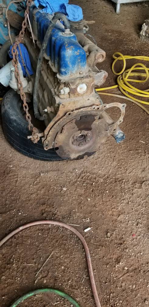

    Plan is to attempt to use the carb and distributor to get the 144 going first...then I can make sure the 200 is in proper shape...note the freeze plug replacements...[emoji12] 20190609_174307.jpeg

  25. gimpyshotrods
    Joined: May 20, 2009
    Posts: 24,580
    gimpyshotrods
    Dual pattern block, automatic flexplate. Originally equipped with an 8-1/2" bellhousing.
    It's a bolt in.
  26. gimpyshotrods
    Posts: 24,580
    gimpyshotrods
    The carburetor and distributor from the 200 will not fit the 144!
