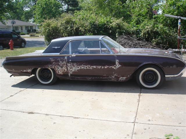

    Finally found a window of opportunity to post some progress pics of my Tbird. It was pulled out of field after sitting for 25 years. I updated the m/c to a dual one, new wheel cyl, drill honed the block and put in new rings, new carb, then some tread and bombed it like that for a 1/2 summer.

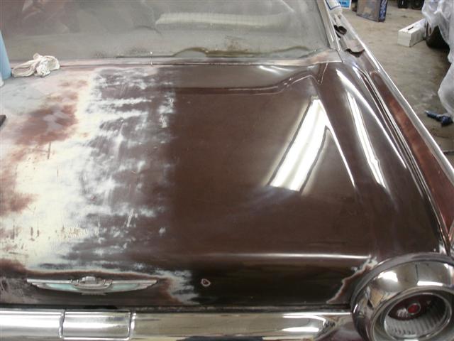

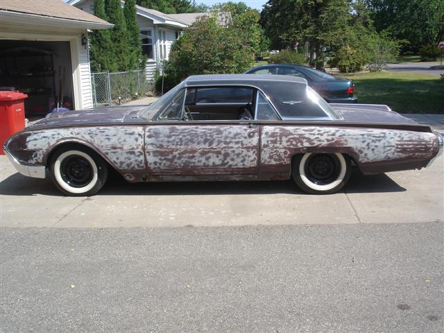

    The car had been repainted once but was heavily faded. I started to sand/polish it and noticed the original paint was still decent underneath. The car is pretty straight save for some weak 1/4's, so I figured I should keep sanding and see what I get. There had been some door ding repair when it was repainted and that's where the primer spots are. I didn't like how it looked so I bought some spray bomb of a like color and sprayed it over the primer spots. Hit the car with some 1000 grit followed by some 1500 and buffed it out. It was crazy how much that old lacquer popped!

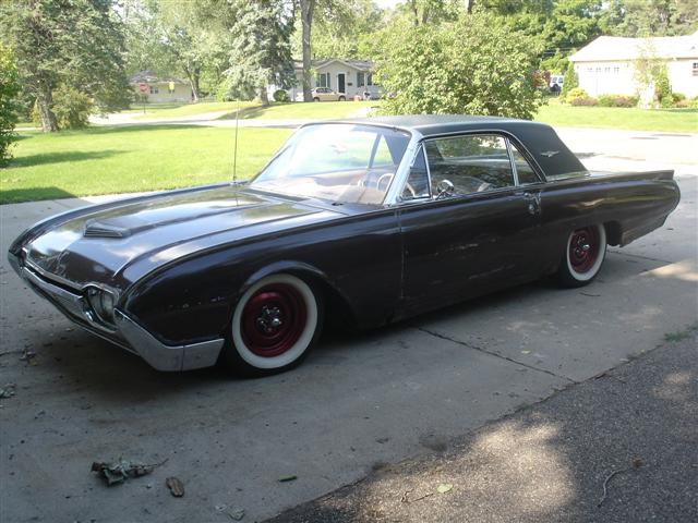

    I picked up some spider caps and just couldn't put them on black steelies so I shot a lil lacquer candy red over some silver to clean them up. Took a coil and a half out of the front springs to get the vertically challenged stance handled. I need to pick up some blocks in the rear to level out still. Hopefully this winter I can get the body repaired and put something that resembles an interior in the car this winter....we'll see.

    You will have to make your own lowering blocks for the rear. The centering pin is 1 inch. I made mine out of 2 1/2 sqaure tubing.

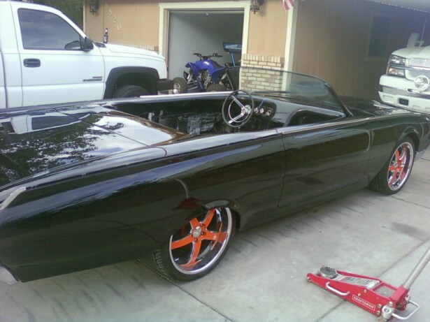

    I took the wheel wells from from a pair of front fender to use on the rear Gives it a kool flow. Excuse the non HAMB friendly wheel package. The car was finished off by a fellow in Vegas names Jay Hawkins. His paint skills are top notch!
