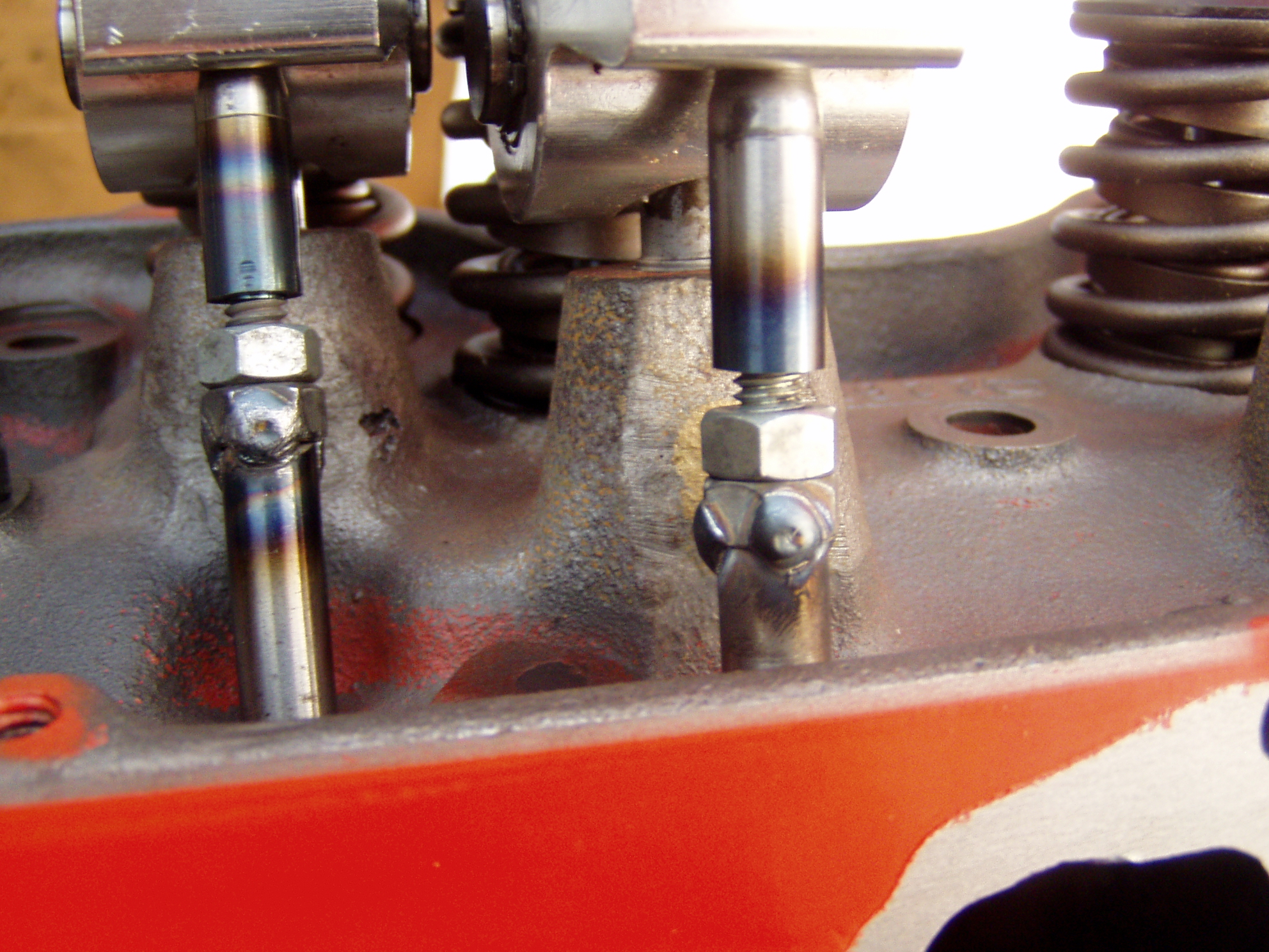

    Latest update. I have the pistons at the machinist to be fly cut for exhaust valve clearance.
    So I was checking push rod length and of course they are too short.
    So I whipped up some adjustable push rods so that I can get a measurement to get some new hot not old and busted ones ordered here's some pictures of the process. Well some of the pictures were to large to load but I think you will get the idea.

  10. Isky has some .096 wall sportsman pushrods, that aren't much more than $100 set.
