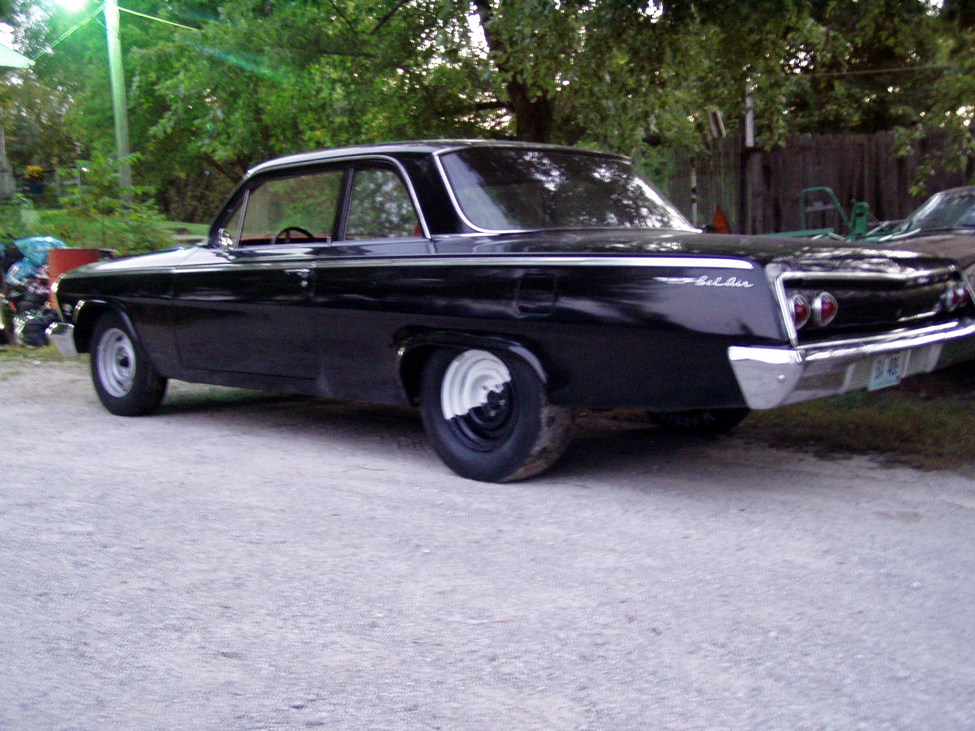

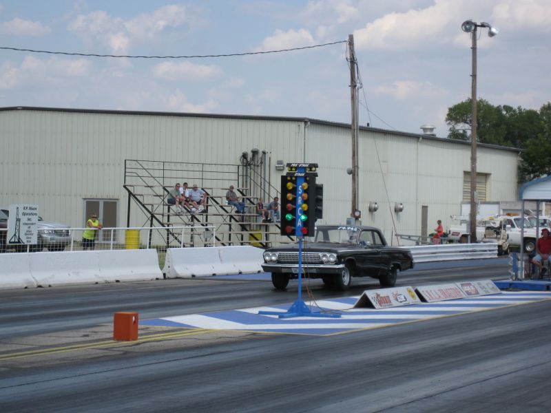

    Here are a few pics of James on the "maiden voyage" last night around 9:ish PM.
    We used my 1962 SS car to ferry our bodies back and forth from the track to the Comfort Inn:
    Enjoy!

    A few self serving photos:
    James at launch:
    Me hanging out with my good buddy Hayden:
    Cheers!
    Tom

    Just found my build on the Bel Air thought I would tell its latest for anyone that may of had some interest
    Ran the car at the Meltdown Drags last weekend witch is the first time out since last September got a best of a 14.76
    Still trying to get a good tune. Guess this could take me some time.
