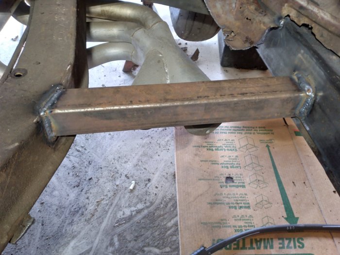

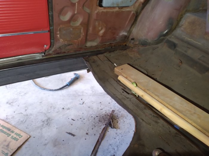

    I did take some time to take another swing at the car today. Working on getting the drivers side as far as the passenger side. The weather forecast is looking good for some good progress.
    20240807_142301.jpg 20240807_142316.jpg 20240807_155746.jpg 20240807_163423.jpg 20240807_163427.jpg

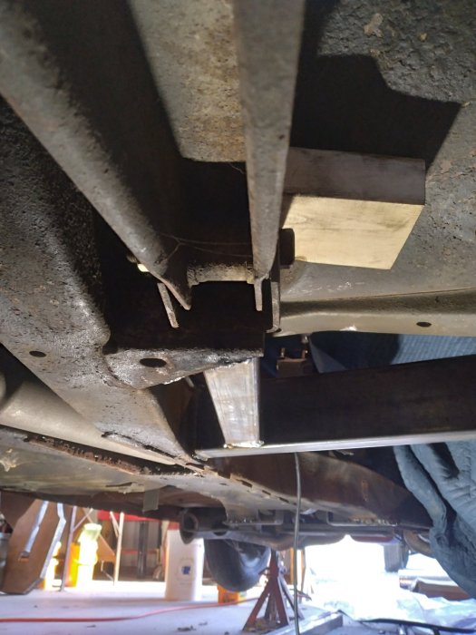

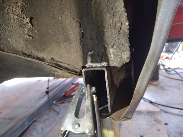

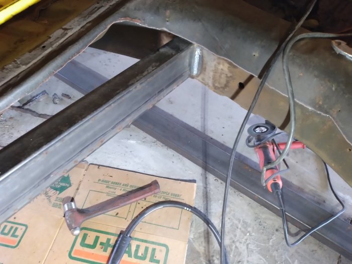

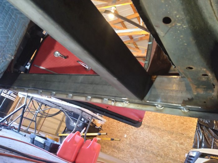

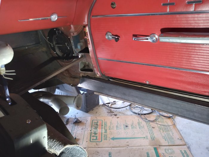

    Looking back through this thread and see I have left out some of the work I have done. Being I'm going to install a roll bar I wanted something substantial to land the roll bar on so for the inner rockers I am using a piece of 2x4 rectangle tubing. I then fitted some outriggers from the frame to the inner rocker. This should give some good support for the roll bar and some side impact protection heave forbid.

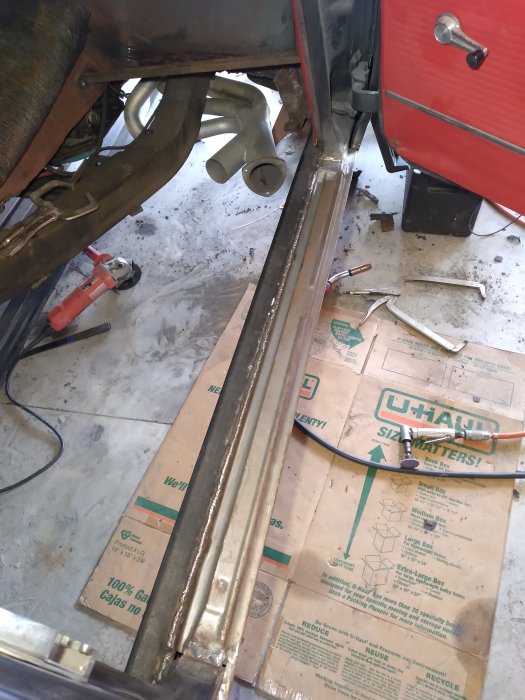

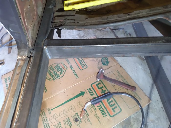

    Hope to have the quarter fitted tomorrow, just keep swinging the axe.
