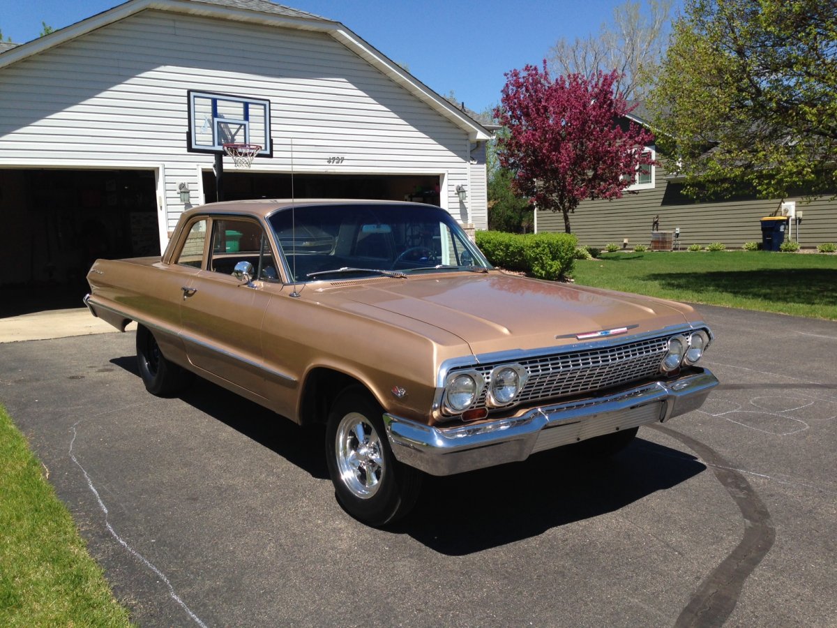

    Hey Guys,
    I'm getting ready to start ***embly on a big block Chevy to replace the small block currently in my 62 Biscayne (she's heavy and needs more oomph!)
    I know I need to replace the front coil springs for the BBC. Right now I have some global west small block springs in there, which lower the front end another inch or so from stock. My goal is to end up with a super stock tribute/look, so I want to go higher, not lower. Stock suspension height or even maybe a little nose high. Looking at all the aftermarket options, I'm finding places like show-cars.com (who cater specifically to the 61-64 full size chevrolets) offer a "heavy duty" spring for the 348/409 cars, and also a "super heavy duty" that lists applications for a 348/409 or 9 p***enger wagon.
    Anyone have past experience with using super heavy duty springs? Is it overkill? Any other insights I should consider?
    I do already have 409 springs in the rear. I lay up those to the super heavy duty wagon ones too. IMG_1494631342.804619.jpg
    Thanks,
    Mark

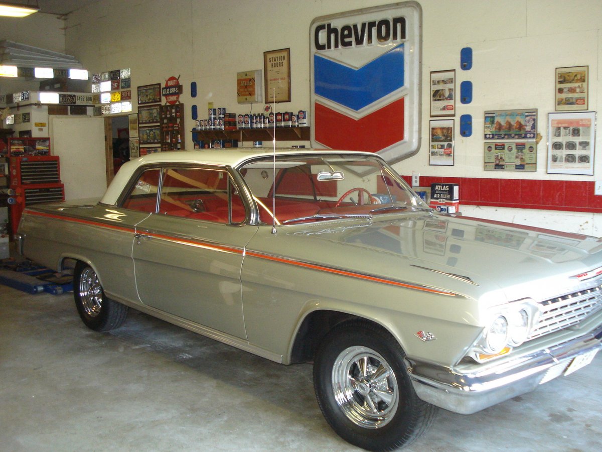

    Here is a pic of my 61. I bought the heavy duty wagon springs and replaced the springs that were in it hoping to get it a little higher in the front. After letting the car down I was surprised to find it sat exactly the way it did before. Seems like the previous owner had already swapped to the heavier springs...
    My brother is running a 454 in a 62 Biscayne with the wagon springs in the front and his car sits just like mine. We have talked about putting coil spring spacers under the springs to get a little more height in the front.
