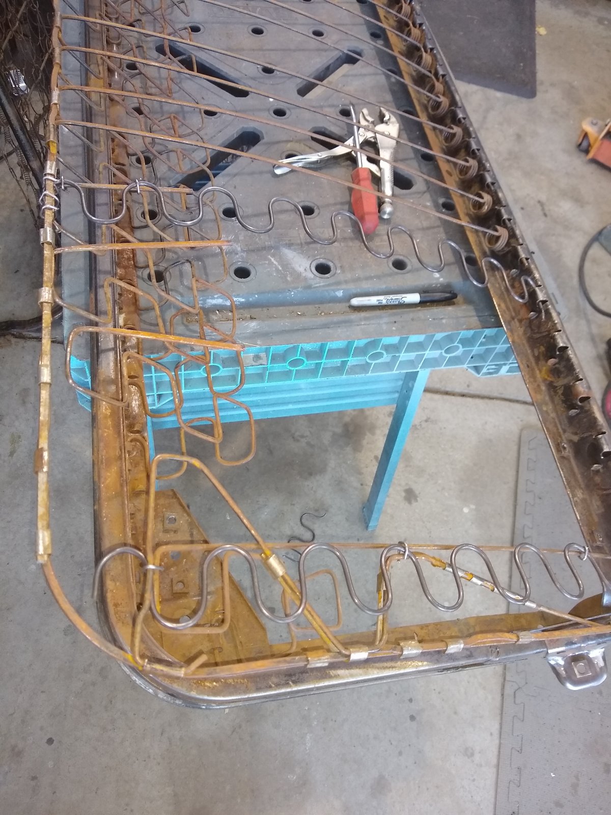

  21. I would beef up the very edge if the seat on the drivers side as they tend to break there and you'll be sitting at a slight angle towards the door.

    I'm just doing a mockup here, I haven't wrapped them yet
    Look about right?
    Squablow likes this.
  23. stanlow69
    Joined: Feb 21, 2010
    Posts: 7,346
    stanlow69
    Yes, on the front repair. I`m not sure the zig zag springs will work. They will curve downward when sitting in the seat.

    Gotcha,
    The zigzags do move more than the stock straight bars.
    I'll try moving the good stock ones to the side, then zig zags in the middle
    stanlow69 likes this.

    Looks good! Had to do similar seat frame repairs for my dad's 65 GMC this summer. I pieced together several broken ones, swapped some from the center of the seat to the driver's side, and added some reinforcement springs to give the driver's side more support. Didn't look the prettiest when I had it all together but felt great when done.
    It seems like tying the long springs together helps spread the load out, I clamped a couple of generic zig zag springs to the long skinny stock springs horizontally, so if one is getting pushed down, they all are. That really helped take the sag out. Might be useful if someone in the future sees this thread, I should have taken pictures.
