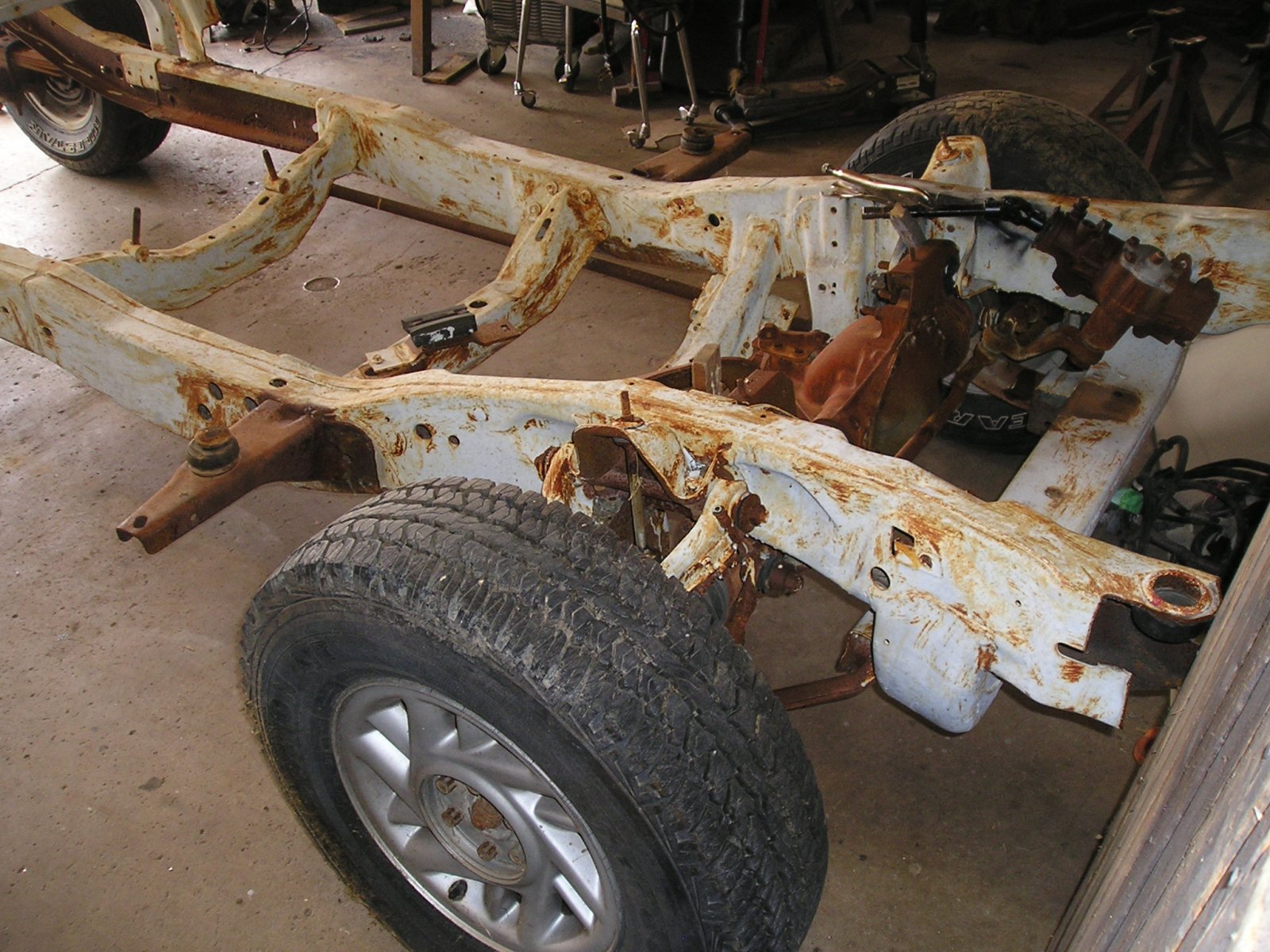

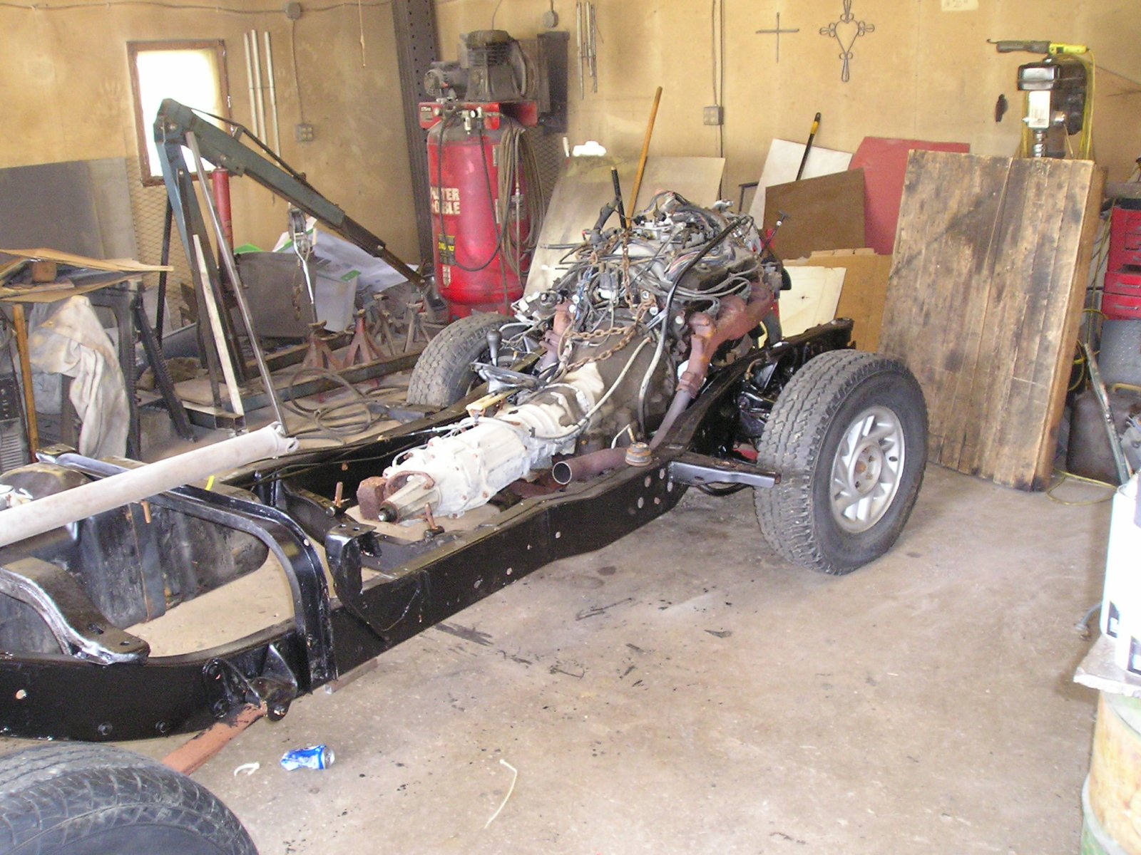

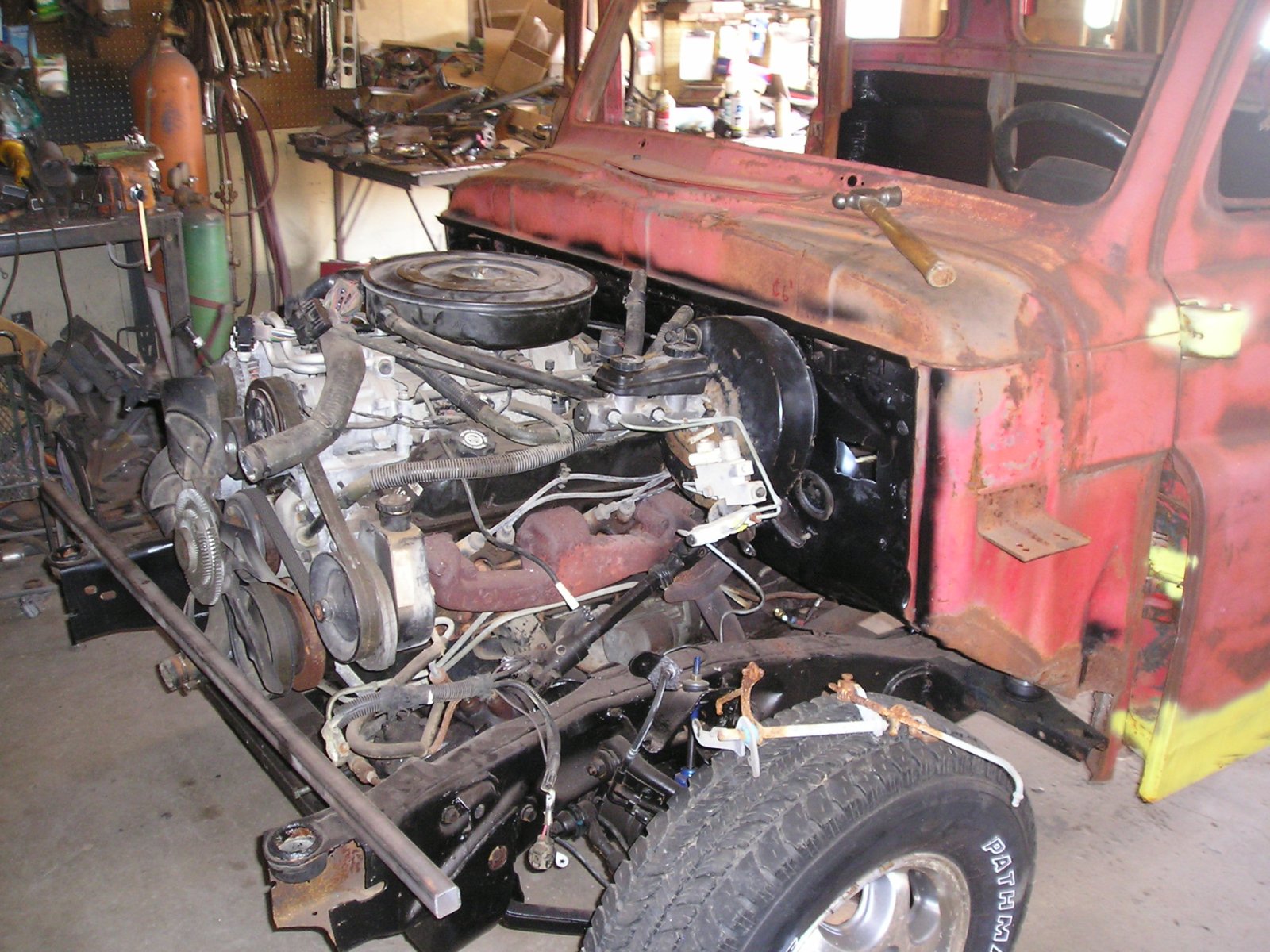

    This pic shows an original 49 Dodge front cab mount bracket that was cut off the 49 frame and welded to a 1993 Dodge Dakota 4x4 frame (the rusty looking piece behind the front wheel protruding outward from the white Dakota frame, just behind the front wheel). The frame was cleaned up and painted afterwards. P1010253.JPG P1010258.JPG Here is a picture of the painted frame. P1010305.JPG Here is a pic of the driver side frame bracket supporting the cab.
    Both rear cab mounts were installed after the frame was painted because there was extensive rear floor work that had to be done on the cab. Those were fabricated because of the differences between the two frames I was working with. I don't have any pictures of those.
