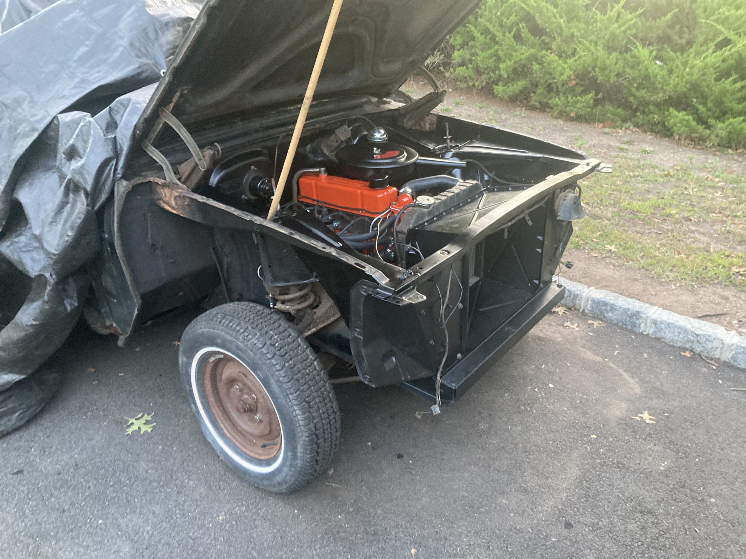

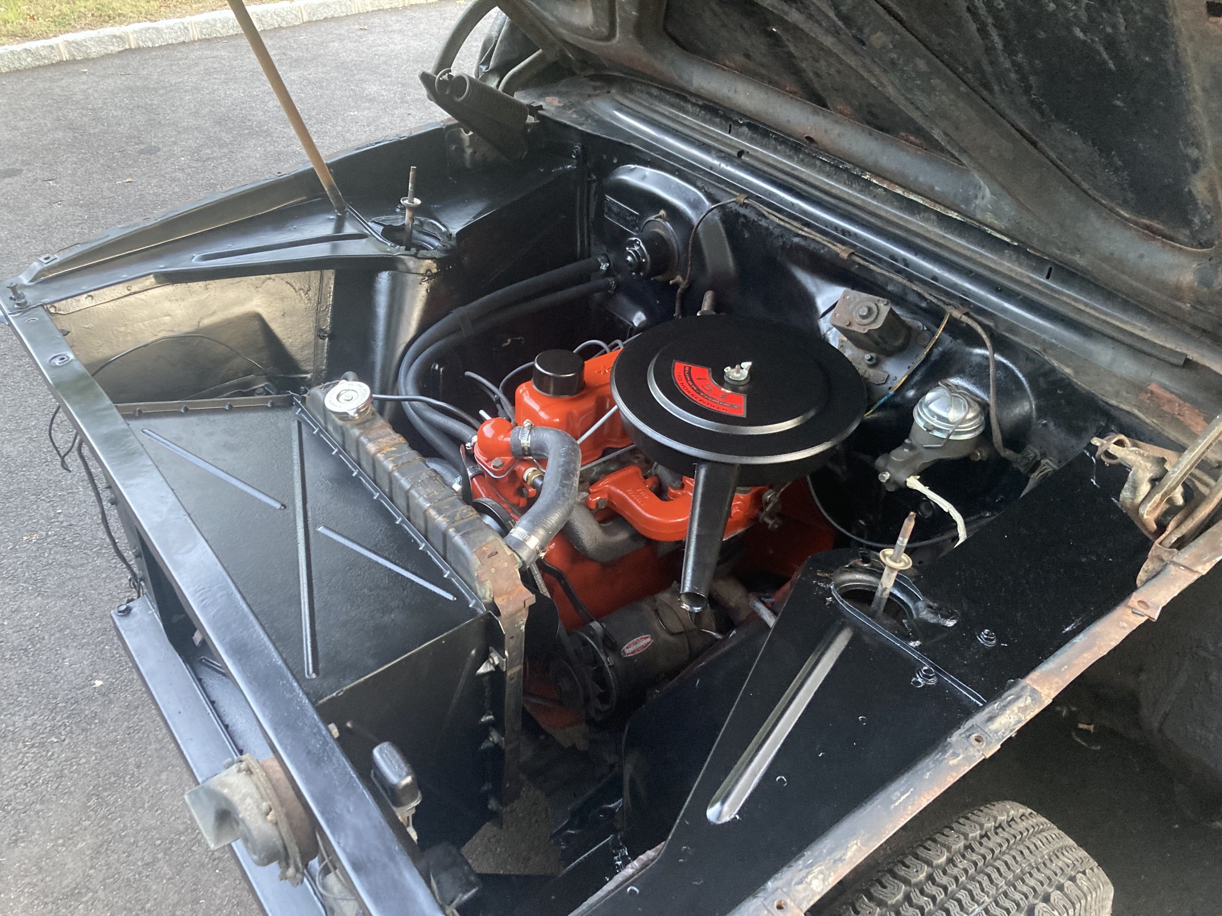

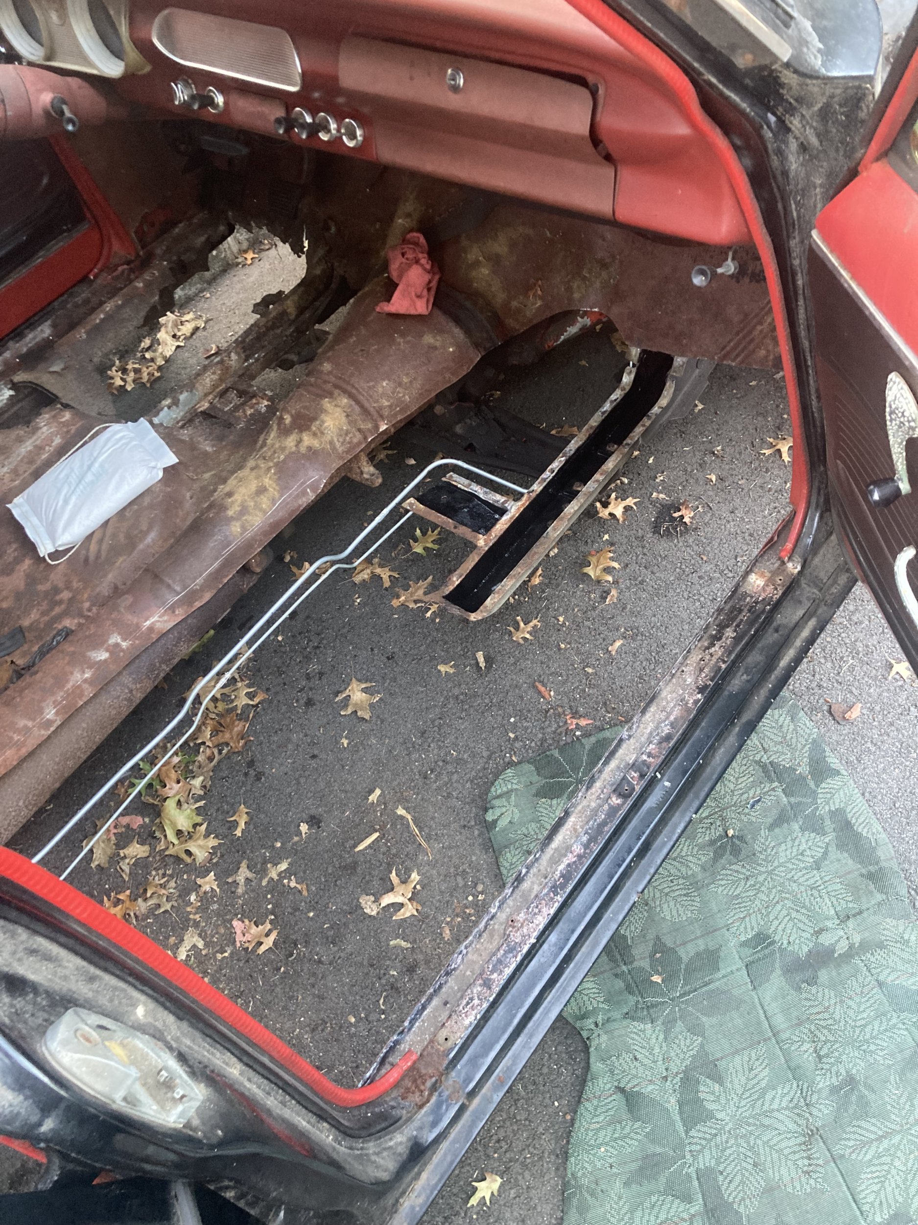

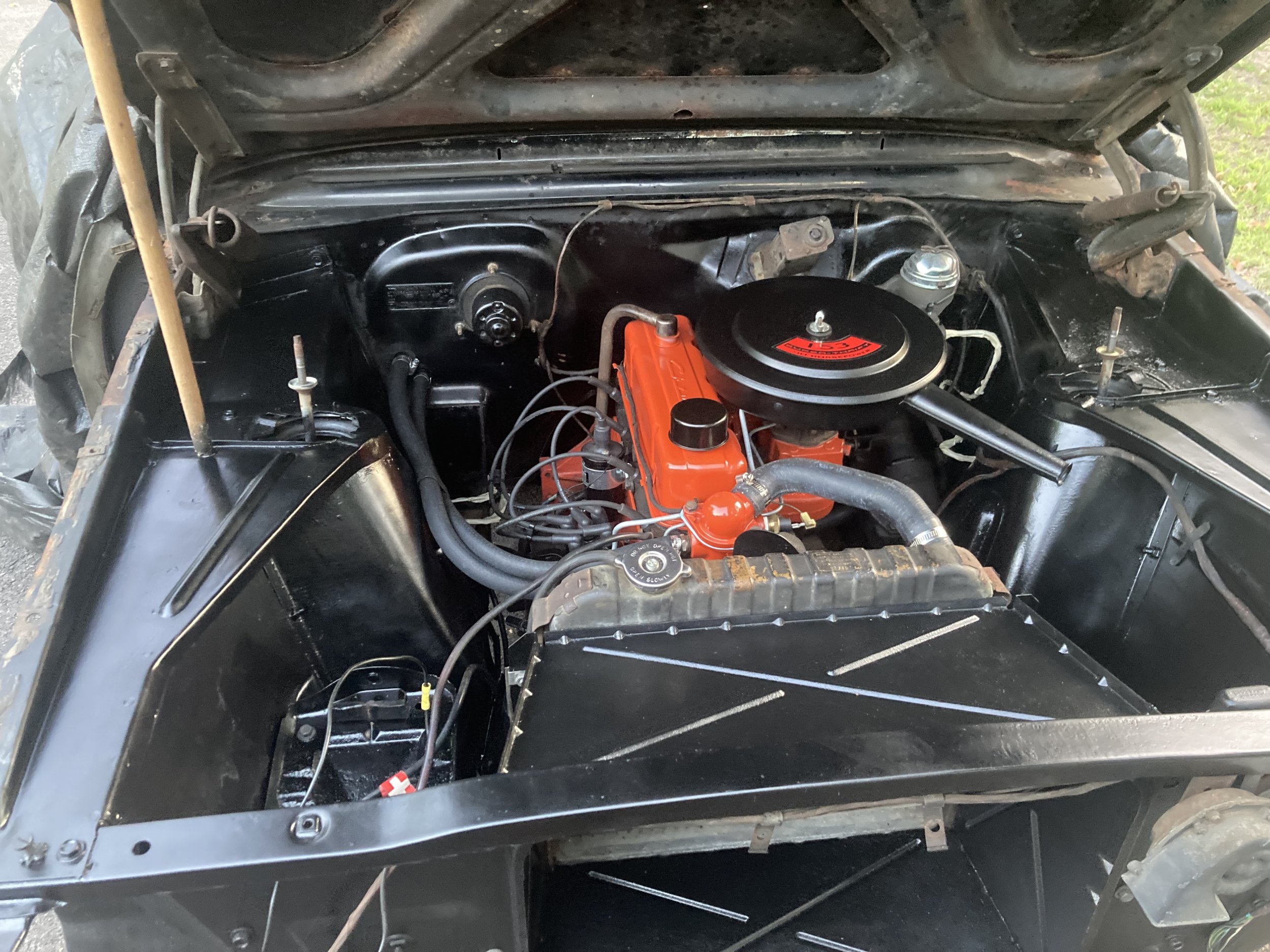

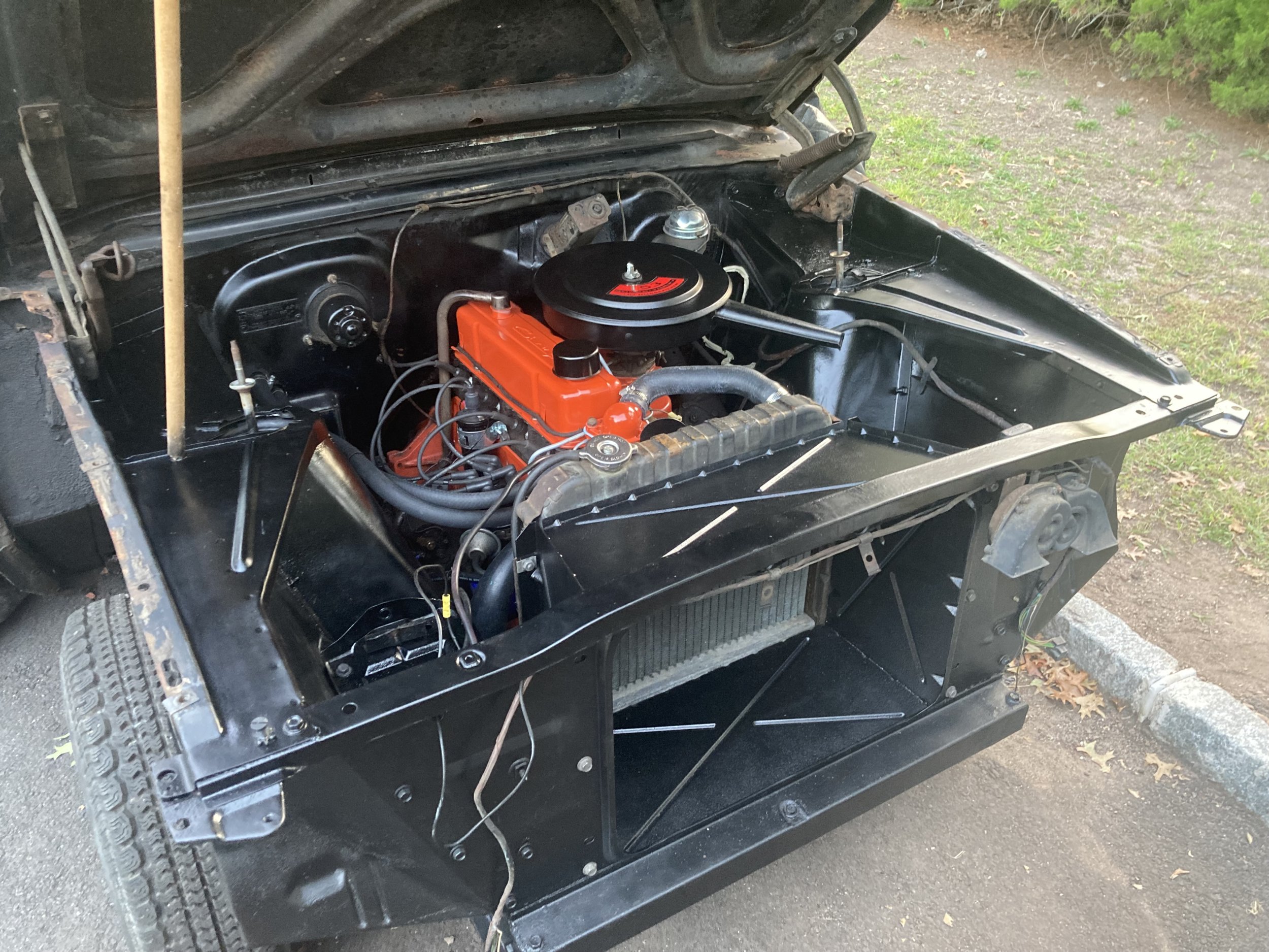

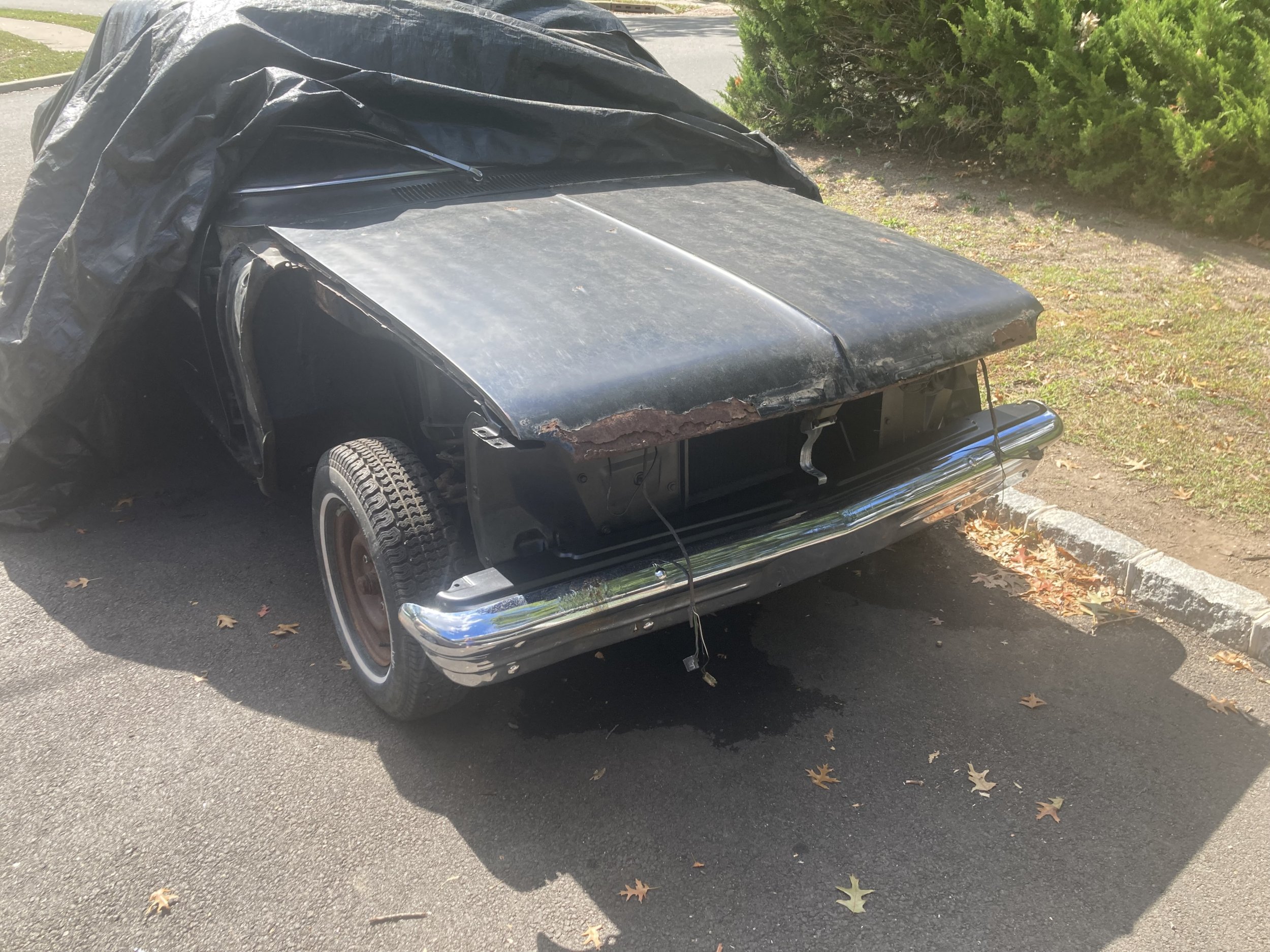

    IMG_7267.jpeg IMG_7269.jpeg IMG_7268.jpeg 1A32D178-4645-477D-A002-957769063DD1.jpeg IMG_7326.jpeg IMG_7325.jpeg IMG_7315.jpeg What ended up being a parts car to fix another car that was recently involved in a car accident might become a new driver project. 1962 4dr with a 4cy 153cu.in 3spd on the column and it runs. All the interior is there needs to be reupholstered, Needs floors and center trunk pan; brakes and fuel need to be gone through. Interior needs some cleaning up but its a possible running driver to enjoy. Neat little car!

    Won't be a powerhouse with the 4 cyl, but beats driving some newer 4 door shitbox. The question becomes how much work do you want to put into it, and what final result?

    any engine foto s . . . ?
    Tow Truck Tom likes this.

    I like the full-service floorpan. It would need a lot of welding, but if you're up for the task, why not?

    I will get some shots this weekend. I do have a video of it running. I will see if I can find it. Shifter rod is botched at the column and seems sloppy. I have to address that. It definitely can be a driver.

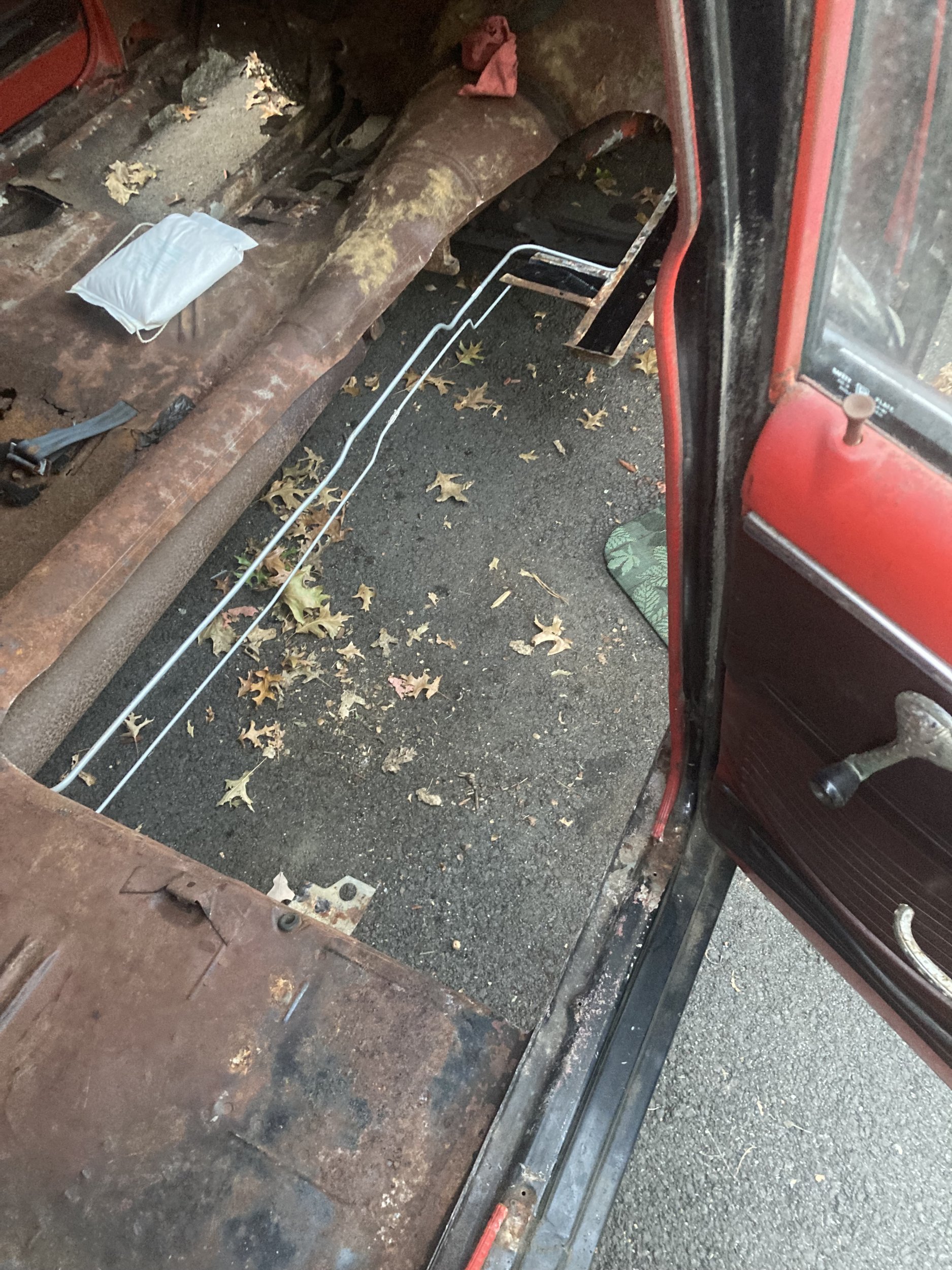

    The floor pans for the 4 door and the 2 door are the same. I just bought pans halfs. no reason to do the full floor. The floors are really not that bad as it looks.

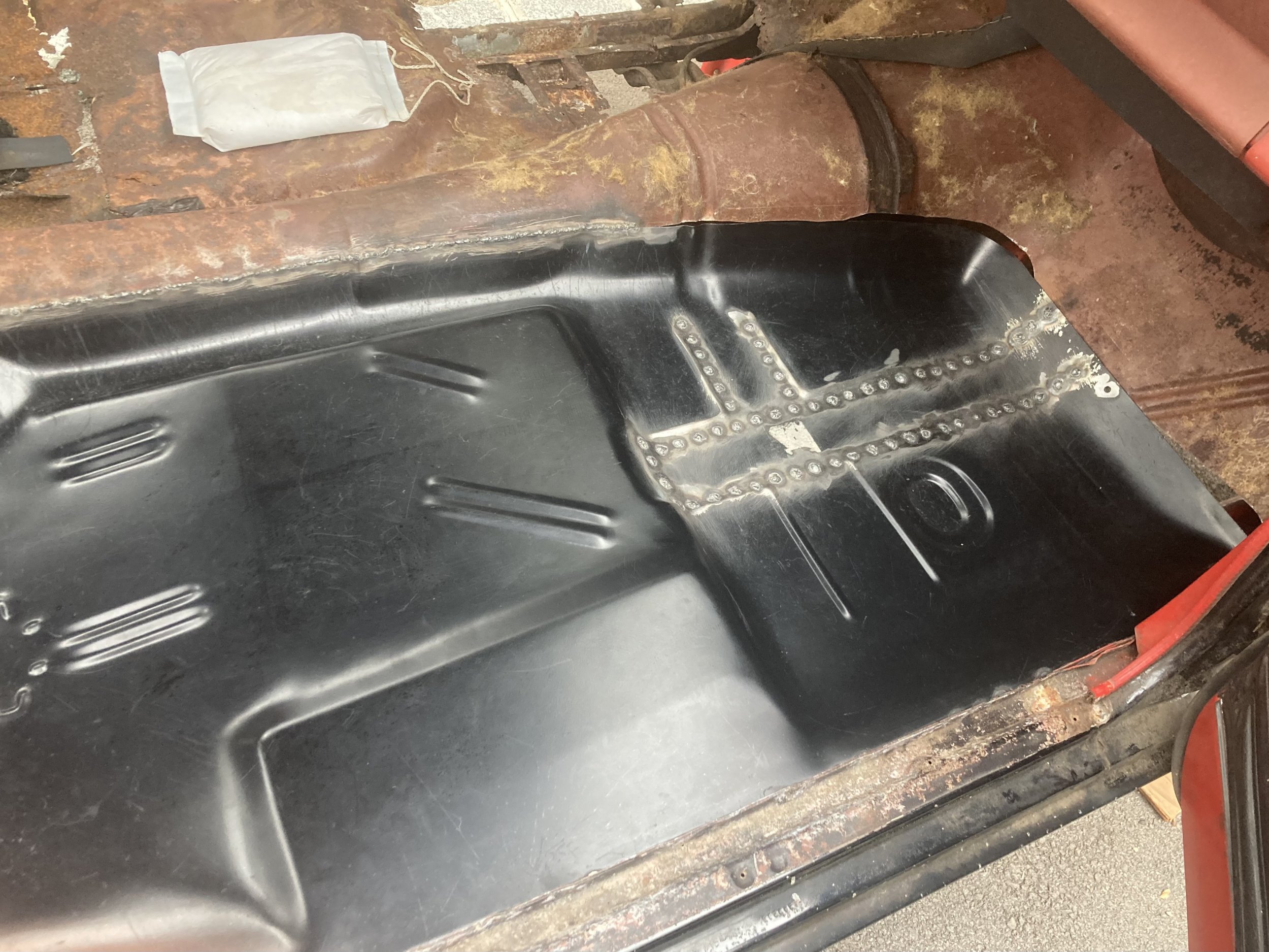

    Alittle Update on the car. Still need to wet sand the engine bay. Currently doing the floors. Fuel system is all new, brakes/new lines etc… IMG_8162.jpeg IMG_8164.jpeg IMG_8165.jpeg IMG_8163.jpeg IMG_8248.jpeg IMG_8252.jpeg IMG_8255.jpeg IMG_8269.jpeg IMG_8270.jpeg IMG_8271.jpeg IMG_8283.jpeg IMG_8282.jpeg

    Looks good. I do floor pans the same way, mark the substructure, drill holes in the pan and then weld them together from the top. Nice clean job that way.
