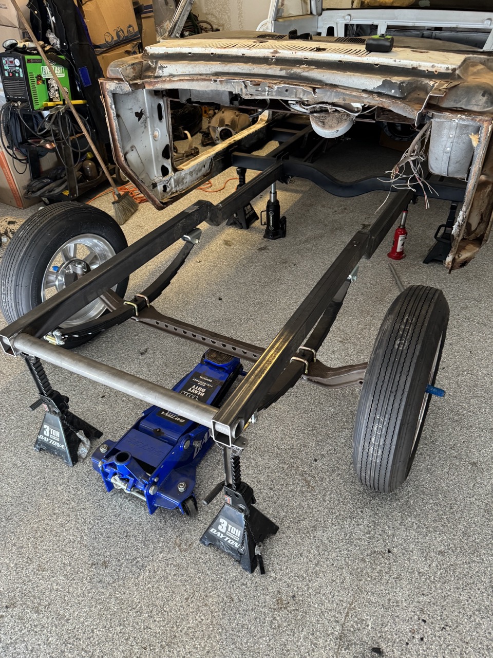

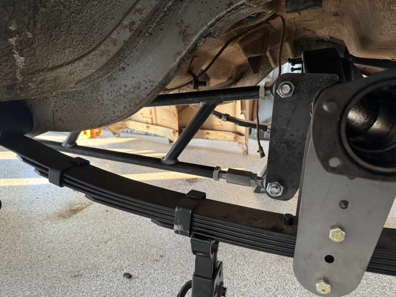

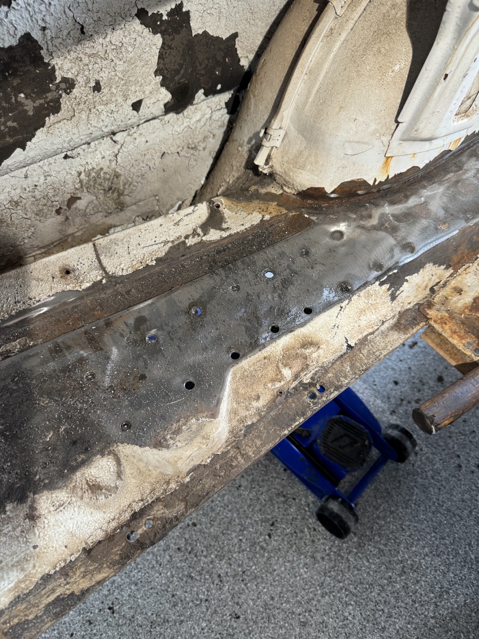

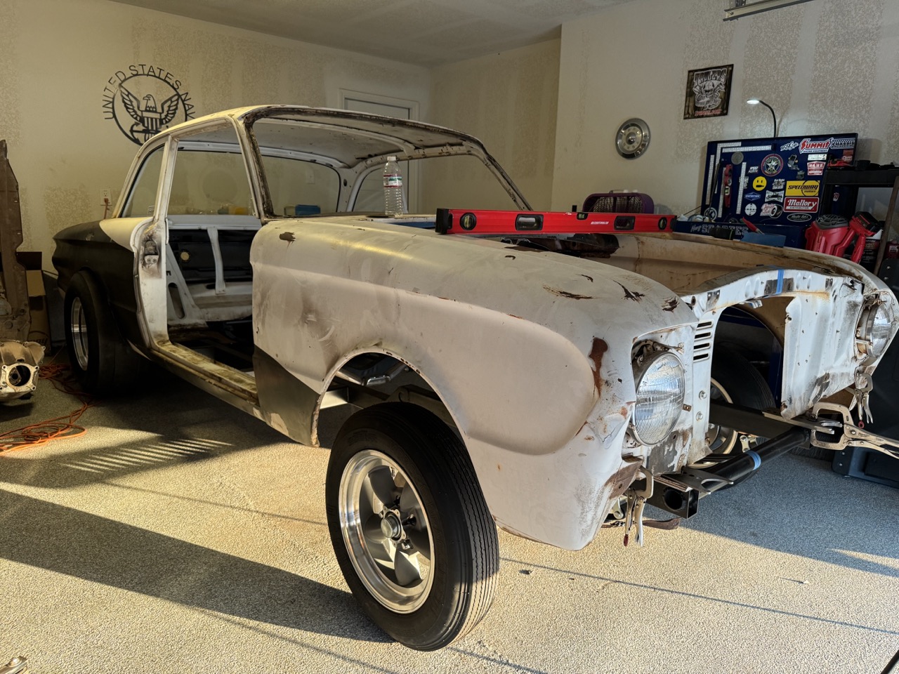

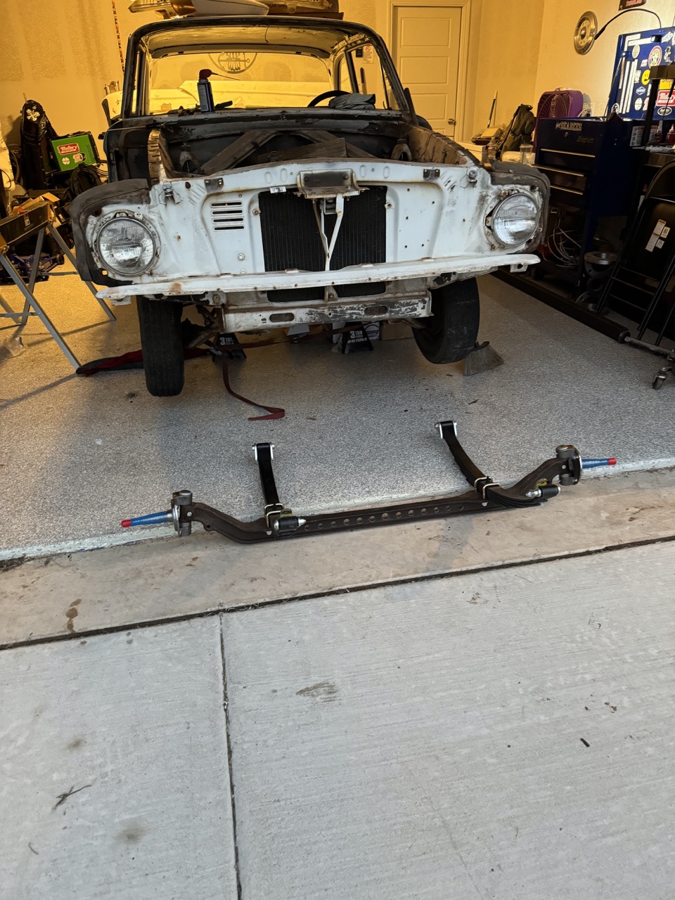

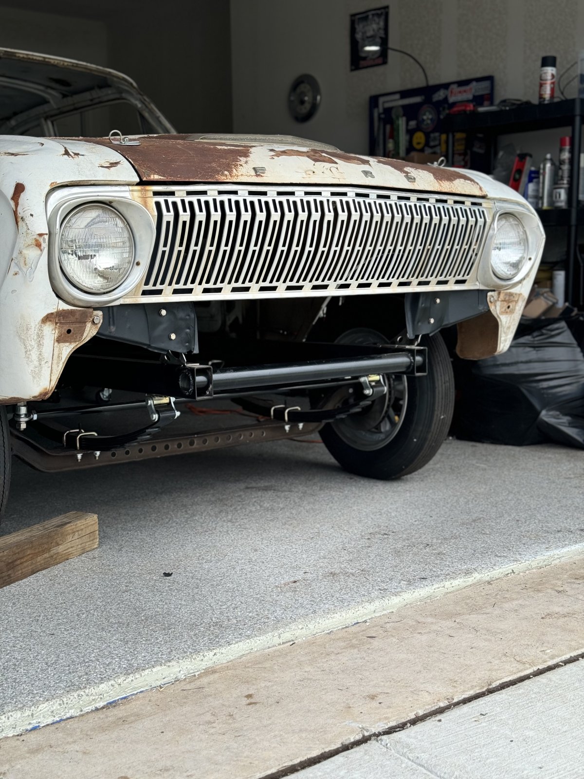

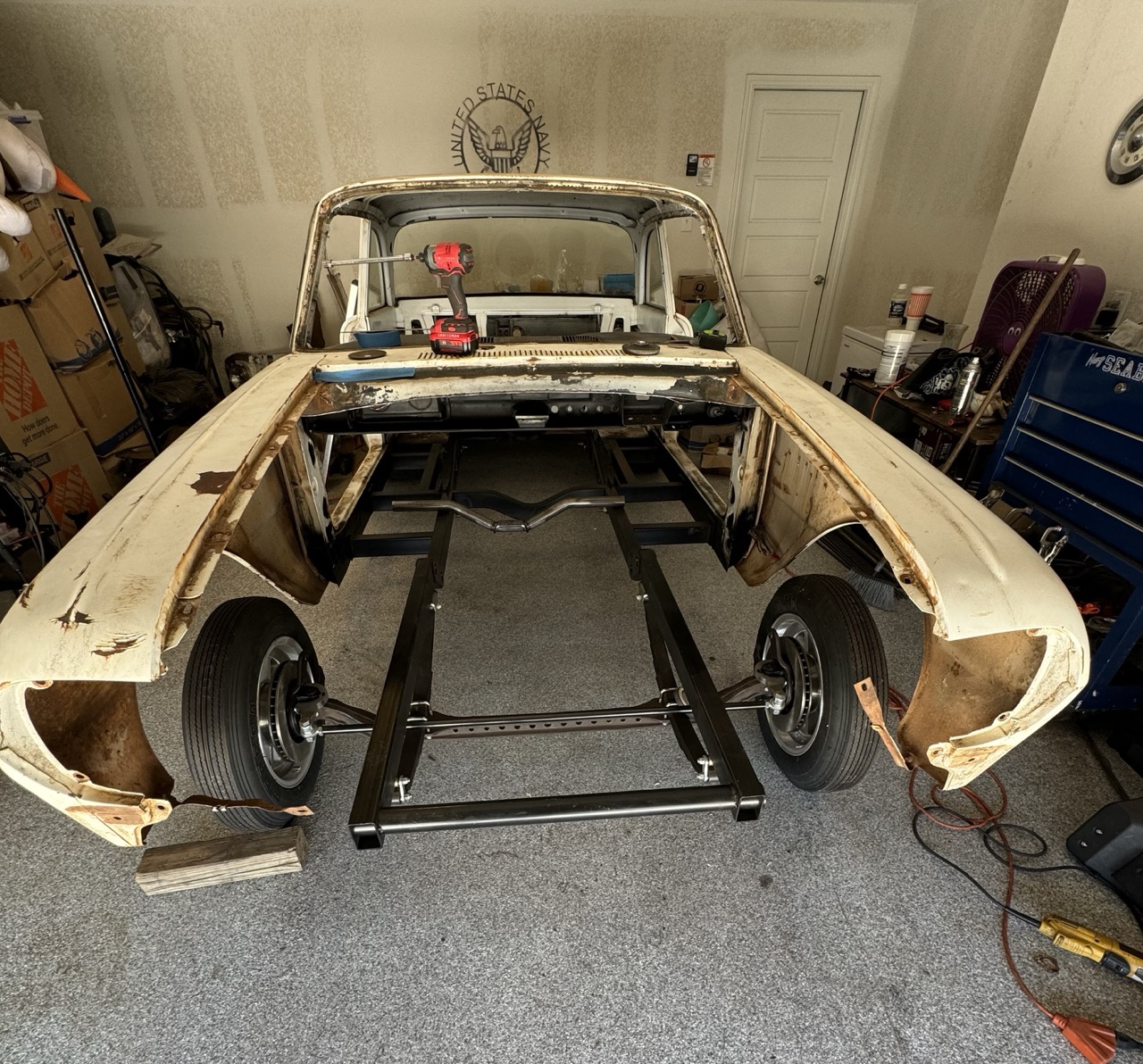

    Here is my newest project. It's a 62 falcon out of OKC. I've been working on it for several months now, so I thought it was time to share my progress. I'm building a gasser out of it. IMG_5252.jpeg IMG_5856.jpeg IMG_4631.jpeg IMG_4629.jpeg

    Few more pics

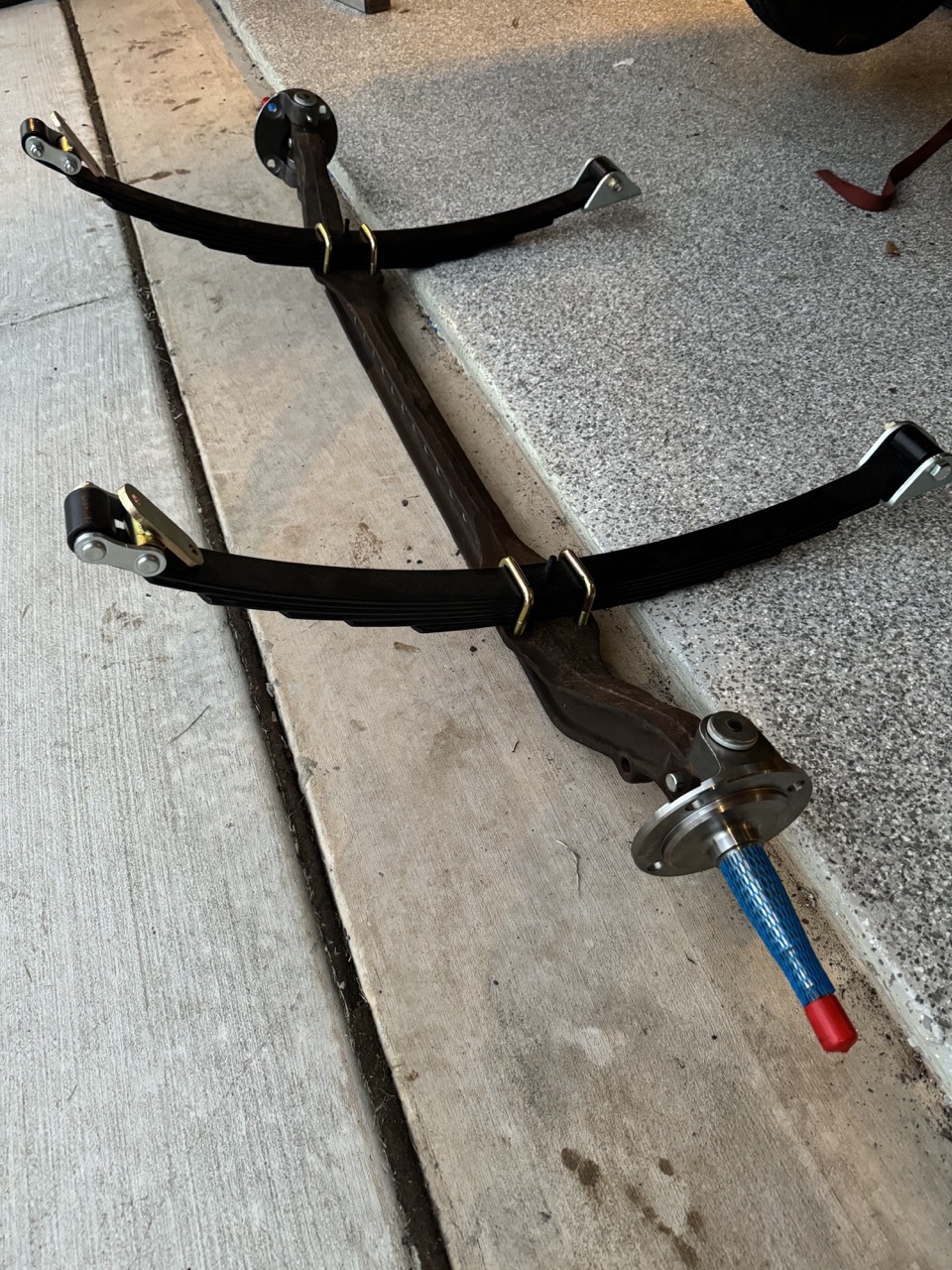

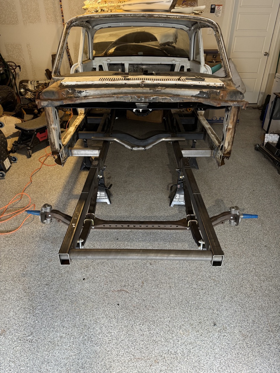

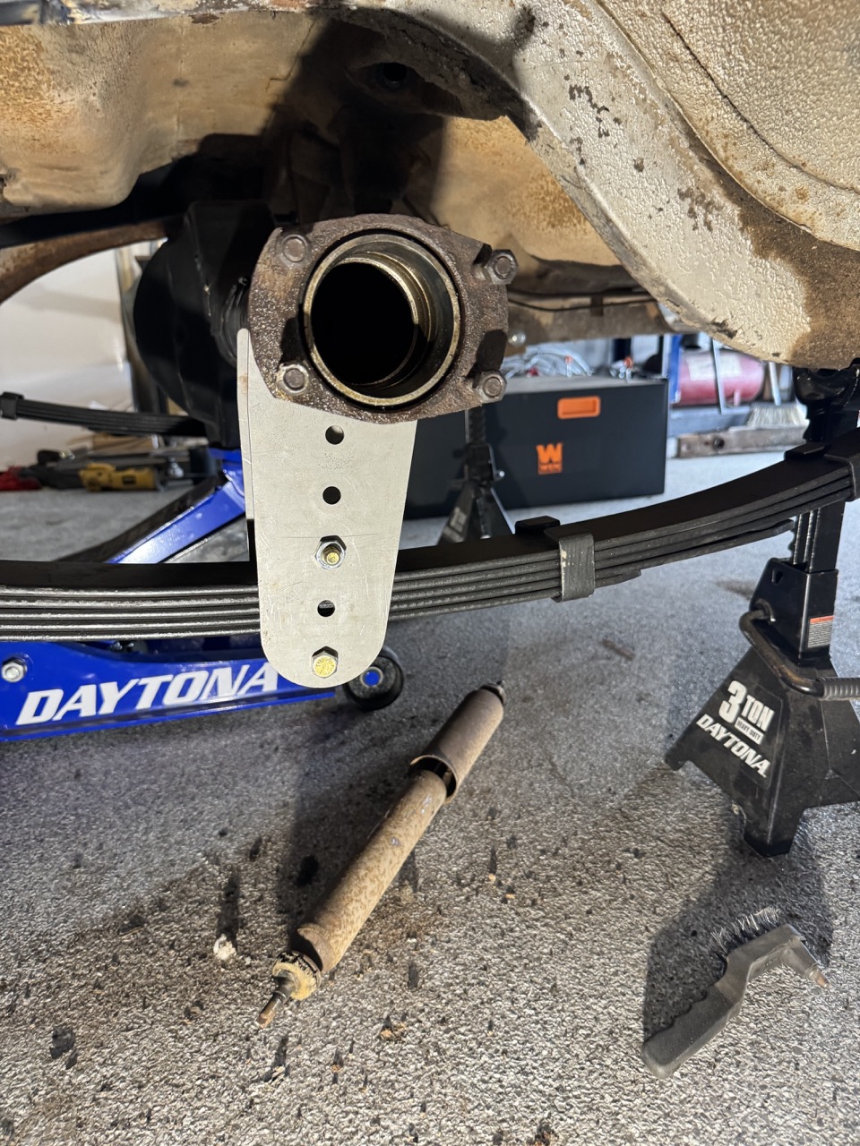

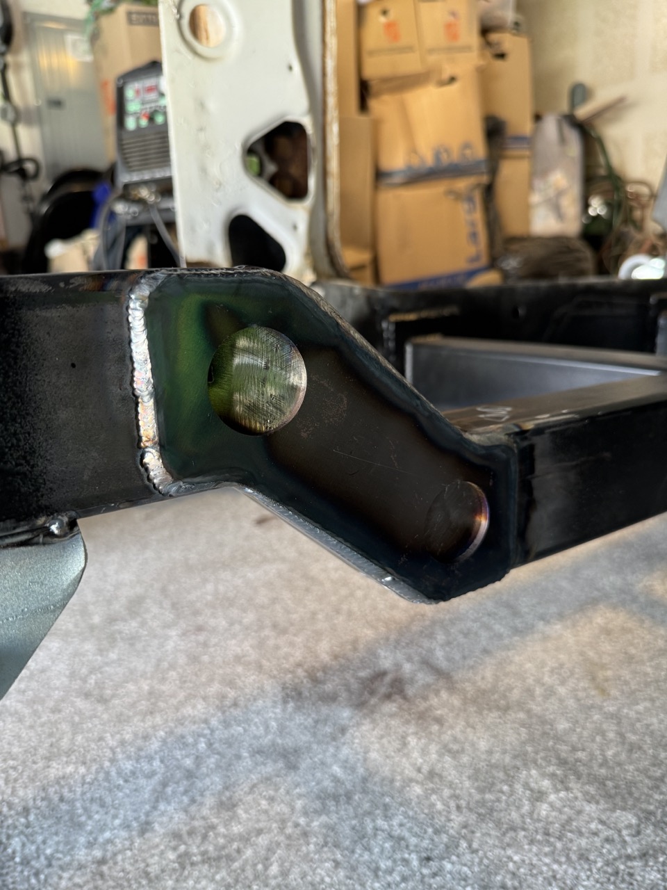

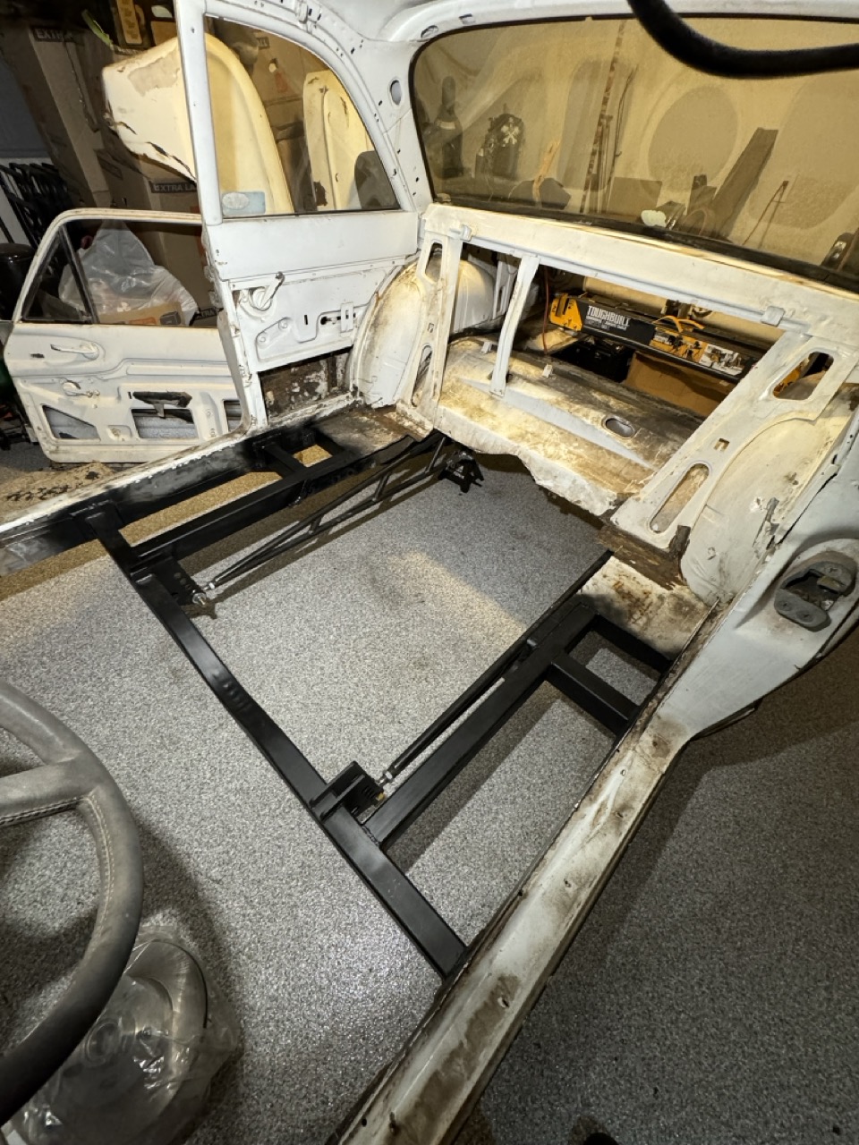

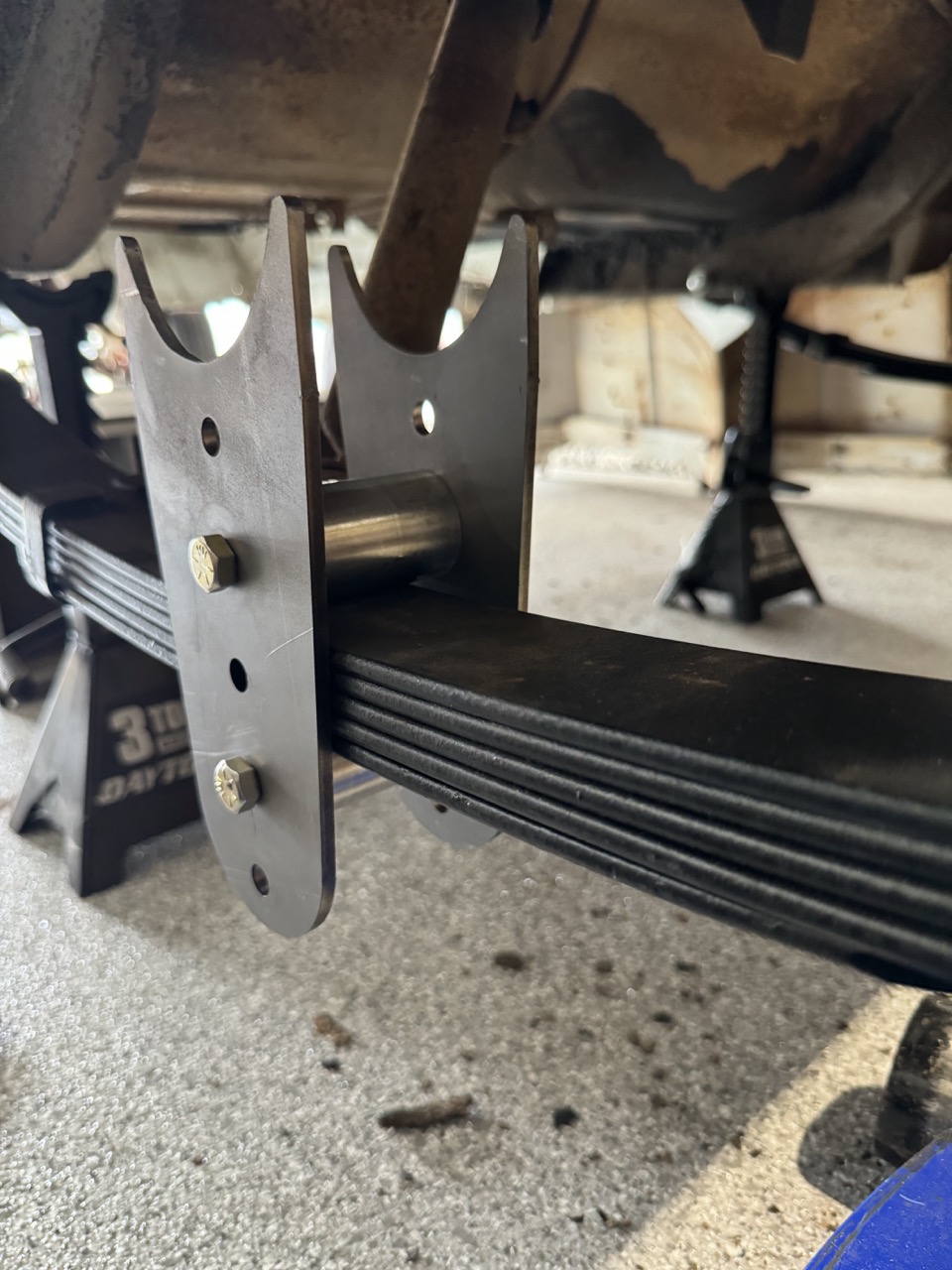

    Here is another photo dump, of the frame rail install, ladder bars, I kept the car leaf spring, but upgraded to HD mustang leafs, the original rear frame rails were rotten, so I modified some early mustang rails to replace them since you cant buy them. I am running a 48-52 F1 axle, using speedway gasser leaf springs, and spindles.

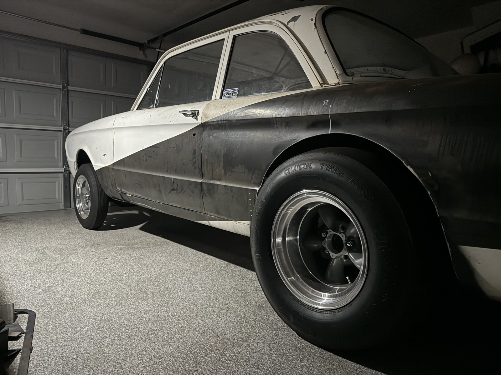

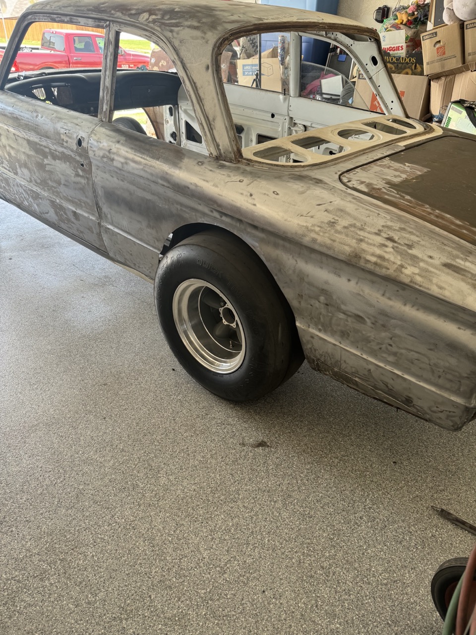

    I also recut the rear wheel radiuses a few times, until I got the stance I wanted. If you ever have seen the Falcon Gasser 'Hound Dog' Thats the stance I was going for. Drivetrain is up in the air, I got a Virgin Fe 390 105 block, and a 460, Transmission is still undecided. Roll cage install will be coming up shortly, after I finish stripping the paint.
