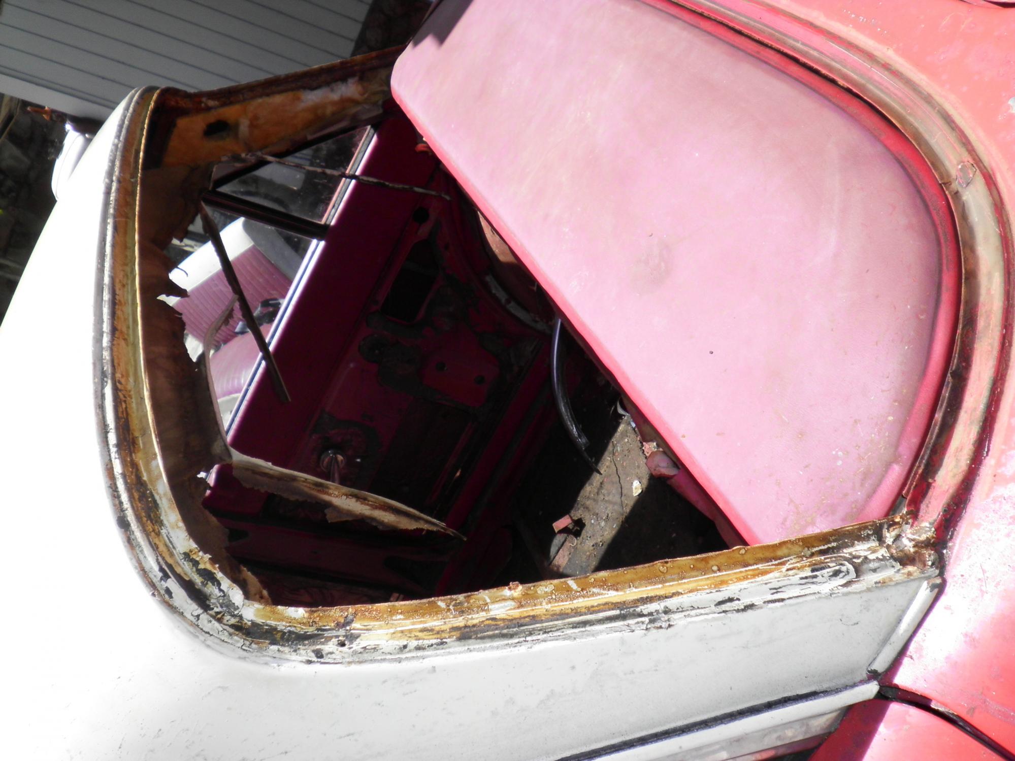

    Went out this morning and started gutting the Falcon. Very pleased about how little real rust I found. It was all I could do just getting the front seat out. Thinking of buckets. I hate front bench seats! even on 4 doors.
