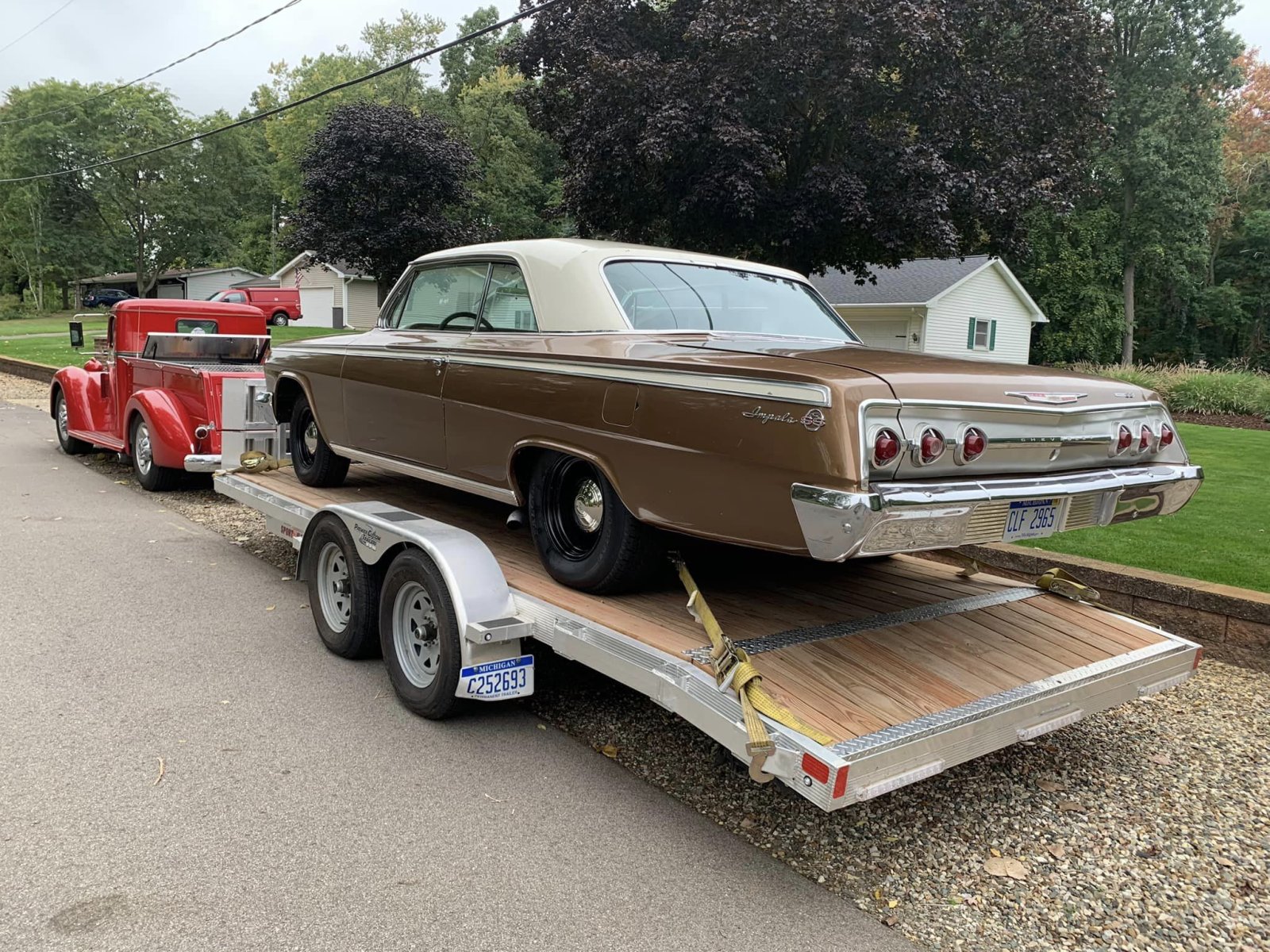

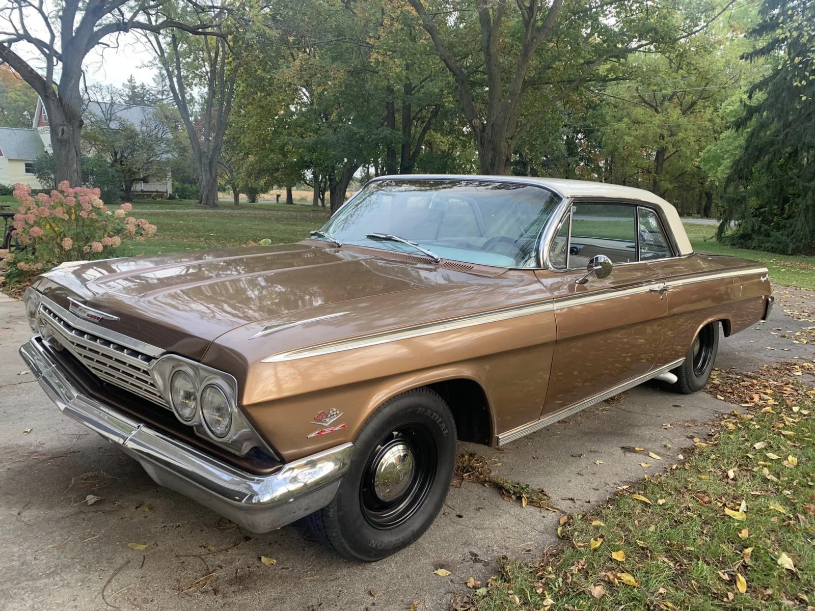

    I'd never seen it, but she talked about it whenever Randy was doing something with it, so I felt like I knew the car. He told me how much he wanted, I told him it wasn't enough, and gave $500 more than he said, and left feeling a little guilty for having bought it pretty cheaply.

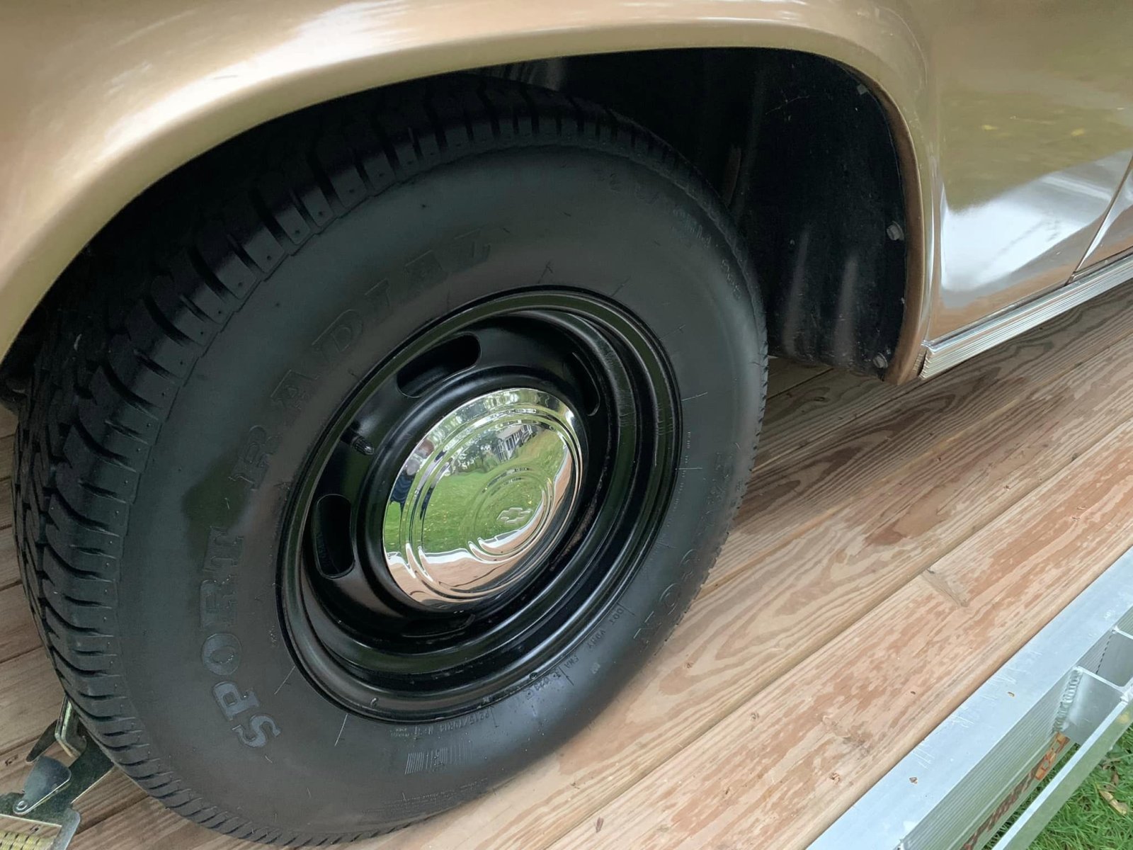

    We drove it for 3 weeks before we left for Florida, it ran great, so I felt like it was going to be a good start. 714E9B95-14D7-430F-B174-034C7D04A51D.jpeg 0B13857A-1EF3-4D47-920D-B08803E93273.jpeg 1B943D71-FBD3-458A-976A-82362DC72ADF.jpeg FA183382-3894-46C1-BAC6-9BE02192852B.jpeg DE687A0F-CF35-40A7-A795-47BE9A391850.jpeg 0C45A34D-8DCD-4D88-AF00-27619920B19F.jpeg E09F0AC0-09FF-443A-833C-8B210E869B15.jpeg 5DA1B6F1-6F89-46E0-8158-9755283AE479.jpeg 44C4D6F7-6F79-48E5-8B6B-EE2CC1C38089.jpeg 4C8B402E-D422-4EAB-9A1C-B1D7B5D5A42B.jpeg AEBA656D-F778-4F54-BAF3-58D92C80D6F3.jpeg 2CC5A690-168C-4E41-8D6A-74E5287FF098.jpeg 29EE8AC7-F4B5-4746-8D2F-EE776F2C8FD1.jpeg 6E3BD3C4-D34C-44A0-B503-34F0FE437A29.jpeg BDC50C50-1302-4D89-887A-062EA26C8F7D.jpeg I got it out as soon as we got back. The first thing I noticed was a puddle of trans fluid under it, but it still moved. Outside, there were some blisters starting on the right rear wheel opening, which he told me had worked on 35 years ago when he repainted it the light bronze color (from the original turquoise).

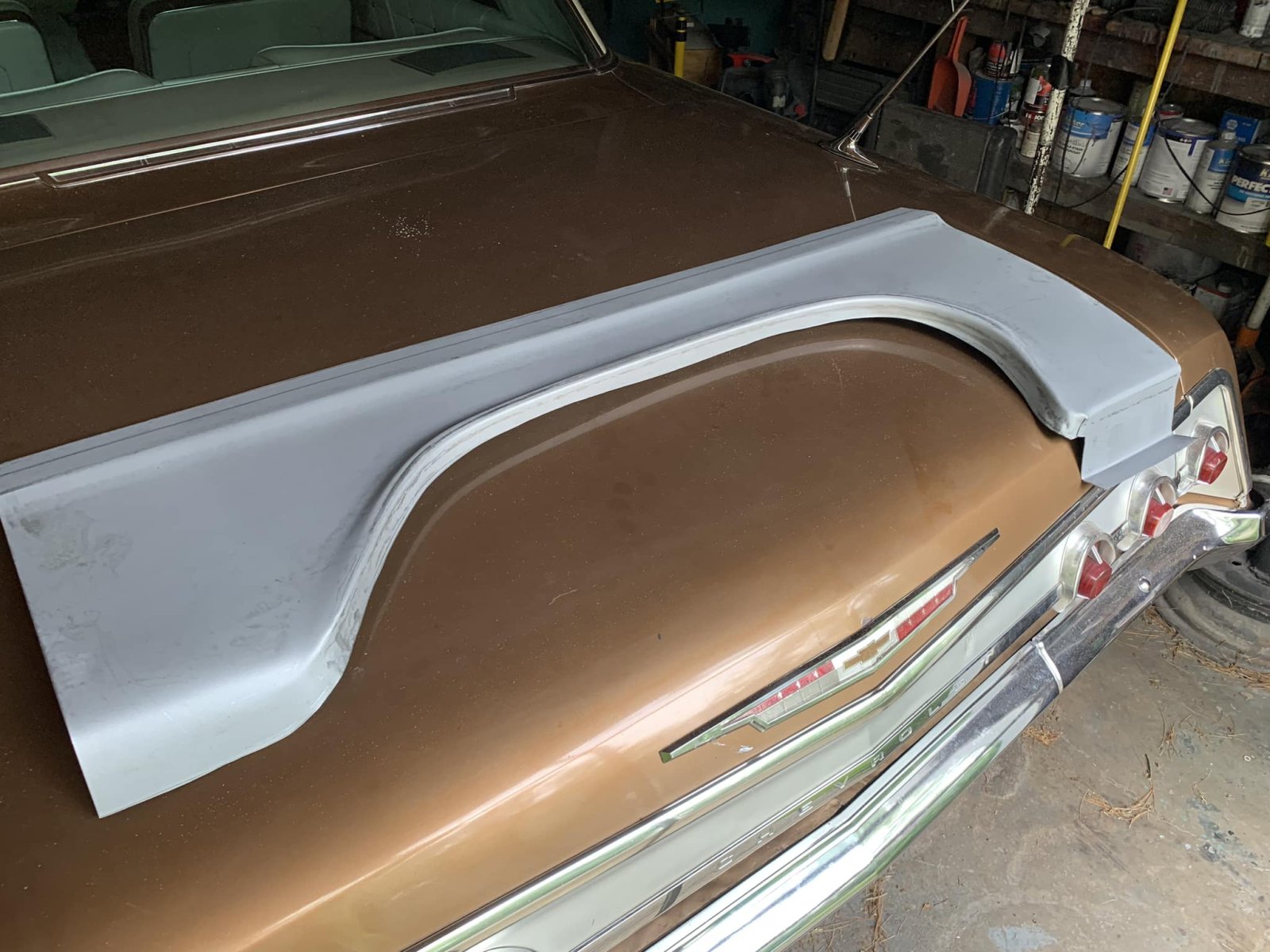

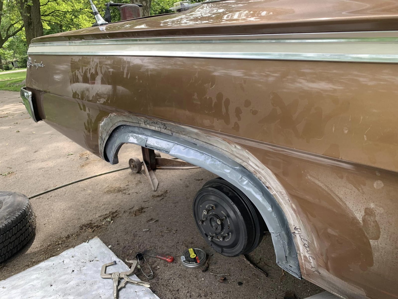

    I ordered a wheel lip patch, as opposed to a whole new quarter panel, and am in the middle of getting that on now.

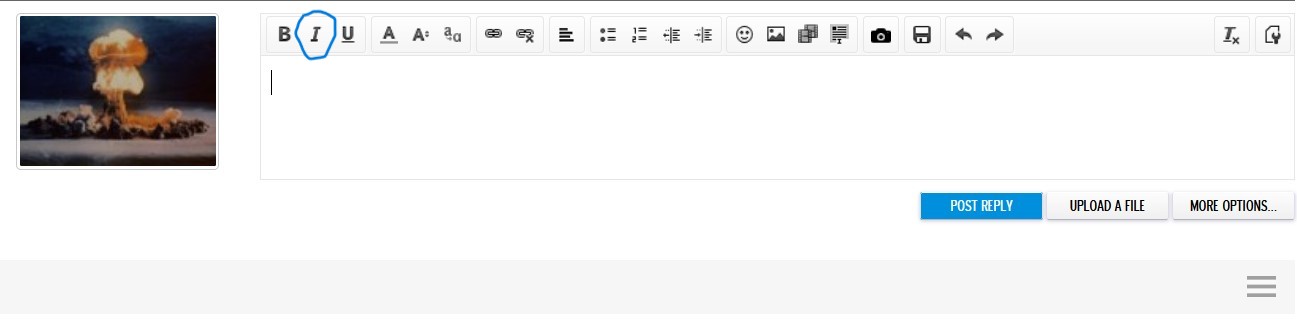

    If you accidentally hit the above icon see (photo below) that will change your writing to italics. If it is changed to a light grey color that means you have turned it on. Simply click on it until the space around it is white again. :)

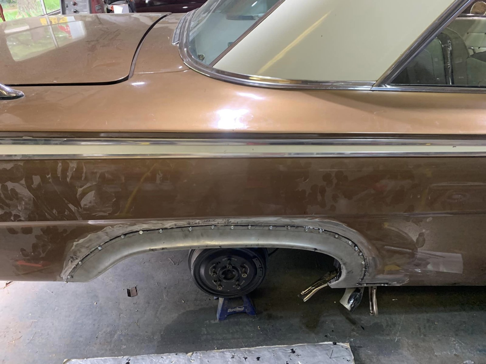

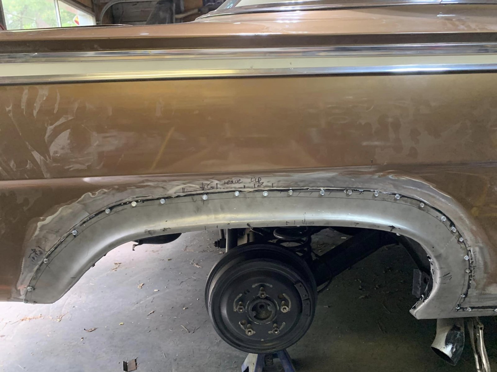

    I went ahead and bonded the patch panel on this morning. I didn't ignore the advice (well, I DID ignore it, but seriously considered it) to not use Panel-Bond for this, but I've used the stuff with great results in the past. The biggest job was a '59 Edsel wagon that I glued the entire roof skin (which had rusted off the body at the drip rail all the way to the A pillars) rocker panels, lower front fender heels and (home made) dog leg panels on with Panel-Bond. It was a huge job, LOTS of seams on big, low crown panels. 10 years on, the repairs look just like they did when the job left my shop, no seams showing. So I went ahead with it, figuring I didn't want to have the panel warped from heat and deal with that. And, I want to get it done and enjoy the car, not spend the summer working on it.
    Tomorrow I'll back the self tappers out, chamfer the holes, knock the little bead of epoxy down on the seam, wipe a skim coat over the seam and fill the holes, then a skim coat of short strand gl*** filler and a final skim of plastic filler and it'll be ready for primer.

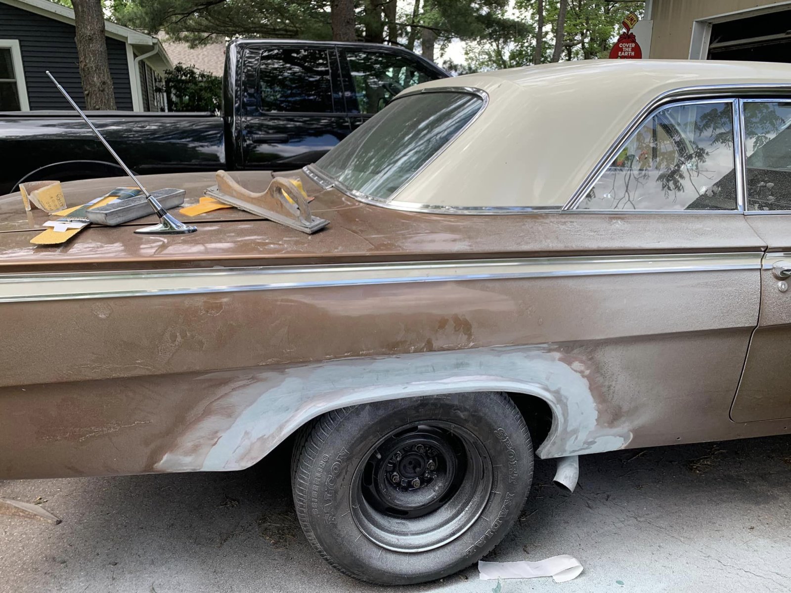

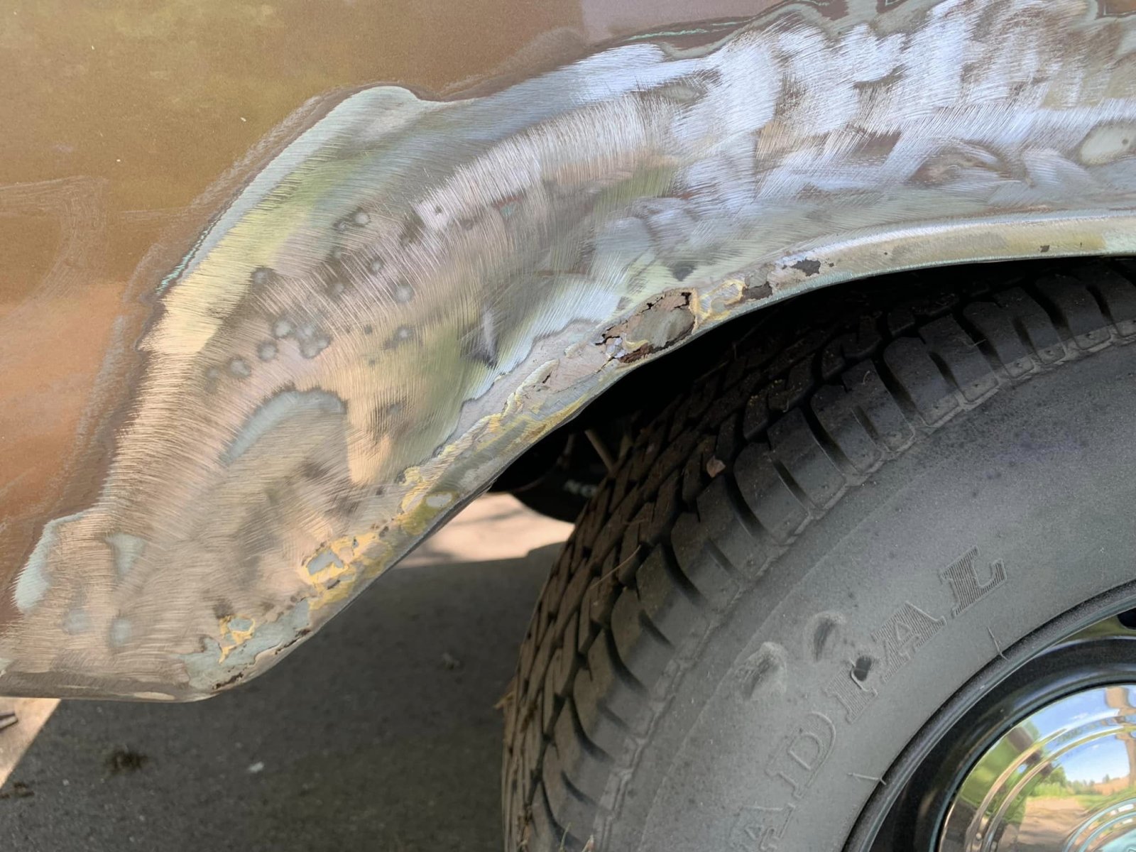

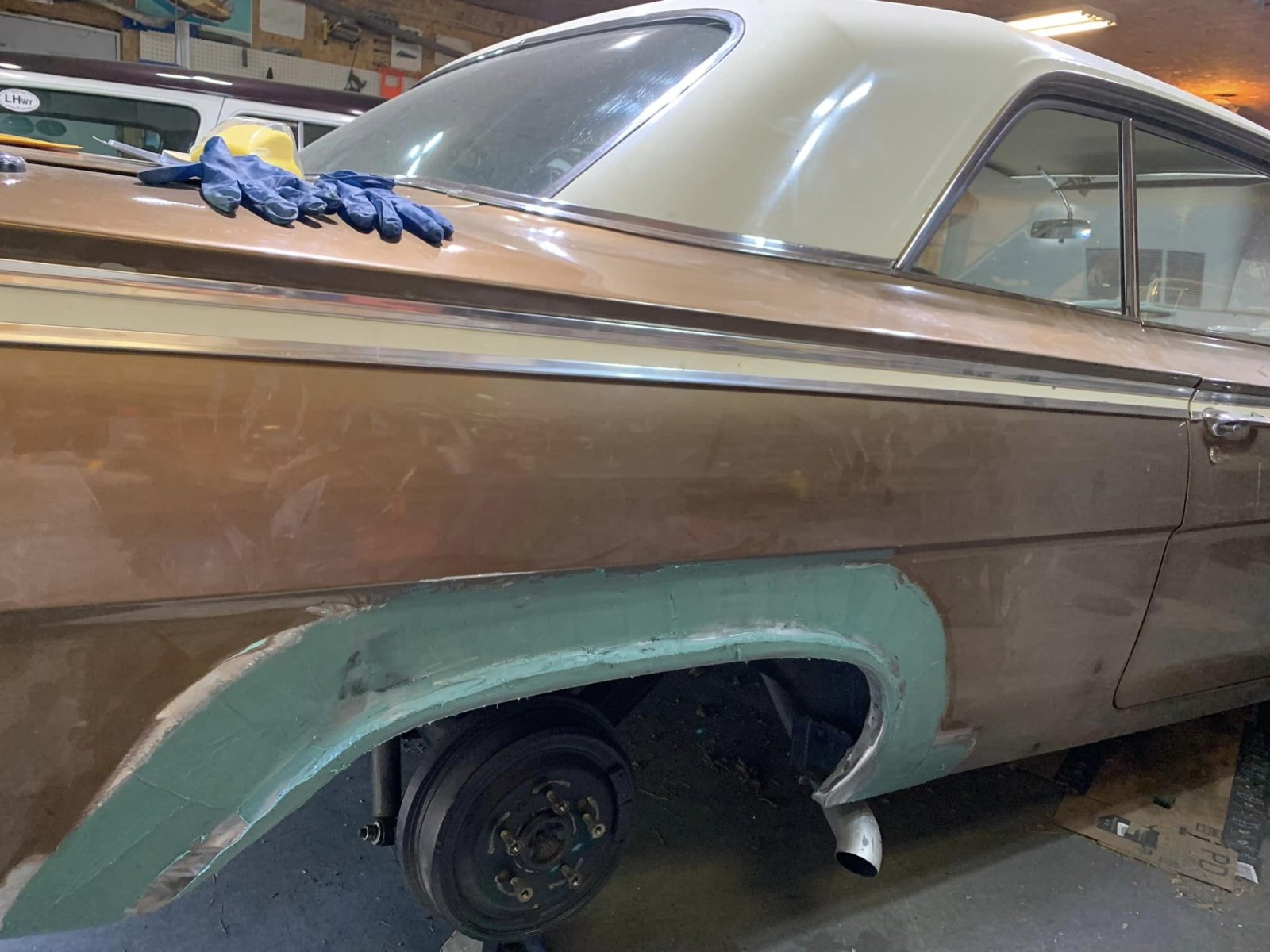

    More dumb stuff: I was embarr***ed to not notice the patch panel wheel lip wasn't as "crisp" as the original, with the lip having a gentle radius, not a sharp crease like the original, until I had it bonded on and the epoxy roughly flattened. It looks like it was made on a bead roller.
    Oh well, I can "fix" that with a little fillet of 'gl*** reinforced filler, which I did. That's roughed off with a first coat of gold plastic filler on. I admit I'm a little rusty, I put too much catalyst in the filler, and it started to kick pretty fast. I'll get it, it ought to be ready to start blocking by the time I get this posted, and I get back out there... B021FAAE-F093-4883-9A8D-5BBDD0273B2E.jpeg 82BF0F9F-849F-4C7C-B876-95D22E3639FB.jpeg E633CAA7-6A72-4EBB-84C0-F012FA2D5B87.jpeg EC270B21-7B6E-492C-B254-79AA972244D0.jpeg

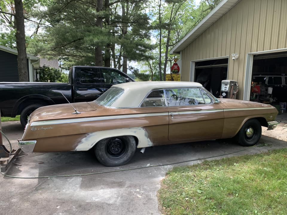

    Sanding, sanding, and more sanding. Then more filler, more sanding, then take too much off, so more filler, then more sanding. I've got enough time in it at this point that putting a new quarter panel on is looking like it might have been no more effort. Probably wouldn't have been any closer to being right, so, maybe not... 4941E70B-B3E3-4E11-824A-8BC90A1010C9.jpeg

    I like the tu-tone, it's that three tone paint job that my wife doesn't like that is making me paint it...;)

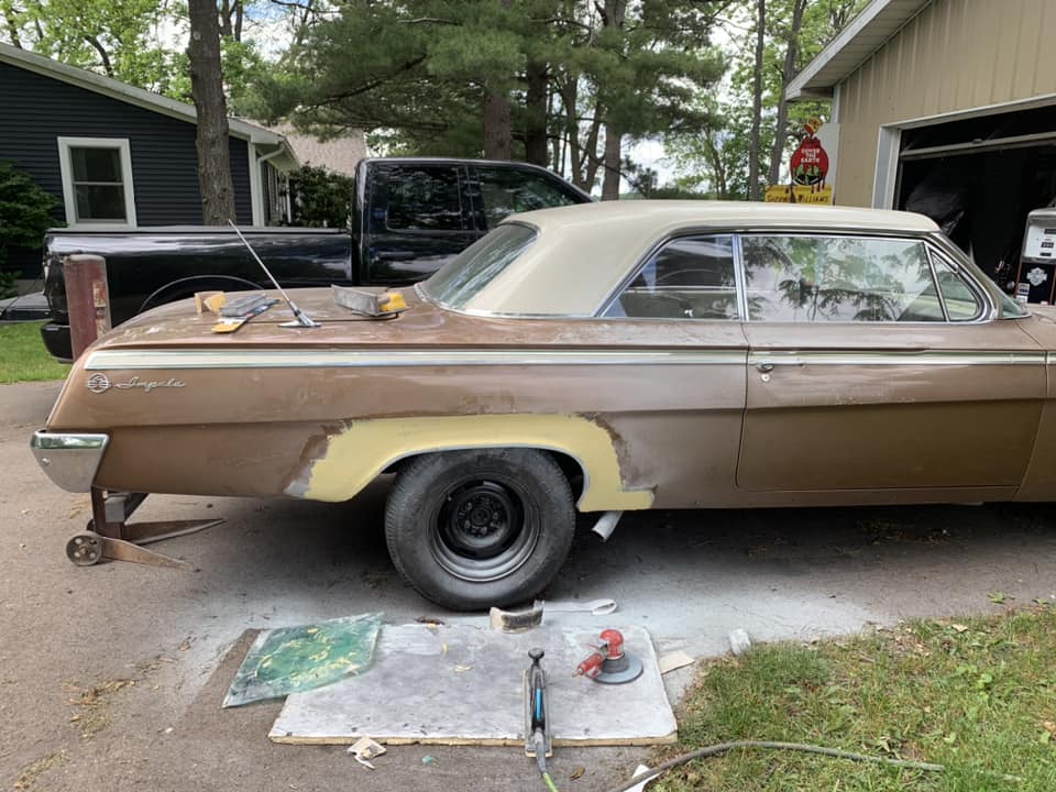

    What’s the jack you’ve got at the back? I don’t think I’ve seen one like that before.

    That's a Blackhawk bumper hoist. It's the bomb for cars with bumpers, although these X framed cars are a little too flexible to be lifted off the ground. My '63 Riviera didn't like being lifted with this either. I've got a scissor lift, but it's in the back of the shop and is a ****** to move, so I'm suffering with this. Laying on the pavement long blocking filler is not my favorite thing...

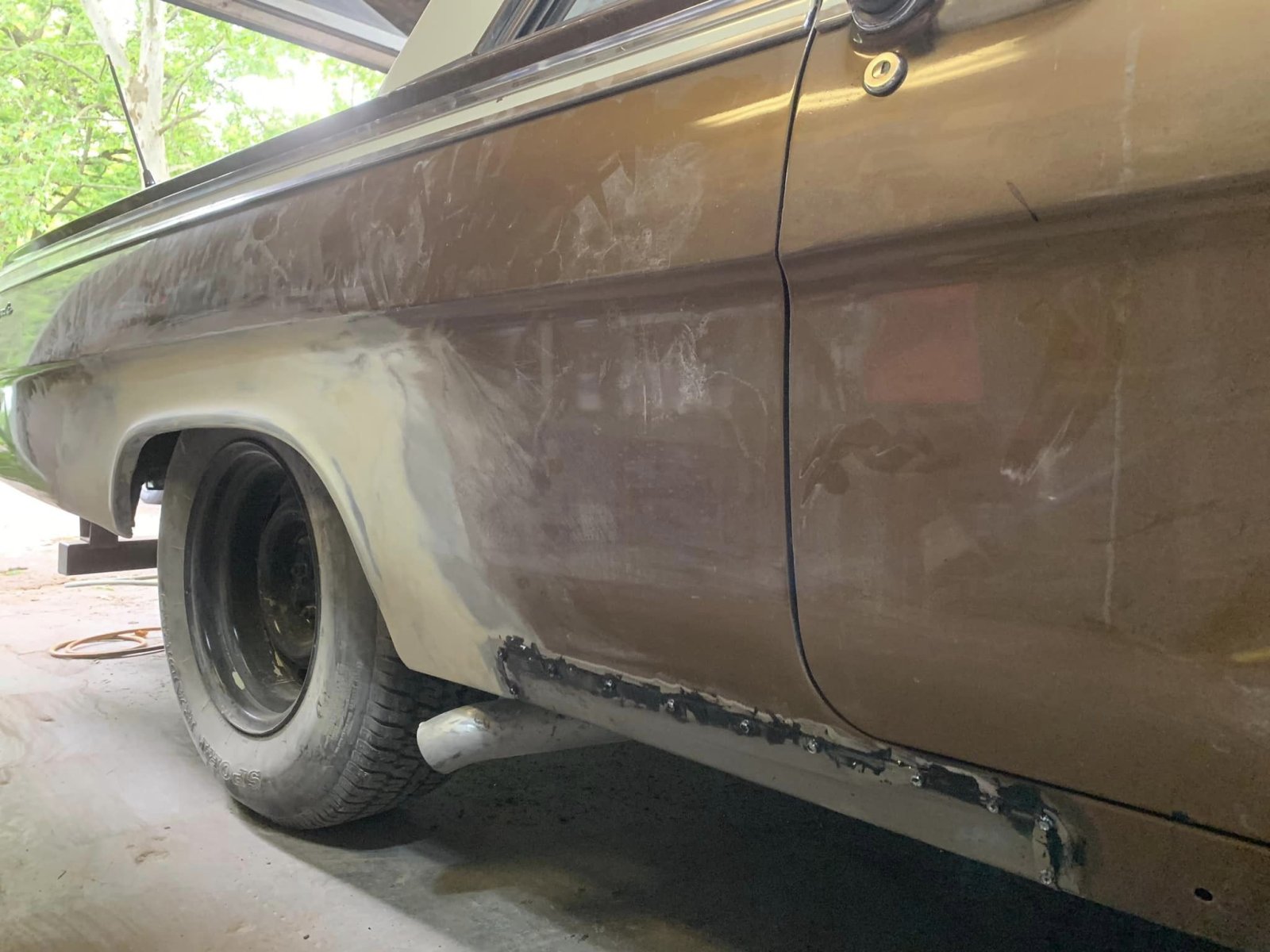

    Well, I THOUGHT I was done. There were some blisters on the lower rocker, that I hadn't noticed until I got under it and was knocking some paint off. I made a patch panel for the rocker, bonded it on and I'll finish it up tomorrow. I'd probably better pop the rocker molding of the drivers side and check that one too... 20184EA3-9C61-46CD-9F6F-D0470C9E57A5.jpeg

    Brian, I’m enjoying this tutorial. Lap joint and adhesive correct? What about all comments stating that there WILL be a noticeable line/shadow showing up on hot days?
    I have something similar to do to an OT truck and was going to **** weld but now not so sure...
    Whose repair patch is that?
    flynbrian48 likes this.
  25. 51504bat
    Joined: May 22, 2010
    Posts: 5,763
    51504bat
    Could have been worse. And no, I'm not doing the repair. Way beyond my skill set. bw2.jpg rr3.jpg
  26. flynbrian48
    Joined: Mar 10, 2008
    Posts: 8,757
    flynbrian48
    You mean the rocker patch? I made it from 20 gauge, on my homemade 4' brake. It makes a gentle radius bend because it flexes a tiny bit with this gauge steel, perfect for this little patch. The quarter patch is from a little company here in Michigan, in the little town of Sunfield. I was going to replace the whole quarter, but this was so much less $$ and work I took a flyer on it. I didn't ignore the advice to weld rather than use adhesive, based on jobs I've done in the past with this stuff. The seam over the wheel lip is in the pretty deep radius in the quarter, so I think it'll be OK. If it does end up showing through, I'll have been wrong, but it won't be rusty either. :p It won't be the end of the world. I want a driver, and if I do end up having to replace the entire quarter, that's what I'll do.

    I suspect the panel bond will work fine but I am not brave enough to try it yet. I had a buddy years ago that bonded a partial quarter panel on a 69 Camaro and it didn't work that well. On that same note and about that same time, I welded some partial quarters on both a Chevelle and a Nova and warped the **** out of them to the point that bodywork after welding was a real chore. So, not sure which was better or worse. Sounds like you have had good luck with bonding so maybe I will get brave and try it sometime. To your point, there is very little to lose by trying it for now even if it does have issues later.

    I meant to add that I debated welding vs. bonding before others here brought it up, but made a decision based on past experience. Because the seam is in a pretty tight radius area, not the center of large low crowned panel I went ahead with the bonding. You are absolutely correct in thinking that welding a patch in a panel like this can cause as much headache later on as this method. Warping, pinholes, and so on. Mainly I didn't want to get into a huge project and have the car tied up, but rather, I want to get a unified, driver quality paint job on it and enjoy it. I have a car in the garage that has been apart for years, I don't want two...
