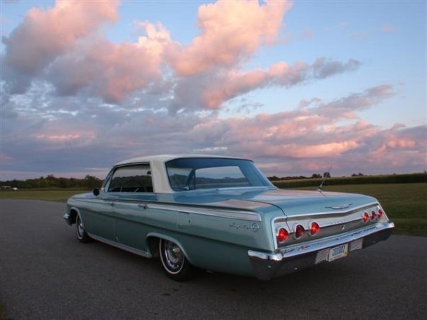

    Just for nostalgias sake, here's my previous '62, this Sport Sedan I did for our son. 283, 'glide, we drove it cross country twice. It did NOT like elevations over 10,000 feet. I love this color, and would paint the Coupe that color, but I don't want to blow the car completely apart to do it. Ginger brown it is. 4E6C5BF1-57ED-4207-A746-1E5843629090_1_105_c.jpeg

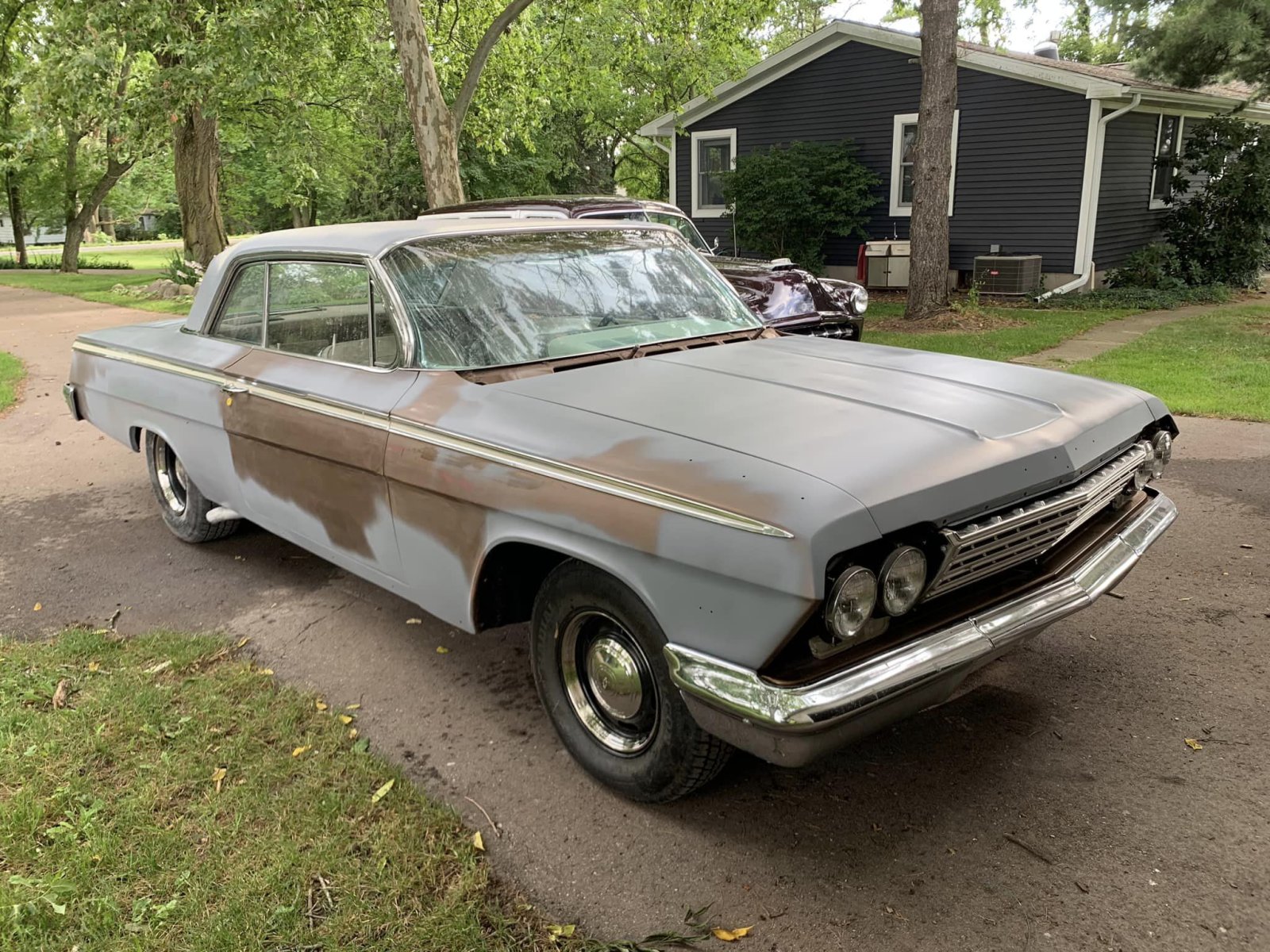

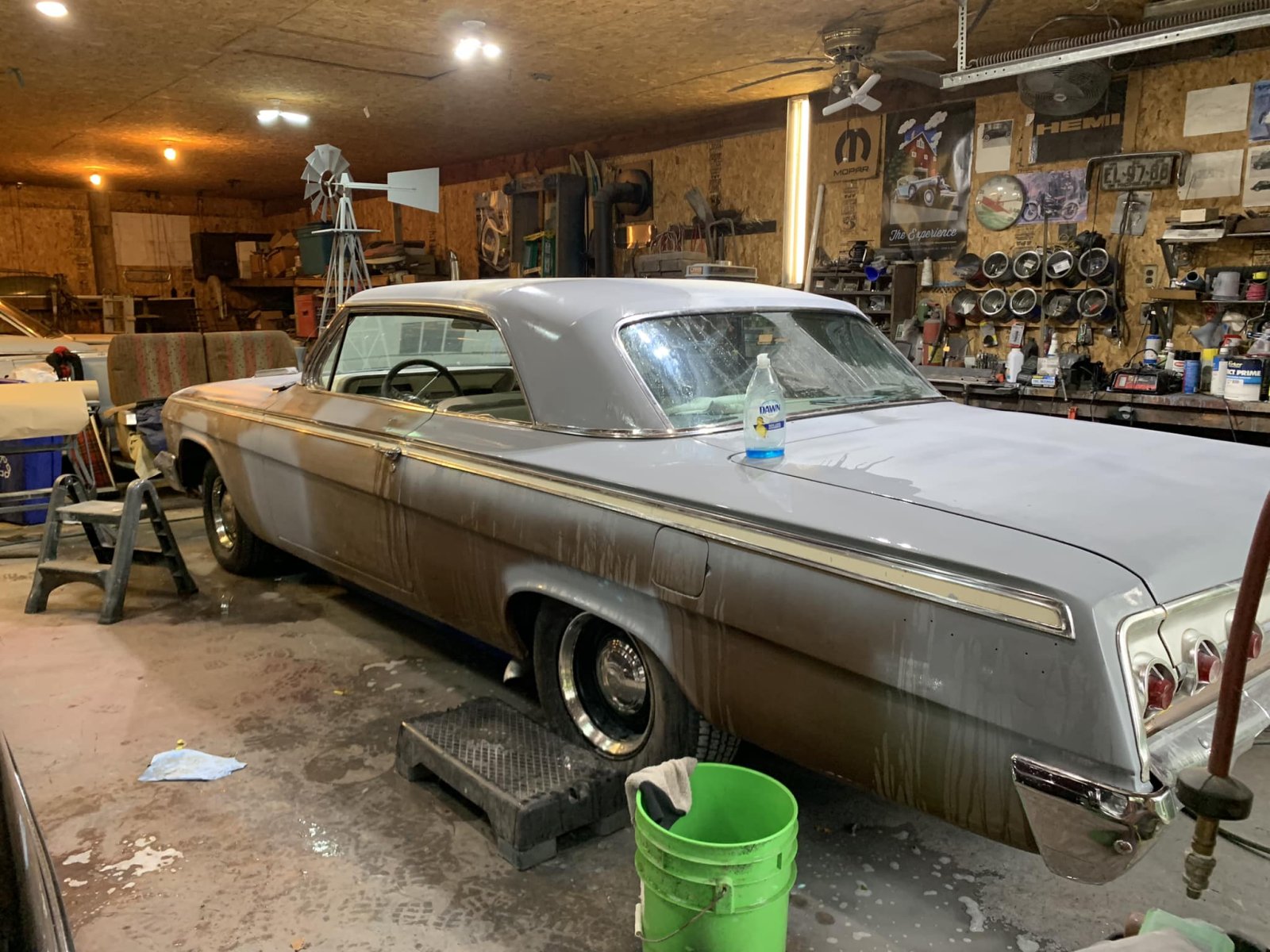

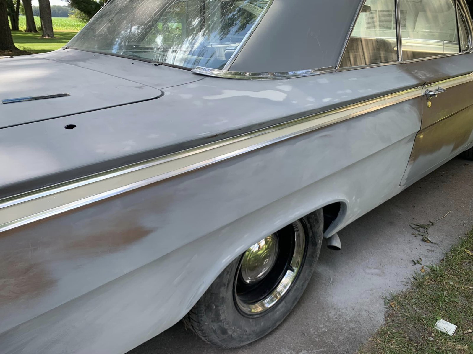

    It's in primer! Lots of work ahead, but one step at a time. 1C16037F-F2E7-4B02-BDC9-10F5E15688C7.jpeg A45063D4-E88C-4264-9DF7-AA5556B31D83.jpeg BD15DA91-90AF-4086-A5FA-3E35B1A4ABC4.jpeg

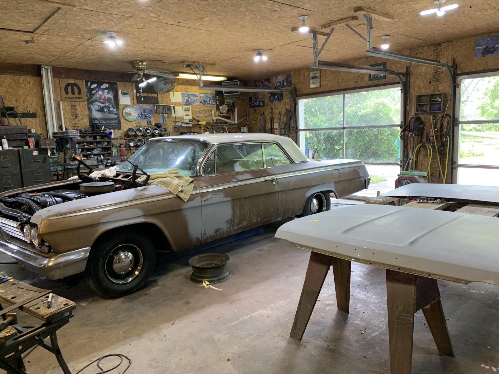

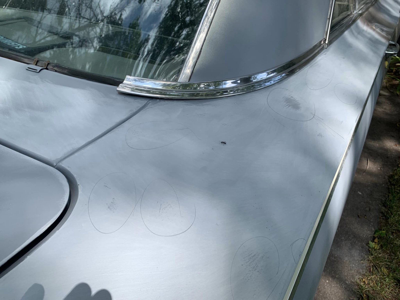

    When you think you've got it perfect, but the long board tells you "Not so fast". More blocking, more filler, more blocking, and I think now it's good. We'll see after I block the next double wet coats of high build... 064AA268-E19F-430D-BA09-0AD8D1D0AF9C.jpeg 1767E27B-2759-4F8D-B5B9-DE6BF154D252.jpeg F6C61137-FDF2-41C6-B922-FE9607F858CA.jpeg 3A55C2A2-609D-46A3-8A42-50D6743FCA1A.jpeg

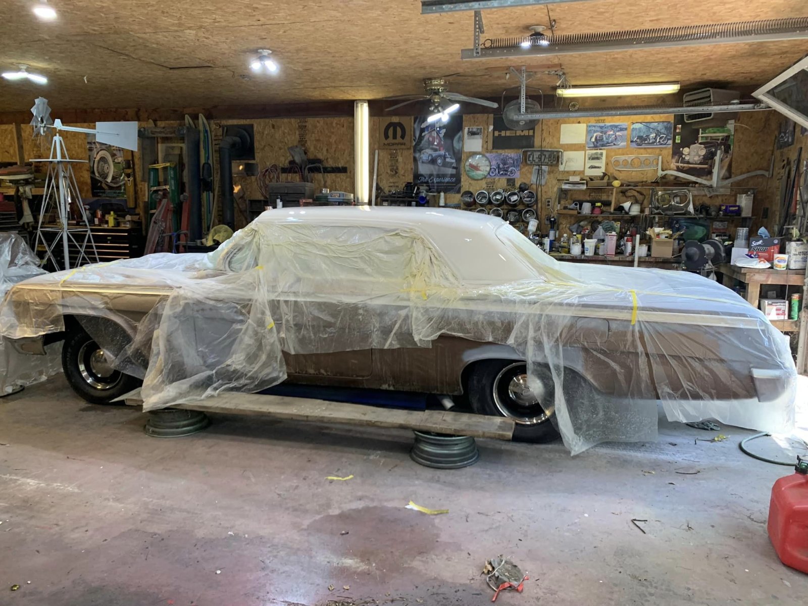

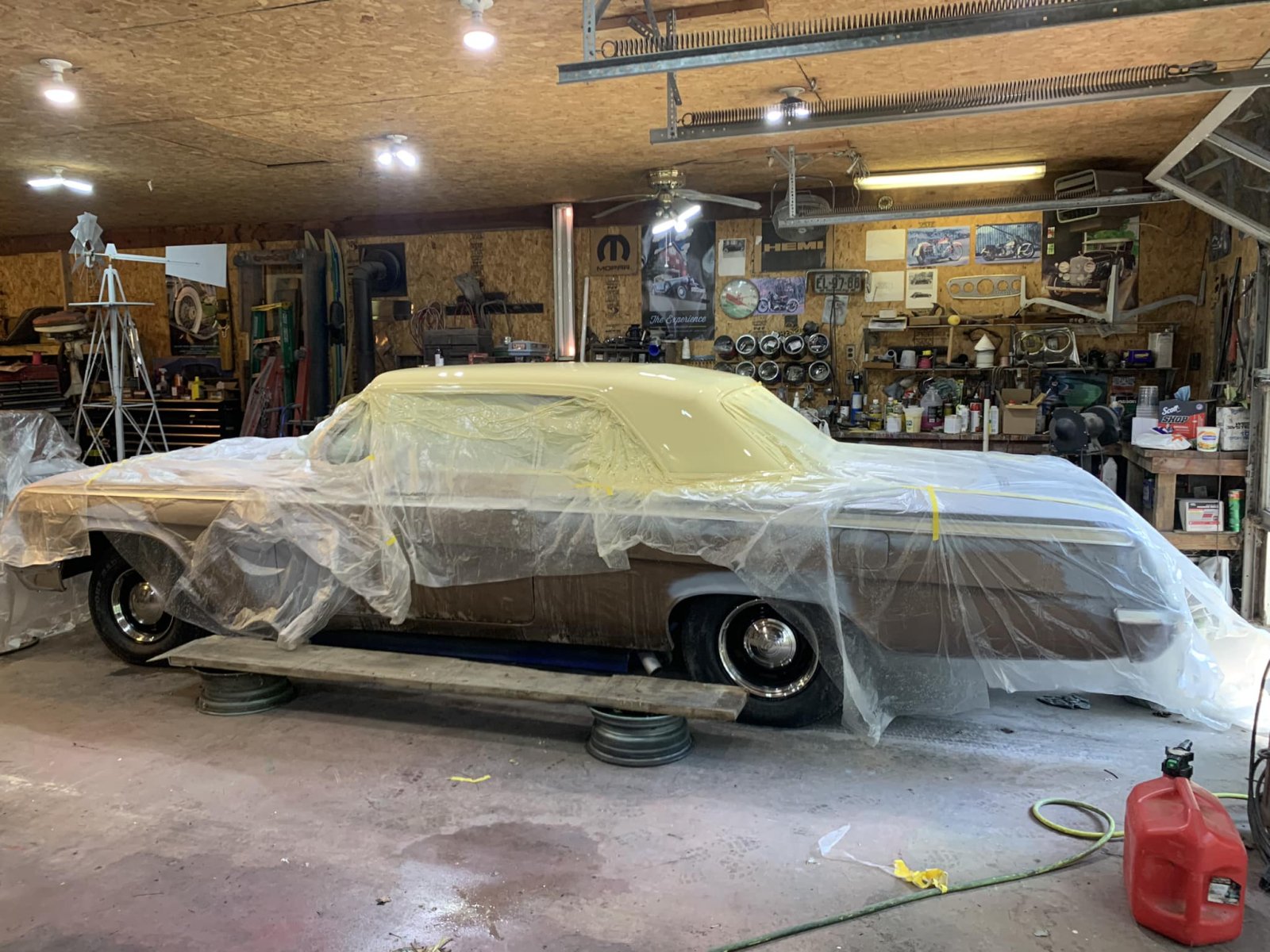

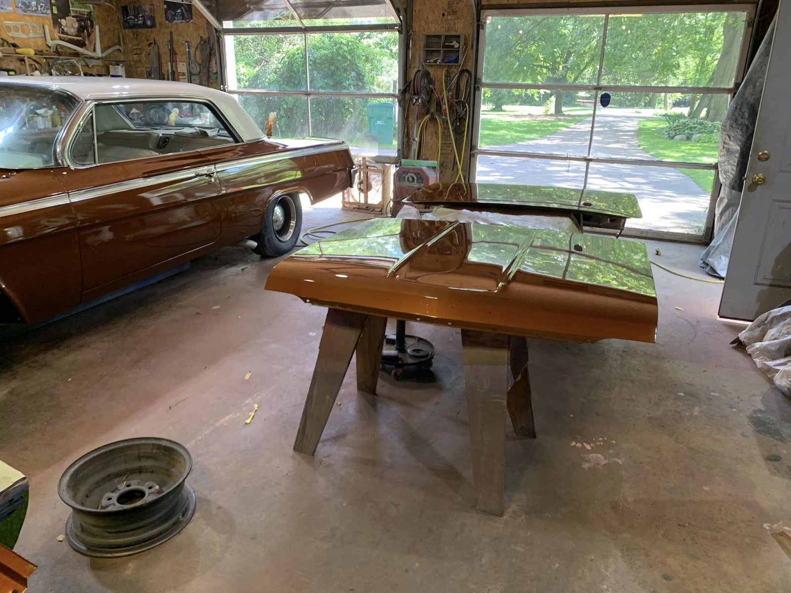

    I had paint mixed yesterday, 3 quarts of urethane single stage in the ginger brown (an '89 GM color called, "Medium Camel") and a quart of pale yellow for the roof. I got busy this morning and masked the roof off, cleaned everything up, mixed up some paint and shot a coat on the roof. It was MUCH more yellow than the chip I looked at to pick it, so I had my wife come out and tell me what she thought.
    "You need to go get a different color", she said, and she was right.
    Back the paint store and had them mix a quart of a Volkswagen color that is MUCH better. I had one self inflicted wound pulling the tape and plastic when a fold of plastic flopped over onto the still tacky roof pillar left a mark. I retaped the roof pillar, shot a couple double wet coats of color on the wound. It's almost invisible now, I'll knock it down with a little 600 then 1200 and wheel the pillar, it'll be fine.
    I gotta pull the hood and trunk lid, I can't reach over the fenders reliably enough to not lean into them to get the middle. I'll put them on saw horses, mask off the roof and should have it color by the weekend.

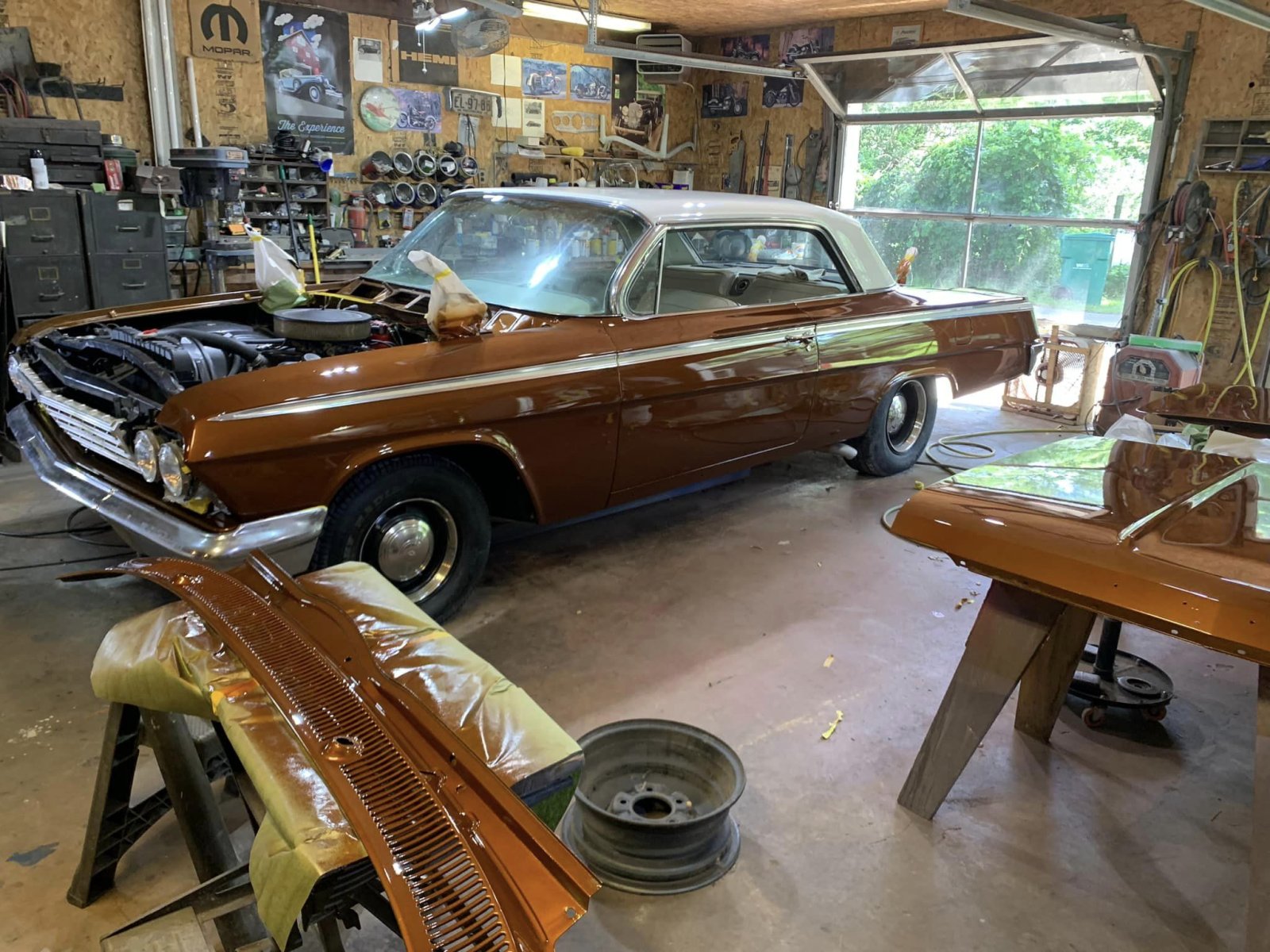

    I feel good. 6632DF1D-93E5-4194-A4A6-27834FC625E8.jpeg B7860D94-4D59-4EC5-82B6-1875C7DB9572.jpeg 7F3A6750-1B90-4E80-A5F5-ADCDAABADABF.jpeg

    I have three quarts of the color white I painted our son's '65 Ranch Wagon, and thought about using it, but it's like arctic white, no yellow at all, would have been too stark. It was only another $80 for the quart of the color that I ended up using, so I think money well spent. People complain about the cost of materials nowadays, but I've spent about $600 total for paint supplies for this car, pretty reasonable in my estimation. The color coats are all PPG, lays down really nice and it's super glossy. Also, very forgiving for home shop users.

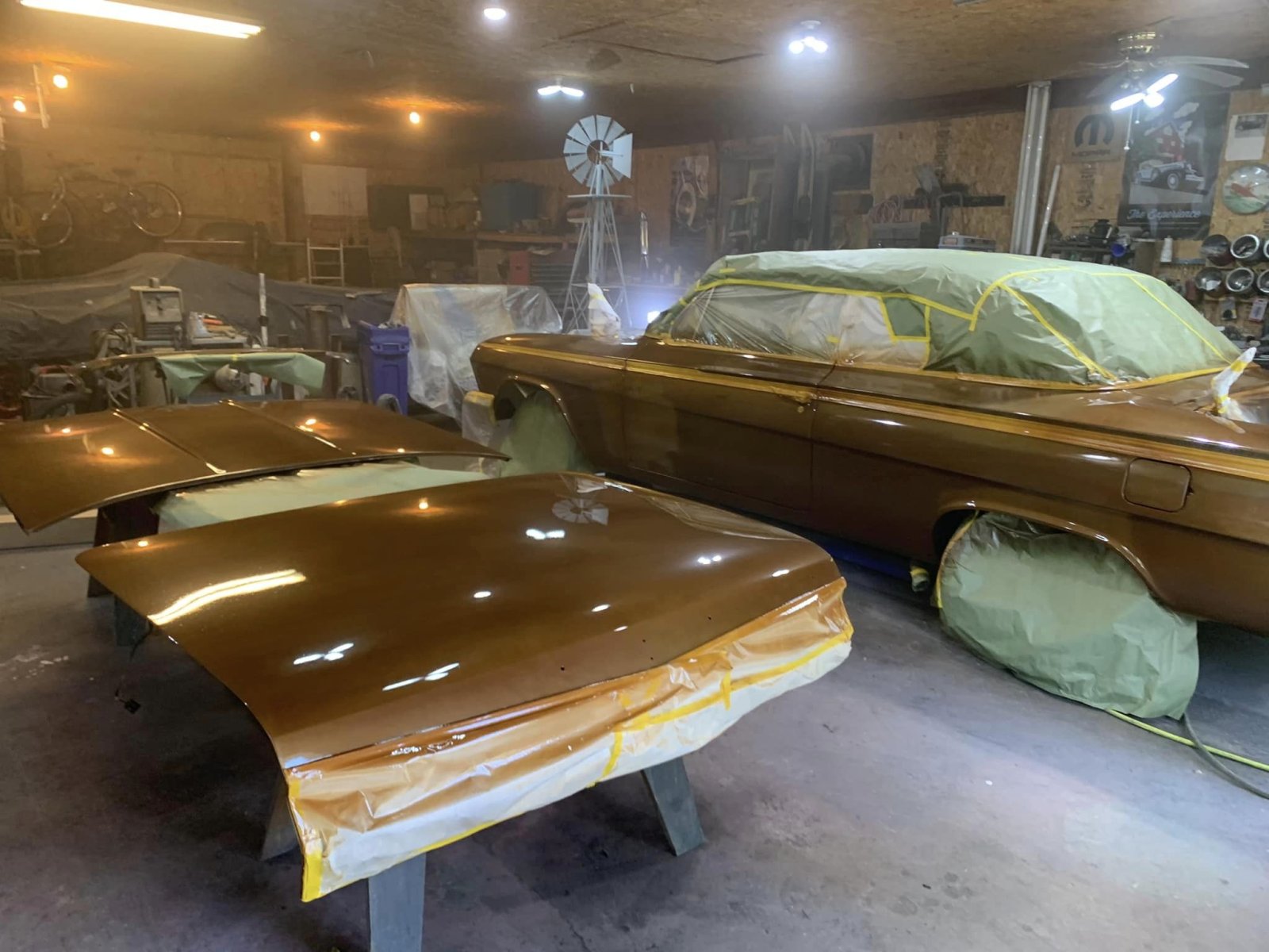

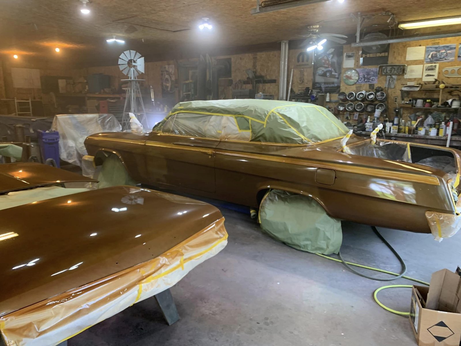

    The deconstruction continues. I'll get it all masked off and shoot the color tomorrow. My wife and I struggled to get the hood and deck lids off, but we did it without messing anything up. I'll get more help to put them back on. 4402ADC6-CC7F-42DC-A675-01239468DAC6.jpeg

    Perfect day to paint. It's gonna be nice. B136BC1F-A7A7-475D-9B27-2F9F31819DC4.jpeg E6FDAD13-93F0-440B-9136-B9A376D81958.jpeg A863D70C-CEA4-4692-8E29-0082ADC72BE0.jpeg FB8DE57A-3DF7-4B97-A65E-173D37BA6CBA.jpeg

    Right? NOTHING like the original color I was trying to match, but, it's all OK. As long as I never have to match it...

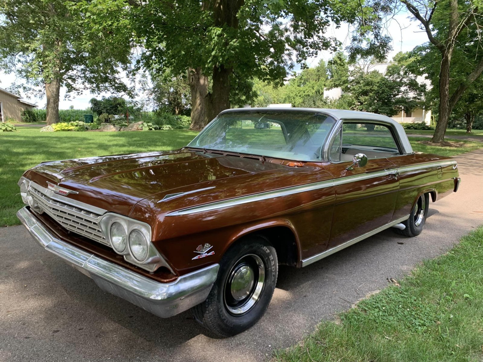

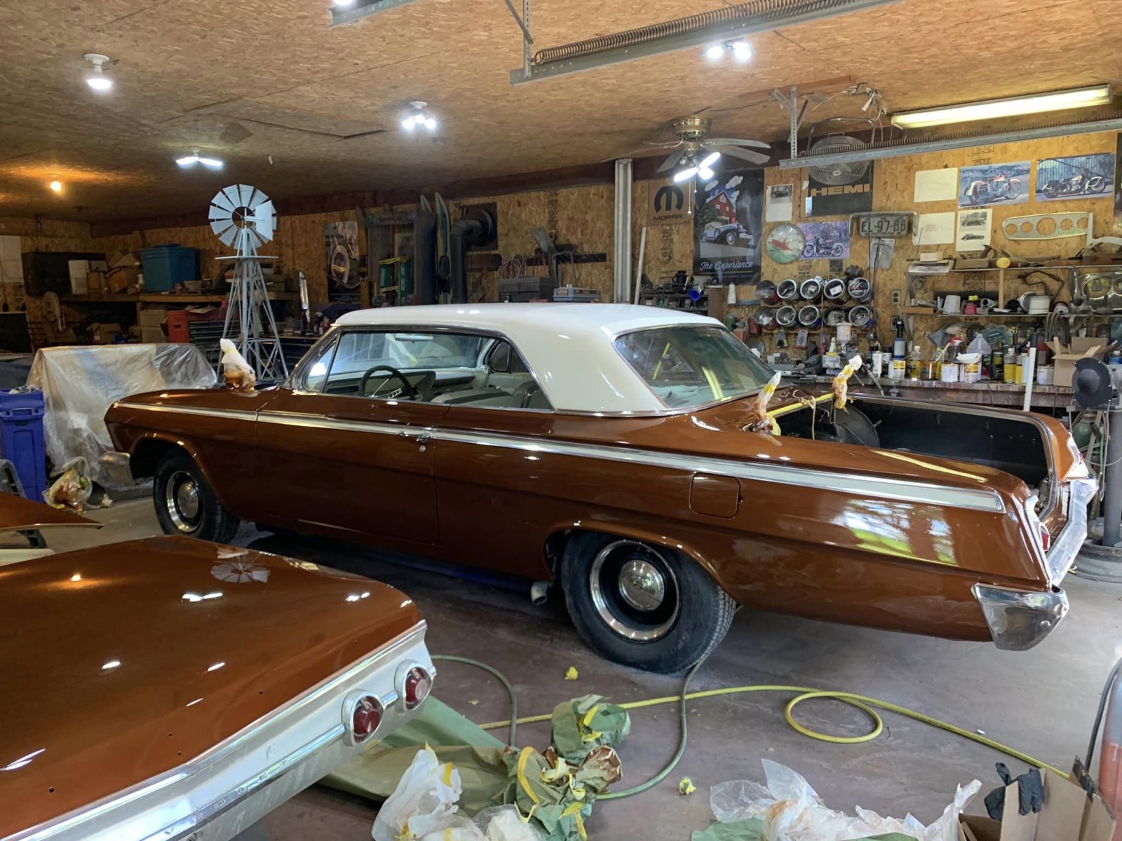

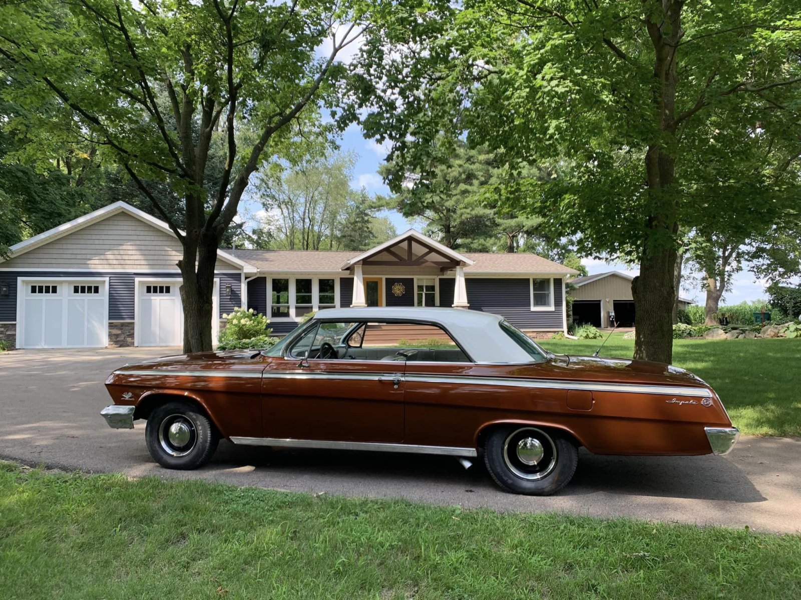

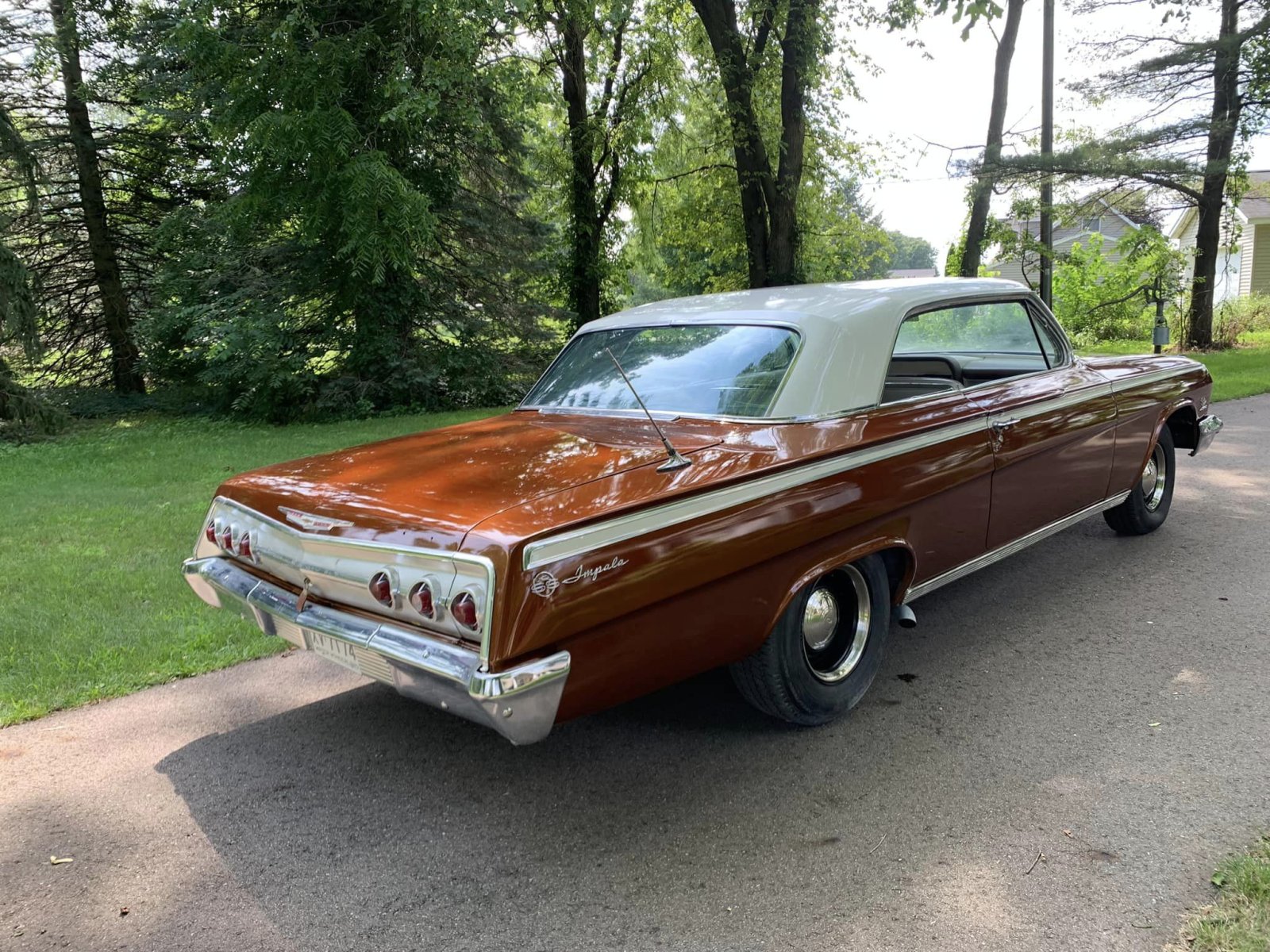

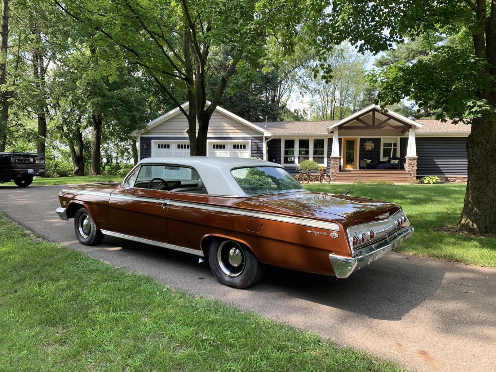

    Here it is done, tape and paper pulled. It is indeed a root beer color, which I like, but had I known that third quart of color was so wildly different I'd have picked the same color I did our other '62 in. This'll grow on me, I suppose.
    The reason it's so different is that the paint store had only enough toner to mix 2 quarts initially. They got more, I went back the next day and a different guy there mixed quart #3. I mixed 1 and 2 together, they shot EXACTLY the same shade of ginger brown as the original, so I thought nothing of it and didn't mix 3 with what was left of 1 and 2. Had I done that, it'd have still been different, and maybe not in a good way, as I got 2 full wet coats of #3 on. I did think I maybe should stop and have a 4th quart mixed, but who knows how well it'd have matched either.
    Since I don't have a mixing table, I'm at the mercy of the guy at the paint store to get the formula right. It's still a fine looking car, I do like the color, and as long as I never have to match it, it'll be fine. If something happens, I'll just shoot the entire bottom half of the car again... E825BABE-5620-42C9-A72E-09891A9A3916.jpeg B65AEABA-787A-4C3A-A4C3-011DEC7E36C5.jpeg 3C55238D-008C-4D3F-8FC0-D4E7E7B439E9.jpeg

    Looking good Mr Brian! As a part "spe******t" and mixer as my day job I hate to see that happen to anyone but have seen it before. I like the color though! Worst case if something happened and needed some more paint surely they can shoot it with the camera to get a formula.

    My pal Butch and his wife Pam came over and helped us get the hood and deck lid on. It went super smooth with 4 people, no scratches, no slip-ups. As I was putting the trim and emblems back on, I thought (briefly) that I'd ought to just repaint it with the lighter shade of Ginger (an '89 GM color, "Medium Camel") but everyone that's seen it has had nothing but positive things to say about this color, so I'm calling it done. It looks like a root beer float, it does have more character than the lighter color it was, so I'm at the point where I guess I have to leave well enough alone. Now I can order tires (red lines), a wiper motor and get the rear gears swapped and it'll be good enough for who it's for. 345C2A5B-8ECC-4C08-9E46-259C5A1F4497.jpeg 75581CDE-3AD9-4B10-8AFD-07AE98265C2D.jpeg EE8E4E9E-817C-4D67-9621-CDE87877C1E8.jpeg 17276B31-91AE-4113-80A2-3B82E497B07C.jpeg 85A2873E-D527-4E0F-B9E4-3670210CD1DC.jpeg
