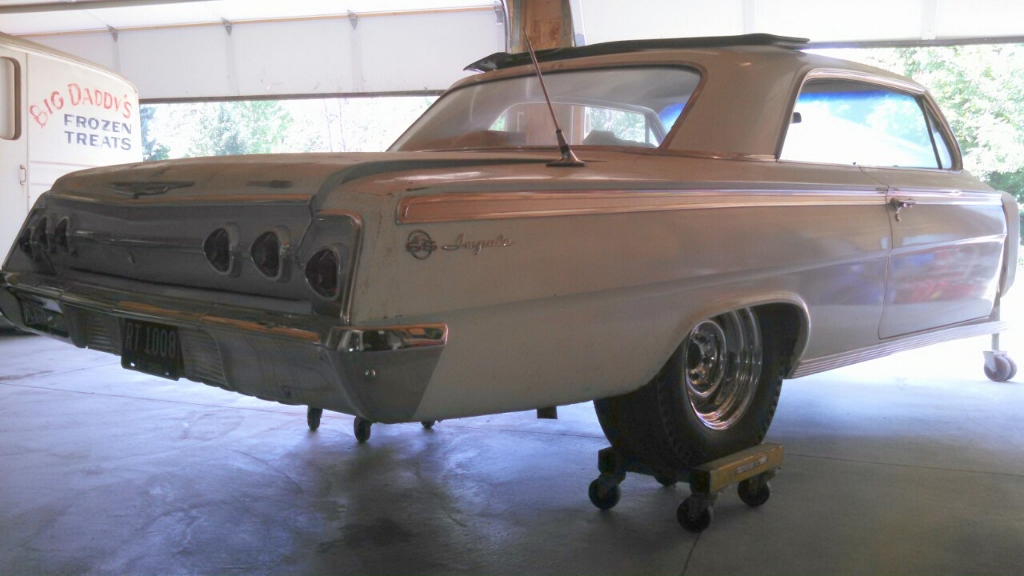

    Bought a pair of wheels and tires for the Impala..............First time the car has made contact with the ground via it's own tires in over 48 years...........Last week I removed and installed all new upper and lower A-Arm bushings...........Need to paint the front frame rails and bolt on all of the front suspension that has not been on the car for over 48 years as well........The front suspension parts still need painted....but what was neat......every part still has the factory paint codes on them, each spindle, each spring ect. has a specific colored paint marking on them...I will paint around all them.

    Btw, what are the specs on the cam you mentioned earlier?

    Perfect wheel&tire combo! That ought to get the juices flowing. What sizes?

    I'd also like to know the size and brand of the rear tires as well as the rim width. Thanks.

    Rims are Wheel Vintique 15x8 w/ a 4.250 BS.........Towel City Cheater Slicks 15x9x28.5.............The original duel exhaust bends into the rear wheel wells, these clear them.......bolting theses on I had to jack the car up and support the frame and lower the jack under the axle relaxing the rear suspension to get them on...........

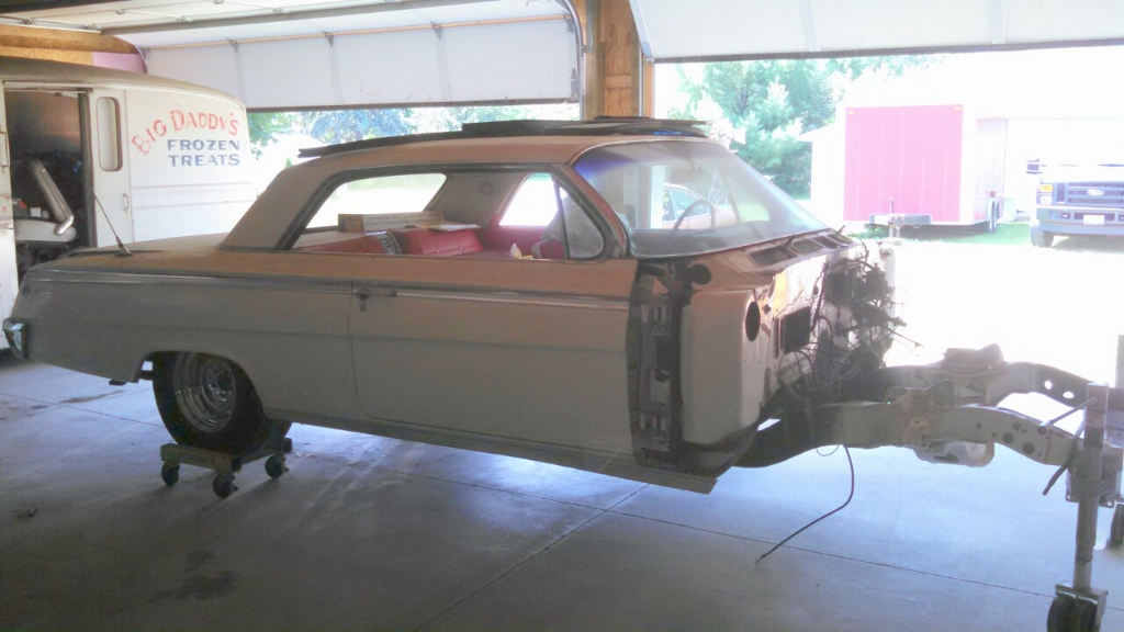

    I got the front coil springs into place.............Having hard time thou finding someone that can tell me if the steering box was either painted black or left bare steel..........I am finding out that some think they restored their car..........but just painted everything whatever.........restored to me is how it rolled off the ***embly line.........I am thinking the steering box and all of the front steering rods and ends were all bare steel, if they were one could use a flat clear over them............Anyone have any knowledge about this..........I have found restoration color code charts, it states the steering rods are natural steel, but nothing is written about the box itself..........I did paint everything black already based on the info from a Impala guru........but I think it was bad info and should have double checked the info........Everyone tells me to bolt it all together painted black for it would not hurt it..........I can always make them bare again............Thanks, Littleman

    My guess (& only a guess) would be cast on the box & steering components. Black probably has been deemed acceptable by most, but I don't see the factory spending the time & money to do that. Thanks for the update.

  27. Can't speak for sure on the steering box in that car, but a lot of the other Chevy's in the sixties (Corvettes, Chevy II's, Camaro's) had bare metal boxes, so I'd be willing to bet it did too. Awesome story so far!

    Littleman, We have a 63SS that my mother received as a graduation present in 1963 and has never been apart. The steering box and tie rods & tubes were all left bare in their natural state, as was typical for all GM cars of that era. If a steering box received black paint, it was more than likely done after the fact at a dealership during a "blackout" process where the cleanup shop guys just ran through and rattle canned everything for a uniform look. As it left the ***embly line though, unpainted. There are those "cast iron" paints these days that look close, but a good satin clear will look more natural.
