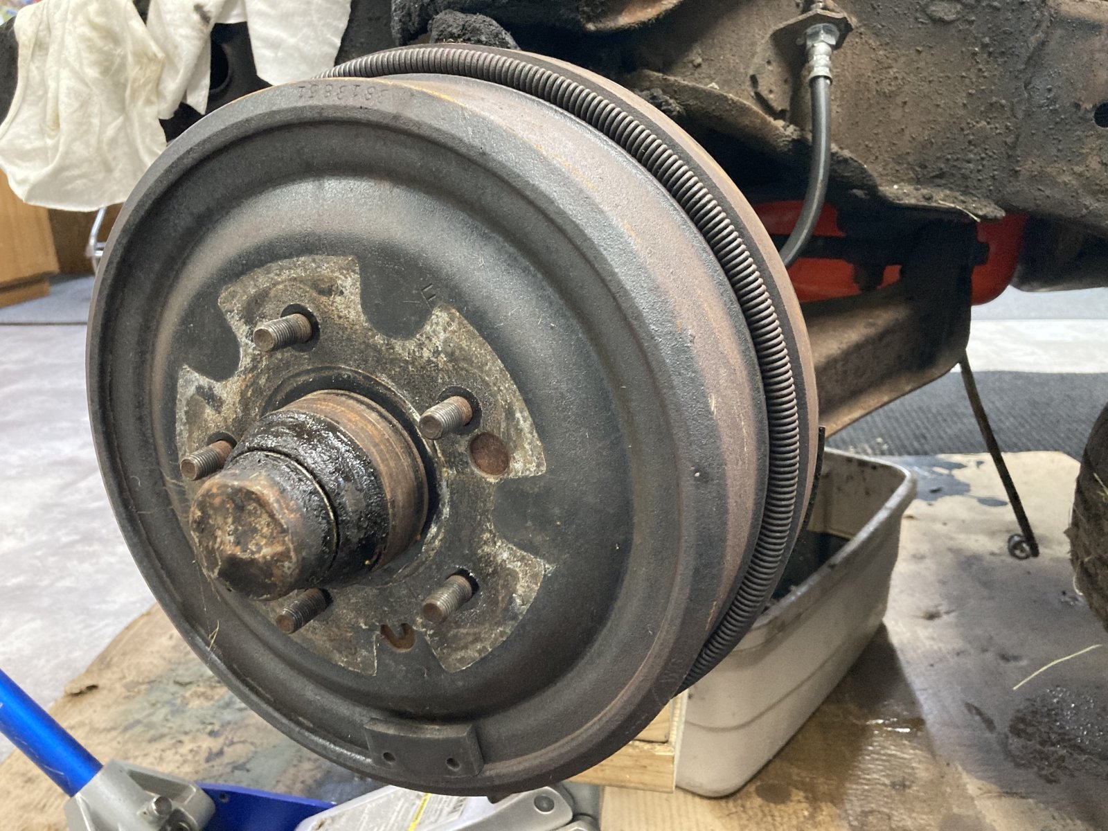

    from Missouri
    IMG_0223.jpeg Wanted to get some opinions on brakes. In the past I’ve always switched over to disc brakes but after reading several post from guys I’m kind of leaning towards just rebuilding the power drum brakes. This wagon will only be a stock cruiser. Thanks

    Thanks for all the opinions. Sure looks like for the kind of driving I will be doing I can’t really go wrong either way. I am in the process of removing the entire front suspension for a rebuild and if I’m going to need to replace most of the drum brake parts I might go ahead and install disc.
