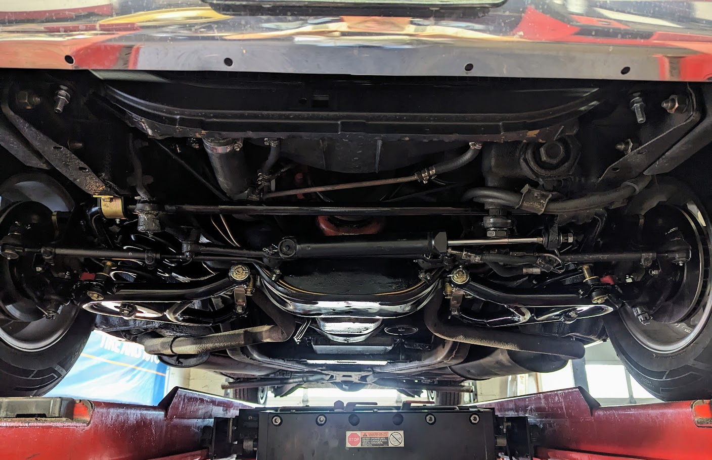

    There are many ways to go about this but cost was part of it for me. Tim parts.jpg parts1.jpg parts2.jpg parts3.jpg
