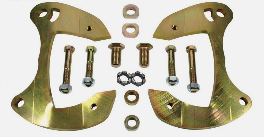

    Some of the disk brake kits I've seen are sketchy as*****, often using the drum spindles and then not having enough length, so the center nut won't fully engage, or using bracketry that looks home-made, and then a mix of off-the-shelf parts, often from late 70's or 80's cars that might not be available in the future.
    For an Impala, there's almost certainly a well-engineered setup available. But there's no way I would consider every disk brake setup superior to every drum.

    Care to tell us what kits those are? I've yet to see a front disc brake kit for an X-frame Chevy that used S10/G-body brakes.
    Mine uses the big car calipers and Trans Am rear rotors.

    Copying an OEM system is a*****shoot ,but you need to choose your cars wisely. A 62 impala can vulture the brakes from a 70 or later Monte' [or better still C3 Corvette]
    Whereas most "one size fits all kits" use G Body rotors which are 10.5" diameter [hardly an improvement] even though they advertise them as 11" rotors
    The biggest issue is the Caliper mounting brackets [usually laser cut steel] These are waiting for pad knock off!
    They then require 10.5" rotors which increase track width and scrub radius up to 1" each side .
    I would rather have a factory forged knuckle and caliper brackets over any dichromate plated homemade P.O.S
    Also beware of aftermarket "drop spindles" [even from reputable vendors] most a Cast Nodular Iron whereas the factory used forgings.
    I consider these ^^^^ a bigger*****shoot than factory brakes
