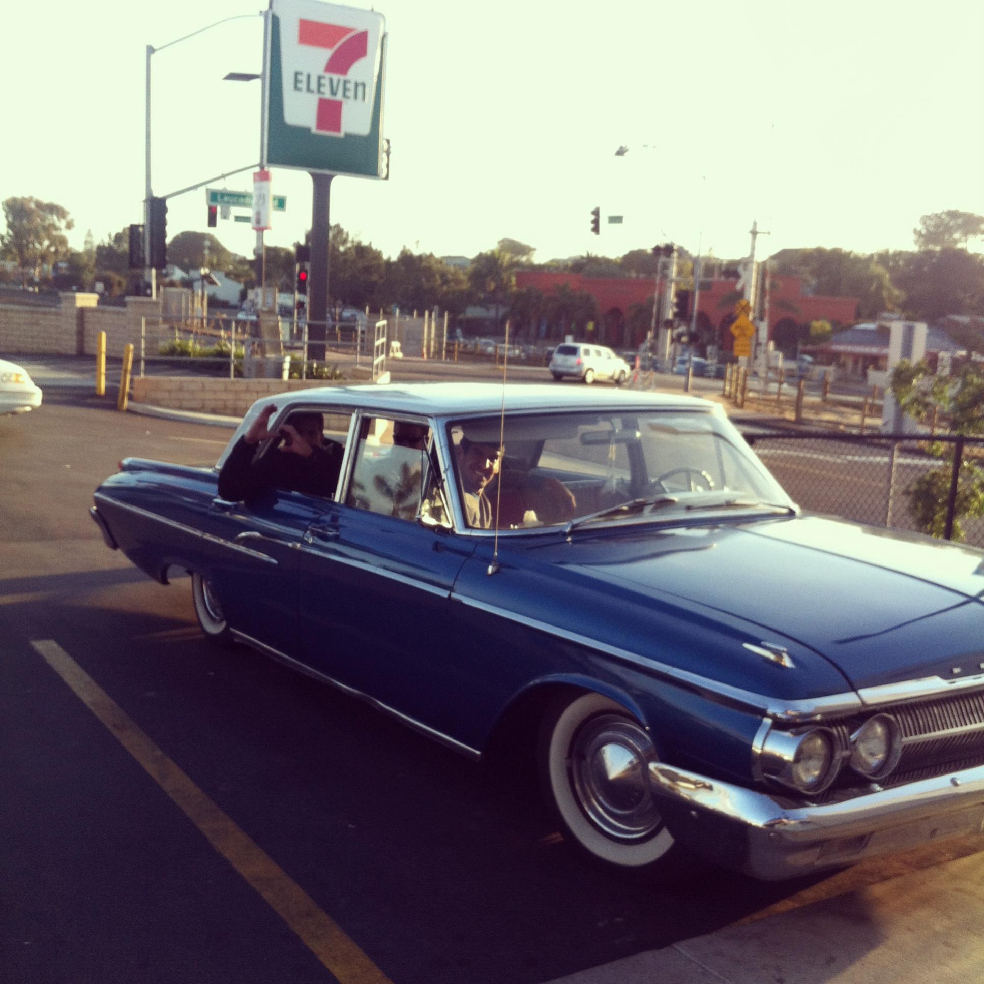

    I lowered my Merc by cutting just a hair over 2 coils up front, and 4.25" blocks in the rear. That just happened to be the size of stock available so I figured if it was too low I could always cut the blocks down. Got bigger u-bolts at a truck accessory store and had to enlarge the bolt holes in the shock mount/u-bolt mounting plate just a tad bit. 14" wheels too.
    It still rides pretty good too. Just barely touching the front snubbers and plenty of travel left in the back. I think the pinion snubber is the only thing that bottoms out back there.

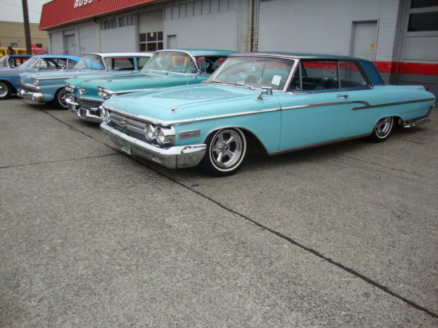

    from PNW
    I recently purchased a 60 Merc Monterey 2dr hrdtp from Ramblux in Hollister Ca. I have to say he did a great job bagging this car he used the Galaxie set up from Air Ride Technologies he kept the original A-Arms on front and used de-arched leafs in the back
