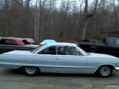

    Looks very doable turning it into a 2 door "post" car as the roofs etc. look the same
    (...but I personally would rather have the 4 door if I were doing a cruiser, however this 2 door post may be the best looking one Ive seen)

    It may get radius and maybe not i just wanna put some more meat under the back an there aint much room in there now. And that 2door you posted is a sweet car! I like the 2 door look.

    The white '63 with the '61 Impala type roof looks fine in that side profile shot. I'd like to get a chance to study that car in person. Roof's got a great design. If it works good on the '63, '64 would be okay too, wouldn't it.

    Look up 63 bubbletop for a couple videos of that car, no details on what they did but gives a walk around in one vid.
